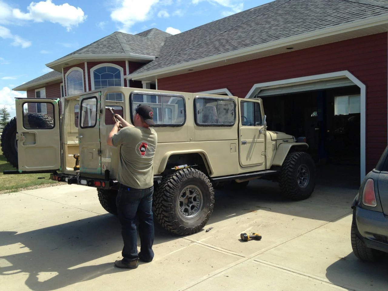

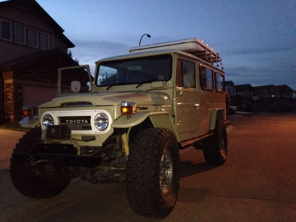

That was quick, good job Tyler and Edmonton crew!
Looks fantastic, hard to believe how quickly the body work came together!!!
That was an insane amount of work in a very short time. She looks fantastic!
Now I want one.:crybaby:

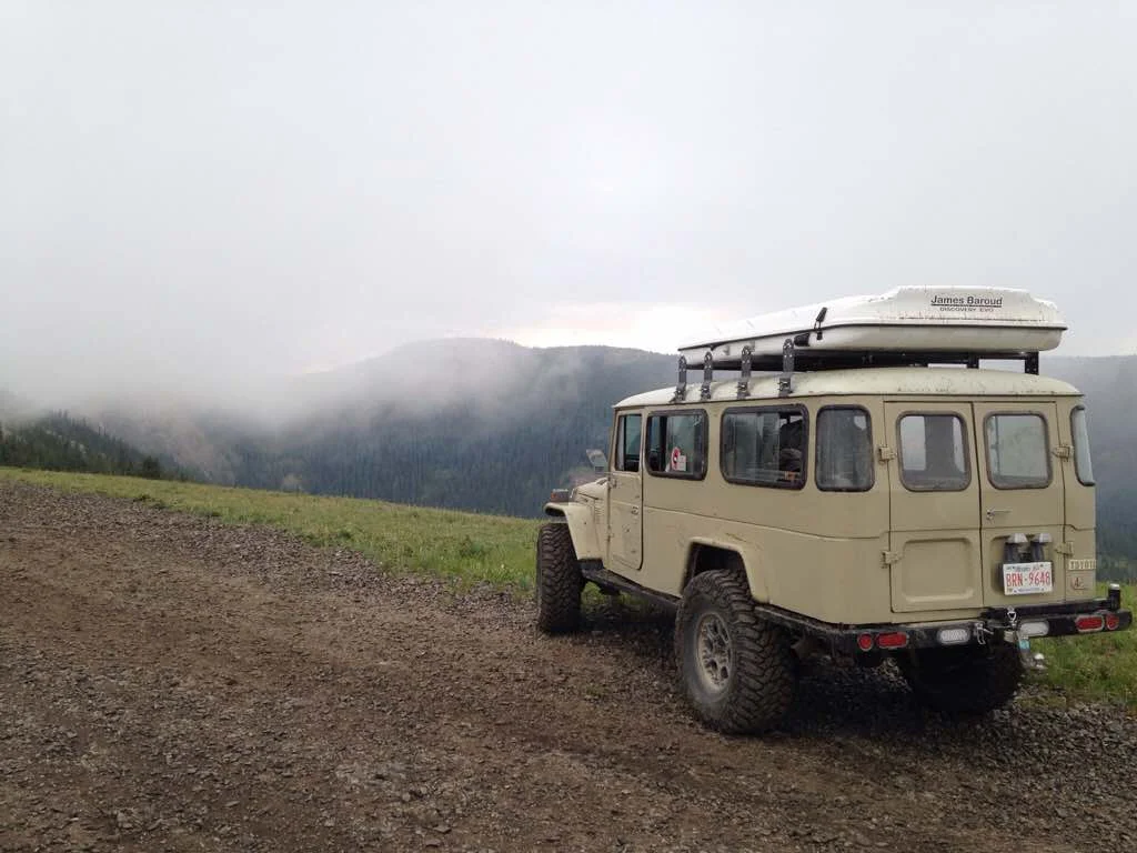

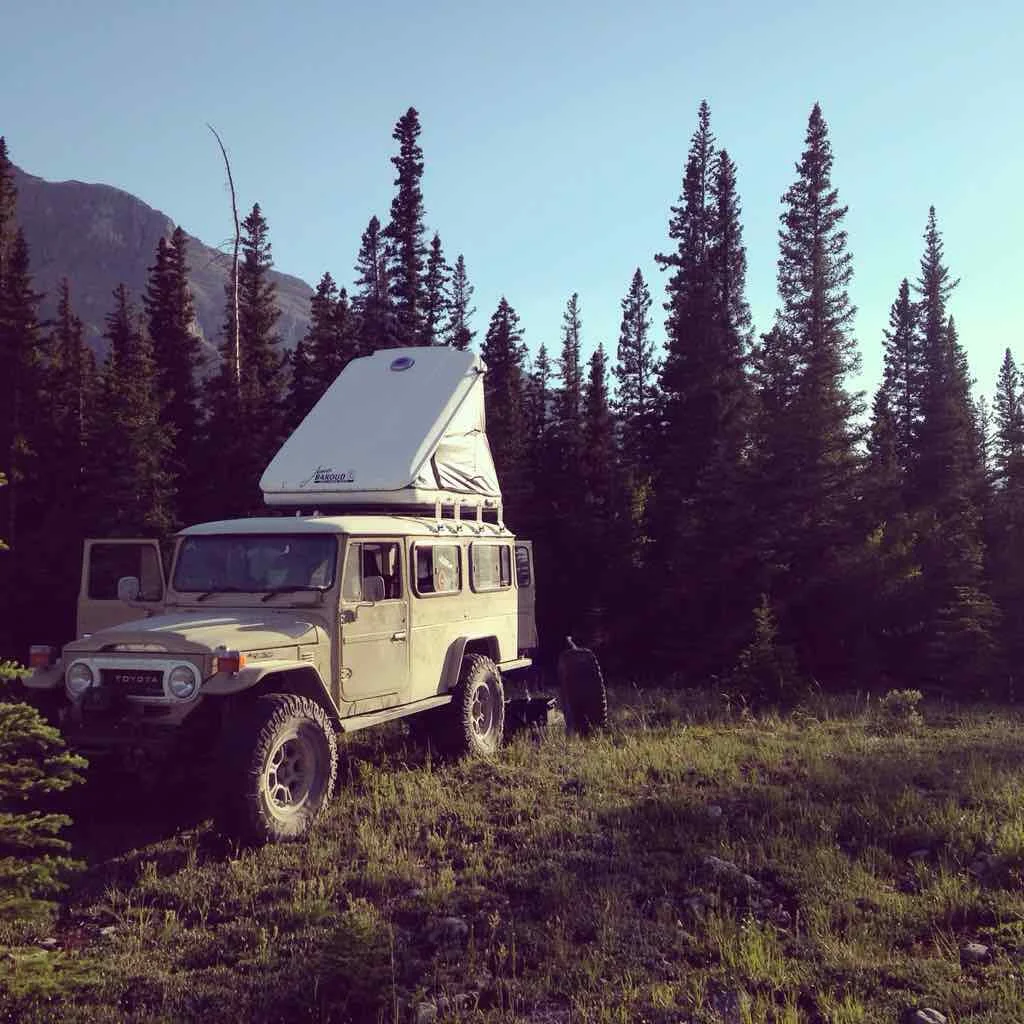

Got back last night from the clunker run up the trunk road. Truck ran really well and had a blast. Couple things went wrong the largest of which was a sheared rear swing out spindle. I lost my spare tire at the end of an epically bumpy road. The spare is super heavy so I wasn't shocked but still disappointed. Now I'll need to build a double shear mount on the bumper to better hold the tire. Hopefully that will be sturdy enough.
I think for general use it would have been fine but this particular road was awful bumpy.
I don't think you should be disappointed considering the epic sprint to the finish. I'm totally impressed with how it came out considering the time press to make that trip. I still say fanatstic job and kudos to all the extra hands that made that possible.
