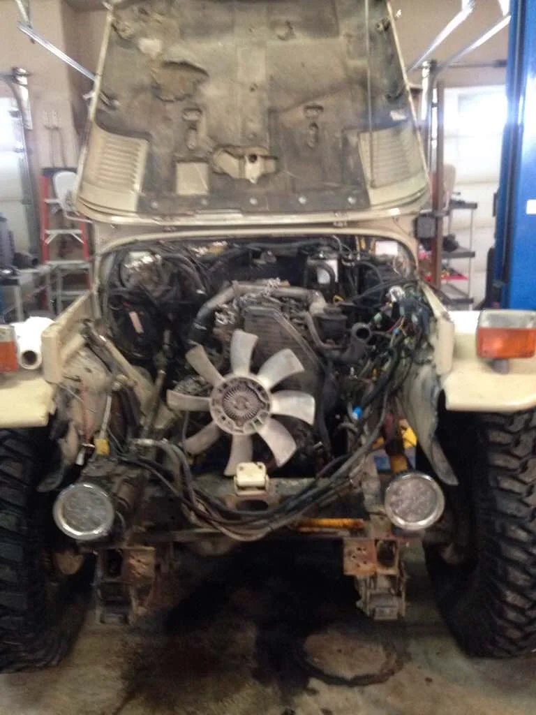

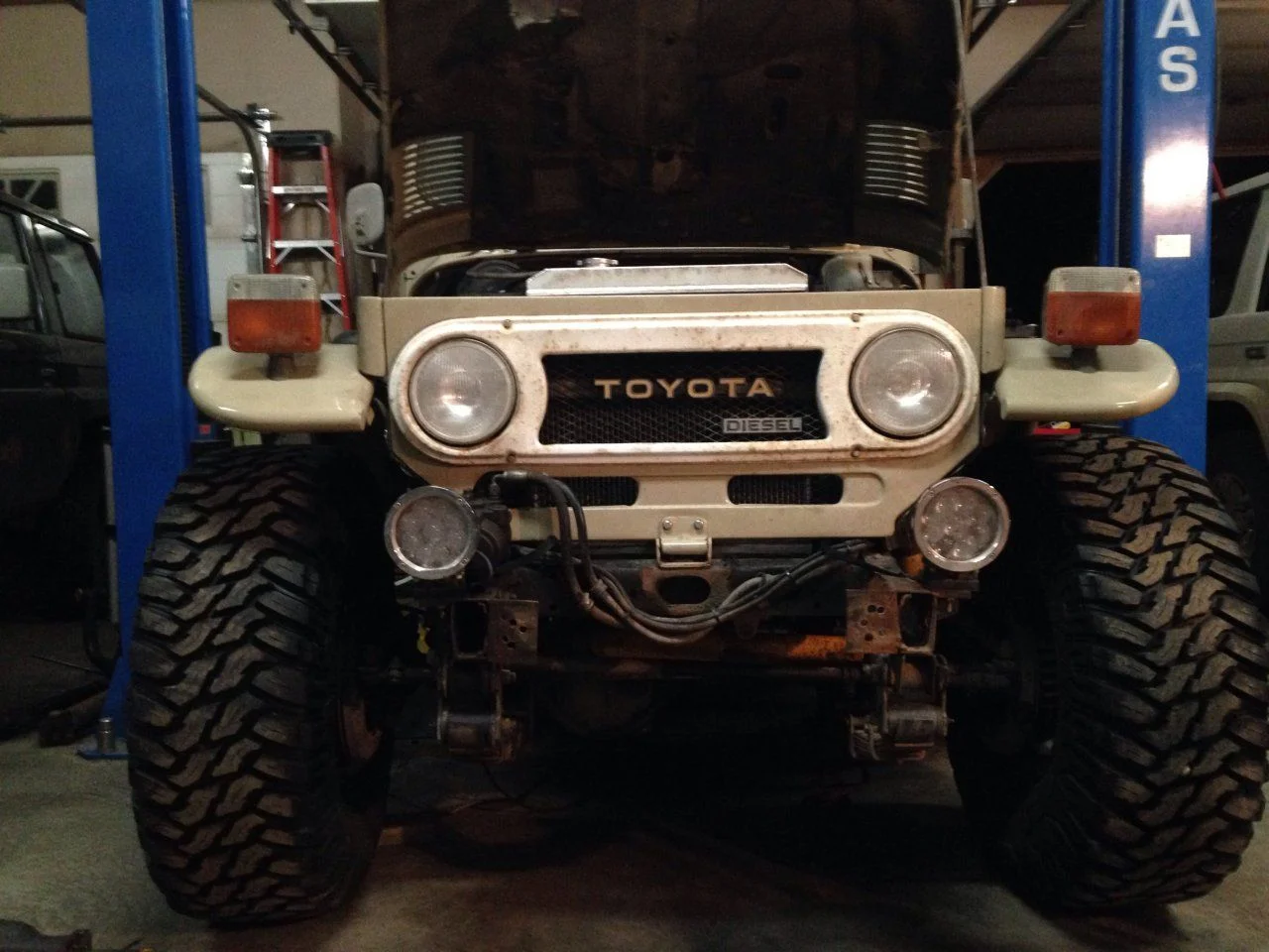

Well engine is in... Twice.
Turns out they is minor differences in the engine mount brackets that are on the block. First time it landed it was leaning hard to port but after a removal and reinstall is back to the level.
Leaning
Leveller.....
Leveller..that's more better. Looking good. I think you're crazy, but keep at it

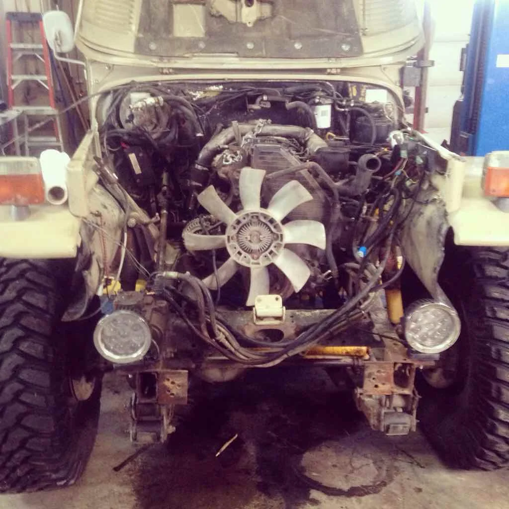

Well lots of progress tonight!
All cooling system is re plumbed including webastos. Electrical is all hooked up except for oil pressure sensor and temp
Oil change
Coolant filled and pressure tested. Starter/bell housing/ clutch/ fly wheel all done now too.
Should be able to start it in the next few days if I play my cards right
It's alive. Started really quickly too. All fluids are topped up and she purrs. Need to raise the idle a touch after removing acsd.

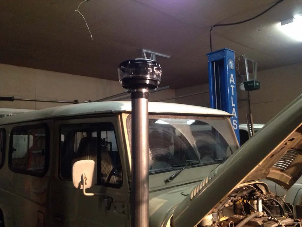

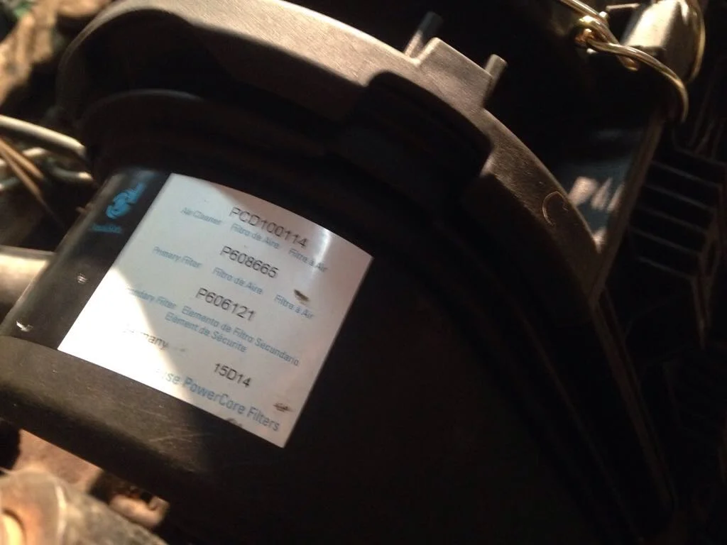

Well tonight was working on the new air box and snorkel. The plan is to run a 4" snorkel into a monster Donaldson pro core air filter. This then reduces down to 3" into the turbo.
Snorkel lid is a 10" Donaldson pre filter like I used to have on my 60
The filter assembly is mounted off the tube fender for a pretty solid set up. Need to finish up clamps and such but getting close. Also need a 4.5inch hole saw to get the snorkel out the side.

And just a mock up to put snorkel in perspective

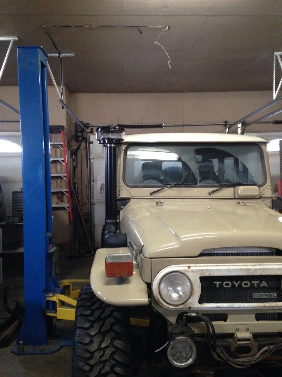

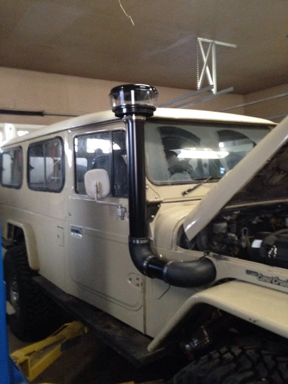

The snorkel is on and mostly done.
Was a busy weekend. Finished the plumbing and mounting of the new snorkel. Need to disassemble to get it welded out and painted. Big question is black? Or silver?

One vote black.
Black

Painted snorkel tubes... Black

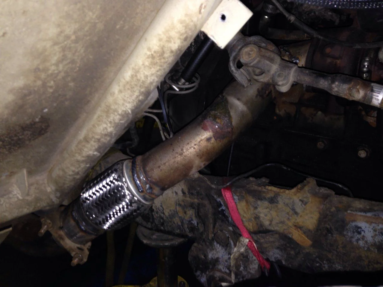

Then moved to exhaust. Got the flex pipe today thanks to ibex and to ratpuke. Welded that in and remounted downpipe to turbo. Still need to work on hangers.
Fired up and it's sounding good.
Silver would have been better.
