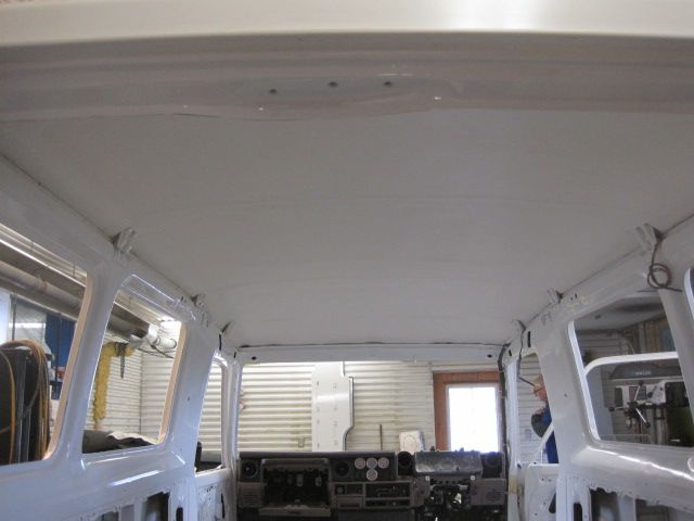

Fantastic effort on the headliner....I know how stressful that can be if screwed up. It turned out perfectly.

well, it seems i messed up.:ban:
the front console doesn't fit with the new insulating material :eek:so i will need to drop the headliner on the front, remove the insulating material, replace with 1/2", reinstall the headliner and then install the front console.:meh:
i might do the same to the rear.:hhmm:
damn tight fits:censor:
