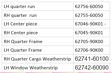

For the part number lovers: These part numbers are the replacement for the older models. Newer year troop carriers sliding windows are the same.

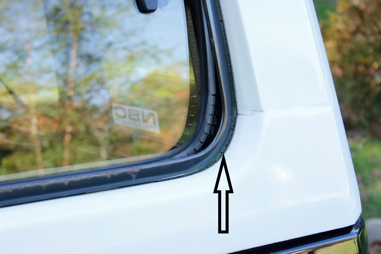

Obviously these aren't in great shape.. This must have been the side of the vehicle usually facing the sun when parked. The other side is not as bad.

Thanks for the input. Like I said I might want to create a new thread so it's not confusing everything. My install is going to include new frames, weatherstrip and the window runs. Here's the part numbers for it.

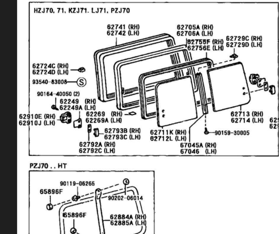

What i'm hoping is that the newer strips look like the image on the example, vs what I have. Mine has an exposed and corroding frame and the butyl is cracked and probably leaking water. There's noticeable rust accumulating under the car where the water could be going. This unfortunately is a bit of a guess, as I can't easily track water leaking into the window and then rusting underneath. There's two schematics that I'm finding for the replacements. One has a list of parts that have been discontinued, this is hopefully the approach that was originally used during manufacturing and has since been updated to resolve what is supposedly a common issue.
