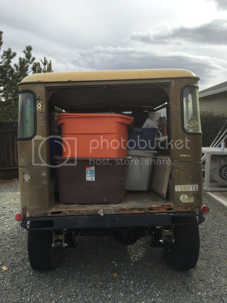

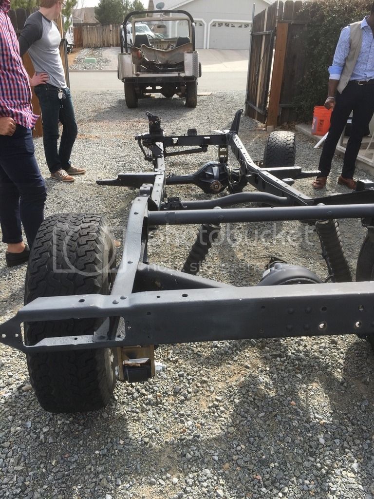

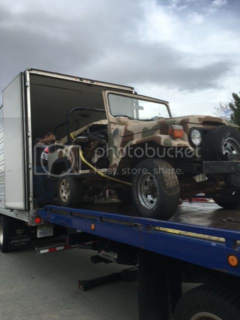

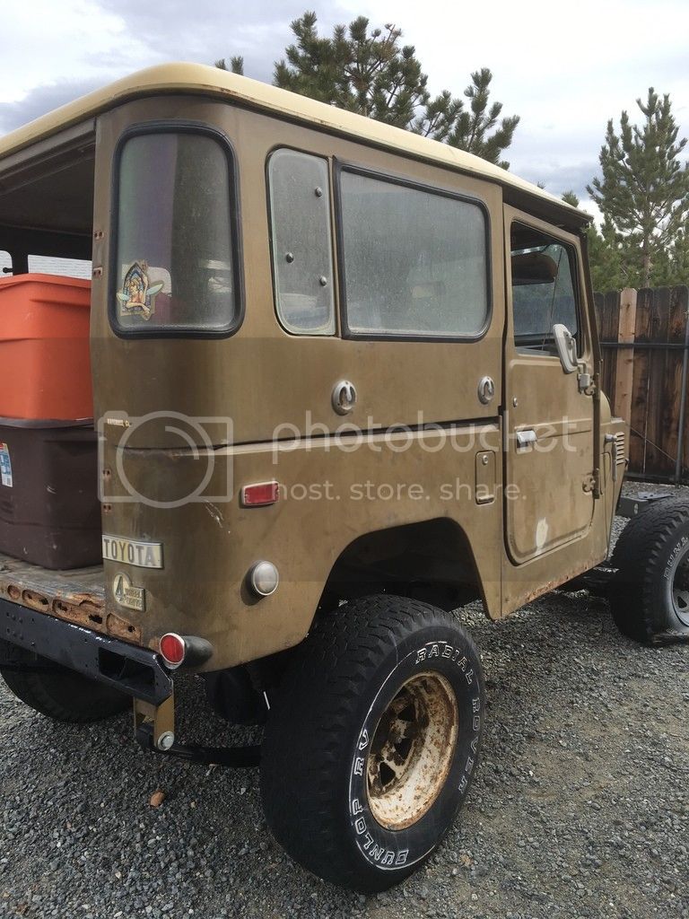

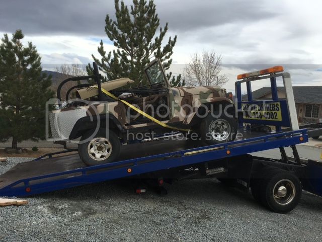

Both rigs were picked up on Saturday. Should be here by the end of the week! Here are some pics sent to me by the Lonnie the seller when they were loading them.

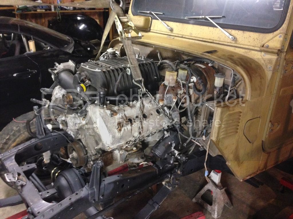

I have been out of town for several days with the family. Had a great time. However, like a girl on the side, (Which I have never had:) I couldn't get my mind off this FJ40 build and I couldn't wait to get home and work on it! As soon as I got home I helped the wifey get the kids to bed and had a cup of coffee. Once the wifey retired to bed I made a B-line to the basement to work on the FJ. I just had to get the motor off the stand on hanging in the engine bay to see how my finished product might look. This would also answer the question if this could actually fit or be done. Well I am happy to report that there is no doubt in my mind that this can and will be done and I am super excited to be the one doing it. Once settled in a position that may represent the engines final resting place I found only one big hurdle. That hurdle being the steering gear box. I also noticed that a straight shaft to a saginaw conversion won't work either due to the super wide cylinder heads obstructing the steering shaft path. However, I have this ingenious solution that I have been thinking about and can't wait to show you all. In the 30+ years that people have been doing power steering conversions on FJ's this one will be way outside the box! Well with great excitement here are the pics and I hope you think it's as kick ass as I do! Enjoy

I can't take it anymore, what's the steering going to look like???
Well let me get it mocked up and I will post up a pic. I have already removed the factory steering gear box. Tell me, has anyone ever made an aftermarket power steering gear box to sit in a similar location as the factory box? That won't work for me as the heads are so wide. However, I can't imaging no one has swapped a Ford or GM box.
