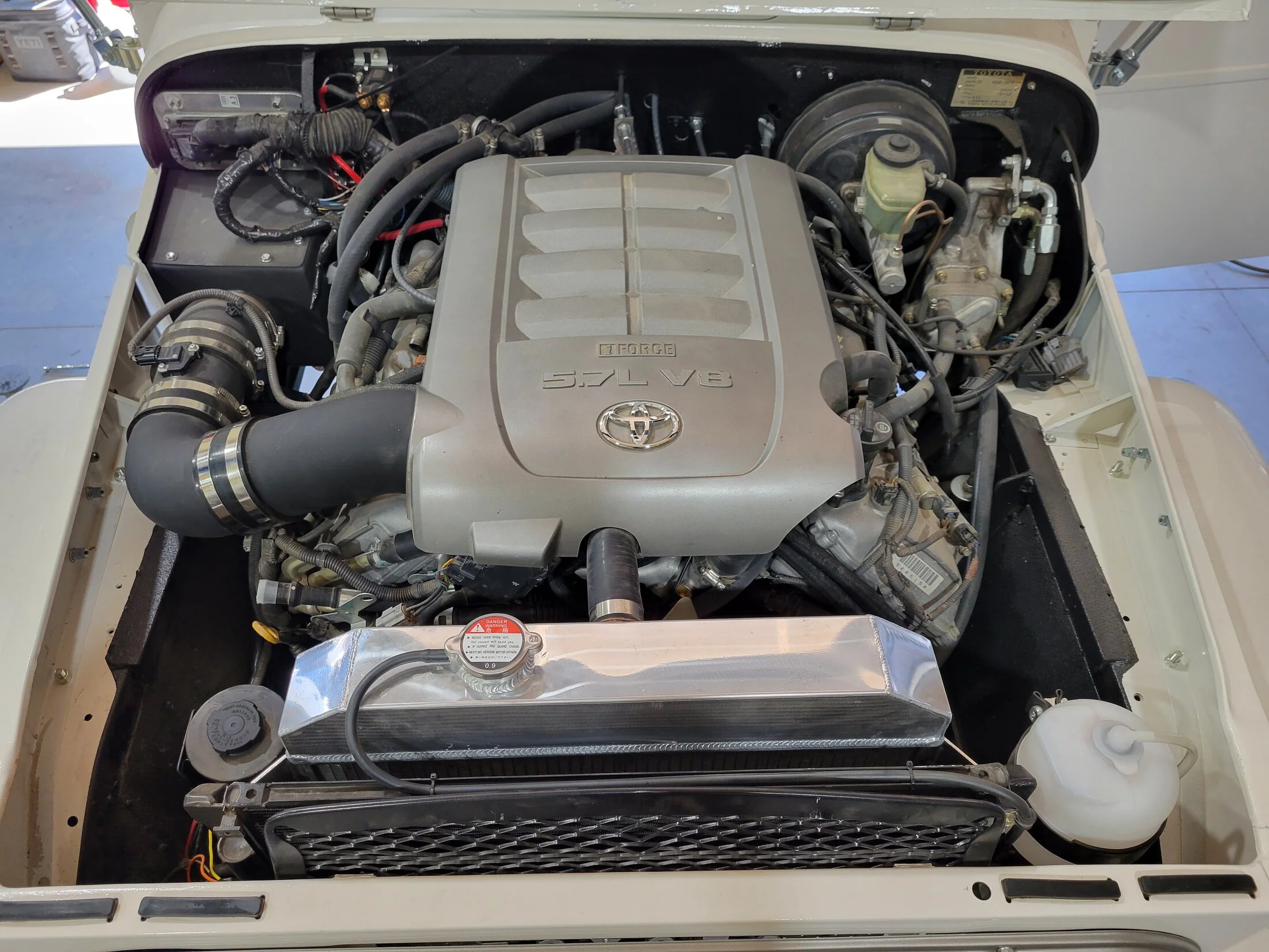

TRD Supercharged 3URFE 5.7 Tundra powered FJ40

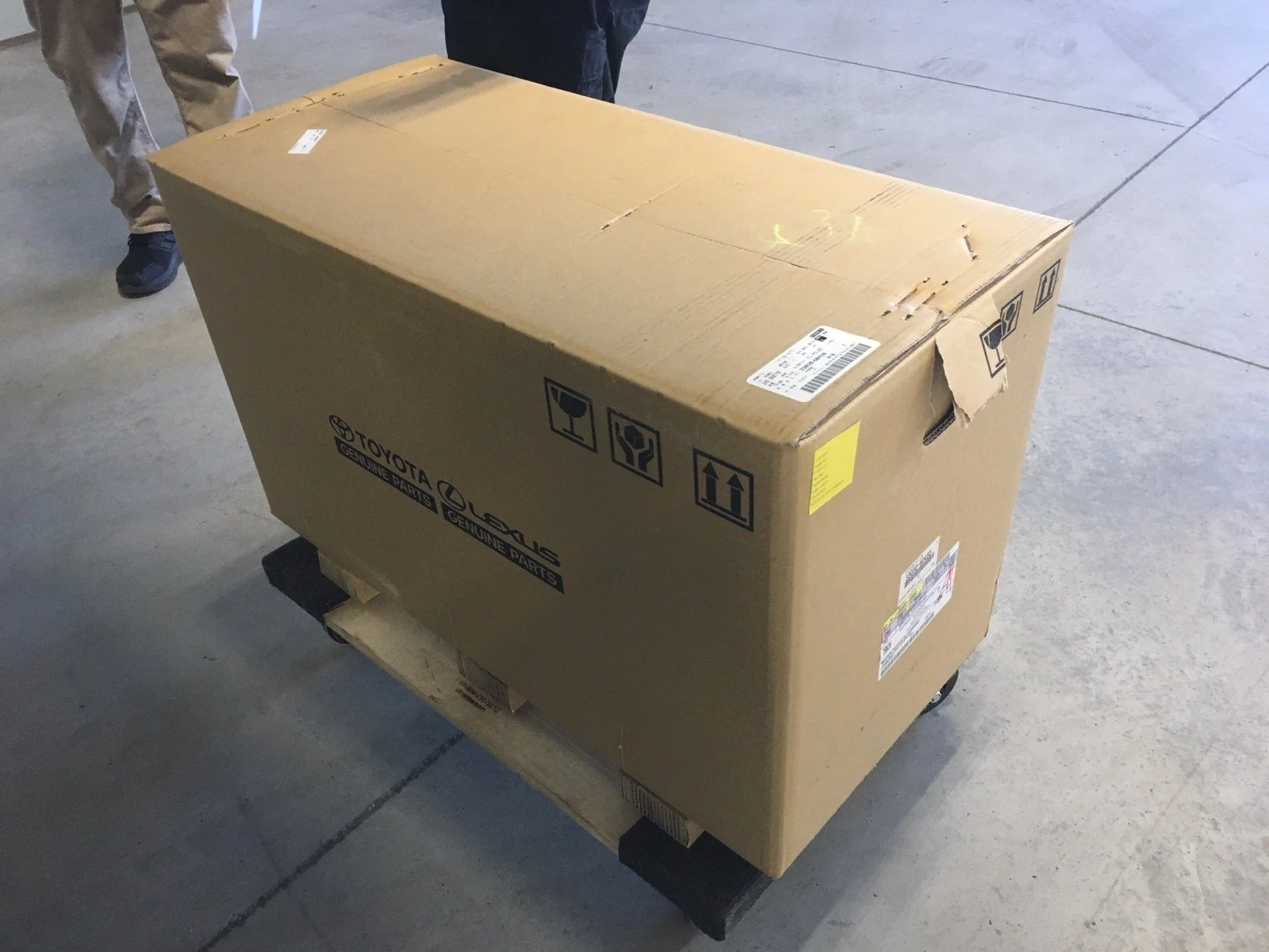

I think the new split case will be overly expensive vs a used and rebuilt unit. Also you want the later 86-90 cases out of the later 60/62. These are beefier with the 38mm idler shaft.
Also super easy to rebuild. Even if you can source a "new" split case, it's going to be in pieces. Trans isn't a problem though, $2500 brand new in the crate.

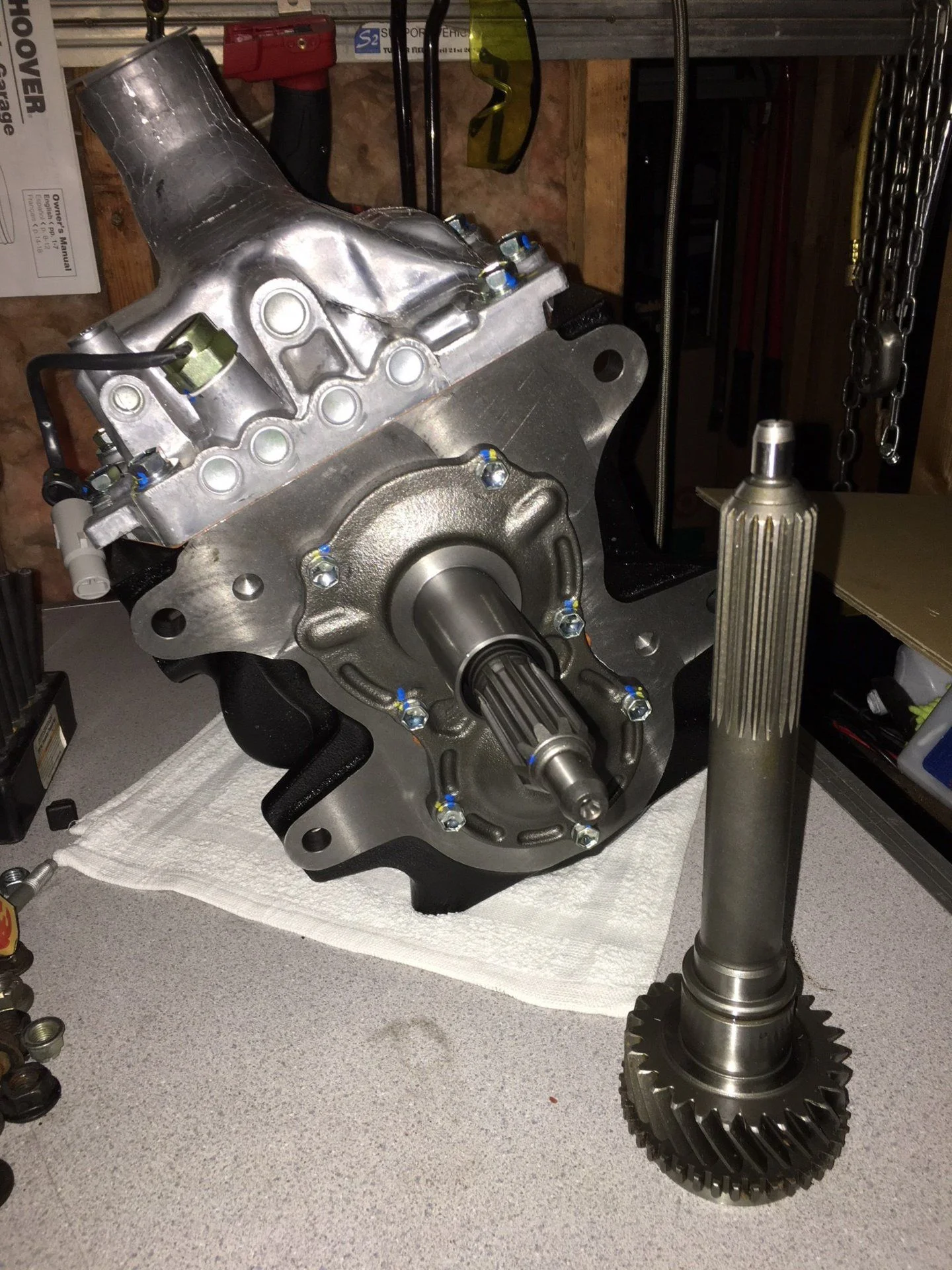

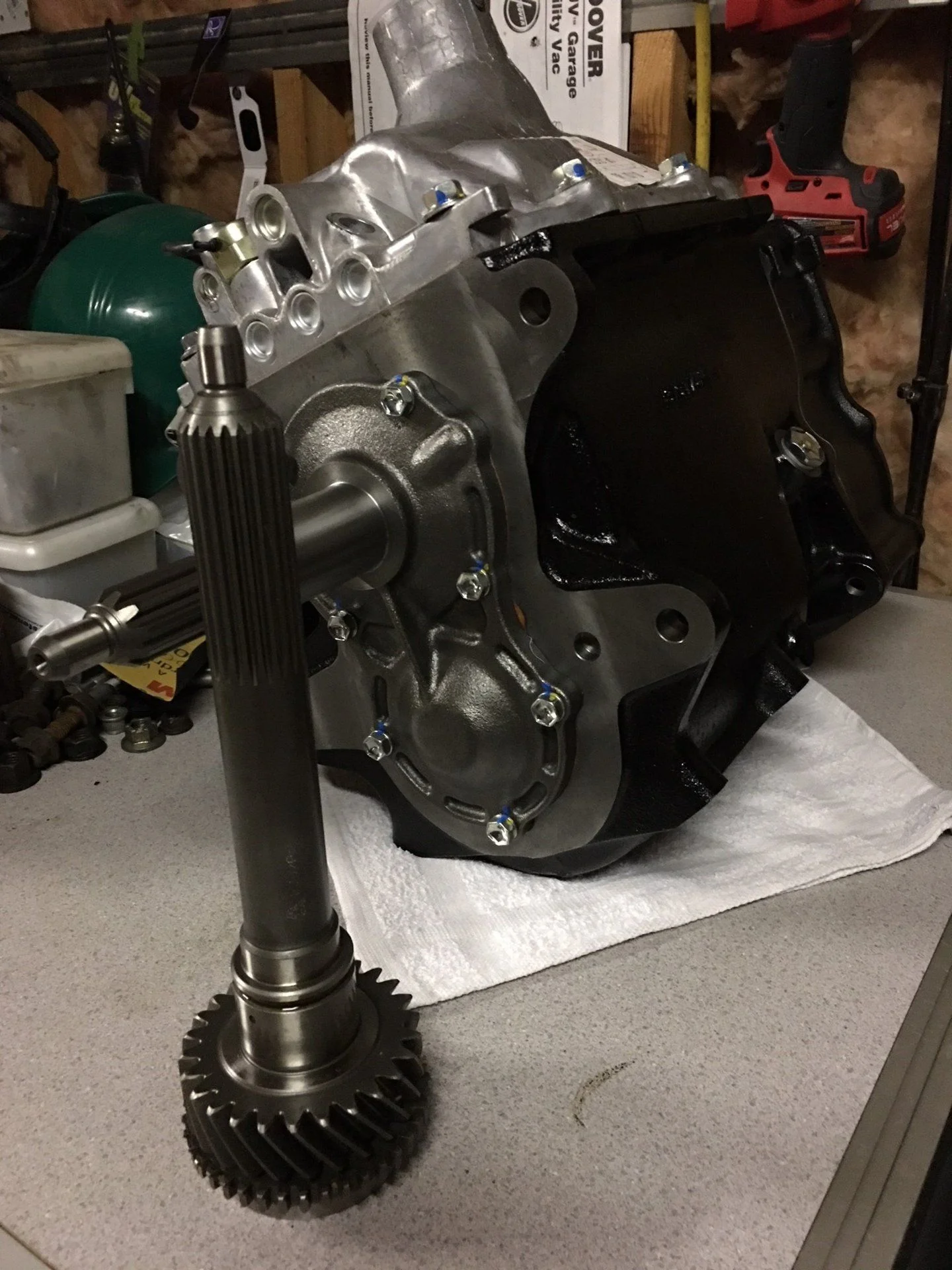

Hey Guys, do you all know the part numbers necessary for the H55f swap? Aside from what I have I think I need the following. I just picked up a new shifter assy too.
Some gear
long bolts for the t-case to the trans
gaskets
Oil Cup
Transmission Gasket
Transfer case Housing Gasket
Tap and Fluid Plug (7/16 thread size 1/4 x 18)
