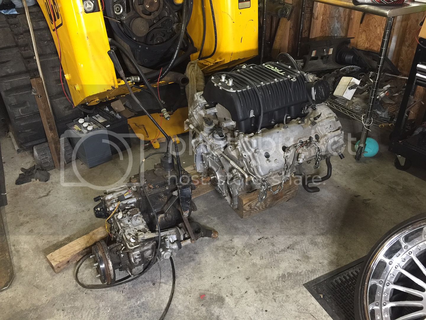

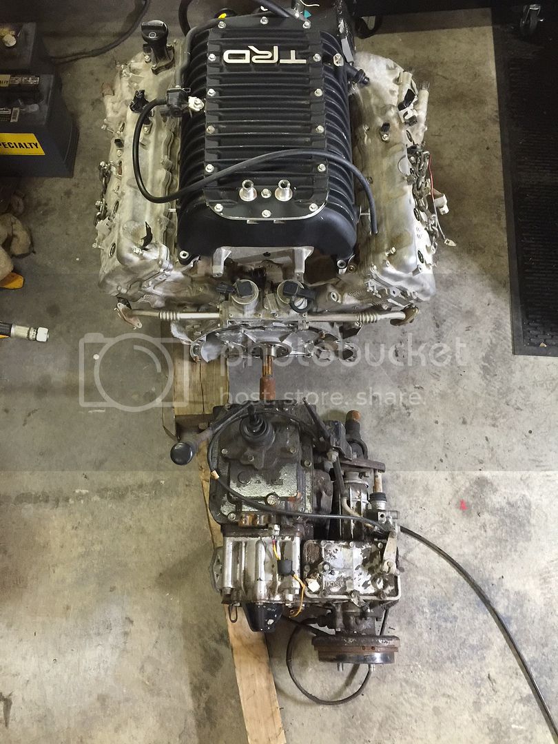

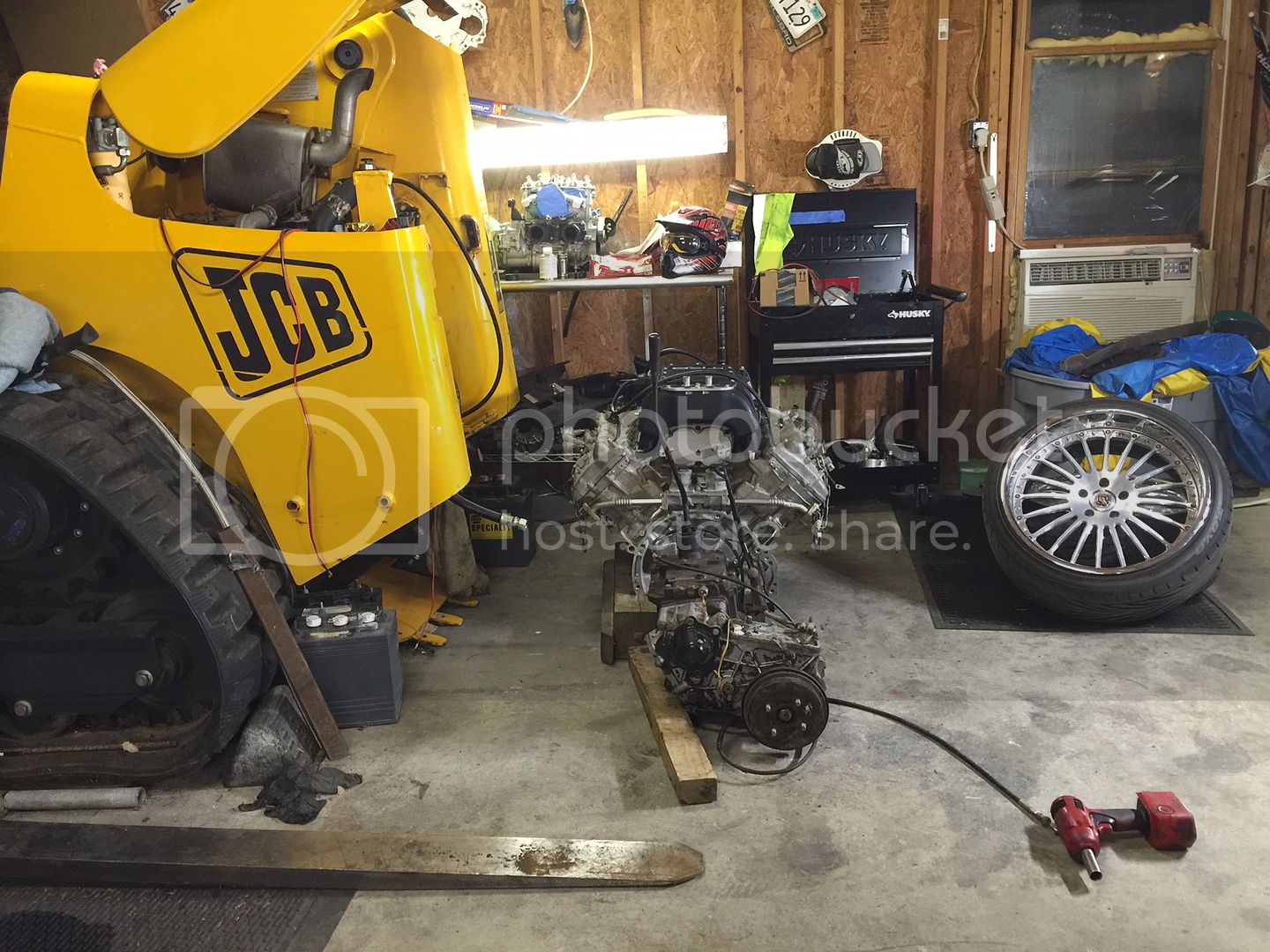

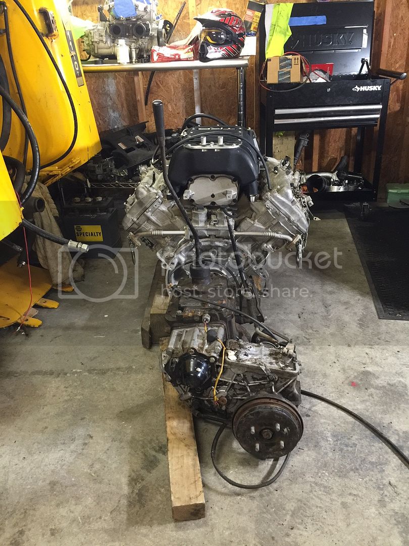

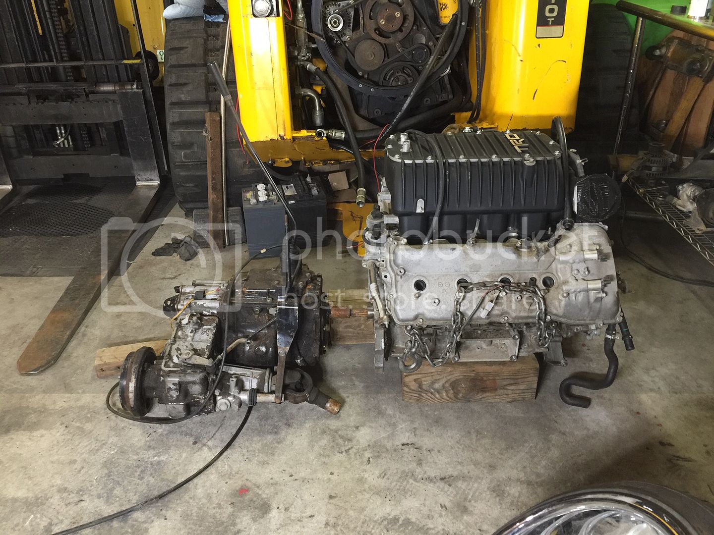

Hey Guys,
It's taken some time since my last update. However, I juggling this and several other projects. However, Here are some good picks of the 4 speed up to the Tundra motor. I have the bell housing being shipped. Once I get that I should be able to determine my next moves. You have seen it here first!
Joe
YEEEEESSSSS
very cool, have you gotten a proper pilot bearing setup yet? I'm assuming that crankshaft has some kind of provision for a bearing of some sort?
Does the 5.7L come with a standard in anything? overseas?
It's a shame how the manual transmission is being forgotten in the auto industry
cwwfj60 - The 5.7 does not have a manual that I am aware of. As far as the bearing / bushing goes, I had to make one for the Lexus 5.7 to 6 speed. I will most likely have to do the same with this one.
