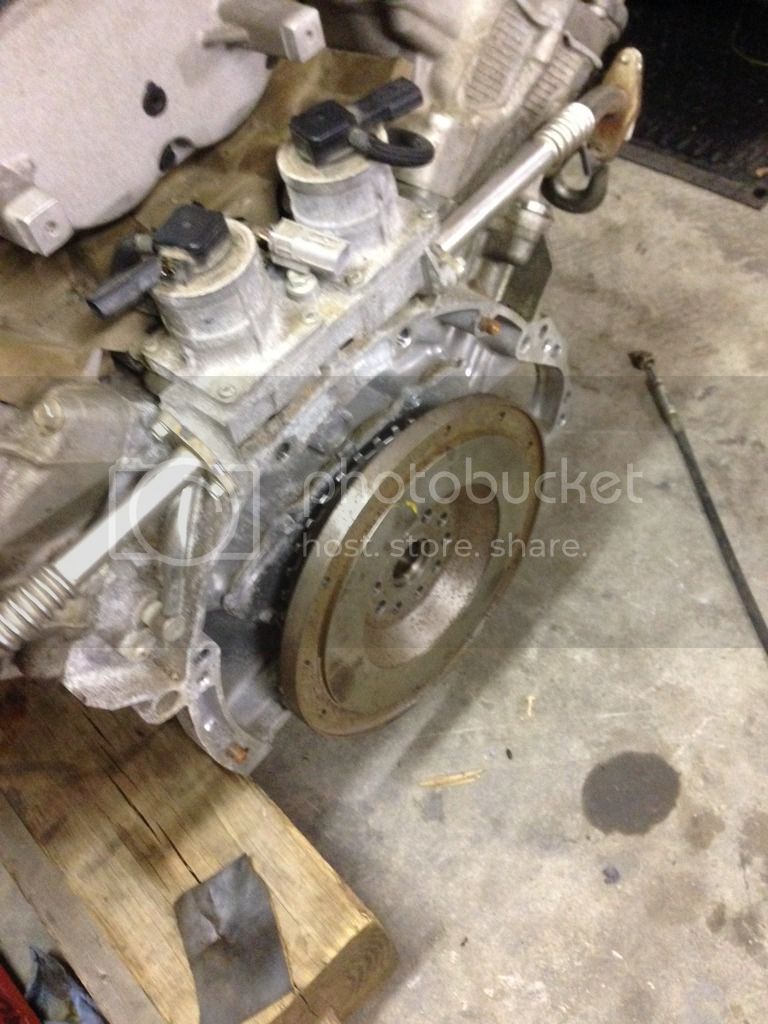

I am looking forward to seeing more updates of your build. I am curious to know if you ended up ordering a h151f that was designed to come behind the 2uz. I would be interested in knowing what the total cost to get it to your door was. I am building a 2uz with a h151f but the h151f I have came behind a 1fzfe and the input shaft is shorter so I have to switch it out. This means I have to take it apart and I not looking forward to that.
I was going to use the H151F but now going the H55 now. It's the same money as the H151f and yet it's new. Easier to source too.
The only H151 I could find was almost 3k. The H55 is just over 2k brand new. Plus if my adapter fits the H55 it should fit the 4 speed FJs as well. So we will see. I have read good things about the H55. From what I have read people have had some issues with the H151. That being said the H55 should be perfect for what I am trying to do. At this point with Icon asking 200k for their custom builds I think I am going to have to lay low a little till my build is done. If they are actually fetching 200k for their builds then this one should be well over that.

Hey guys what 5 speed do I need to get for this thing? H55f? I also need a split case transfer case. Does anyone know if you can still source the Tcase new? Also considering this is going to be around 500hp crank I am considering awd w/low range. Any ideas?
