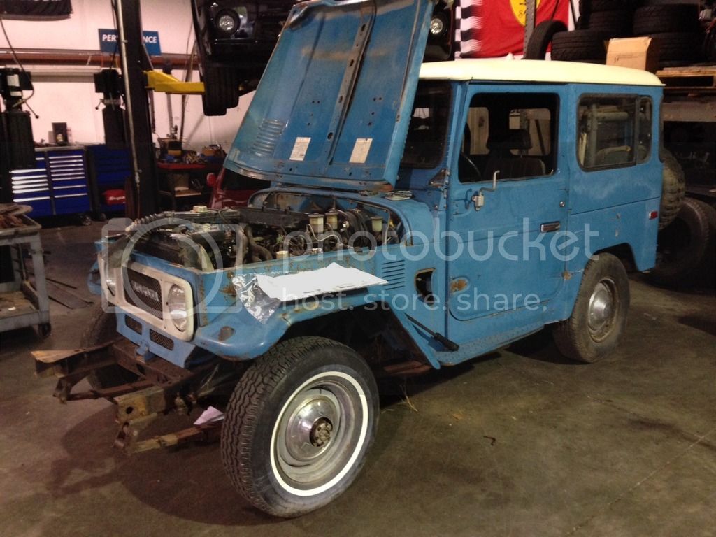

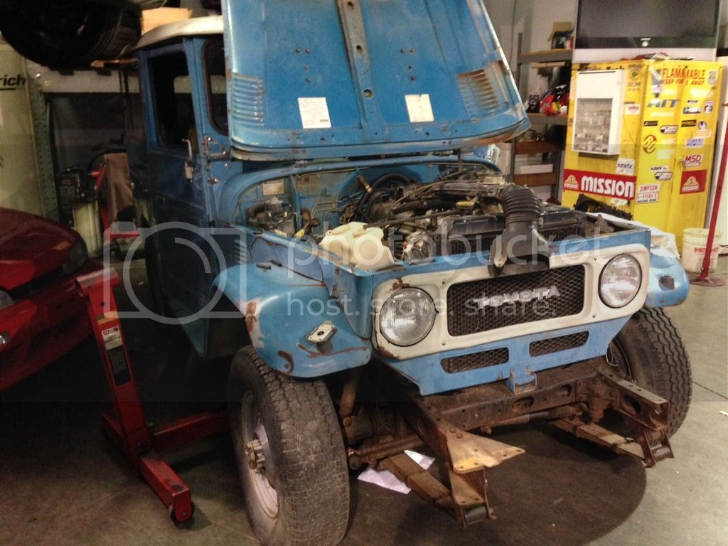

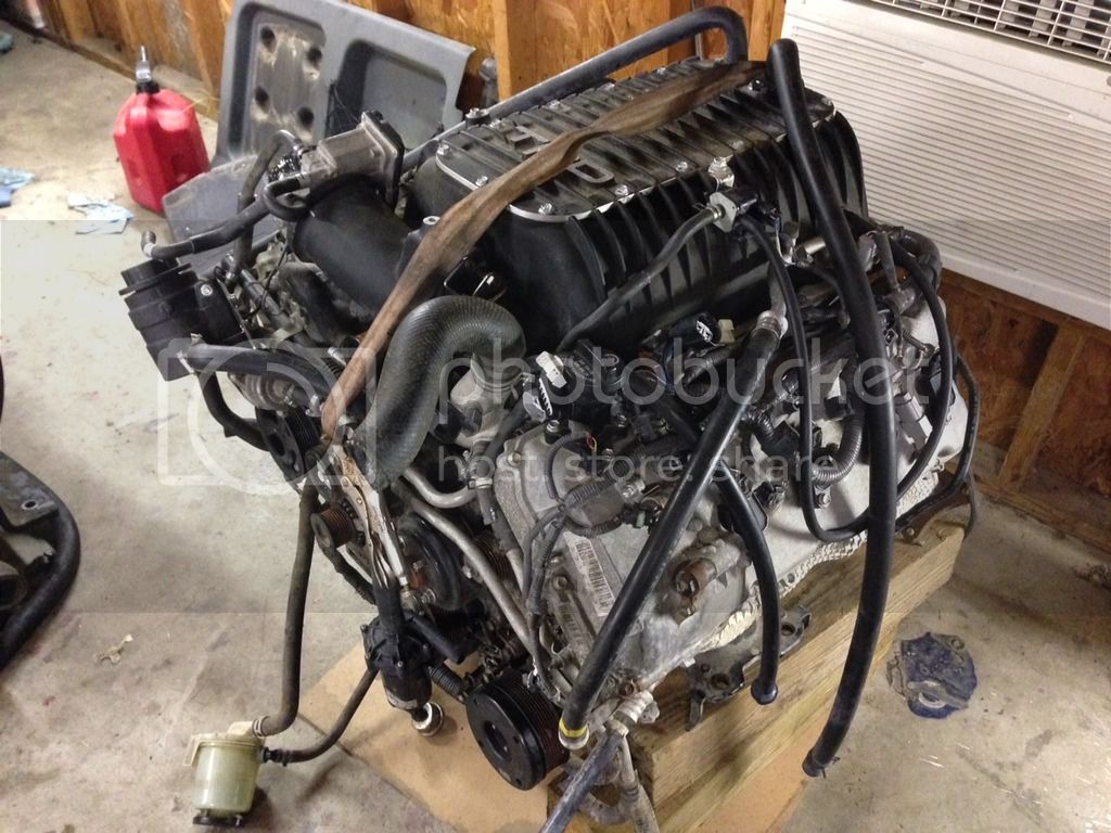

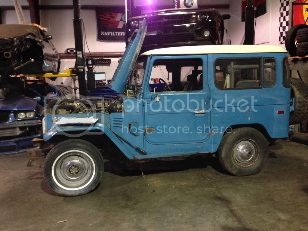

New to the forum. I have been posting to TundraTalk for some time about my TRD Supercharged Lexus SC430 I have been building. Now that most of the crazy R&D has been completed on that project I have decided to start on what I believe to be the ultimate FJ40 powered by a TRD Supercharged 5.7 3URFE. I think the major hurdles in the past on using this motor is the engine management as well as the lack of a manual transmission being available from Toyota for such a swap. Both of those items I have pretty much overcome. I have several 3URFE's and an extra TRD Supercharged so it seems like the right thing to do. Currently my brother's recently acquired 1980 FJ40 may be the recipient of such a powertrain. However, this may change. We will see! Here are a few pics as we get started!

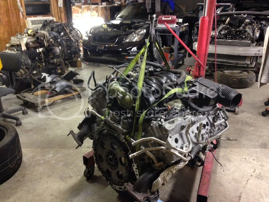

Here are a couple pics of the clutch/flywheel and RWD trans for the Lexus. Need to figure out what trans and transfer case we are going to use in the FJ.
No manual trans for the 3UR is available from Toyota that I am aware of. I am hoping to track down a 6speed manual and transfer case from an FJCruiser. If you all know of any that are not too expensive let me know.
