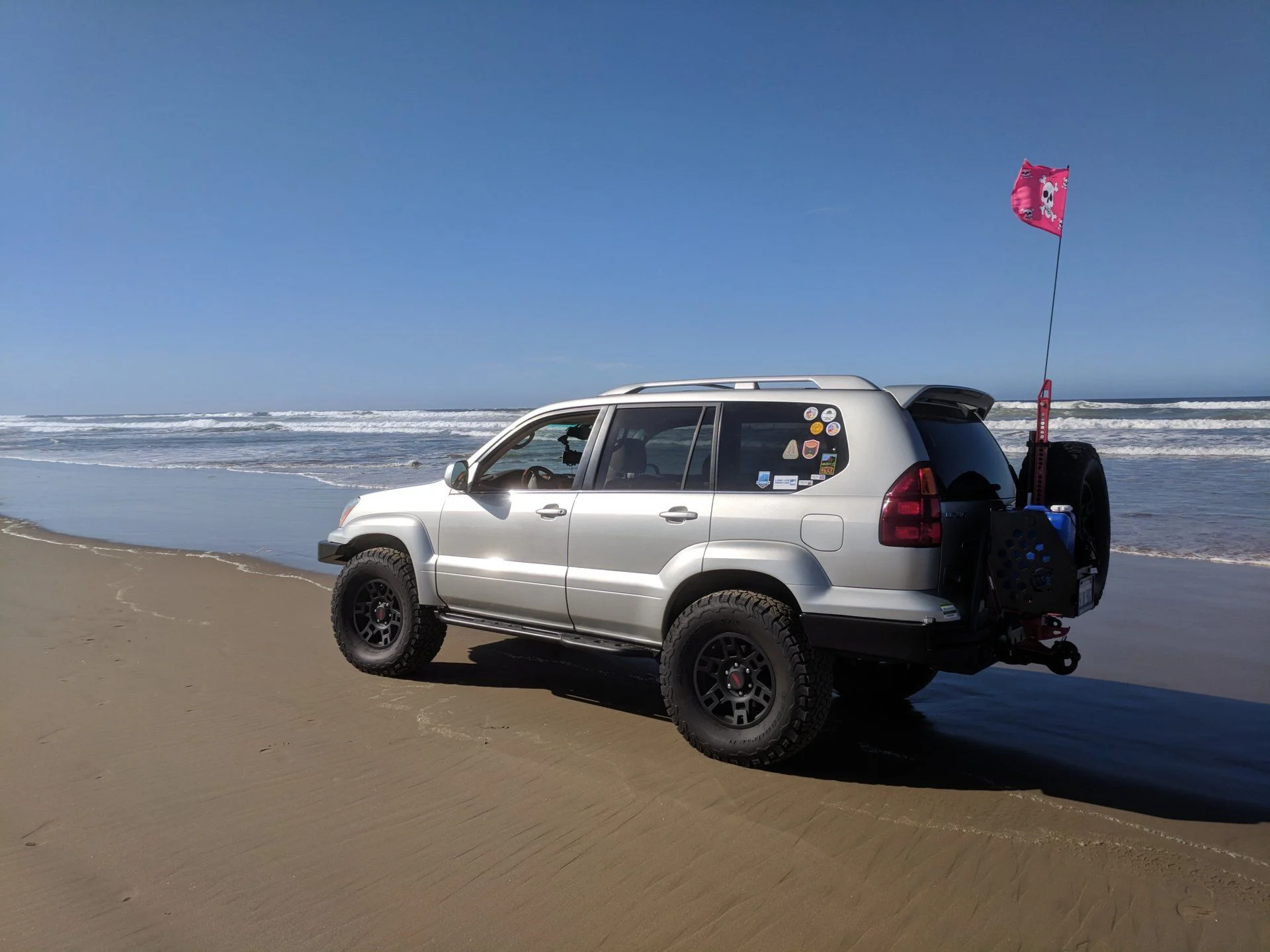

I have these rims in black with 315/70r17s. So stock tires should fit fine.
The official trd pro sema rims are 17"x7 with 4mm offset 4.16 inch backspace. I would confirm that these are your specs. The knock-off version have different specs. I believe they're wider but about the same backspace, so they would work too.
