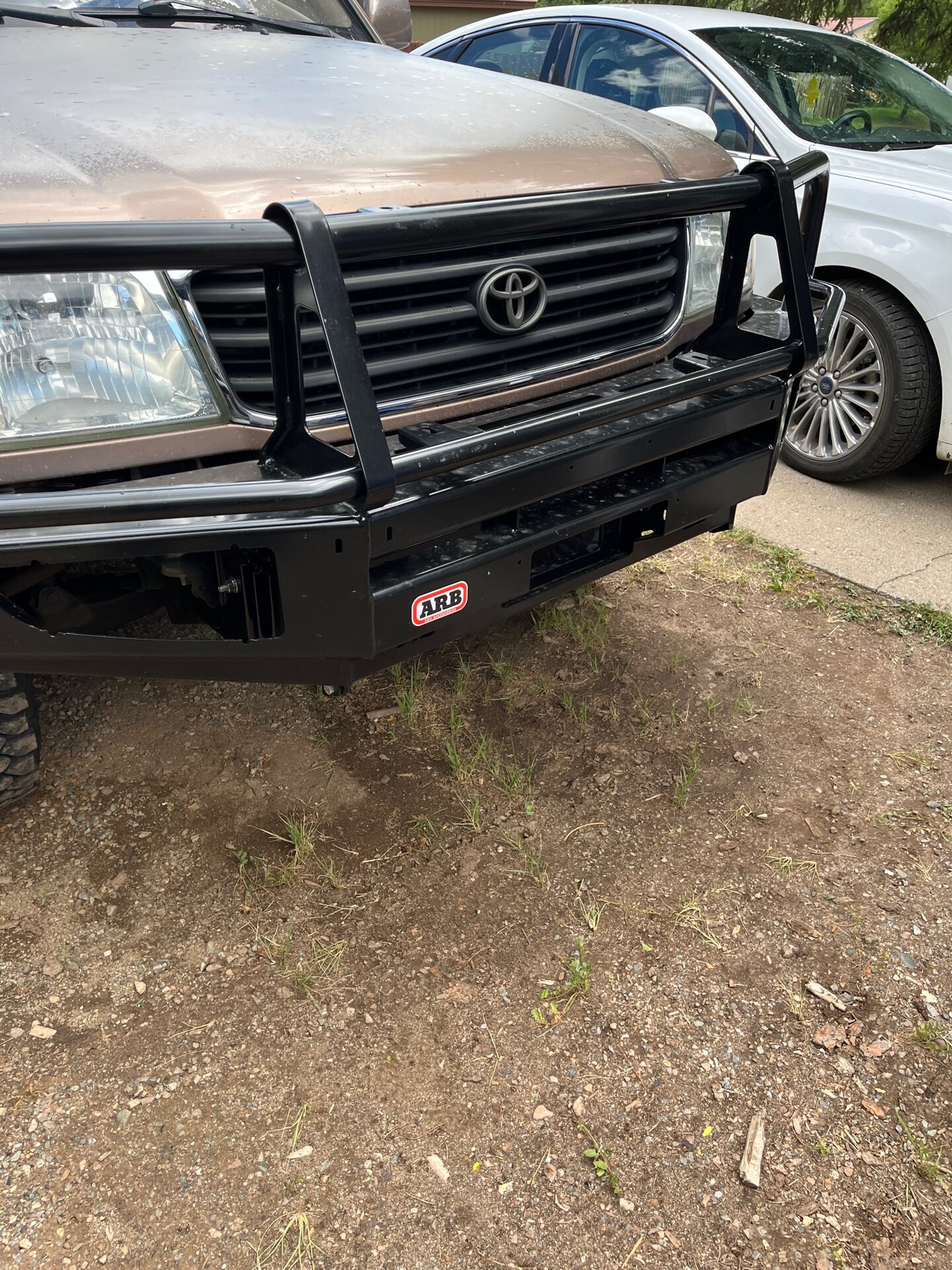

Today I swapped out the old, slightly-damaged grille with a nice aftermarket
unit I got off Amazon as well.
Amazon product ASIN B009DJQJE0
Took the Sombrero off the old bumper (the chrome hadn't de-lammed much at all) scuffed
it up a bit with a scrubby then hit it with some self-etching primer then a couple coats
of ceramic cast coat iron gray.
Looking forward to tomorrow and getting the stance widened a bit!
