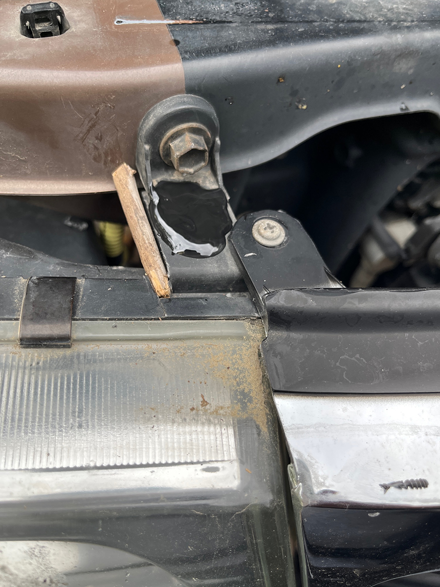

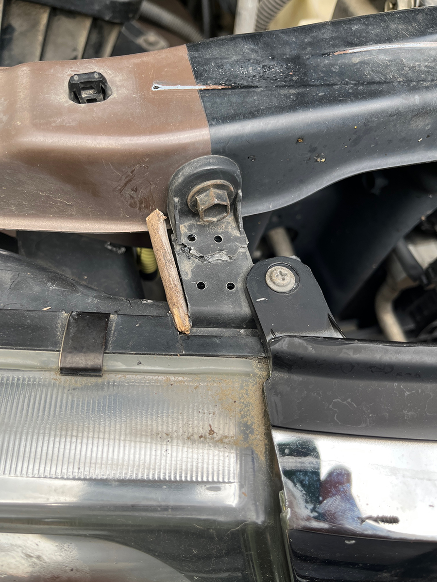

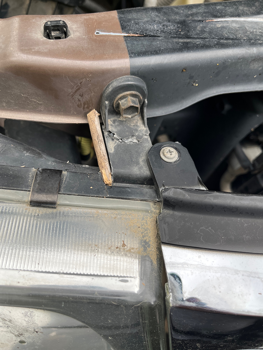

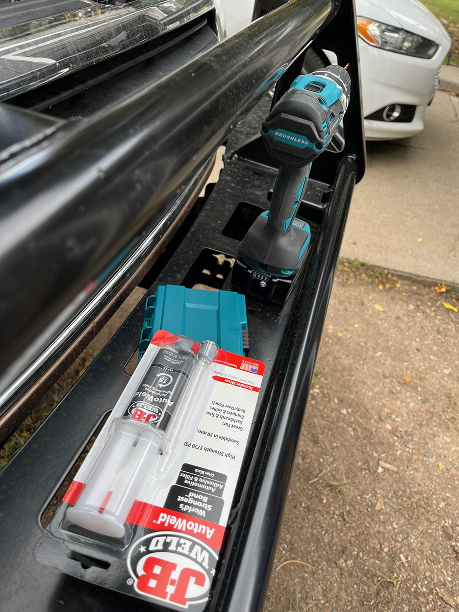

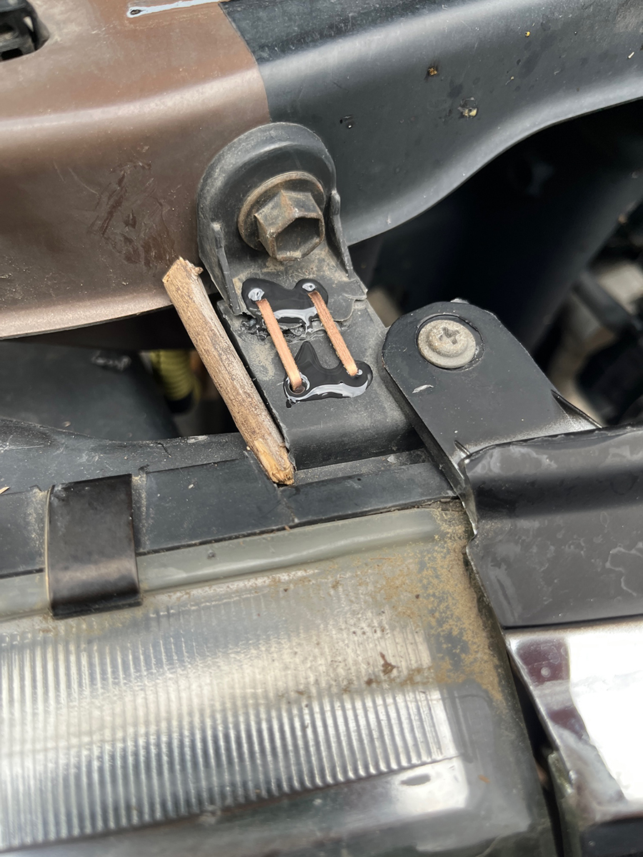

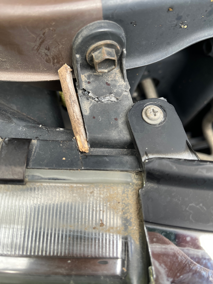

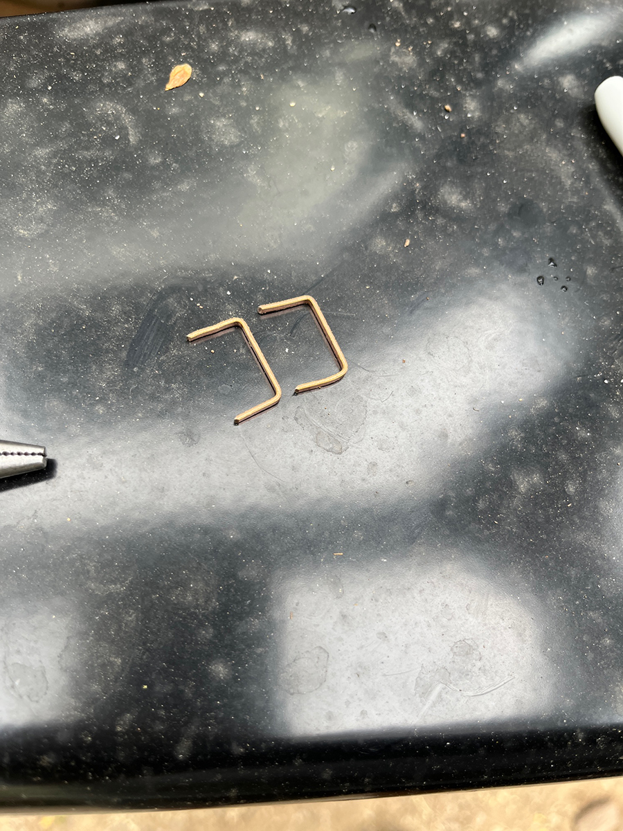

Okay, small little project on the passenger headlight assembly mounting tab.
I've seen this fix somewhere here on Mud but I can't remember where so I can't give full credit to whomever I got the idea from.
Parts/Tools:
- High Performance adjustable stick
- Staples from box my new grill was shipped in
- Tube of JB Weld
- Makita LXT Brushless Drill
- Makita Drill Bit
- Sharpie Pen
I'll remove the Performance stick after the JB sets up.
If anyone knows where I got this from, throw in a link.
Parts/Tools:
- Tube of JB Weld
- Makita Drill Bit
- Sharpie Pen

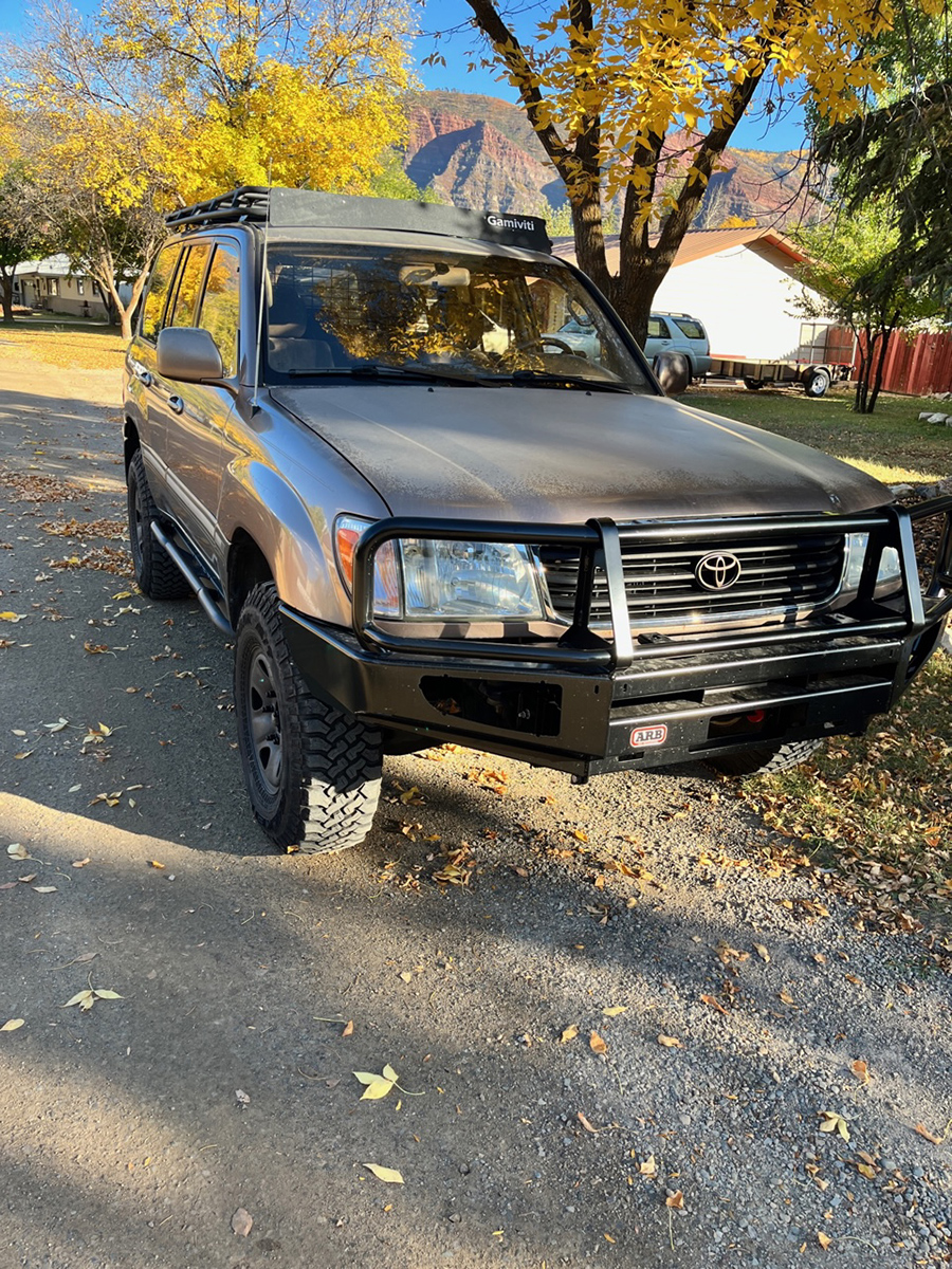

Big Weekend - for my temporarily handicapped ass anyway...
Got the roof rack as far back as it would go. These low profile racks are a little difficult to get
the inner rack to foot bolt along with washer and lock washer. But all settled in to it's new location.
Thank you, new Makita hand tool :) (in preparation for RTT install)
And the big day today:
1.25" Spidertrax Spacers on all four corners and
Trail Tailor Extended Swaybar Links all four corners.
The stance is so much better now, especially considering tall/skinny 255/85R16's just get
swallowed up by the wheel well when mounted to AUS OEM Steelies. The spacers just put
the wheels out closer to the edge of the fender and I imagine it will handle a bit better with
the 2.5" wider track...more stable side-to-side.
On to the pics:

Thanks! I think it looks pretty sharp as well. :)
Yup, metric - at least the hardware that was on there was. I can't speak to whether or not it's what came with the rack but I imagine so.
