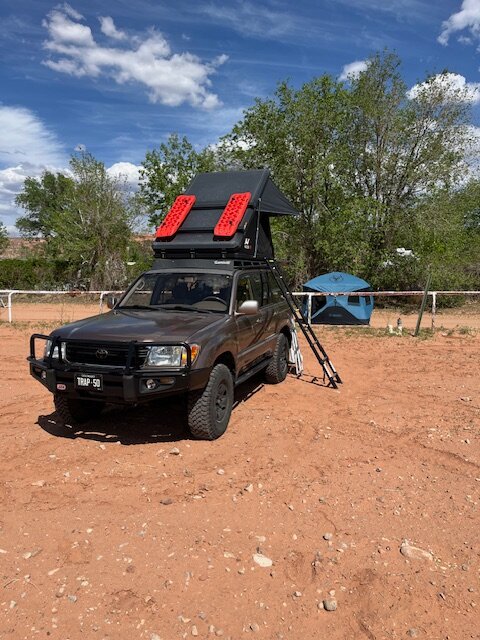

It's really nice to have 95% of a ROOFNEST for 50% the cost. It's held up real well and it deploys and closes really quick and easily.
The only tough part is getting the awning rods off without the rod straightening upon release and hitting the truck.
If the trucks paint was in perfect condition, I'd be pissed about scratching it but the way it is, it's no biggie.
Between the RTT and the Gazelle T3X, camp is set up really quick. It'll close with SOME extra bedding in there
but not a lot. We ended up just latching the hook of the hatches but not completely closing them a couple times
but they never came loose.
