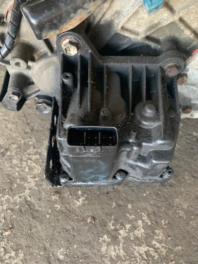

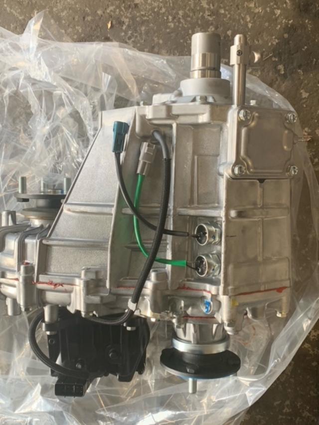

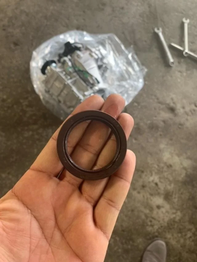

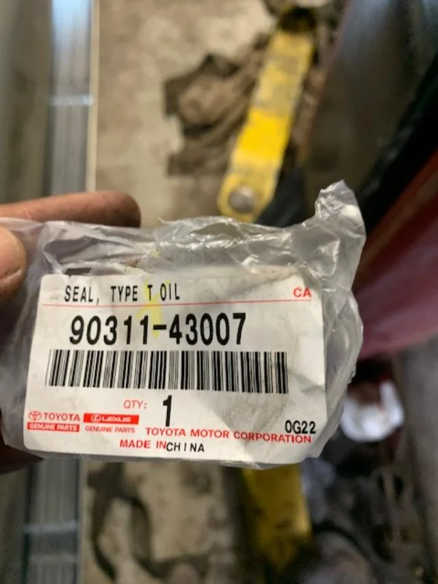

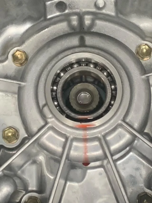

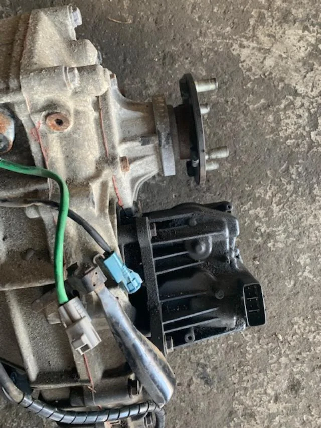

I went ahead and purchased a new Transfer Case from Lexus dealership for $2780. Paid $ 700 for labor installation. Don't forget the seal that goes in between TC and Transmission.
