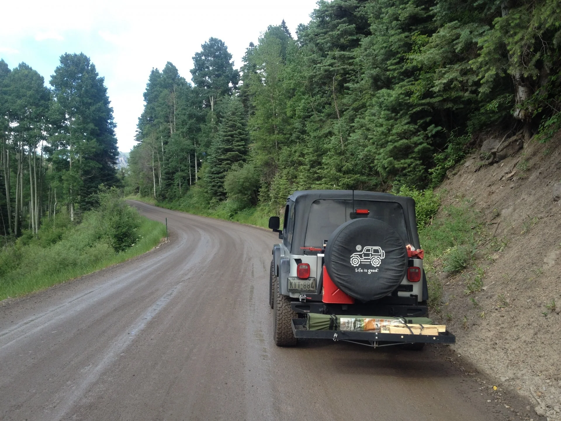

I have something like this which has served me very well over the years. Mine isn't a Curt but is very similar to the design and build of it. Mine doesn't flip up like this one. Someone took the flip up bit off of mine and made it solid. Mine is all steel (no aluminum games), but is fairly heavy as a result. Have had many people run into the back of it with their car not seeing it. Its handled multiple hits from all sides and doesn't even have a scratch on it. I'd like to see someone break it. HTH:
Edit: Heres a shot of it I found when I was using it to haul stuff behind my Jeep:
