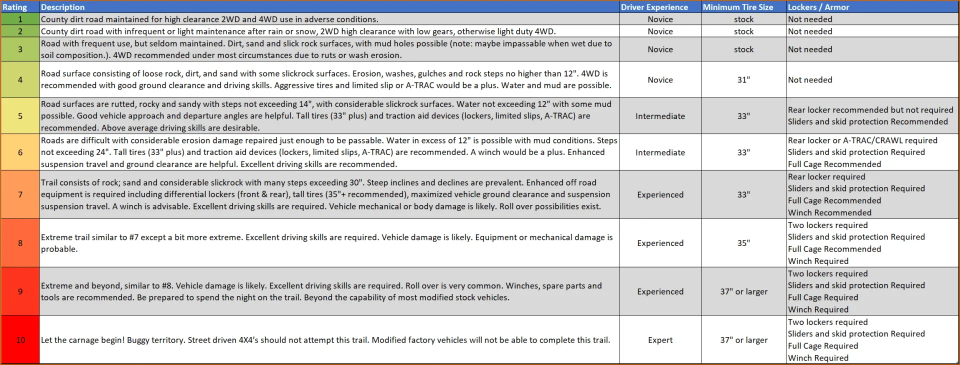

Someone mentioned formalizing trail ratings. I poached this from Cruise Moab and made some adjustments. What do you think?

I like them too but I want a quick reference style rather than a three pages and I like that the chart is used for Moab and others in the TLCA too.
I find myself liking them both as well. What I like about the Mitchell guide is that it doesn’t slice the differences too finely like the Moab guide, but I like SOME of the equipment suggestions of the MOAB guide as it relates to a particular trail class. A lot of this is so subjective and subject to personal experience, driver skill, the amount of help you have, etc.
Yeah I agree. I do REALLY like the quick reference style of the Moab list and I was able to create the adjustable graphic for the "Trail Scale" too and I think it is cool! :geek:
