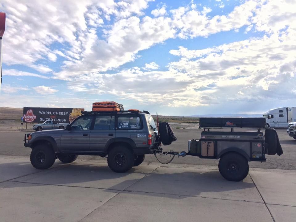

I have been towing my offroad trailer that's roughly 2k lbs (maybe a bit less) when fully loaded, and my wife and 4 kids are typically in the truck with me. We've been doing this for years in a cruiser with stock gears and 35's and now in our cruiser with 4.88's. The 4.88's help on the canyons etc. On rare occasion on the really steep climbs it may drop below the speed limit briefly but it's not bad.
A 100 series will have a bit more power with the V8 but we've pulled my trailer with my brother in laws LX470 and honestly it didn't feel much different than it did with our 80. Didn't feel much extra power and it still slowed down a bit on the big climbs.
