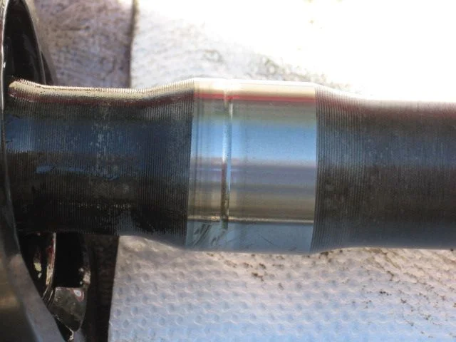

94 80 series front axle rebuild, we've all been there.
right side axle shaft may too groovy for rebuild.
Check out the photos and offer your opinion.

Speedi Sleeve repair
Long, long ago in a place faaarrrr away, I used a product to repair a shaft called Speedi Sleeve. At that time the local Napa dealer was the place to go, but google on speedi sleeve and you'll see many options. Take a look and it may be more cost effective than out right shaft replacement.
