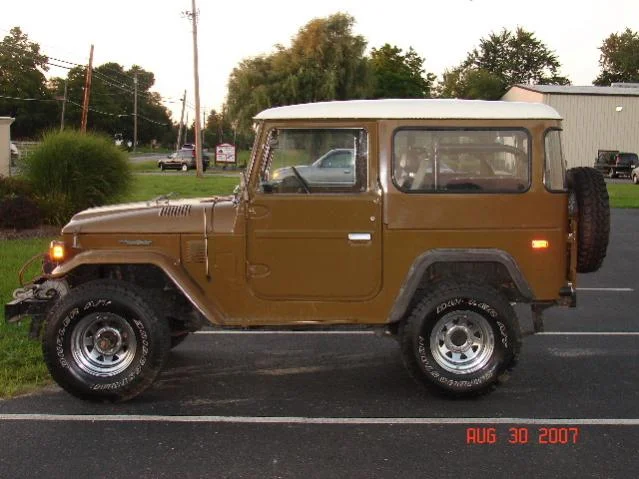

I found some oem steelies and was wondering if i go up from a 32x11.50 to 33x10.50 is there anything i should be concerned about? it has a shackle lift that will eventually be replaced by suspension lift. it seems there will be plenty of clearance for dd duties. thoughts?
I ran my 1980 on shackle only lift and for daily driver status it was ok, Pretty close to the tub in the rear, I only ran it that way for about 6 weeks though. That was a 33x10.50 on stock steelies though, Not sure what backspacing you have on those rims, and what interference you will have in the 1/4 panels or against the steering linkage in the front.

the bfg ko is what i was looking at. if seems to have plenty of clearance on the current setup. i cant see how a tire one inch taller would make that much of a difference. however im obviously new to all this.

That rear looks cut, if that is the case no rub issue on the 33"s DD. I had 33 x 10.5 on my 77 with a shackle lift tired spring and only rubbed on the road with 4 people in the truck and a big girl behind me on the Jump Seat. I hit a bump on the road and did not have heart to tell her it was her fat ass that made the tire rub.
Just a minor factual point, but the 33x10.50 is way too wide to mount on a 15x5.5" wheel, according to the tire fit chart from BFG.
OTOH, they would be very solid on the 15x8 wagons shown in the picture.

the dilemma is that i really like the look of the oem wheels. i would like slightly larger tires without going wider. desired tire size (33x10.50) is getting hard to find in 15inch. haven't found 16inch wheel that i feel has the right look for a 40. am i looking for "atlantis?" should i stick with what i have? suggestions...
One of the few times I'll disagree with Jim :p: I think the 33x10.5 BFG works fine on the stock hub cap wheel. Yeah, I know what the charts say. I also know how the combo seems to work well for many of my friends on their Cruisers. So I guess the choice is yours... Either way I think that tire will fit your truck as is for DD duty.

I know it is not advised to run the 33x10.50 on the stock wheels but I have about 3 or 4 thousand miles on this setup, I run the pressure pretty low, about 28 psi in all 4 tires to keep the rims from crowning. any more than that and I get some wander in the steering on bad roads.
