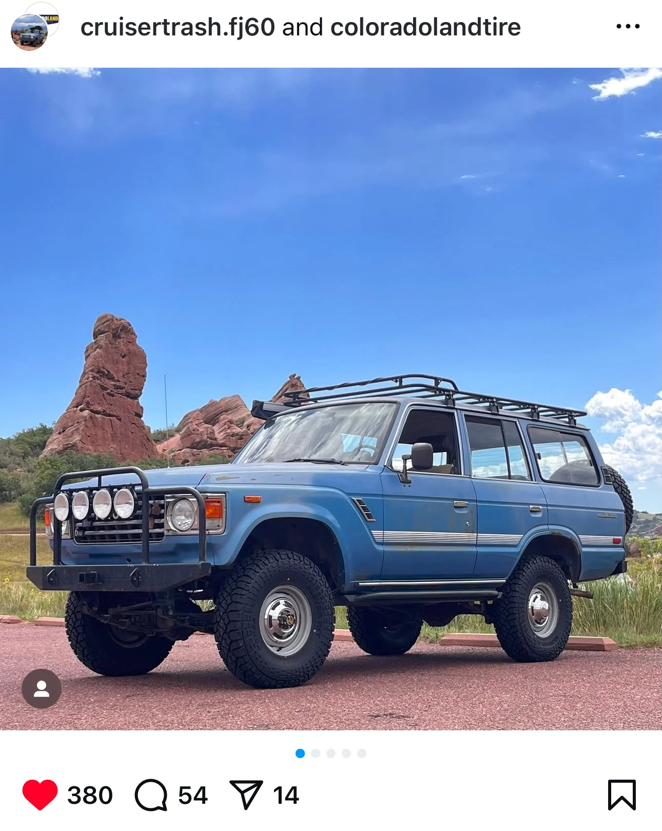

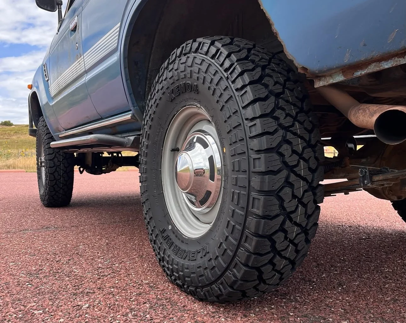

Alright man, post some pics. I need to see these!
Just ordered another 5 for customers 40 here in KC. Perfect stance for any 40/60…Availability becoming an issue 😡
📸 @CruiserTrash
FWIW, for anyone interested in these, I'm still loving them on my 60 after a year and I think they'd be great on a 40. Much quieter than MTs despite the big tread lugs, and no chunky feeling on the road like MTs. No perceptible hit to fuel economy. Great in the rain due to the siping and they performed great all winter here in Denver. I was worried about ice but they do fine. Not as great as a dedicated winter tire of course, but they were very sure footed within reasonable expectations. Certainly better than any highway or MT tires I've had. Only Duratracs have been better for me on ice, and not by much. On the trails here in Colorado the Klever RTs have have been the best tire I've ever run. Our conditions are dry and rocky so my experience in heavy mud is limited - we don't get into much bogging here.
