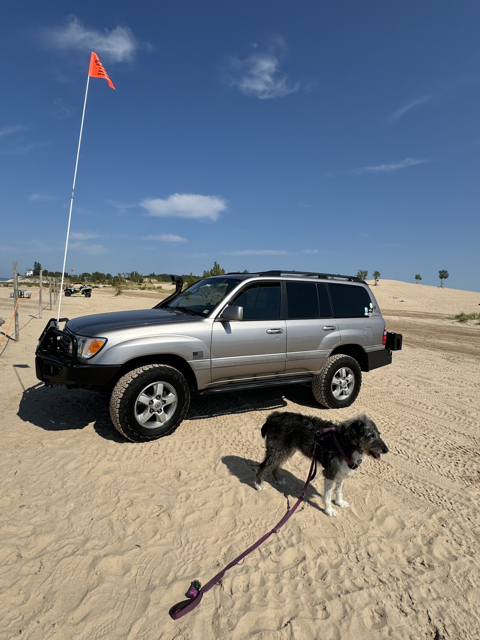

Just an update, just got home after spending the afternoon at the dunes. I admit, I did check out from doing the test Hill. Ran the rest of everything in for low with the center locked at about 12 PSI in the tires.
A couple of these smaller hills after the Whoopie’s, Towards the north end of the park, almost got me, however, with constant throttle and some sawing I made it up and over OK. I saw a few new Ram test trucks trying to hills as well and a couple got stuck in needed rescue.
Thanks again for everyone contributing to this thread, I used all the tips and tricks that everyone recommended here which made my time a lot more and less stressful!
