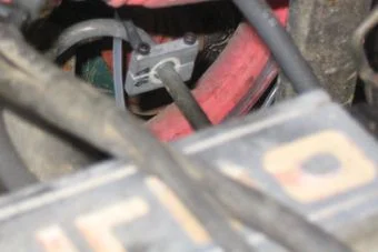

Just hooked up a "tiny-tach" on my 13bt.
Installed easily/quickly and no calibration needed.
warm idle is about 655+/-
pics are of display and transducer mounted on metal fuel line.
This thing was like 65 USD
I got the 1/4" "PN: DTT-1/4" size, it fits well but could be a hair larger. But a week so far and not an issue.

I read the site but I am assuming it attaches to the #1 injector line? it must get a pulse signal from the line? Very easy to install!

chet, the manual does not specify a certain line to use. It just must be unpainted metal and a straight section.
Usually while revving, there is no lag. Occasionally coming to a stop, it will switch to the hour heter display for a second, then go back to tach. At warm idle, it does fluctuate between 648-660 usually closest to 655. Not sure if that is the tach or the rpms doing the fluctuating. Is that a normal range for a 13bt?
