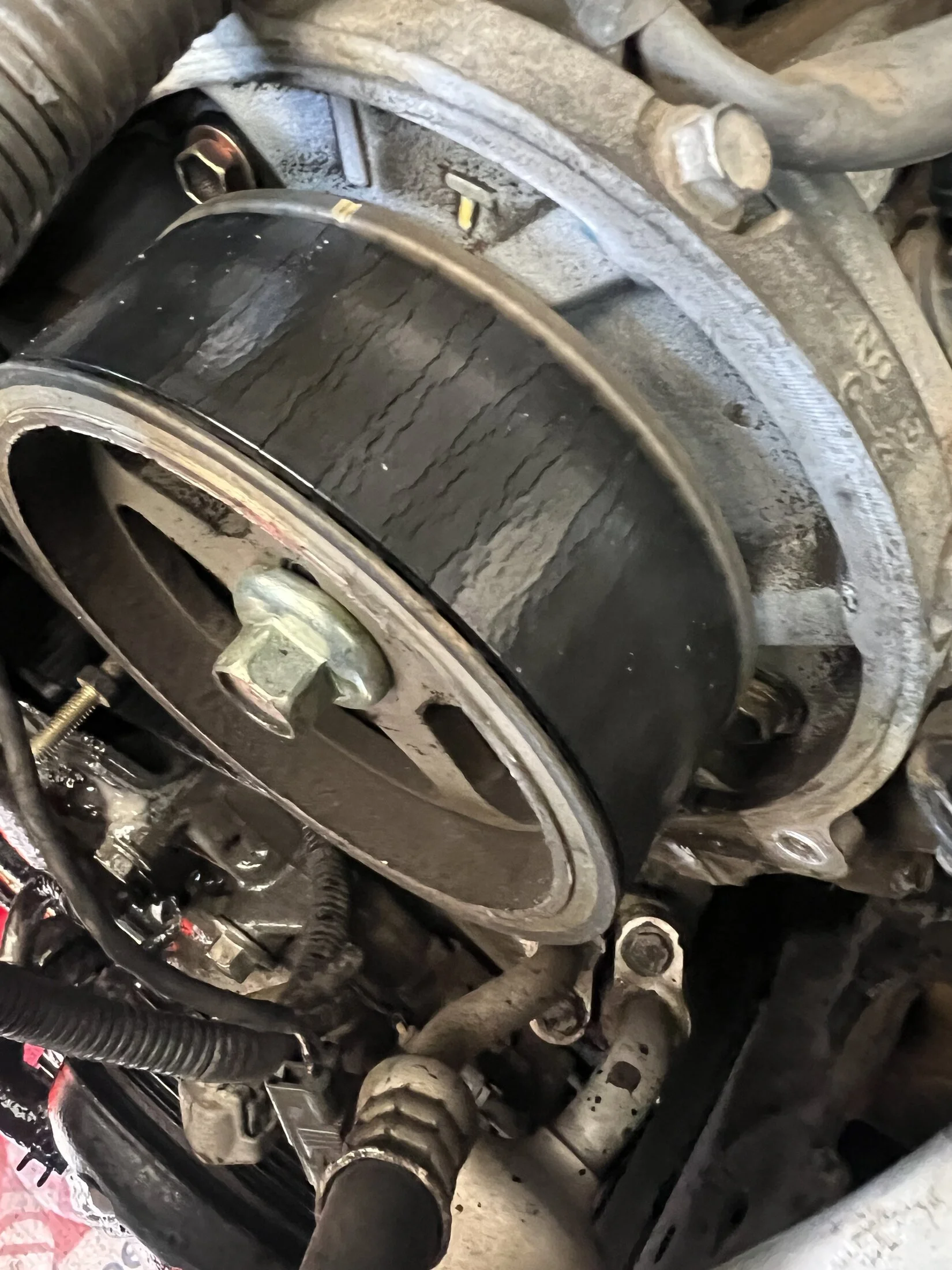

Bought a 100 series and 1 of the big question marks for me was when was the timing belt done? After fluids and tune up, i tackled it this weekend. Check out the condition. I believe it may be the original at 237k miles.
So now that i have finished my second timing belt on a 4.7, my cruiser wont run. It starts and immediately dies. Any help?? Any guesses?

I’m guessing you had the battery disconnected for a spell, it’s common for those engines to wake back up grumpy having to relearn idle and possibly not run at all. Usually a good throttle body cleaning will have that thing chugging like a champ.
Usually if this happens I like to disconnect both battery terminals again link the pos and neg terminals with a small wrench or screw driver to wipe the computer memory ( keep the terminals away from the battery so you don’t arc off of the positive post on the battery cover the positive post with something, after you’ve disconnected battery and connected the wires to one another ( safely away from positive batt post ) clean the throttle body ( off manifold is best but you can do it on the manifold, but I don’t like all the junk falling into the manifold ) after the throttle body is clean reconnect the battery when the engine is 100% cold and let it warm up 100% and you’ll be good.

That is the crunchiest TB I have ever seen. If it’s original, that speaks volumes about OEM durability. That belt owes you nothing.
