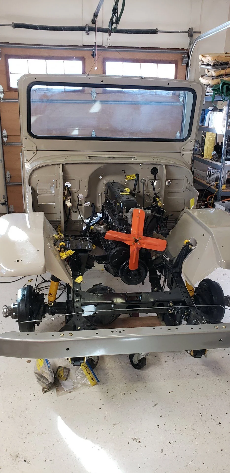

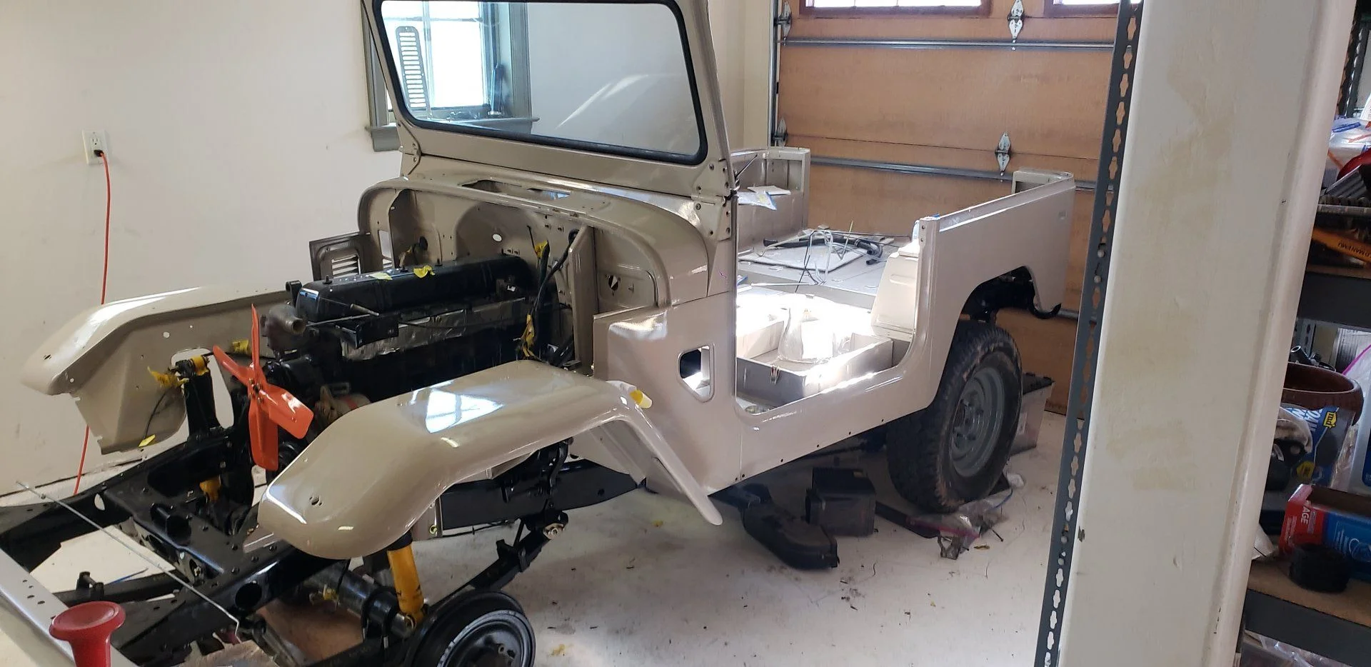

Thanks for the info, I read through the threads, I will post some more pics specific to my situation in hopes that we can all reach a consensus on the best path forward. Just for reassurance, my buddy with the collision center that is helping me with the frame, this is the garage at his house:

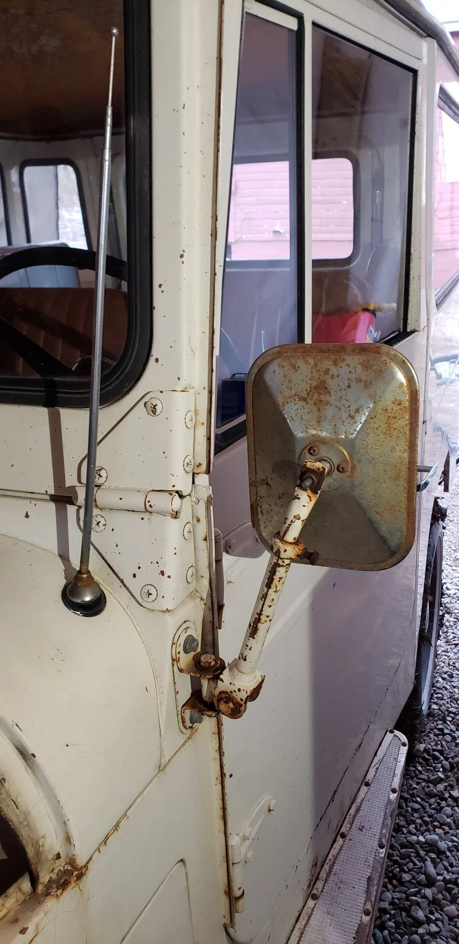

Appears to be a factory mirror. Driver's side only, nothing on passenger side.

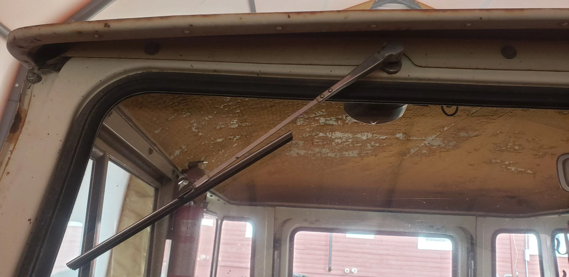

Such delicate windshield wipers.

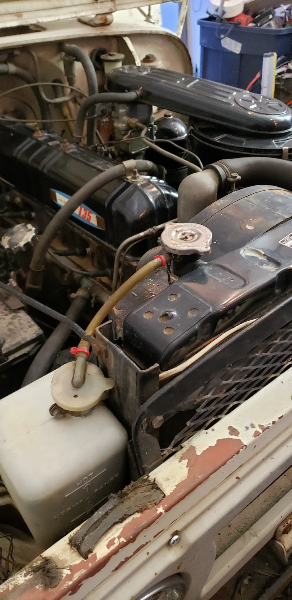

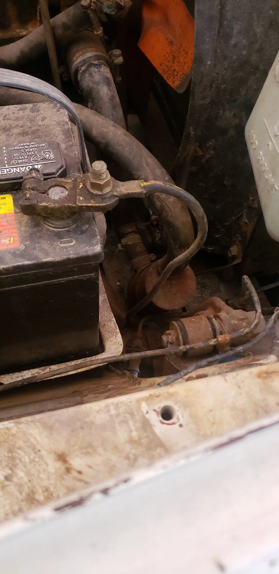

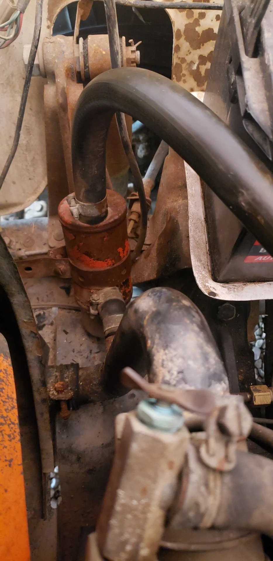

Those seat covers are definitely originals. The red canister is likely a Engine block Heater for keeping the engine warm in extreme cold when sitting. I’ve seen a few in my early ones over the years.

That is the horn relay with its cover, score. The “L” Elephant Horn is the low frequency horn, score, the missing one would have an “H” for high pitch frequency. Brake master’s been replaced, still has original tin cup clutch master, score. Remnants of the original hood pads are still there, they are of some fabric sort vs. the solid rubber replacements now available. (JP’s @ClemsonCruiser mom might be able to make some for you, 😂). Wipers original, score, heater shutoff valve original, score. Etc., etc., etc. Yeah, that’s a score!

We are on the same page with preservation. My vision for this is to gently correct the front corner damage 1mm at a time. Then all new rubber bits throughout including the cooling, brakes, seals and even the suspension bushings if they can still be had.

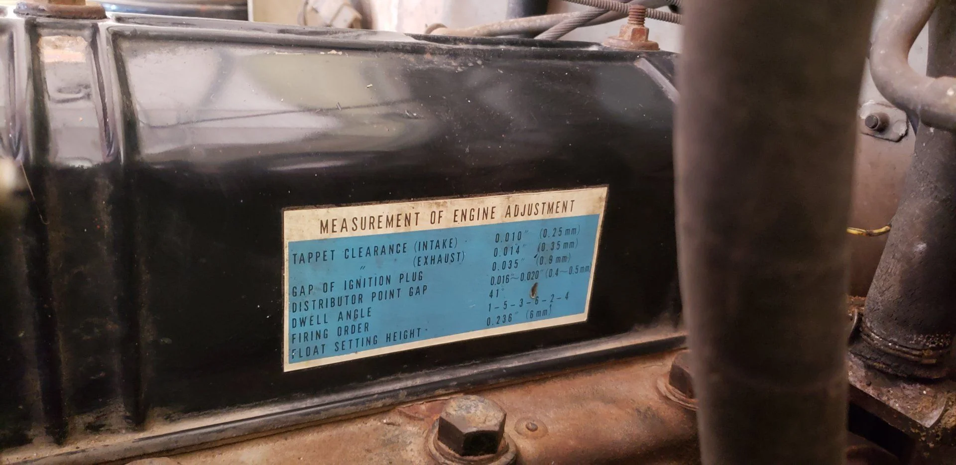

@whitey45 and ClemsonCruiser when did the larger window carburetor end. I went thru a bunch of different carburetors on my 68. Came with a Carter one barrel in 74. Back in the nineties I finally ended up with a small window one barrel that the wrecking yard had tagged as from a 66. Next time I'm around it need to check the date. I know it was the first time I had to wire an idle solenoid. I sure where but now have three more small window carburetors. Interesting the 10/67 has a smaller window than the 12/67.
I also thought that starter ended around 65 when lug nuts went from 23MM to 21MM and the cool hand primer fuel pump went away.
