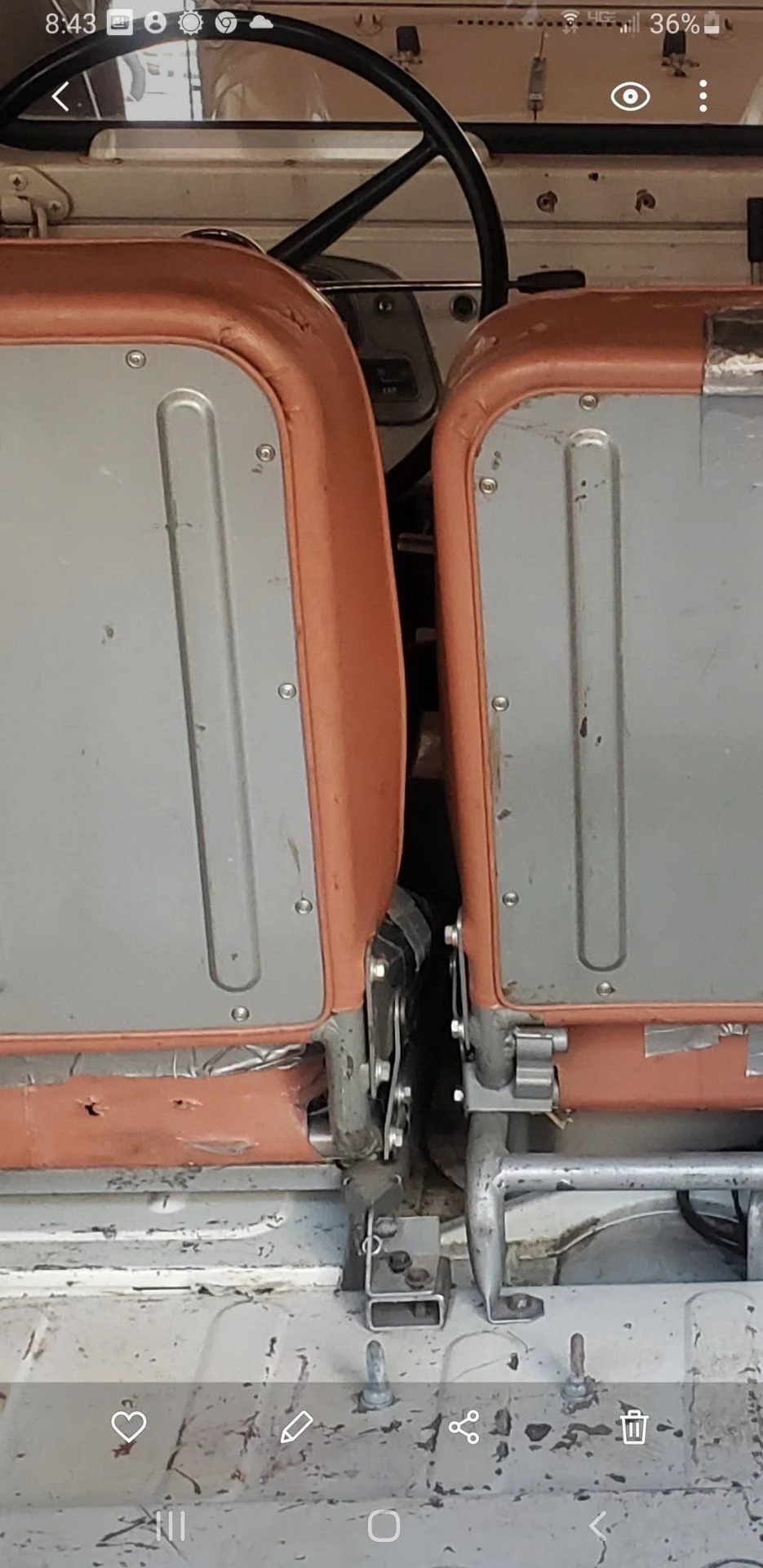

looks like a solid, super original truck. I have the the ‘66, same coral seats. Keep it this way.
Are you saying those seat vinyls could he original? I don't see any tool marks on the screws now that you mention it, plus there is a color matched piping on the metal backing.

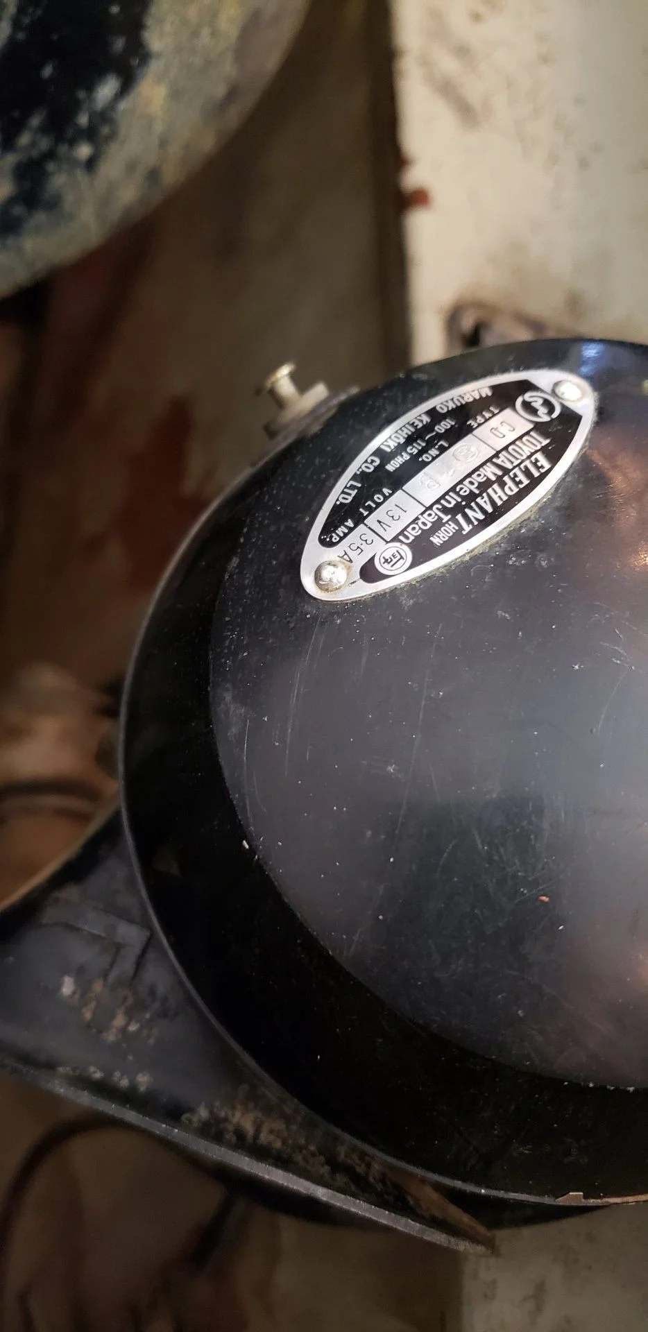

The horn seems to missing it's mate.
That one has an "L" embossed on the lower housing, assuming there should be an "R". There is a wire there, but no horn.
I think this is the horn relay, the mounting screws are not there for some reason.
