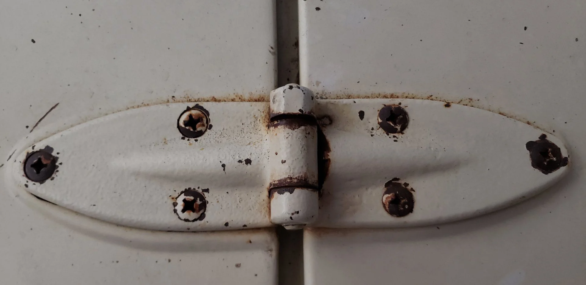

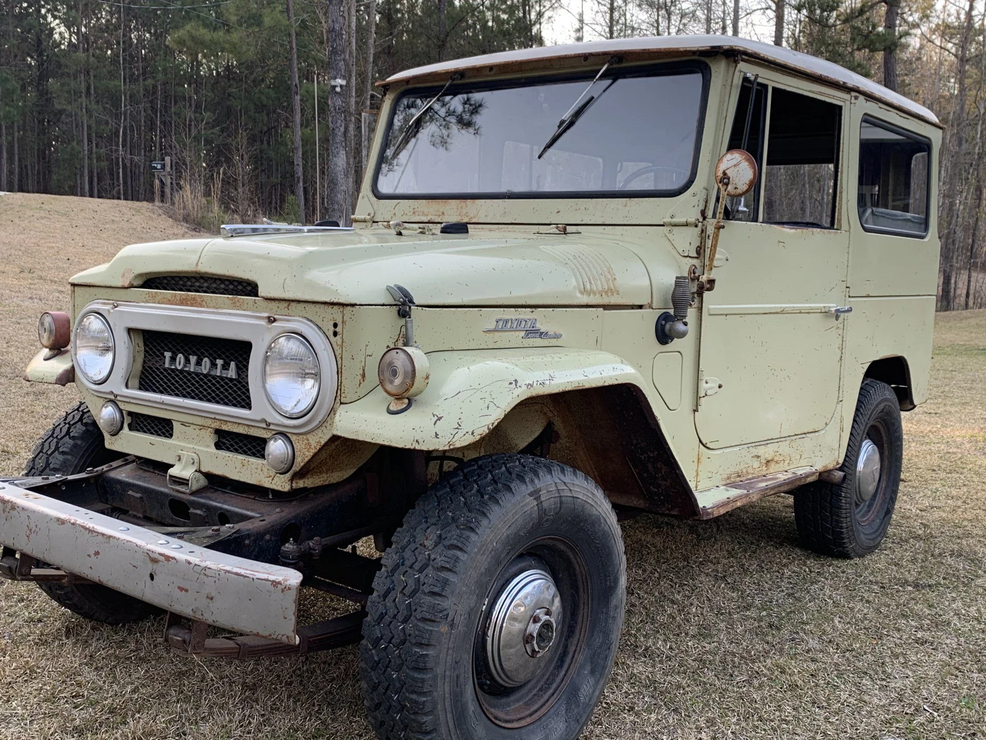

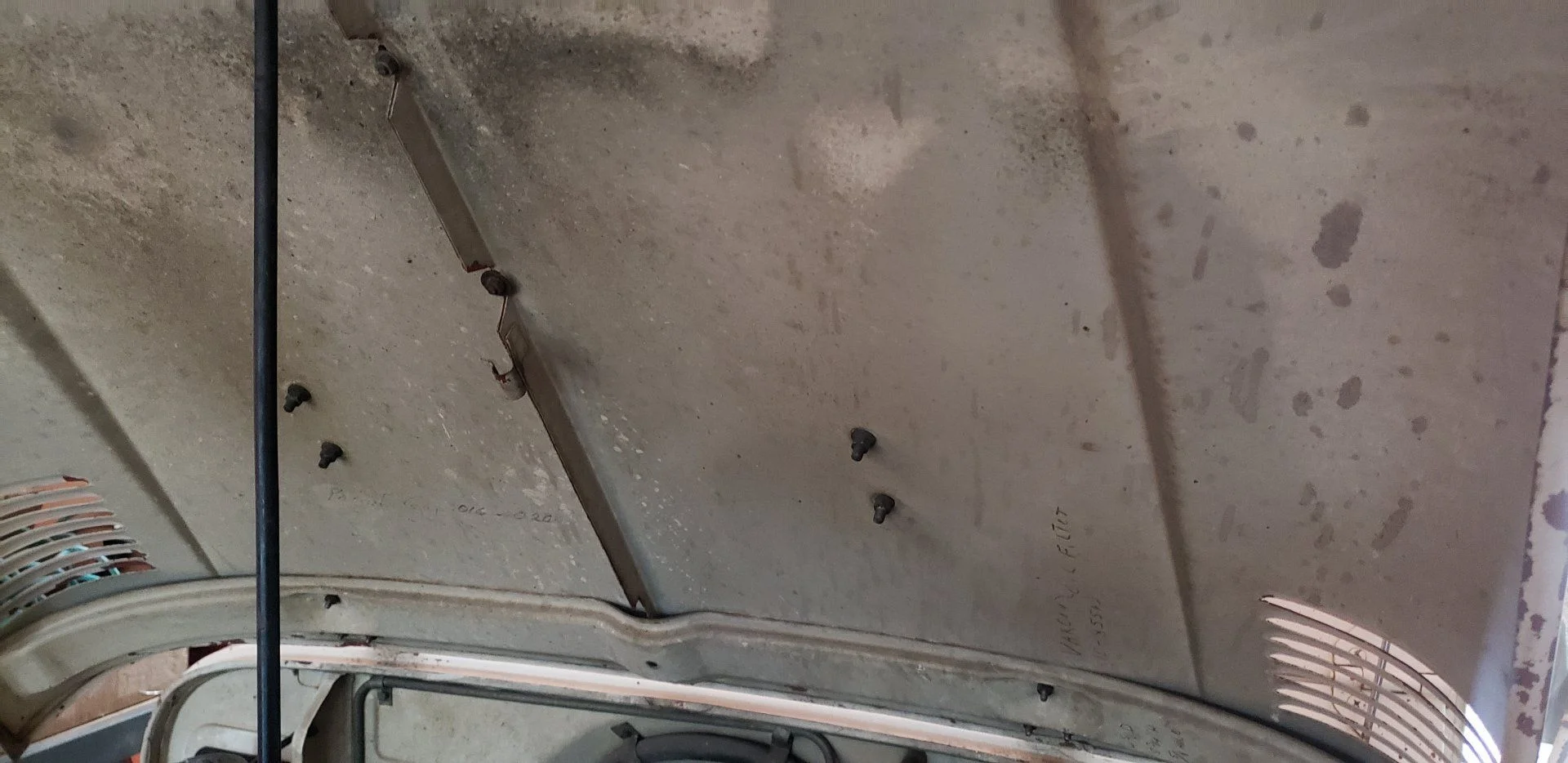

Why no hooks for the windshield on the hood? Aren't there factory catches on the windshield for them? That hood bumper style is unobtanium... Be careful with the studs if you ever remove them.

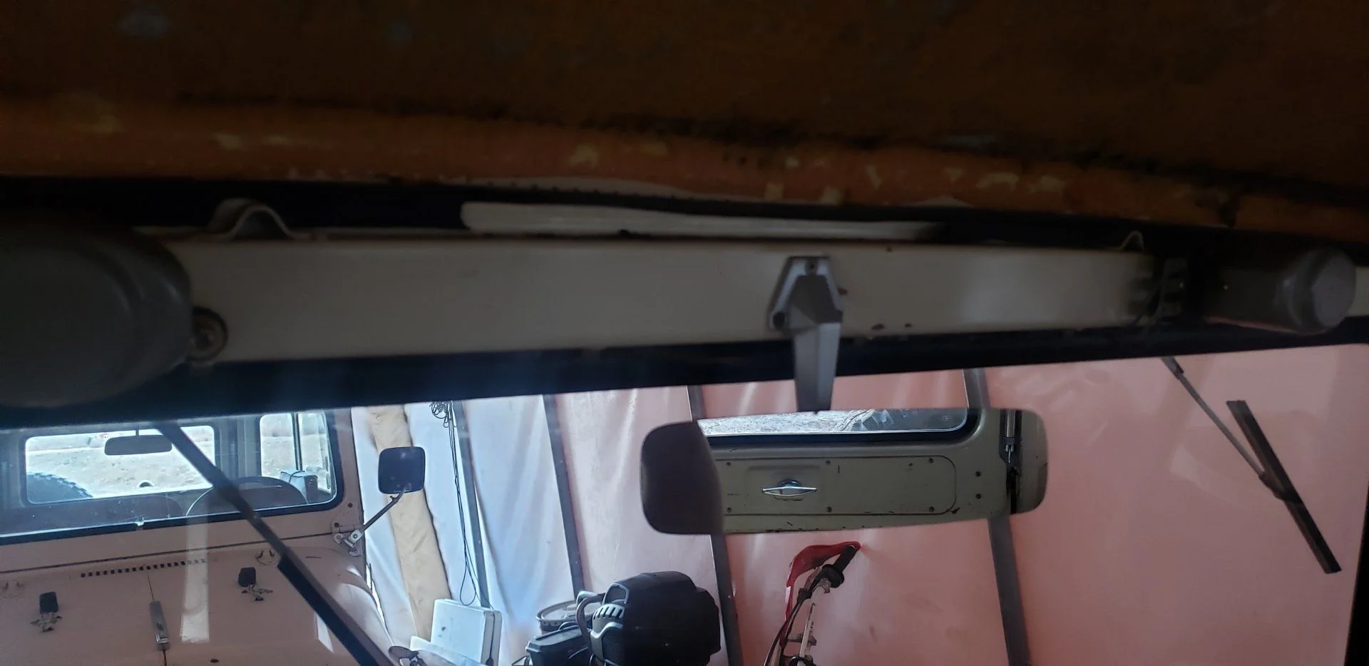

Stay tabs are present on the windshield frame.

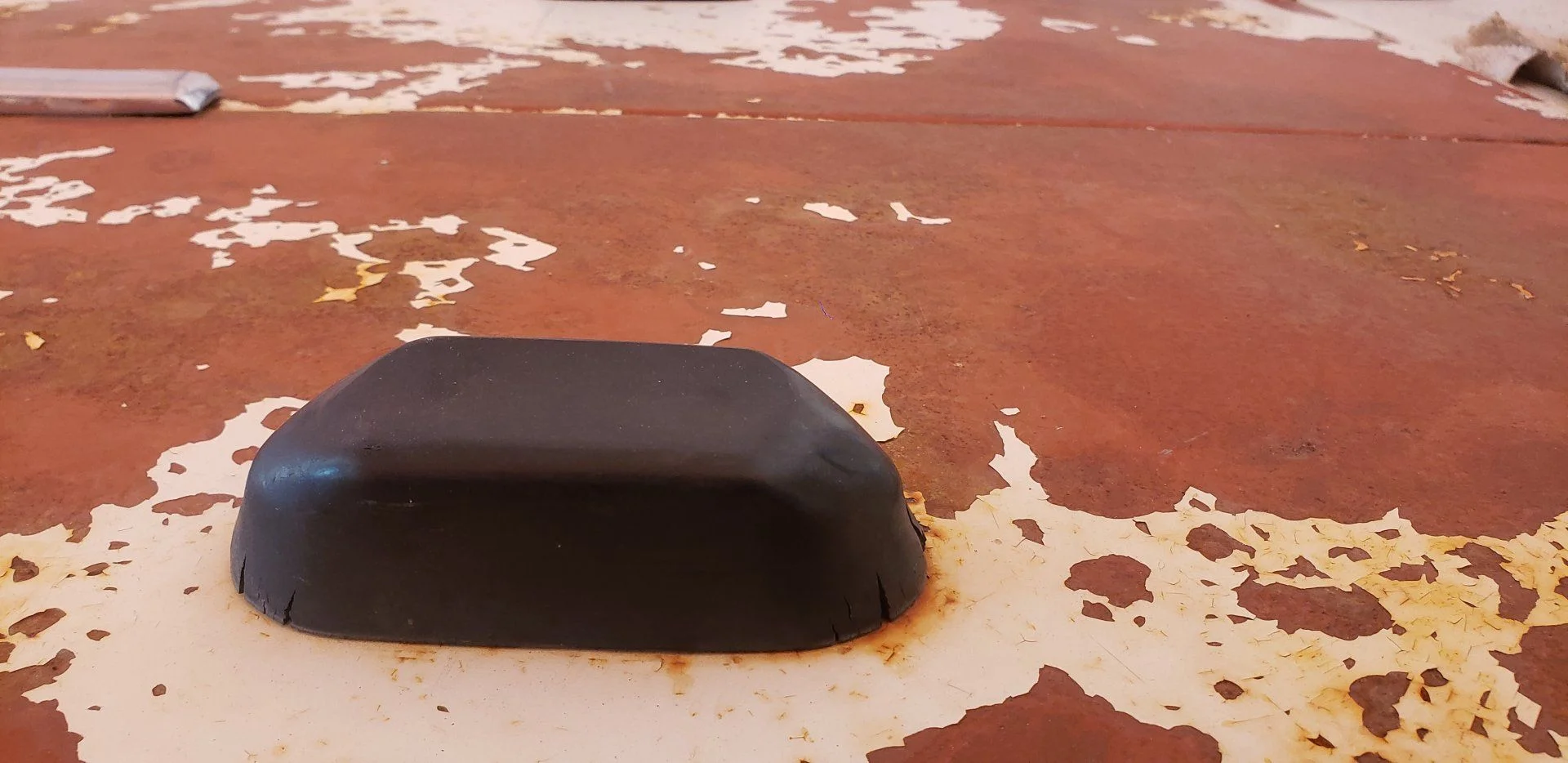

No stay tabs or hooks or holes for them on the hood.

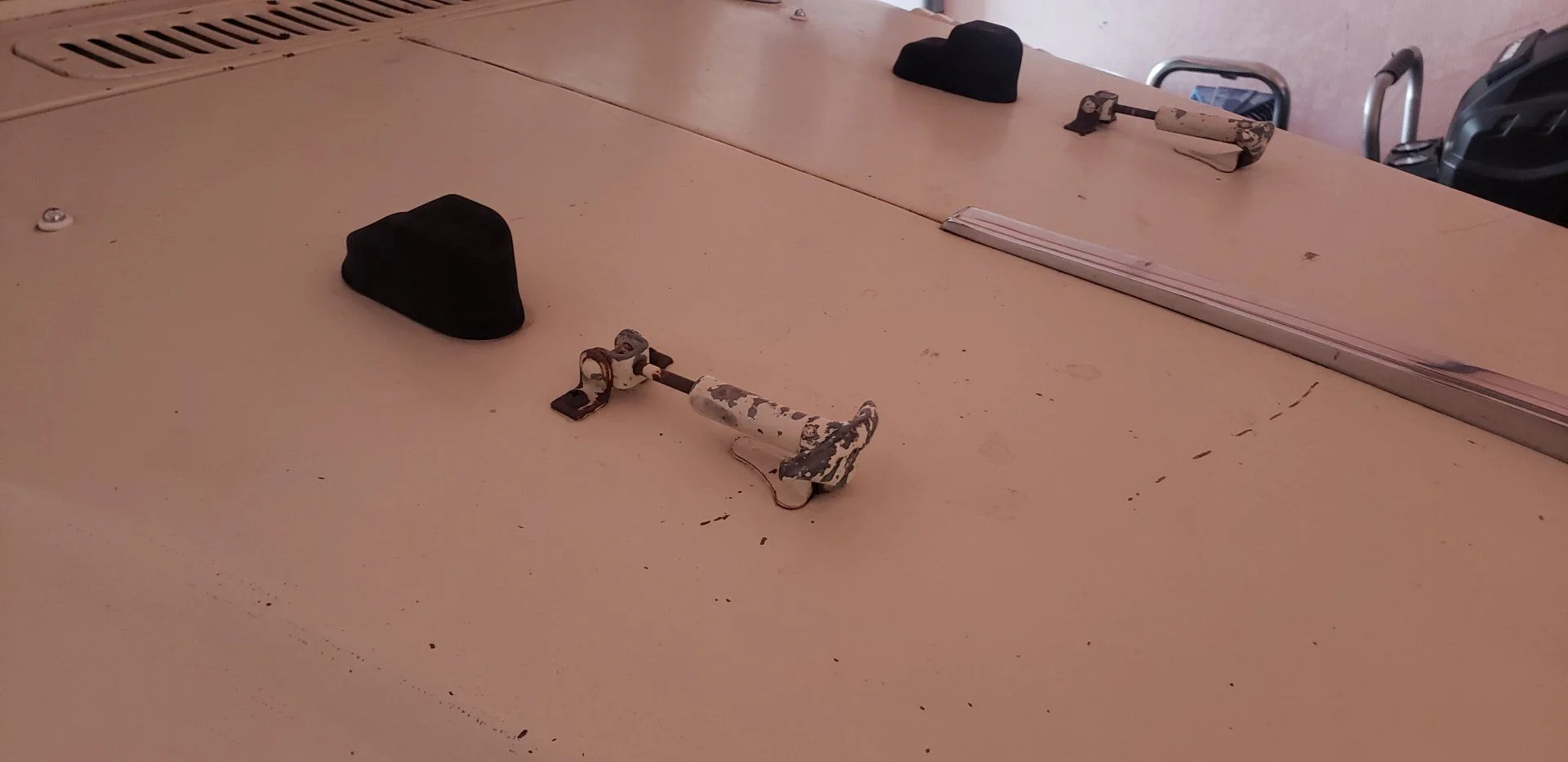

My '71 hood for reference.

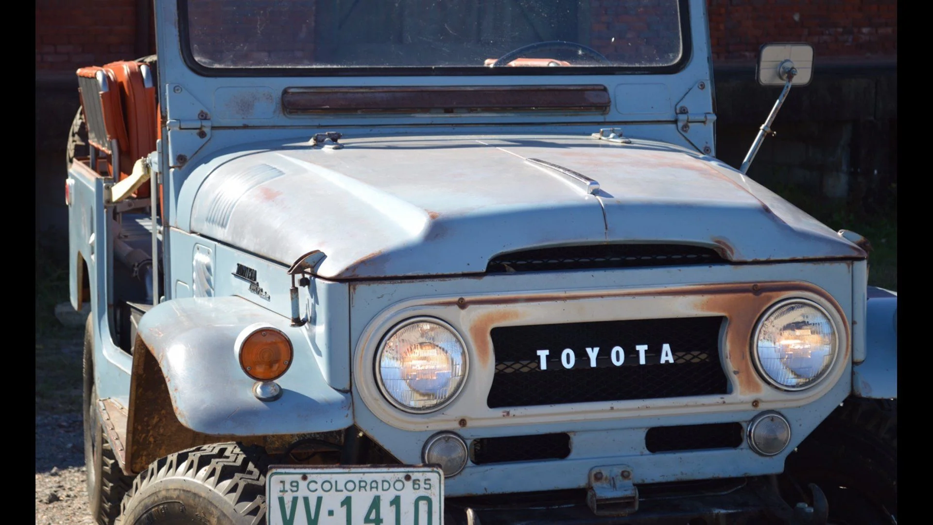

I’m wondering If that hood and driver fender were replaced at some point. Any hood after ‘64 should have the windshield catch hooks with LVs being the exception. Also that might explain why the paint in those areas aged so much worse. Also along that front in the mid 60s Toyota used a base primer of red, then gray, before the final top coat color. You can see it here on my ‘64 original paint.

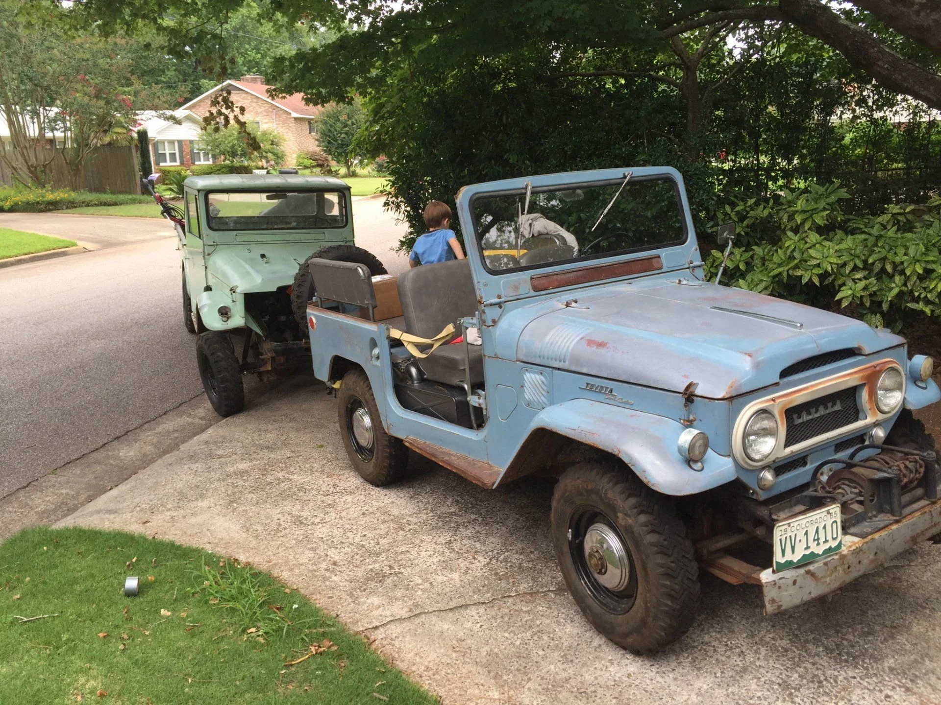

I’m wondering If that hood and driver fender were replaced at some point. Any hood after ‘64 should have the windshield catch hooks with LVs being the exception. Also that might explain why the paint in those areas aged so much worse. Also along that front in the mid 60s Toyota used a base primer of red, then gray, before the final top coat color. You can see it here on my ‘65 original paint.

I think you just got to the heart of it. Excellent information, thank you.
Just got off the phone with Brandon over at Classic Cruisers in Poncha. Sounds like they have the correct vintage and color and patinad body panels I need. I think these panels should be replaced for two reasons:
1. They have already been replaced but are incorrect.
2. My friend with the Collison center really wanted straight panels to work with too as opposed to repairing the existing ones.
If somebody has some reasons why I shouldn't replace those panels please speak now.

I'd bet that Toyota ended their 45LV, or fixed-top 45, production run ('67), but didn't know where to unload the extra hoods. So, they sent someone out with a hand drill and poked some holes for bumpers, but didn't want to spot-weld thru primer for the catch-hooks stay-tabs.
Are you saying the earlier hoods shouldn't have the rubber pads either?
Only Factory Softops came with hood bumpers and hooks up till about mid to late ‘64 with the arrival of the removable top 45s and the non corrugated 40 hard tops. All models except the LV from ‘65 and up had the hood bumpers and windshield hold down latches.

I’ve had a lot of original paint Cruisers front the 60s usually the paint fades from the body color to the gray then red underneath not the blotchy patch work like the hood on this ‘67. So I’m fairly confident it’s a replace and repaint job.

I'm certain it's a repaint job on replacement panels. Those panels are going to be replaced again, this time with the proper antique pieces. I wonder if it was crashed again after the first repair job because of that front corner being pushed in? So far I'm ok with the damage because I feel it has contributed to it's low mileage and it is repairable.

Guessing the hood, apron, fender and bib are all off an earlier 4X series and someone just drilled the holes for the pads. Those four pieces are the ones the paint is peeling. For the shock tower to have that far body took a pretty hard hit. Wouldn't be surprised if more than just those four body pieces came off the donor. Was a time 40 series were not that hard to find in wrecking yards. Eighties and nineties I collected a lot of parts off 40 series.
