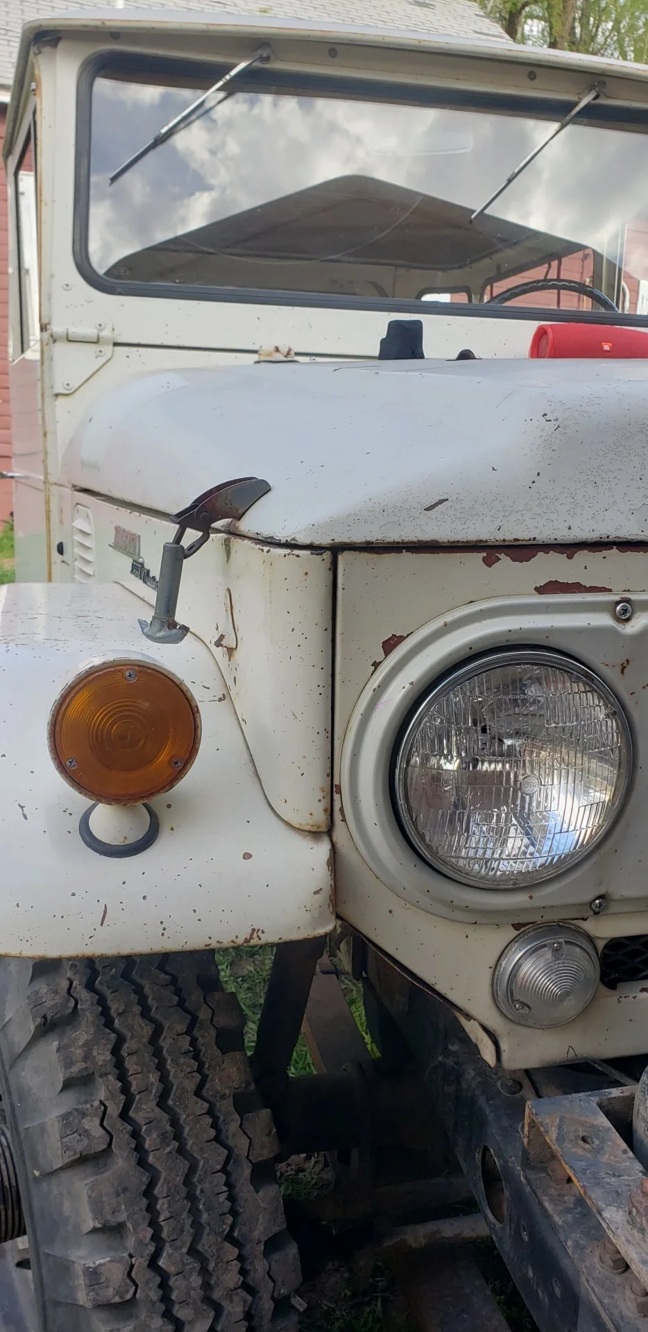

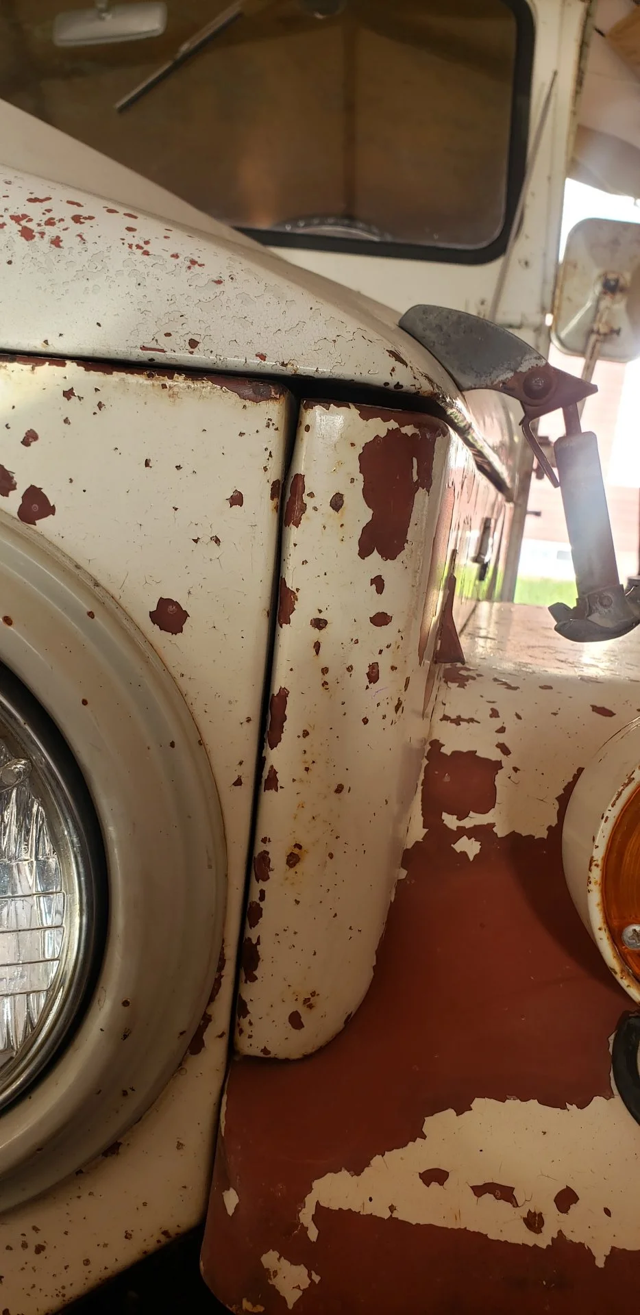

Good news is the frame was not pushed back at the front driver's corner, bad news is it was pushed up. Relatively straight forward repair, the front bib realigned itself with the hood after pulling the frame down at that corner. The shock tower doesn't appear bent, but it is pushed into the frame a bit, that is the next item to address. More pics coming soon.
