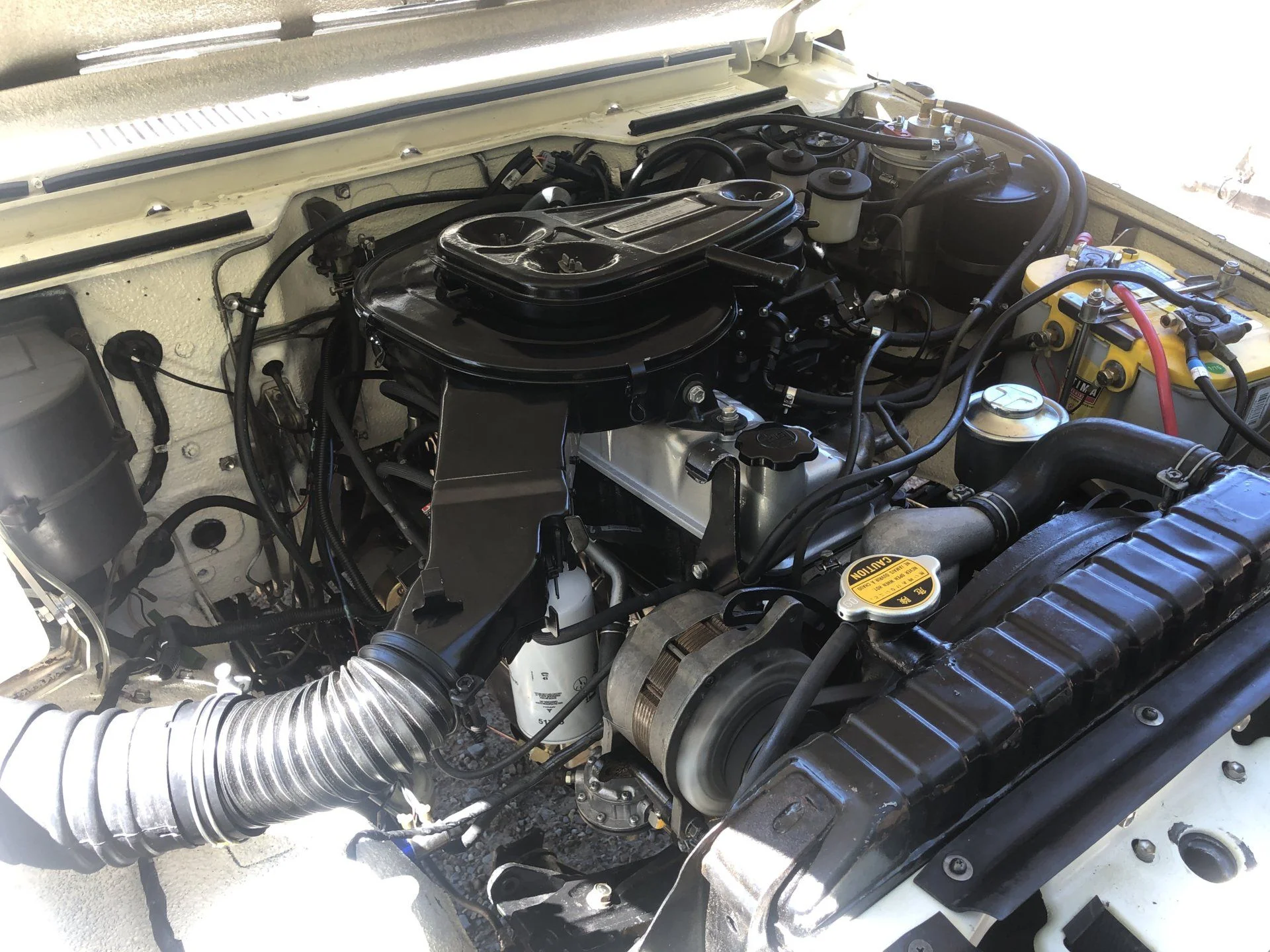

Do you mind sharing the part number on that Wix oil filter. All I can see in the pictures 51xxx.
Thanks
Damn. I can’t remember but it was @FJ40Jim approved.
Also, the large Toyota filter that has long been DC in the US is now completely discontinued by Toyota according to @Onur
I believe that is the Wix 51773 oil filter.
That’s gotta be it. It matches the one I normally use only it’s bigger. Don’t know if it’s better, the XP is synthetic and the hog is cellulose.

Jim C. typically installs the Wix 51773 (tall boy) filter with his oil changes. The Wix 51515 is about the same size as the standard Toyota 15600-41010 filter.
It's a long read, but there are documented failures of engines that ran the Wix 51515.
Wix failure thread
Yes, I know that is in the 80 section, but the failures happened. Also, google-foo it and there are reports of the Wix anti-drain back valve failing in other applications.
Even though they may not be made in Japan anymore, I stick with Mr. T
