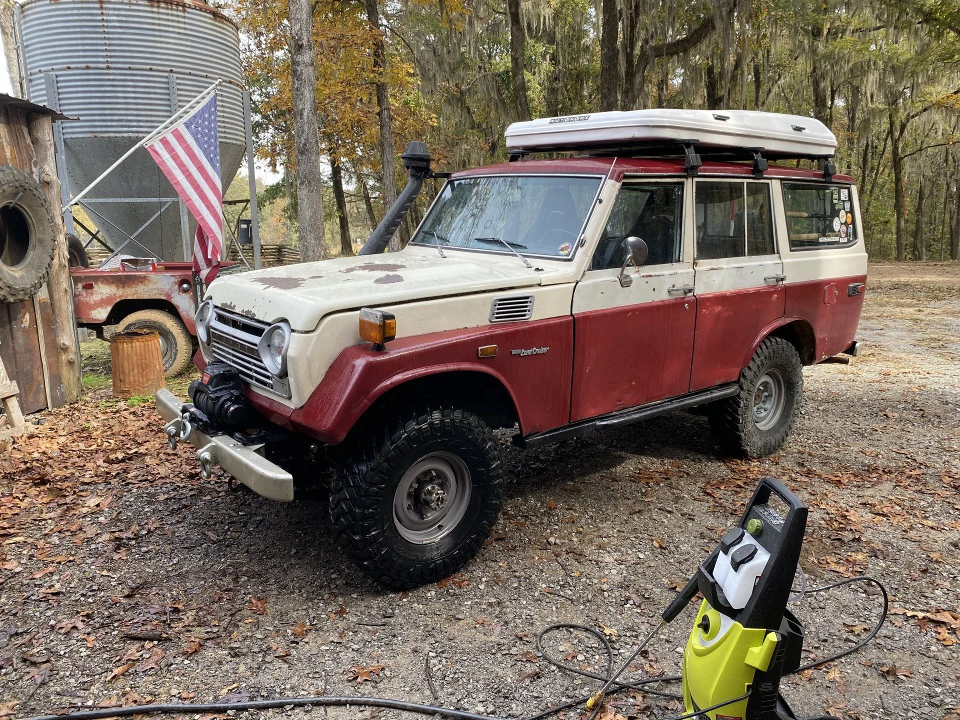

Deep clean for the Warthog 4.4 after a flawless 1200 mile trip to and from the Southern Swine Soirée in Arkansas.
The Mosley Motors 4.4 2F is still impressing me on every trip.
I averaged 12.6 mpg to include almost 300 off road miles and best of all, I did not turn a wrench or add any fluids.

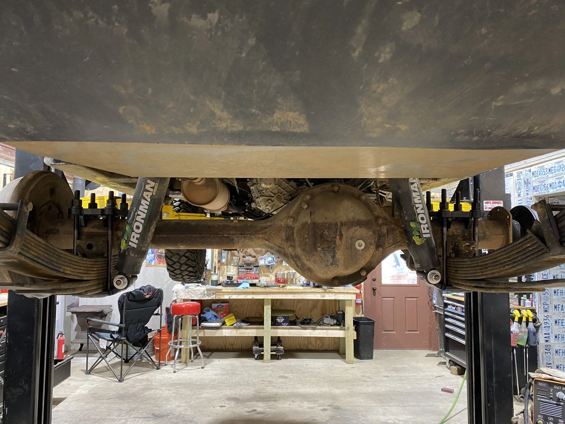

The OME has probably settled in finally with about a 45* shackle angle making it ride better each trip.
I am collecting parts to do a steering upgrade and am going to replace the body mounts. Other than that this pile keeps impressing.

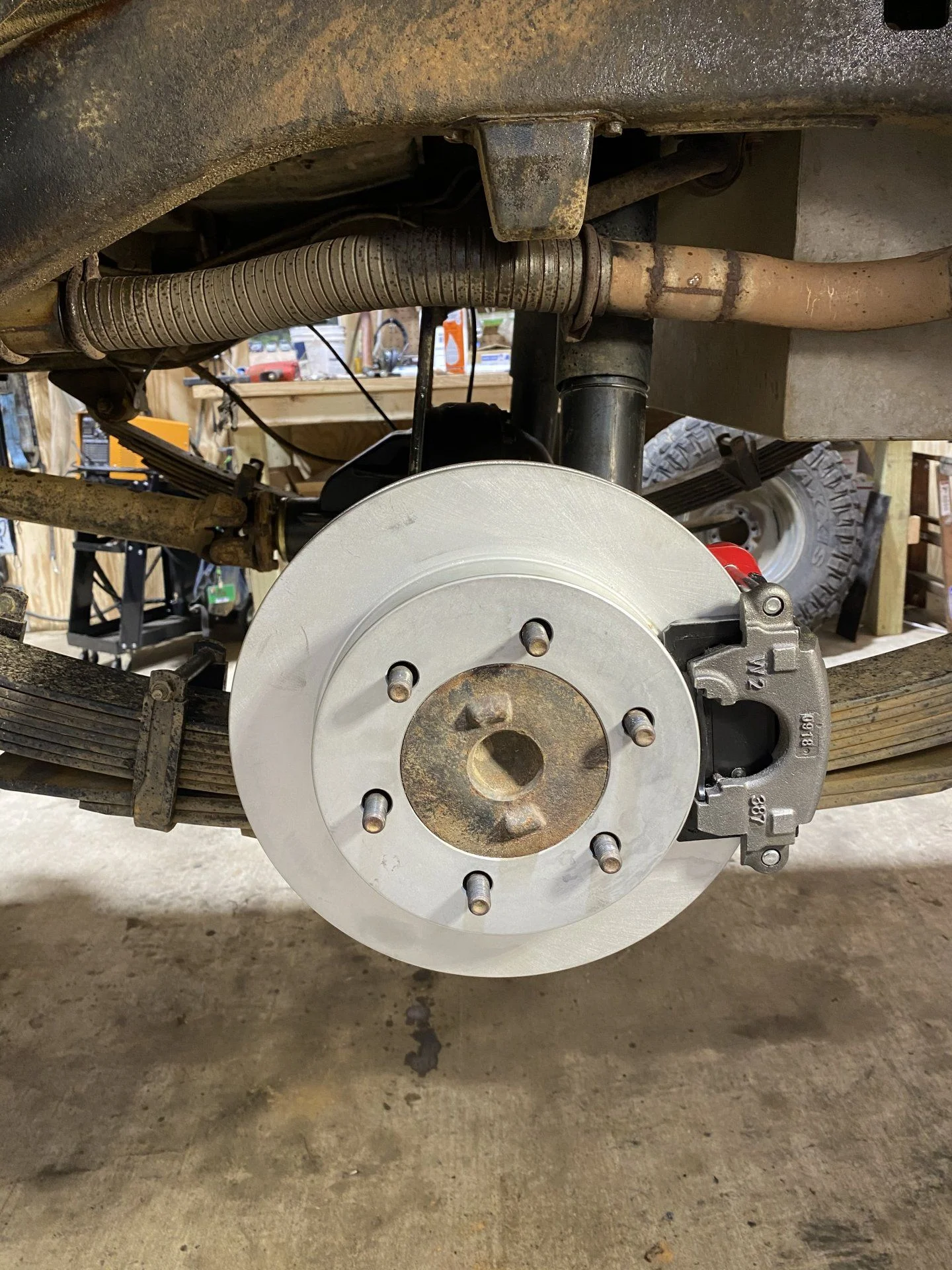

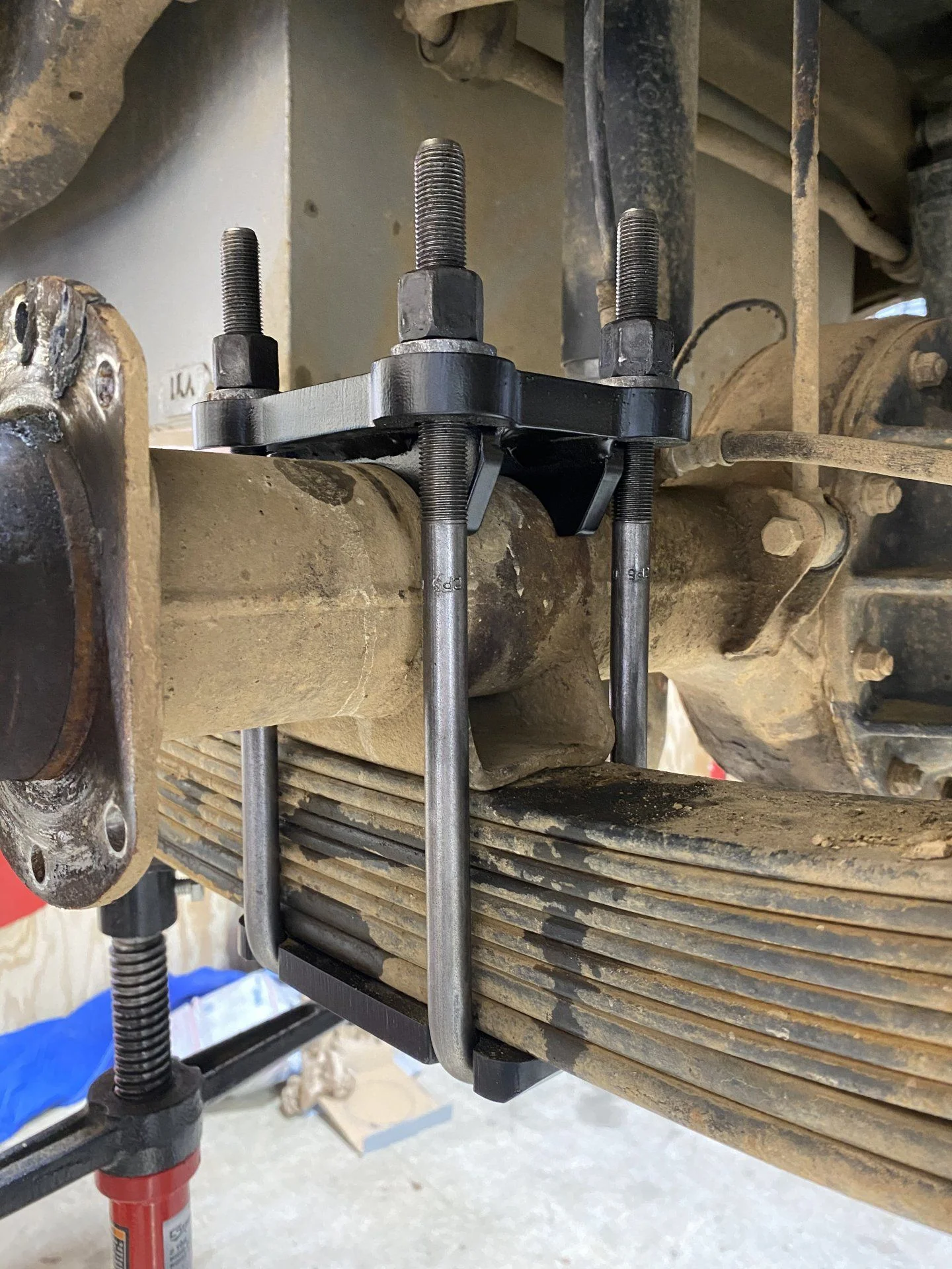

I also needed to make this omission correct from the original build and get some @lcwizard 4Plus flip kits installed.

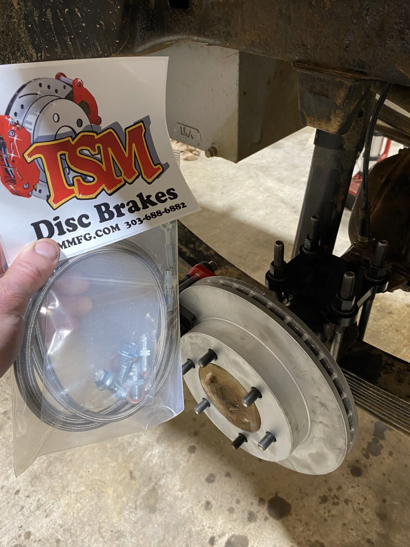

This disc kit is top shelf. I used it on my FJ45 and cant say enough how nice it is.
This thing still runs like a scalded hog with the Cop Motor but stopping it is not as good as my other Cruisers ...... but that can be fixed
Are there details of your disk brake conversion in your build?
A little more but there is not a lot of details needed.
The kit is a complete kit. Everything you need including all new stainless lines for the axle.
Super simple to install. In this one I cut my backing plates off so I would not have to pull the C clip out of the ARB. Easy install.

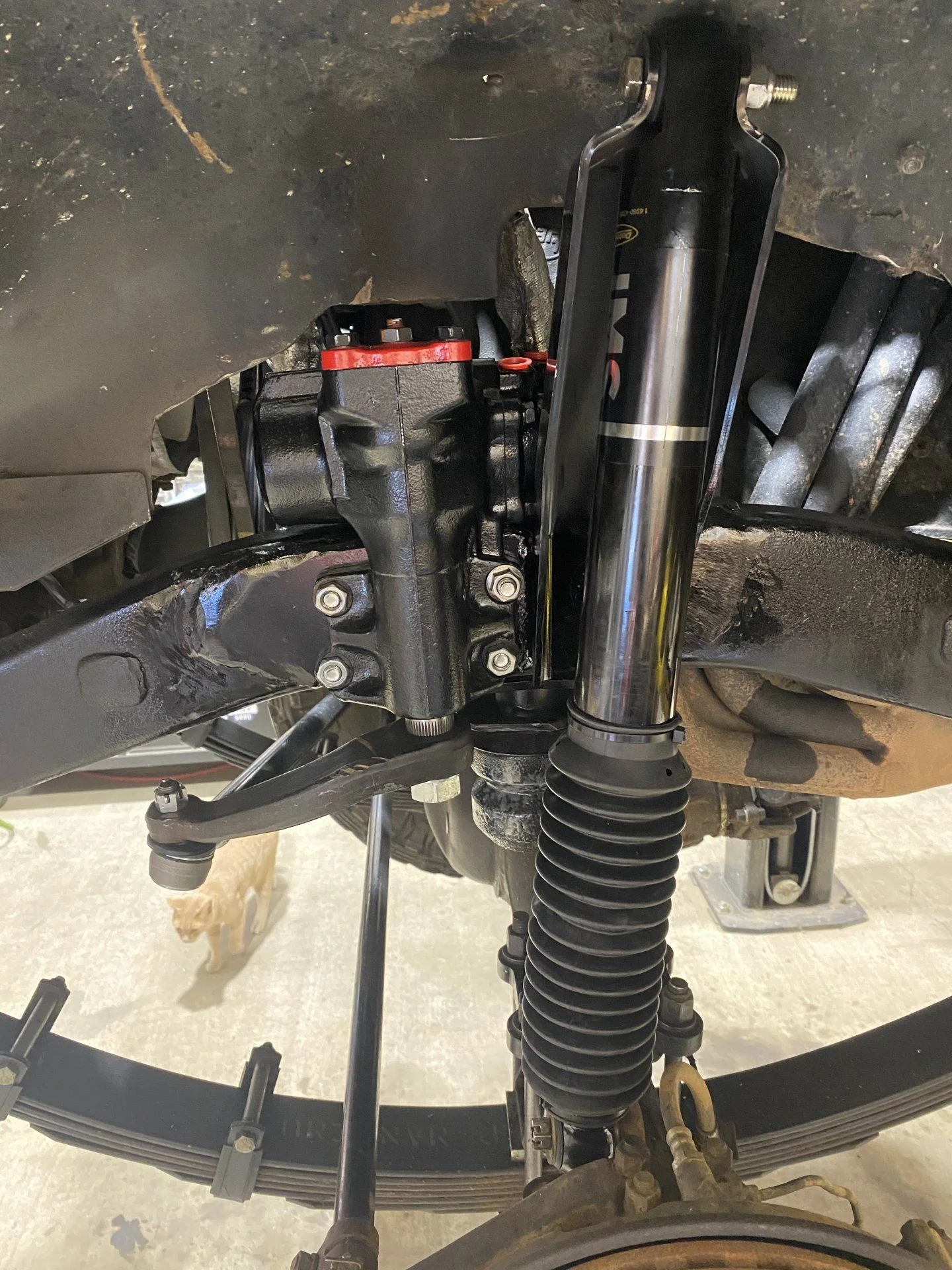

The Warthog got new Dobinsons IMS shocks and a Redhead 60 box steering conversion this weekend. Details on how it’s all done are in my build thread in the 55 section if interested.
@wngrog you use the 40 u-bolt flip kits for the piggies?

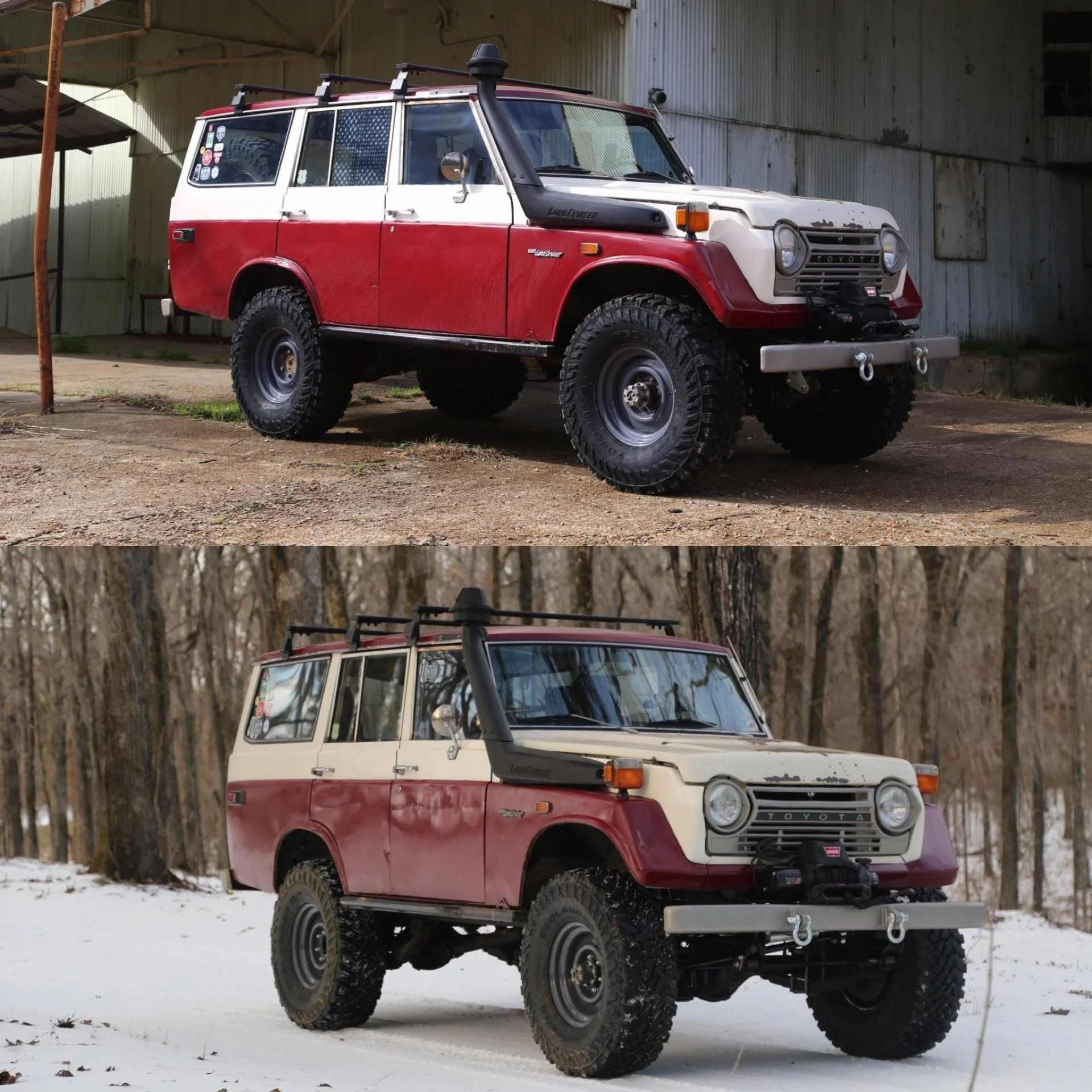

FJ60 PS dialed in with a drop arm (Fj60), Dobinsons IMS shocks feeling great, fresh powder on the bumpers and grill. 86’ed the swing out tire carrier and gave it all a fresh coat of rattle can.
Back to getting it dirty again soon......

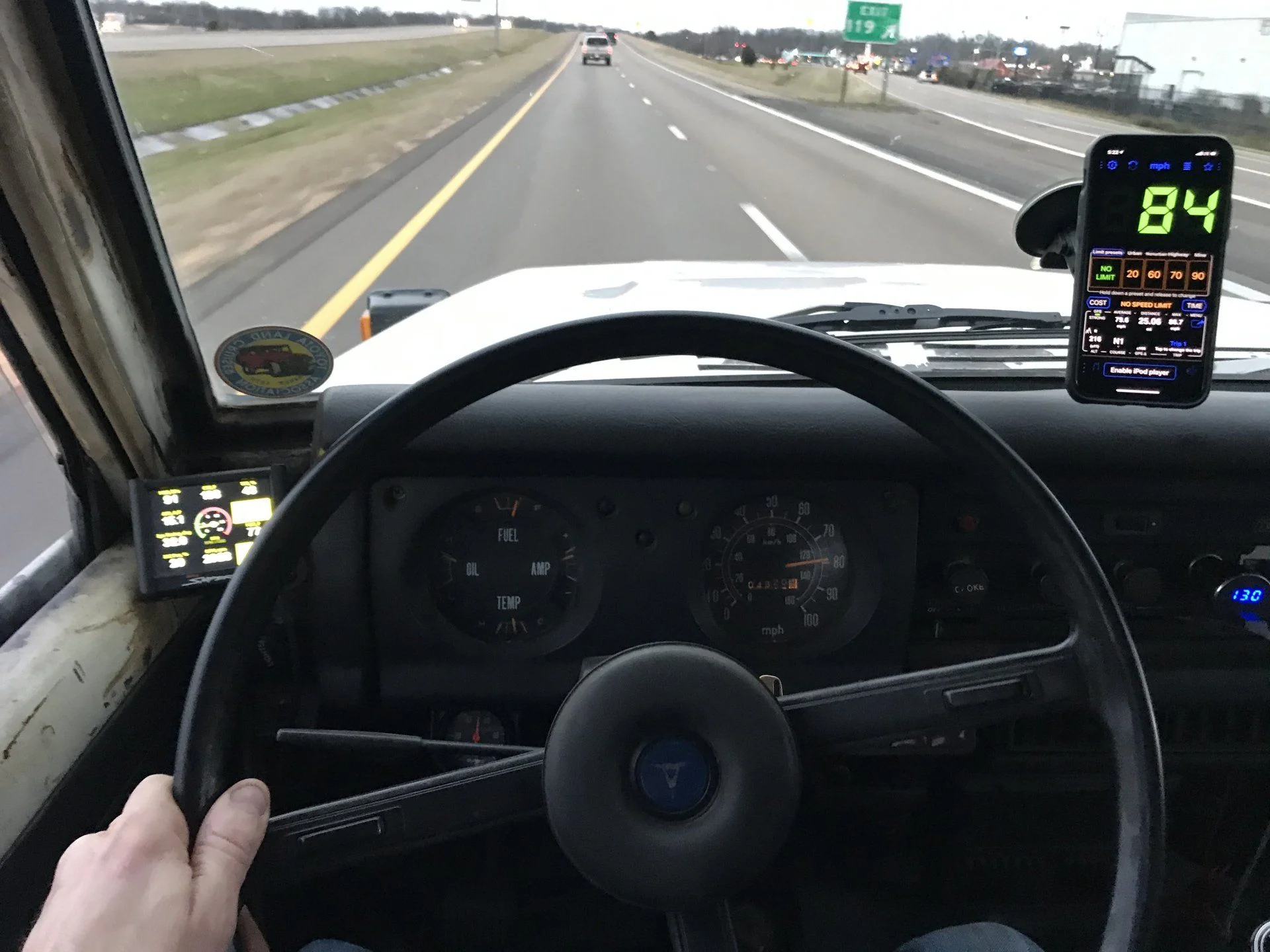

I had my stock 78 40 on the interstate running 66mph this weekend. Maybe I am chickens#@t however I can say unequivocally that I never want to do 84 in it.
