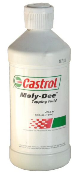

I use the same blade and run them as slow as the saw will adjust down to on the speed adjustment. On my saw this is still reasonably fast but not shooting sparks off the blade fast.
I also brush CASTROL MOLY-DEE CUTTING FLUID 16OZ PN 98-890-7 on the cutting edge of the blade before each cut, they seem to last quite awhile.
I quit using sawzalls for anything but wood. Straight to cutoff wheel.
