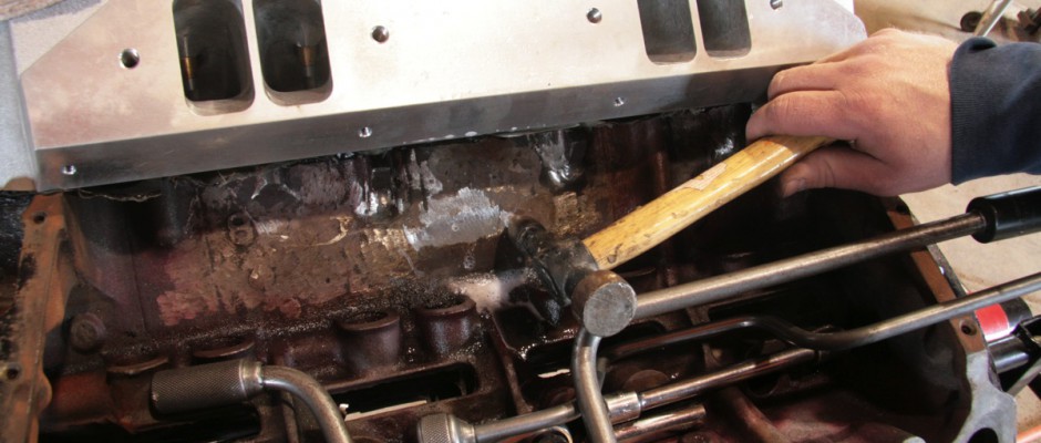

Can they weld a crack on a block. I've seen them fix cracks on huge punch presses before. They make some good cast iron welding rods now, too.
Run the engine for a while to heat up the iron and put a phat bead on it. Only needs to hold the psi of your water pump, right?

Back 30 years ago we just used brass rod and peened it over. Still an acceptable repair method depending on the crack location.
A better article describing modern block repair,
