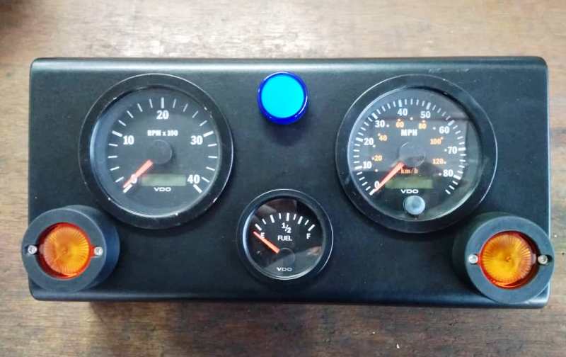

The overhead console has been simplified and the light panel is completed

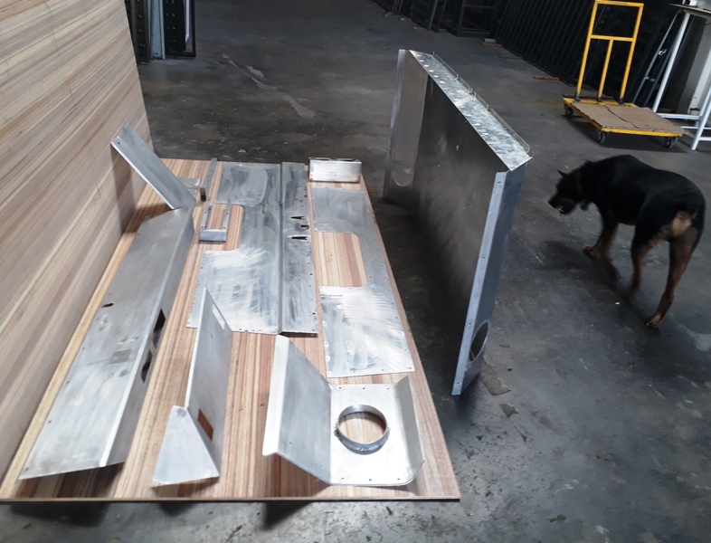

We spend the afternoon sanding and cleaning the panels 5:20pm they are all in the powder coating factory next door and Mr Brown escorts me there.

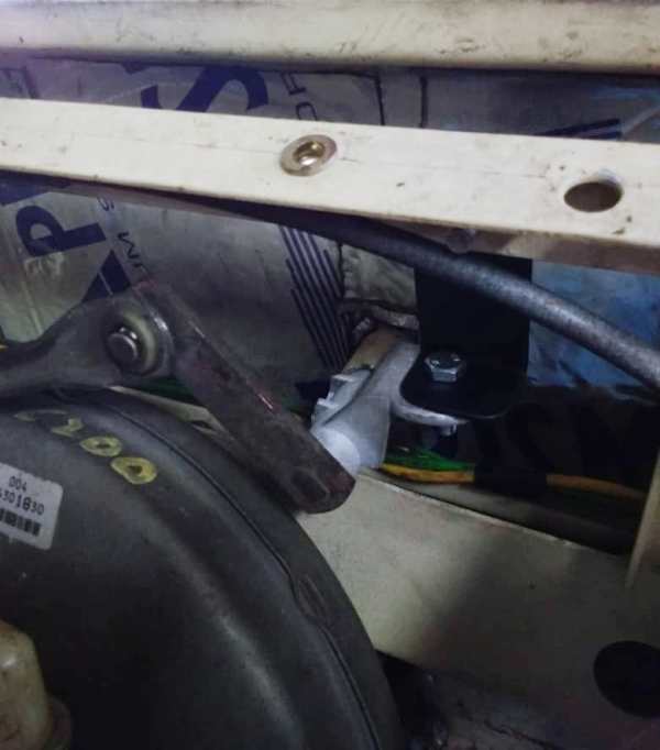

Then its onto the clutch we cannot get another one which has the bolts vertical so we cut off the new old clutch mount and prepare a new one. However, the pedal and brake master cylinder assembly must all be removed first.

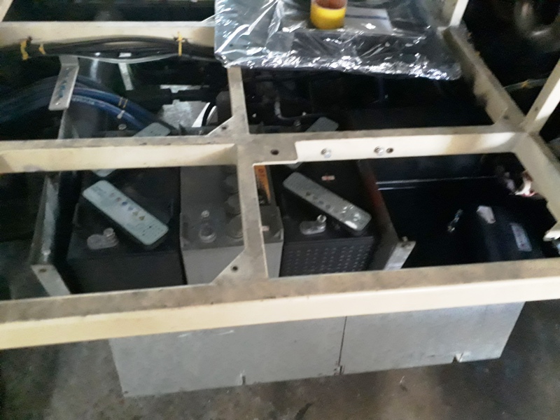

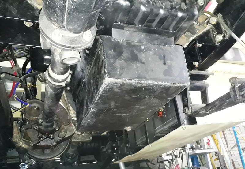

The batteries are all fitted just need wiring in and I now have a straps box.

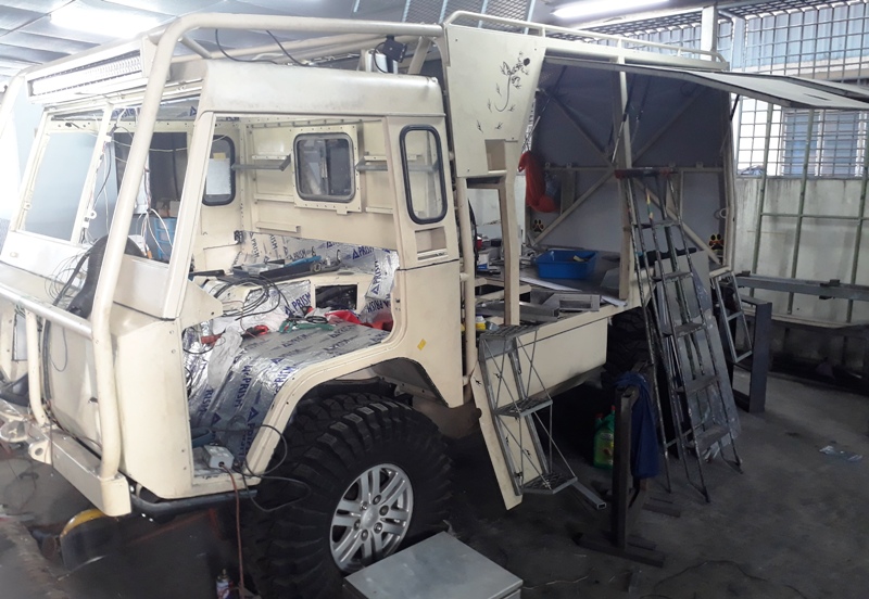

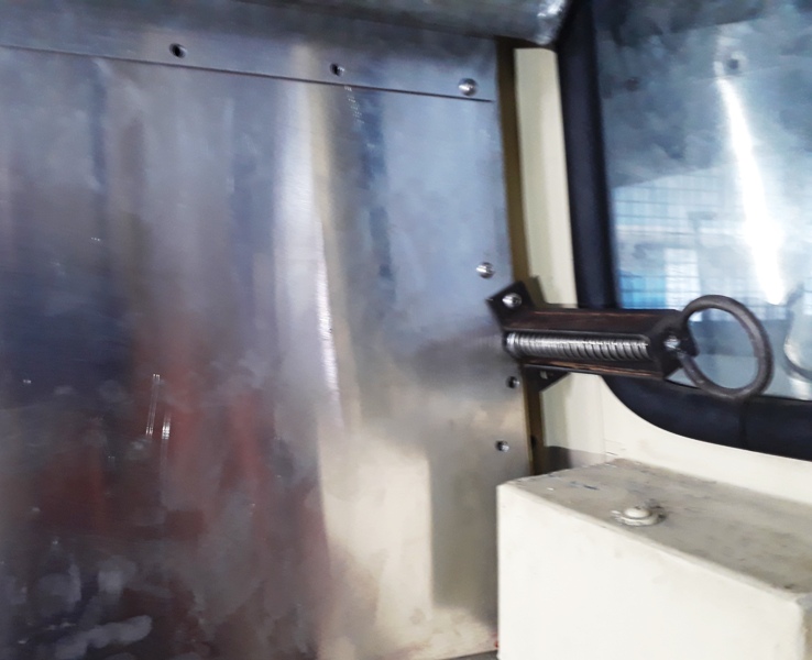

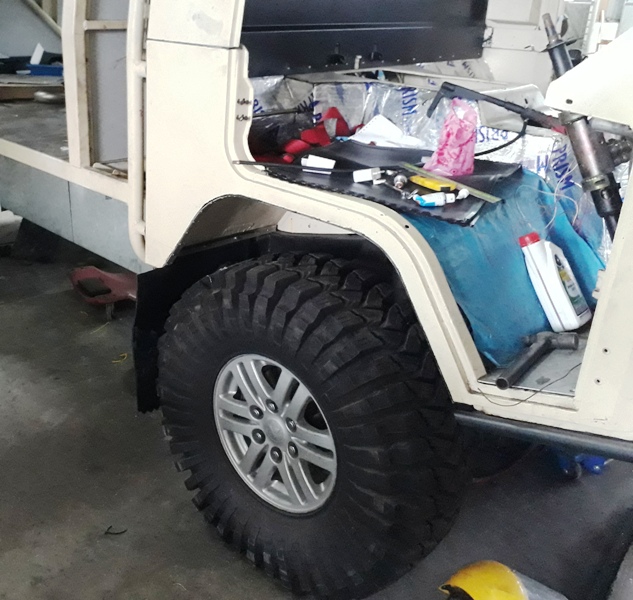

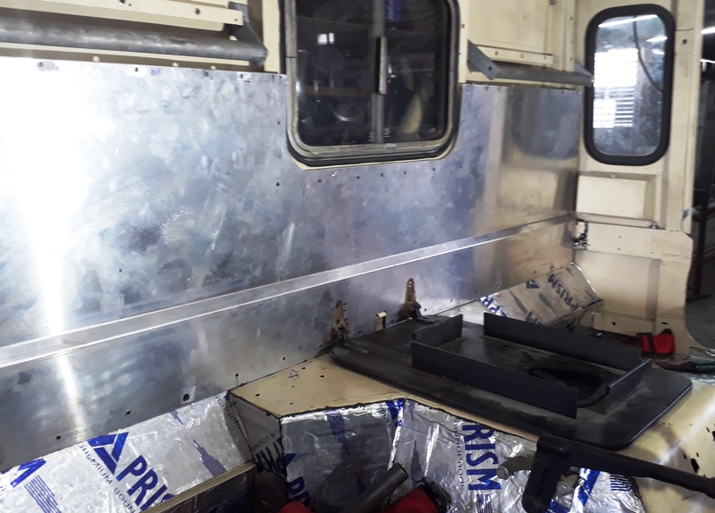

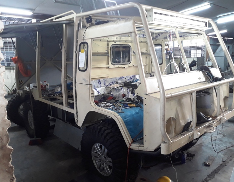

The 8.30am meeting shows they hAave been busy. The rear of the cabin is all soundproofed and 2 layers of insulation added. Its all bolted down and looks really ace. The batteries have had an inspection hatch cut into the floor

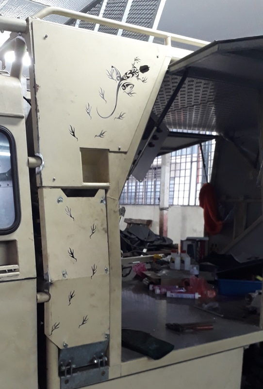

My job today is parts collection first while Ranjit does the making of the air intake, starts to mount mudflaps and also bend the leading edge of the service hatch covers deg to make them nice. My job is to mount the panels and the watertank and paint the new battery box hatch and the parts run and work on the clutch.

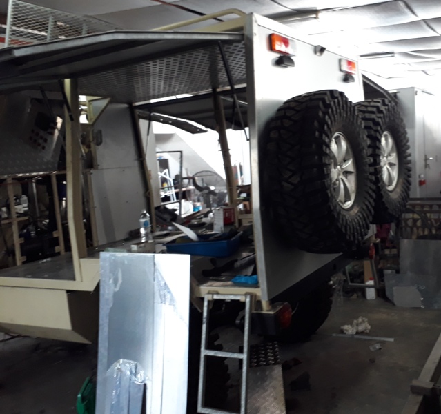

Afternoon for something different we mount the wheel studs on the tire carriers and then a test load and unload one of the studs on each carrier spins - DAMN we now have to remove and find bolts and weld them in. Damn more wasted time.
The rear panel and roof look really ace.

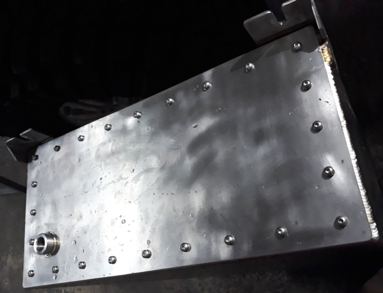

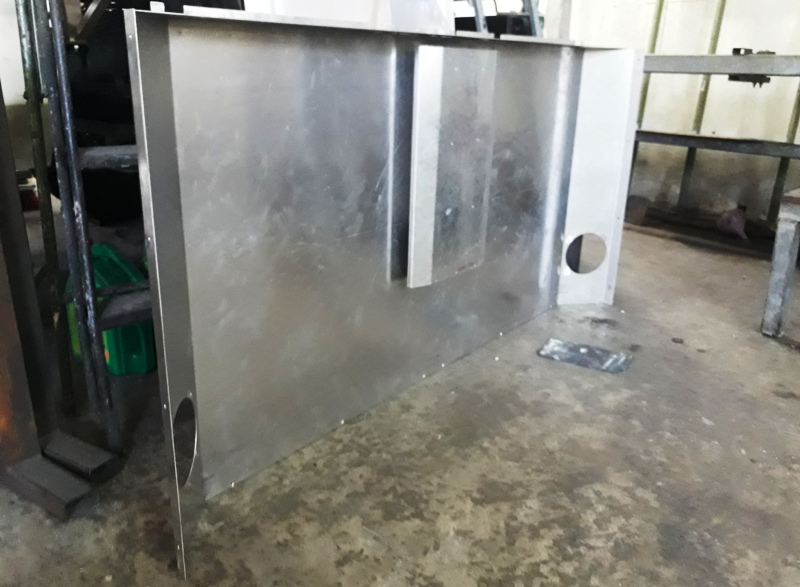

The new 80 litre Stainless steel water tank is washed and prepared ready to mount tomorrow and test fitted
I have the clutch starting to work it no longer leaks and pressure is building in the clutch line.

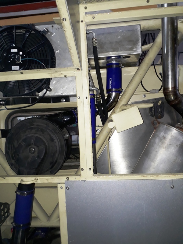

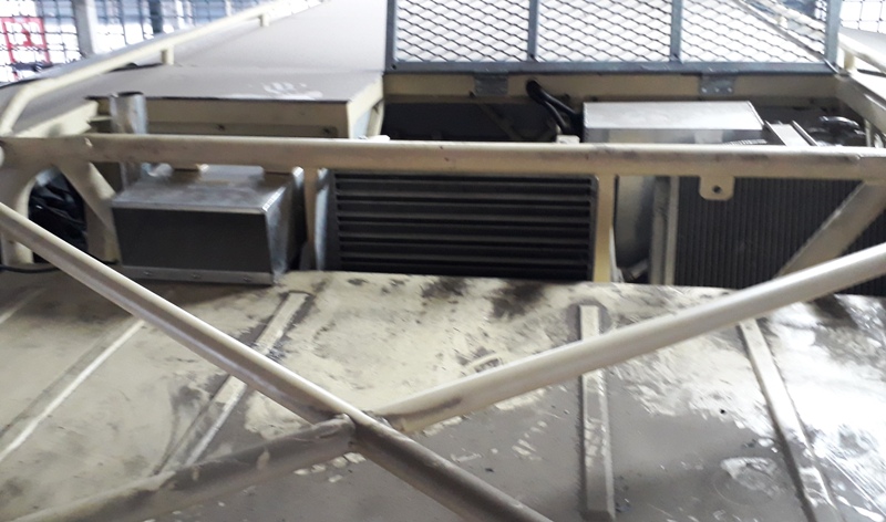

The air intake is completed and the connecting pipes made up.
By early evening we have the water tank mounted and 3 panels bolted in and sealed
One mudflap mounted with more to do to stop early wear etc
Ranjit has bent the leading edges of the service hatches inwards 45deg to make it look tidy.
The water tank looks ok
The air intake is completed on the left or the birds nest as it's been named after the tiny finches who made a home in a fluro light in the workshop.

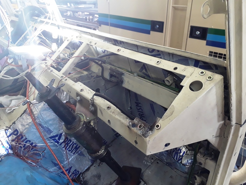

Got 3 pictures sent to me.

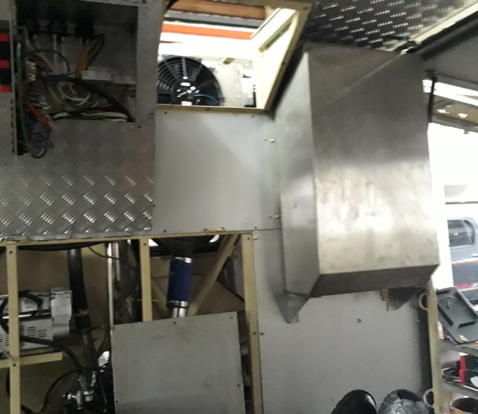

The wiper arms and brackets are finally installed
And the dash is starting to look completed
