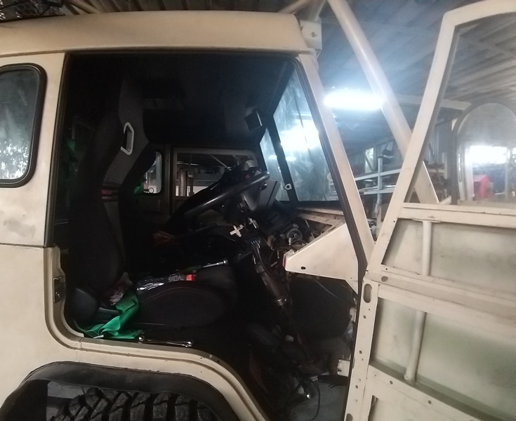

So back to the Volvo we have stripped the power steering off the Volvo so we can do the inspection, Saturday morning was spent getting the remaining seats for the Volvo. The distances in KL aare causing huge logistics issues rounding up components. THen off to the local hydraulic shop to get hose made to go from power steering pump back into resivoir. He saw me coming and charged me more than double the IPOH costs for a hydraulic hose.
Calculations for the power steering pump and the steering column unit and the hydarulic ram are also being done to see where the issue is. I have already found the washers on the banjo bolt are .6mm too thick resulting in lost throughput on the hose.

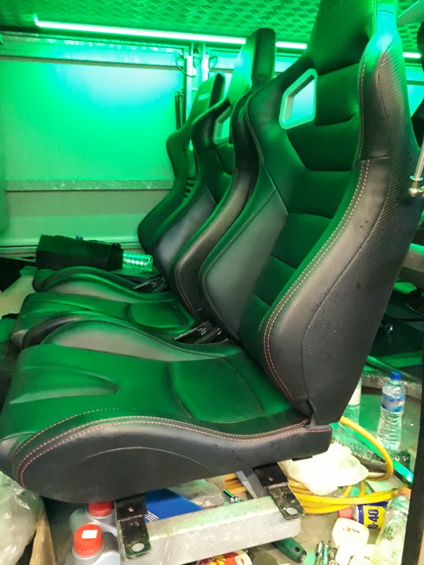

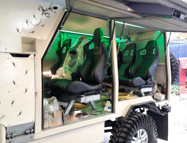

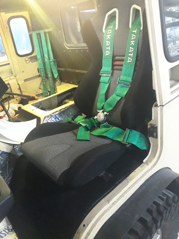

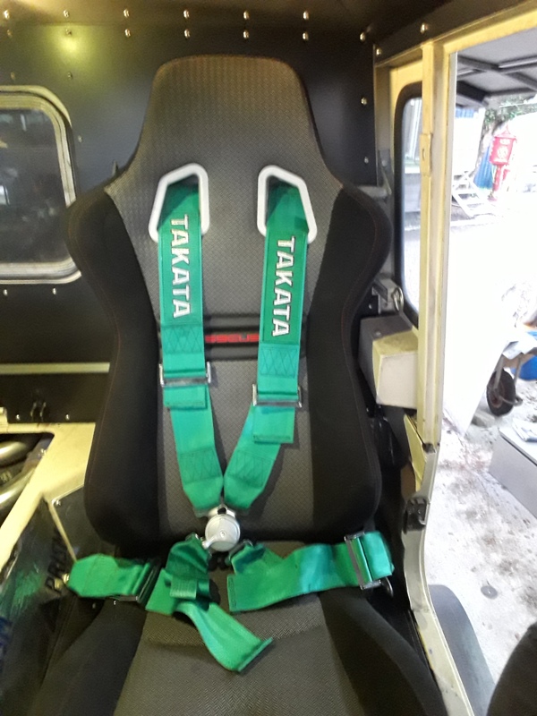

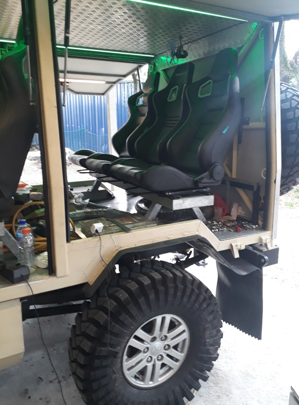

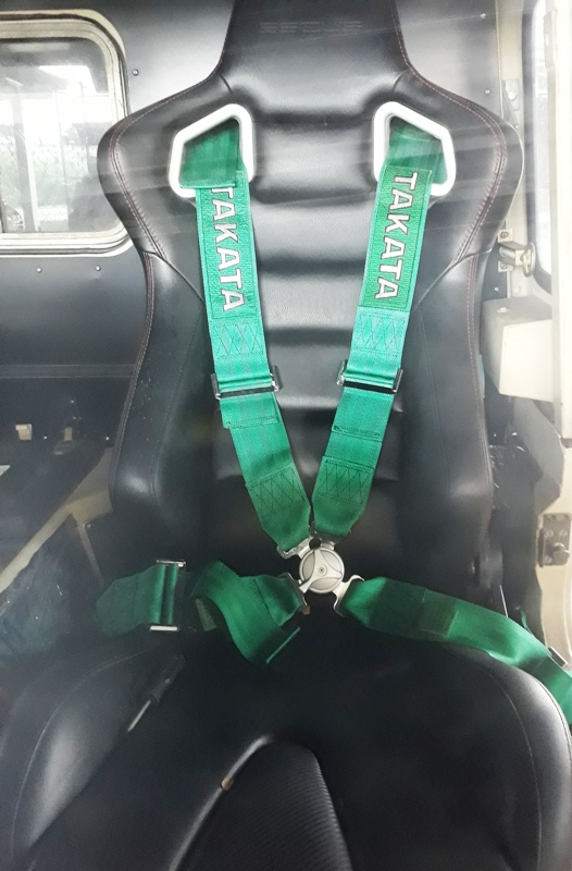

Seat belts were fitted. Remaining 2 steats fitted then I realised I had bought 4 narrow and 4 wide seats and the wide ones are also taller - oops.

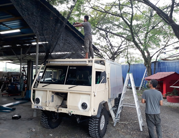

Then it was time for the Volvo to earn it's keep as a stepladder.
Seatbelt connection.
seatbelts
Rear seats all fitted but now I need to do some moving and matching.
seats
seatbelts

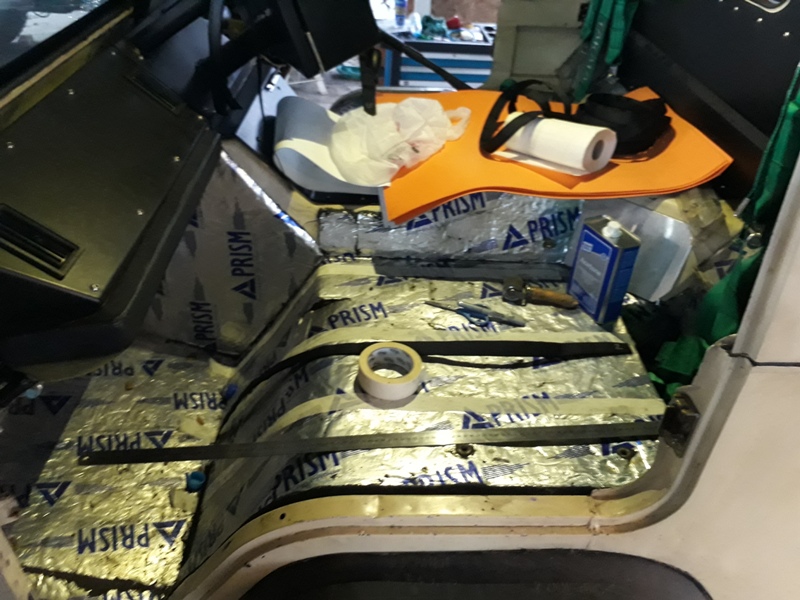

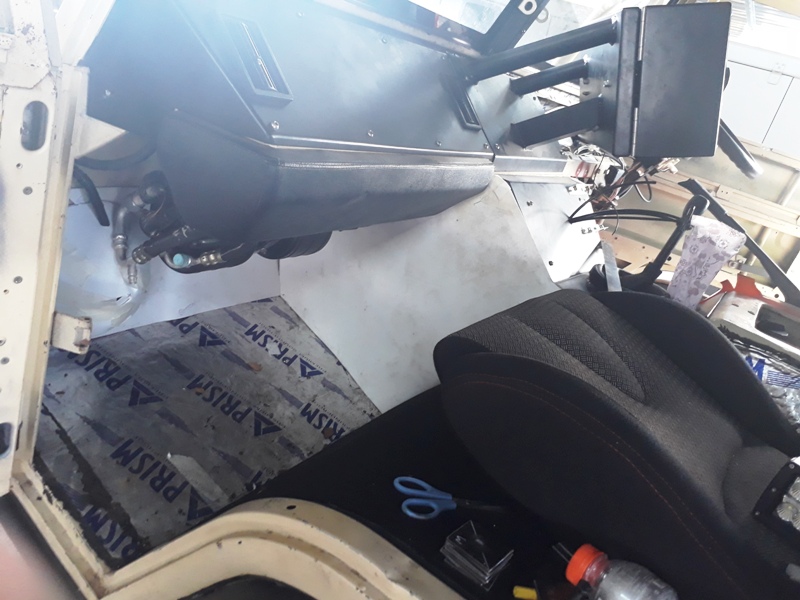

The carpet for the cabin floor has been done with the passenger seat floor complete. The driver side needs a mistake corrected but will be installed on 1st Feb 2019.

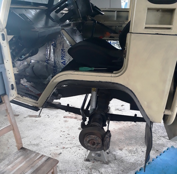

Last weekend we took all the wheels off and ran the Volvo on jacks,, that was scary. Hmmmmmmmmmmm problem found. The vaccum was not working it's shared with the PTO and the 4x4 via 3 T-joints so we direct connected it to the brakes and we had brakes. But it still will not lock the wheels up so further attention is being paid this coming weekend.

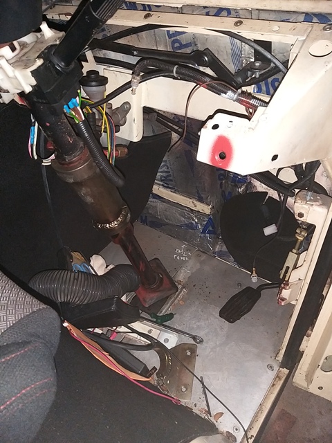

We looked at the HOrn and tried to connect the wiring to the steering wheel with no success. A separate dash switch is being setup this weekend.
Once these 2 items are completed we can attempt the dreaded re-registration inspection.

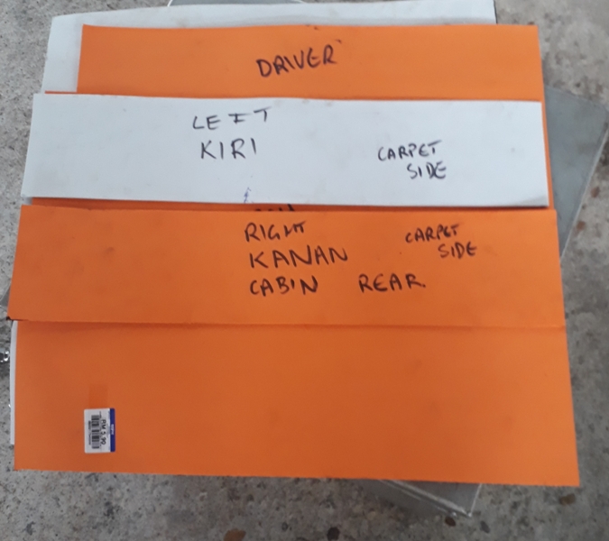

Today is a public holiday so I'm working on the templates for the rest of the carpeting in the transmission tunnel and footwells etc.

Working on the carpet templates to take to the cushion shop.

Preparing the floor for the velcro to be glued down
The front row of seats almost ready for the last seat to be bolted in until I cut the wrong lugs off and had to reweld them in lol. Felt such an idiot.
The passenger seat with the floor carpet fitted

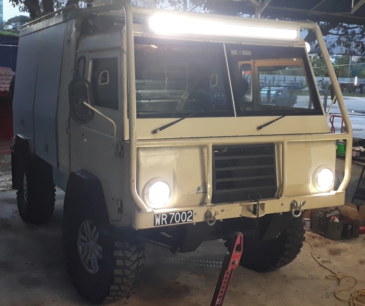

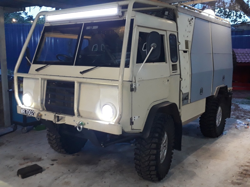

Just to prove the lights work.

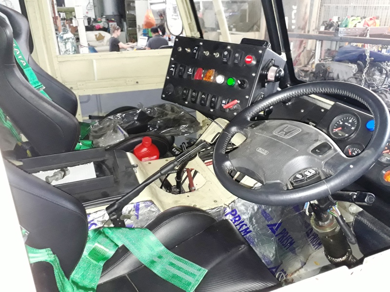

My electrics whiz buddy turns up and we install the HORN button. Wahoo only BRAKES left for the inspection.
Then we try and get the TACHO connected. Cannot reach the tach wire from the fuel pump - oh crap. Go to use the "P" of the alternator only to find its a PETROL alternator and no PINS are available. Order a TOYOTA DIESEL Alternator from a friendly mechanic - delivery after 11 Feb. Then onto the SPEEDO. The halls effect unit is already installed on the driveshaft. However we find one of the l;ocking nuts has vibrated out. More issues to solve cannot get a nut bolt shops are all closed until the 11th.

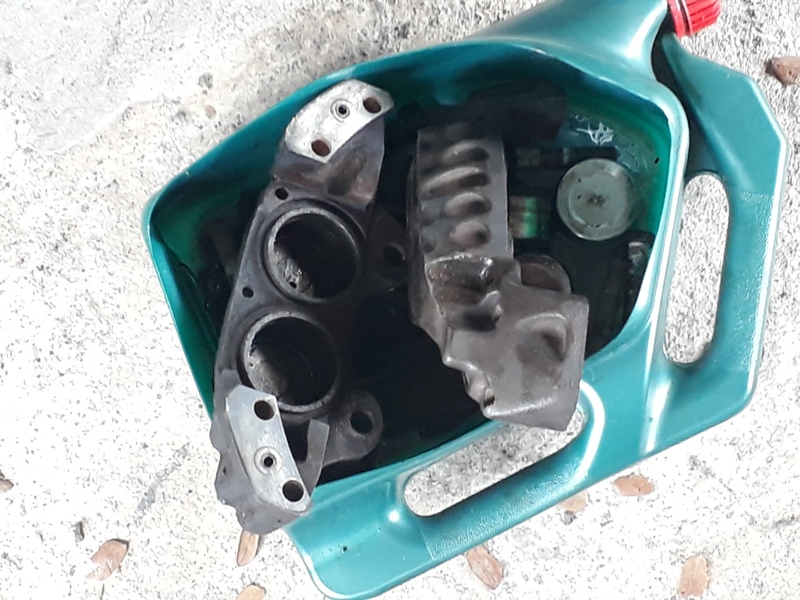

A rebleed of the brakes made no difference so we elected to just pump a lot of fluid out of the brake lines, OOps suddenly black fluid came out oops so we decded off come the front callipers for a full rebuild even though the brakes were contracted out to be rebuilt a few months ago.
The end result was some very sick looking callipers with 6 of the 8 pistons not moving and all the holes blocked up.

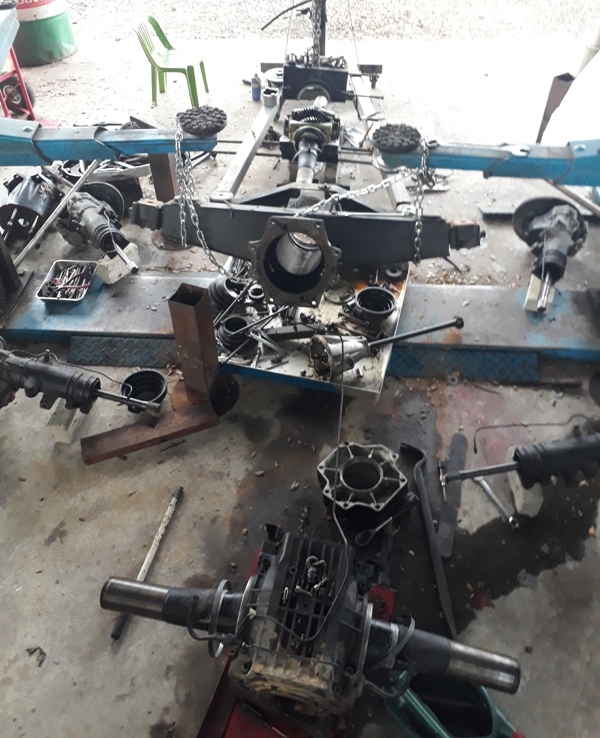

Meantime Andrew had completely stripped the Pesky Pinzgauer rear tandem axles completely apart to find the mystery whine only to find a single diff bearing gone!. It's CNY he also cannot get any parts until the 11 Feb.

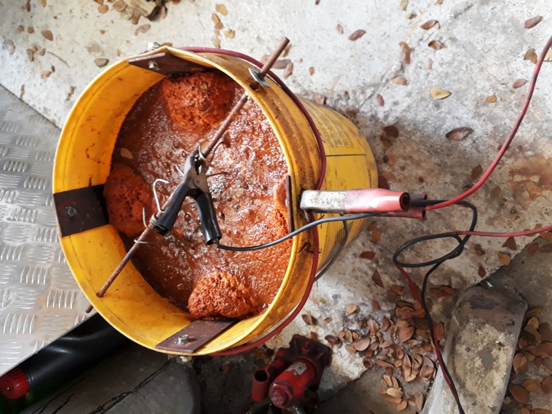

Meantime the second calliper is in the 12v battery charger and baking soda cleaner and enormous amounts of crap come out.

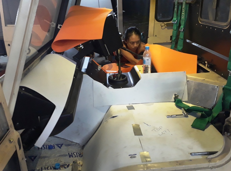

Meantime I have most of the carpet templates cutout mainly because the Volvo will not fit under the Kussen/Cussen/Cushion/Upholstery workshop everythng has to be done remotely. Only a few remain for my assistant to help with tomorrow.
A last minute brake test run of the VOlvo is a failure it takes 2.5 street lights to stop over the normal 1 and a bit and then the engine starts dying - no fuel. We realise the electric pretank pump is no longer clicking but its working slowly. Strip it out and find its 24volts. Damn they forgot to change n the 12v conversion it's browned out.
Sunday

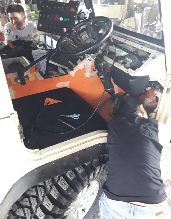

My trusty assistant turns up so she gets the carpet templates to complete. We have to finish Volvo 1 before we can recomence work on Volvo 2 and Volvo 3 (is going to be started side by sde also).
She is kinda tiny and flexible and works unconventially lol.
However, by 6pm she has all but one carpet template completed ready to see if the cushion shop might be open Saturday since they are not chinese owned lol.

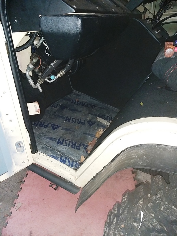

The carpet is slowly being installed.
Drivers side is a mess while we fix up the brakes issue
Slowly the carpet is installed.
Rubber Door seals installed.

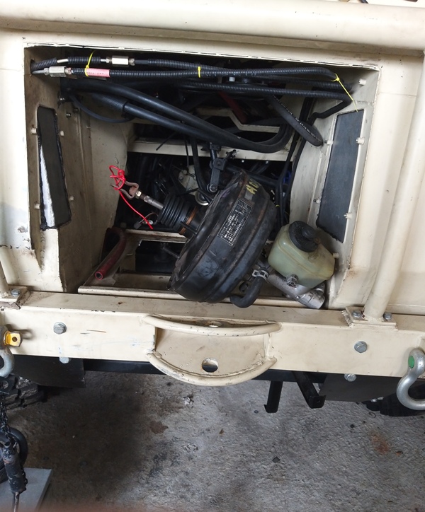

We have progressed in the brakes issue to purchasing a 80 Series Landcruiser twin diaphram booster and master cylinder and now im waiting for Andrew to mount it remotely. However the pesky PINZ still torments us and only on the 1st did they get the pesky PINZ back together with all new bearings in the transfer case and the rear differentials and wheel bearings etc then upon testing late on 1st it was still making a whining noise leaving work on the Volvo's stopped.

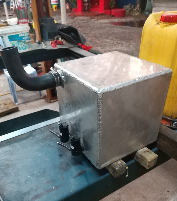

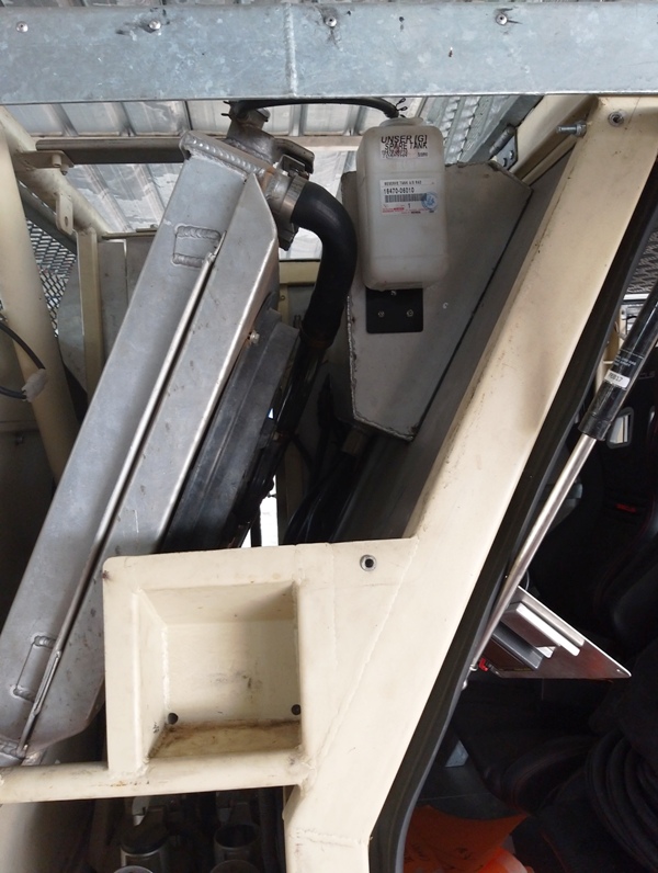

I have made a bracket for the radiator overflow and mounted the overflow bottle.

They are almost finished fitting the new Landcruiser 80 series master cylinder after saving 2inches on the pedal bracket and have about 1/4" more to save to make it fit. Then we have to change the fulcrum point on the brake pedal to give 3/4" more travel to the piston then it might be ready for testing.

We have rebuilt the brake pedal it's almost finished and we have found the brake issue we had 1cm of master cylinder travel not 3.5cm like we need to apply sufficient pressure.

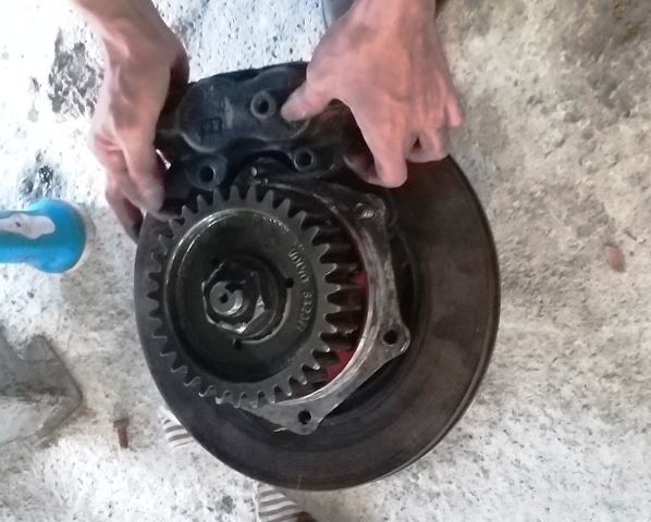

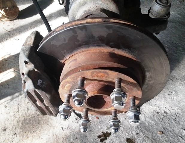

Bleeding the brakes we find the issues the pads are not moving enough. It's back to stripping everything out of the Volvo again. We pull the portals out callipers and all Pedals out Callipers out and strip and rebuild and refit but I could not get the callipers with PADS to install. Finally we see the problem. The callipers had been pulled and rebuilt previously with new pads installed but they did notice that the old pads had had 3mm trimmed from the middle of the pad so it could clear a portal bolt resulting in the pad not clamping the disc correctly. Fitting the PADS after the calliper bolted in caused the pad to hang on the portal bolt. We fixed that and refitted the pads and checked for correct operation. Still no proper BRAKES. We elect to start building up the brakes to the before 2010 status. We add a vaccum tank and the brakes are better we add another tank and build a rack of 3 tanks and add the cross member vaccum tank back to the setup. More brakes now it stops from 60kph but still will not lockup. Investigation to a bigger master cylinder is continuing.
Pulling the portal and discs and callipers off
