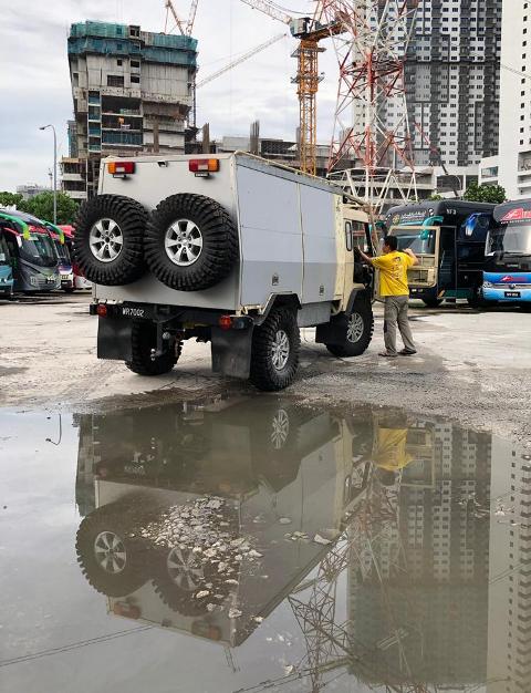

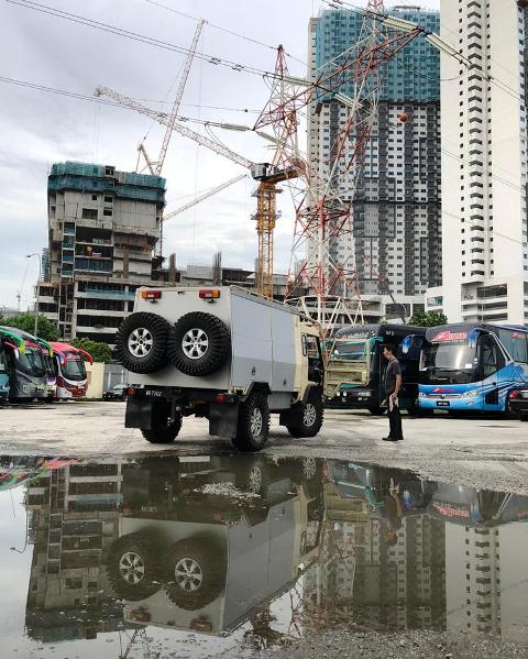

It's a reflective mood in the carpark outside the place is full of buses as there is no tourists or planes to the airport they are all stored up more than 300 of them.

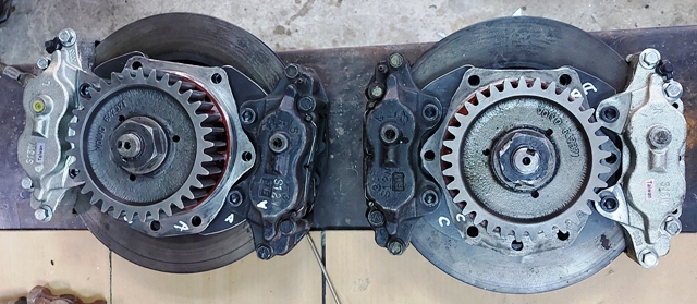

New brackets were decided for the Volvo and some other mods to make them fit better. So new 12mm steel brackets were designed by an engineering shop along with twin callipers for the front discs.
New Callipers were purchased to match the existing ones. Then we waited.

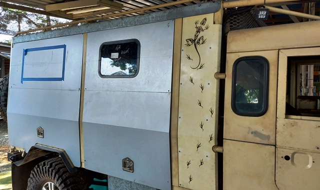

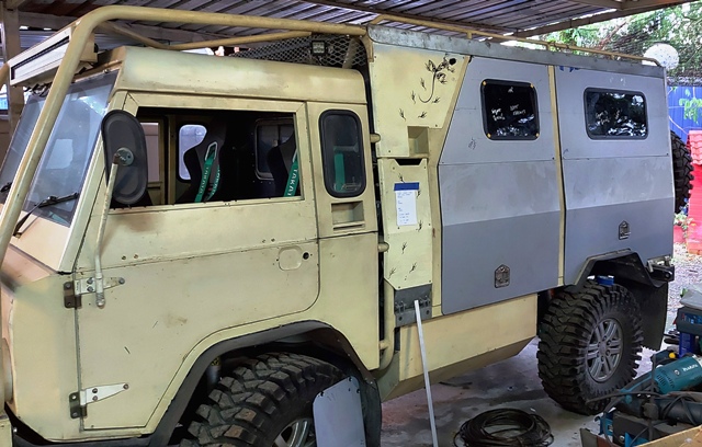

The new rear side windows were installed (compliance to make it not a commercial vehicle).

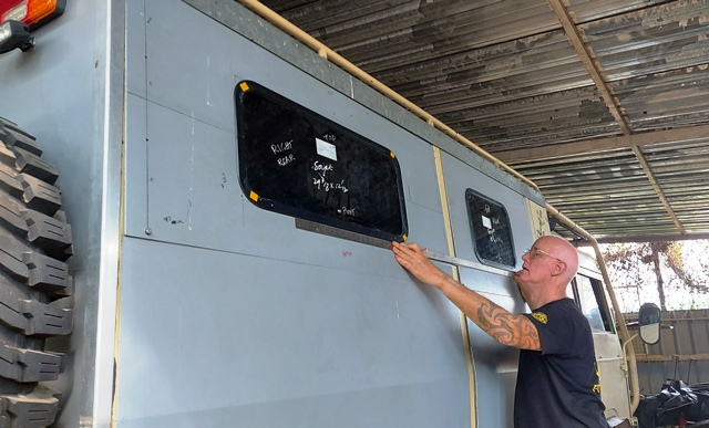

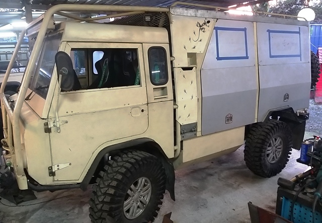

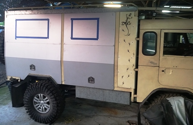

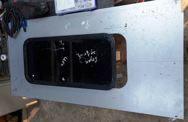

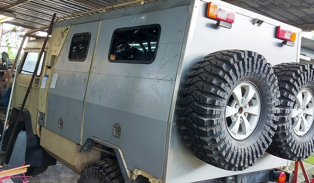

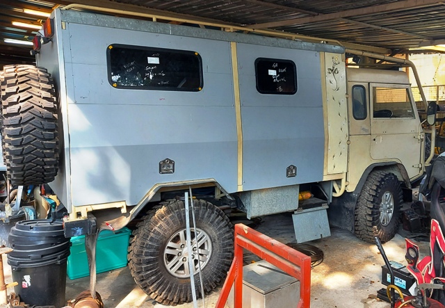

Marked out the windows location after receiving the windows back from the factory. THen we discovered that they had not made the flange big enough so could not bolt them in had to glue them.
August

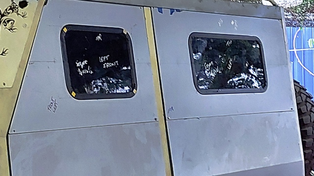

Then slowly each window hole was made carefully one at a time took about 60 minutes for each window to be cut in with a tight fit.

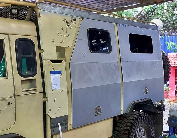

Before and
After
Then its the drivers side to be done

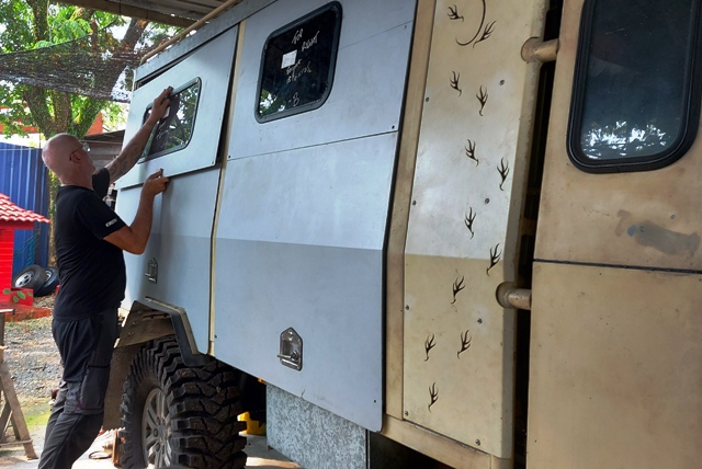

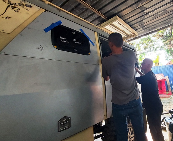

Making sure the windows are level.
Wah finished someone offers assistance to help bolt them all down.

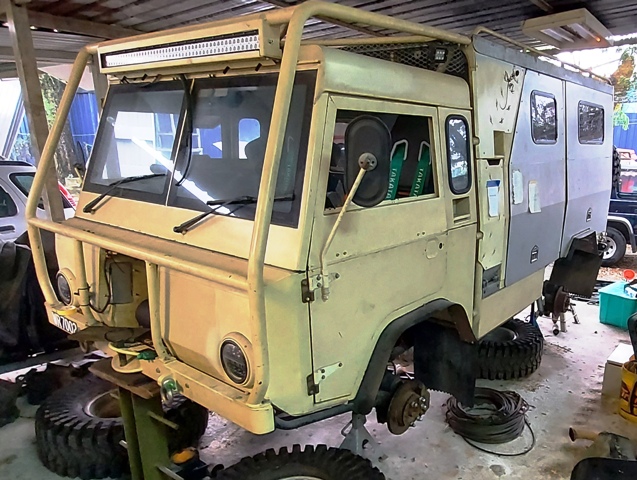

Strip the brakes off to go to the engineering shop for the new calliper brackets to be made and source a new pair of front callipers to make it twins on each front wheel. The old brackets were 5mm thick and flexed when we were testing the brakes under close scrutiny.

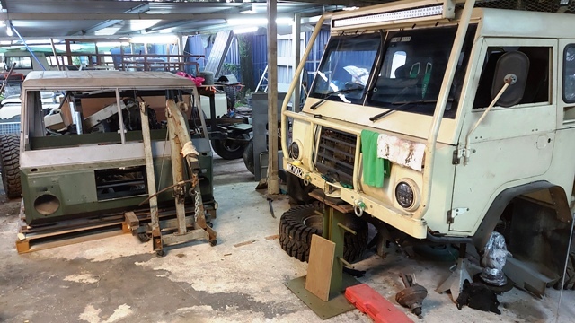

Then it was the big workshop cleanup we moved Volvo 2 to its new location in the workshop ready to start work once Volvo 1 is completed.

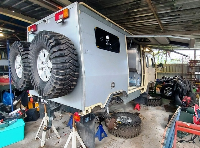

Well I had a few days leave and did not want to travel far due to the growing COVID issue here and people running all over the place for a holiday. My JETBOAT boat is still in the shop getting new headgasket after the last Elephant hunting trip disaster.

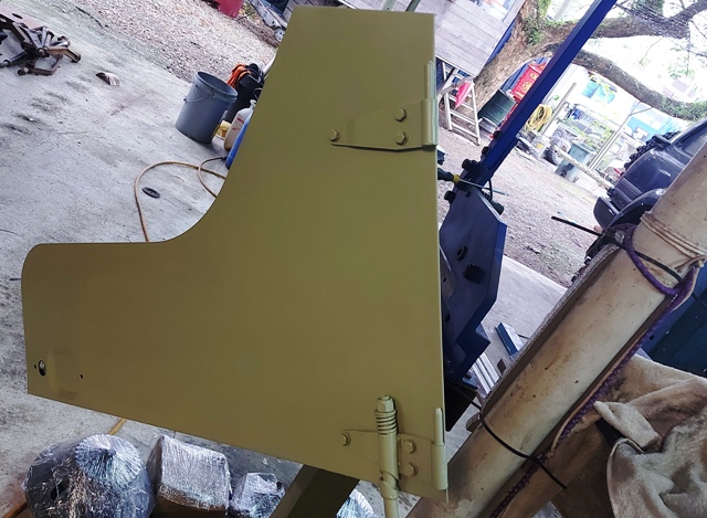

So I decided time to paint the truck again the oil stains in the paint have become unbearable to look at.

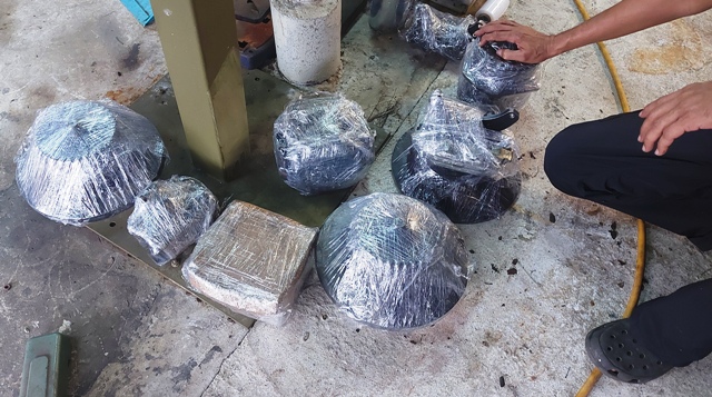

I managed on Saturday to collect the new brake parts from the shop and we will begin assembly Monday morning.

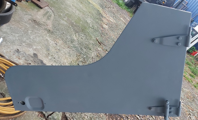

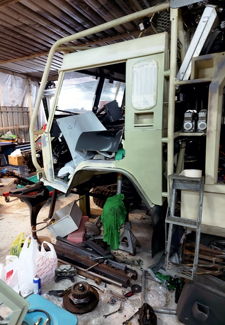

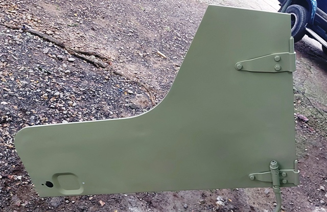

Started with the doors easy to fix and sand and undercoat. Yes I'm doing outside in the workshop. The paint is real paint mixed and canned for me. The new colour is Desert Kakhi.
Then we ran over to the engineering shop to collect the Portals and brake components.
The top coat looks good a nice light green. Clear coat is a matt clear 2 pack and will dry nice and hard.
The monday I managed to get the painting done and we got the new rear brake brackets installed.
