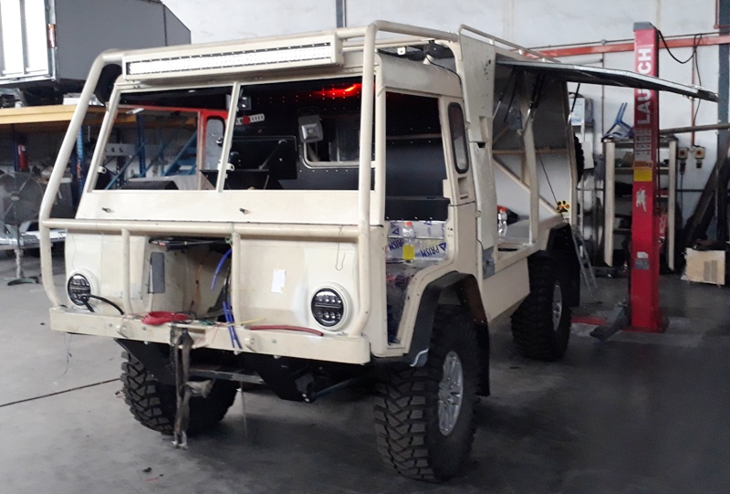

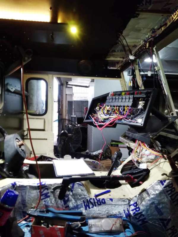

Got a set of pictures sent to me of progress.

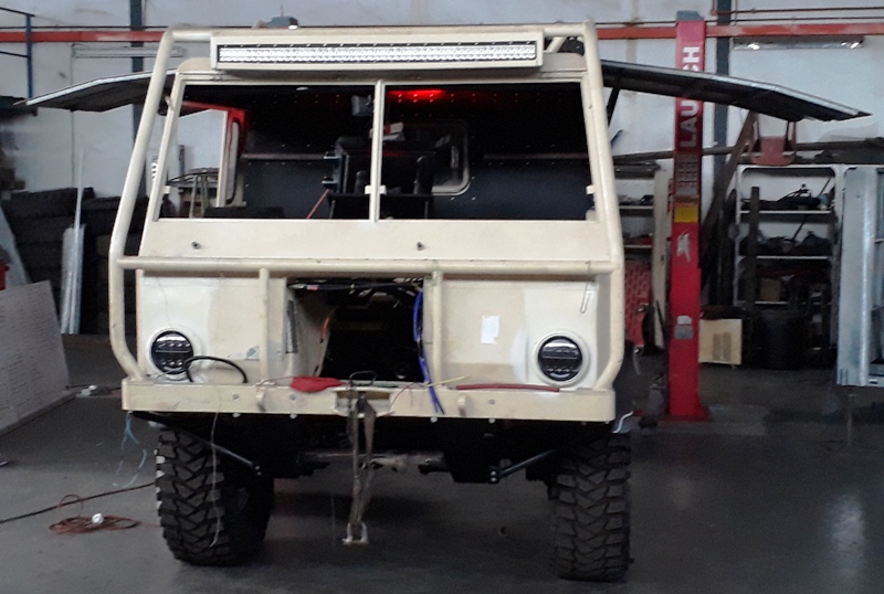

Headlights back in.
It's up on the hoist so they are working on it.

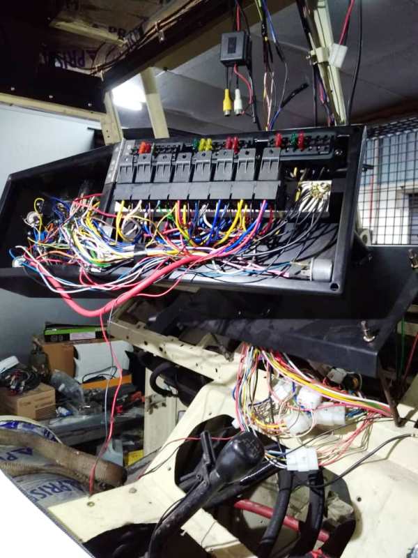

Work on the wiring continues.
The maze of wiring looks not so much of a maze and now looks connected up.
The interior lights etc and batteries are connected.

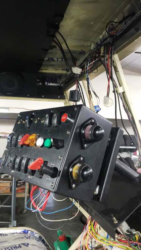

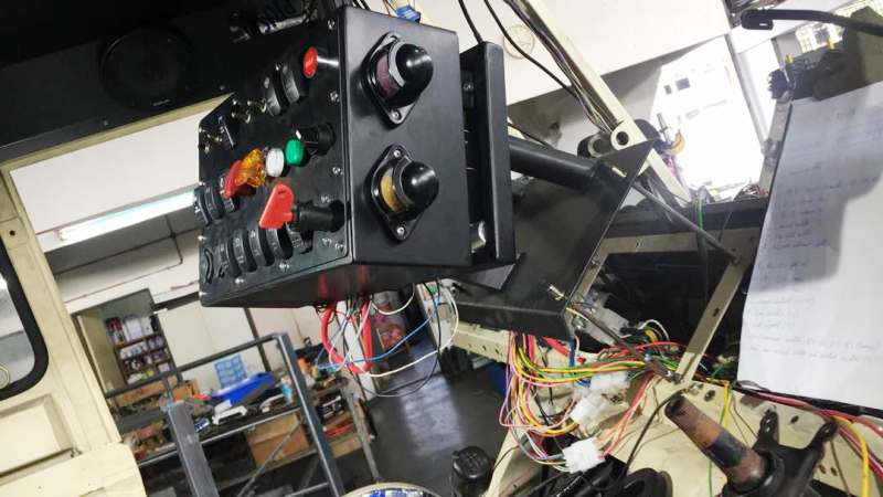

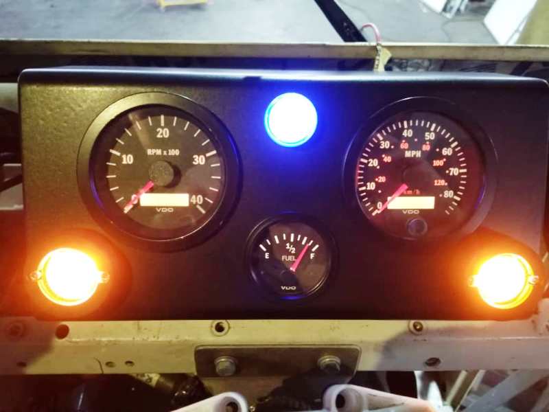

The dash panel is now almost completed and the water temp etc all connected and working.
Tacho and Speedo connected and warning lights etc connected.
Progress is being made. Today the wiper arms etc are supposed to be connected I guess then the windows can be installed.
I hope to collect it on 29 September and bring it to KL.

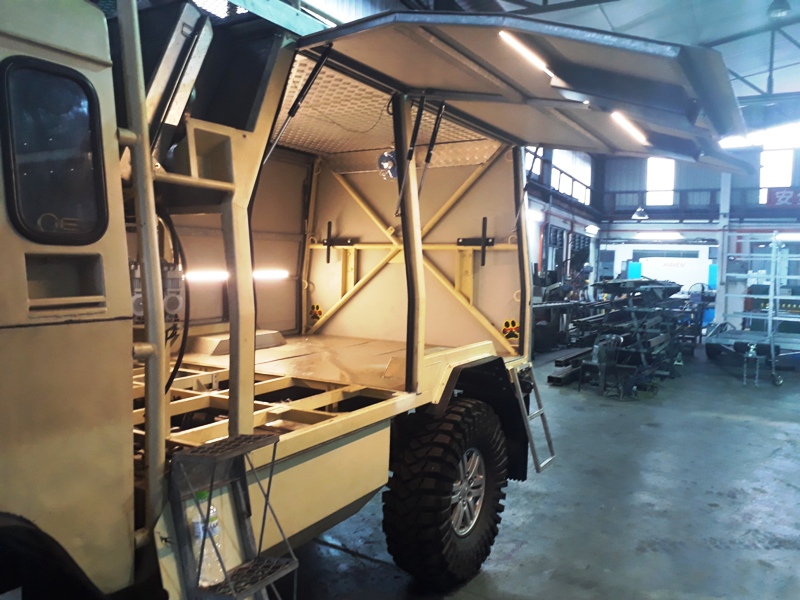

So what's been done to the Volvo quite a lot:
-Window washer 15litre made and ready to fit sits where the radiator used to go.
-Fuel pump wiring relaid to avoid andthing trouching them.
-Both forward winch cables are not enclosed in a tube for most of the underneath to stop any cable drag and protect all engine underneath delicate areas.
-All wiring is completed and we tested everything yesterday
-New fanbelt tensioner made and fitted

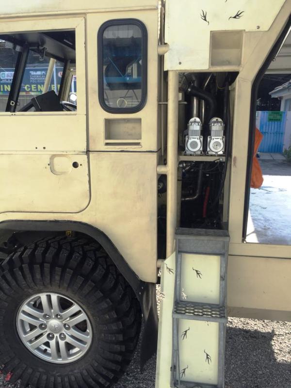

-Compressors etc work.
-Engine starts and runs nicely but very noisy I will assume that will change once its outside and all covers are on.
-Fan being installed to haul air over the turbo when its idling to stop radiant heat
-All the cabin panels are installed
-Window wipers work
-Rear camera up and running
-lockers work etc

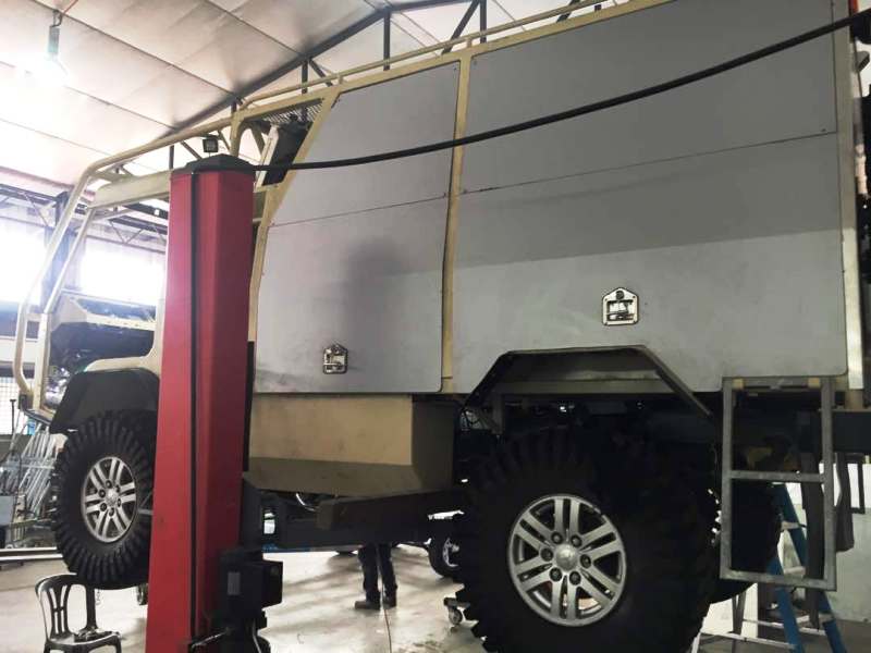

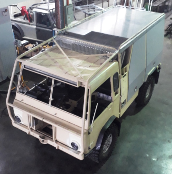

Side views not much to see

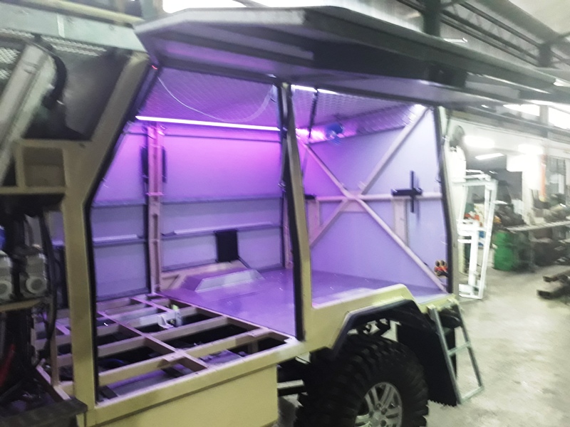

The 2 colour interior lights work
Slowly its getting complete - right view

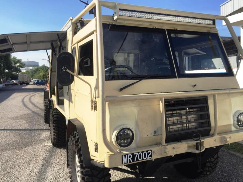

Front view
It's so close its quite exciting.

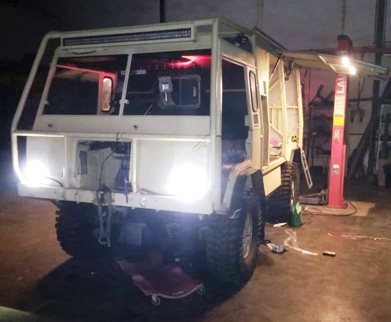

She's alive!
Friday 5 October 2018
Late night pics I guess they were working on the lights.

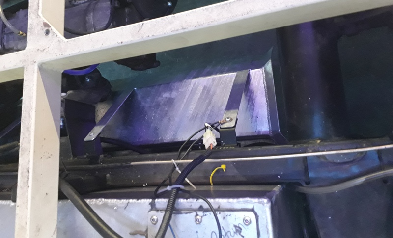

The tube made and fitted under the chassis to allow the winch cable to not catch on anything is made and installed.

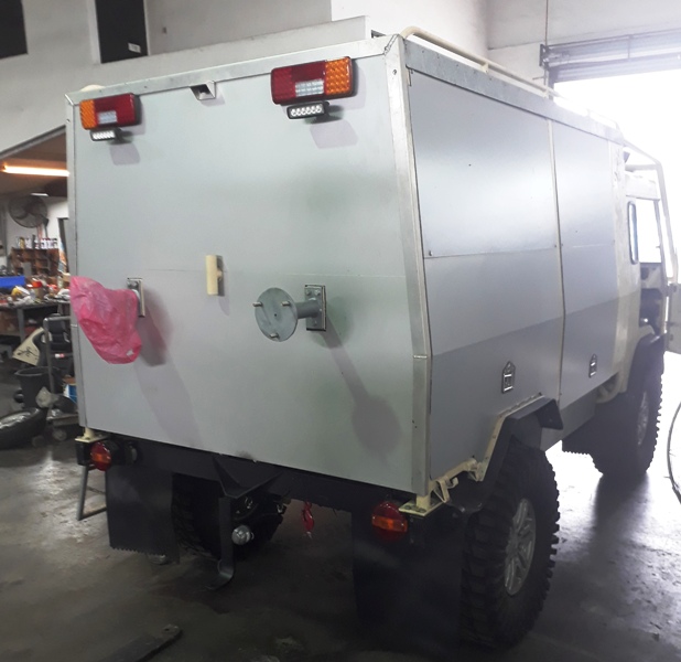

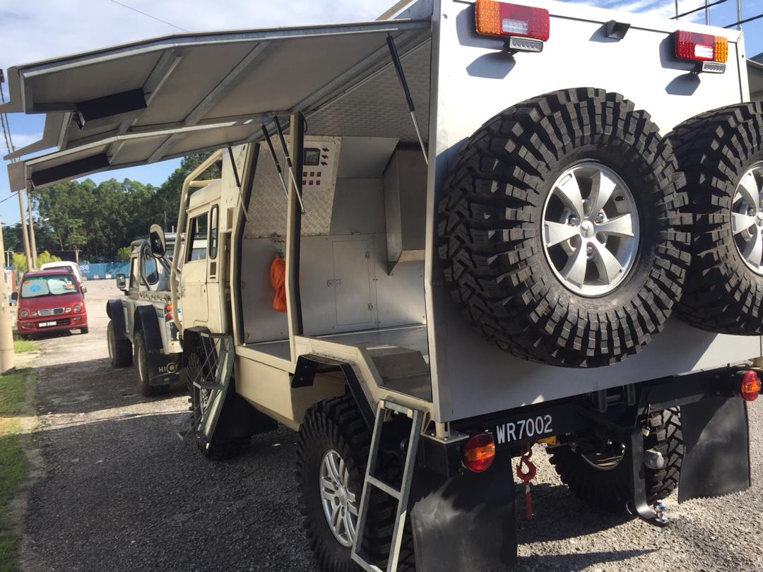

The rear side view and the new quick release tow bar for the kayak trailer all fitted

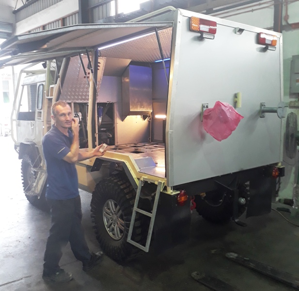

Brett smiling as he tells me it can go next weekend and holding the remote for the interior coloured lights. The rear tire carriers have also had the studs welded on now and not pressed in.

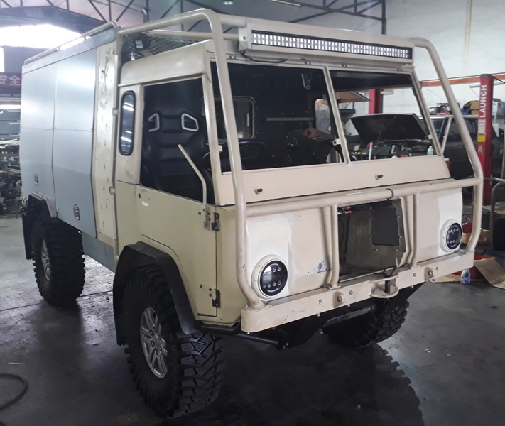

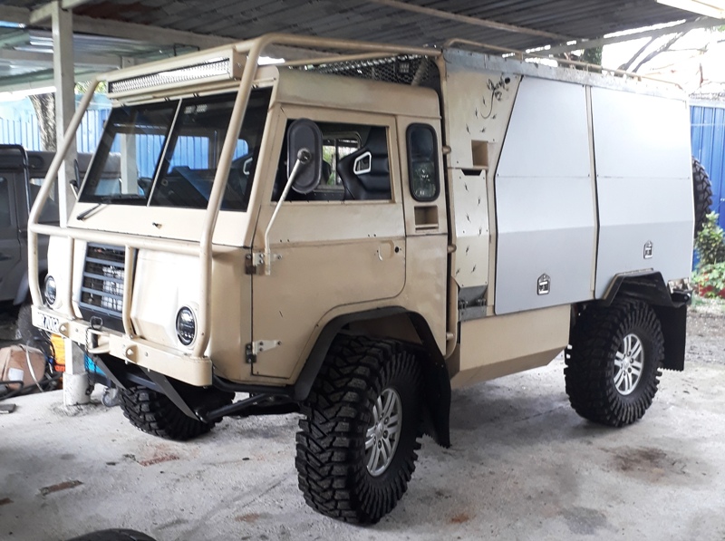

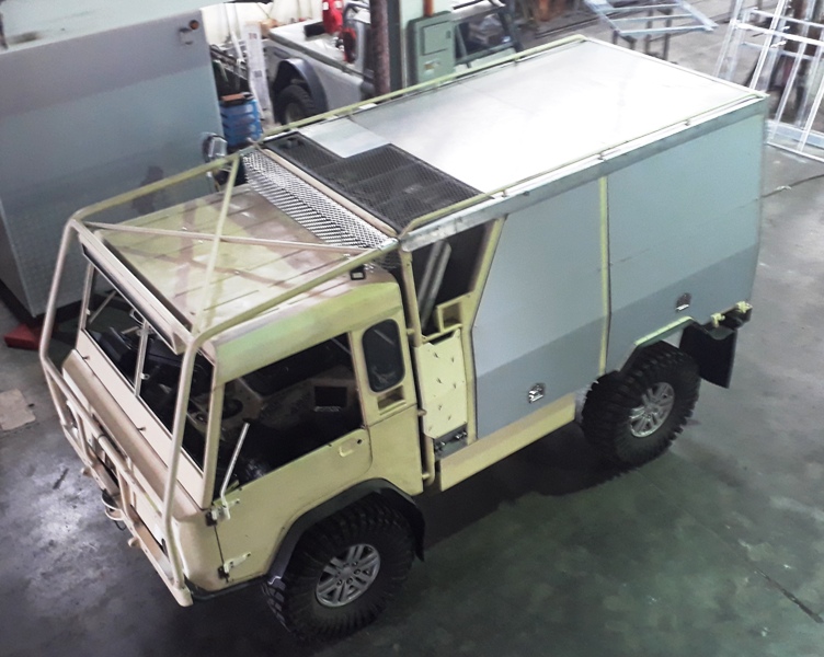

The front view and yes the doors are on for the first time in 7 years. Only the top halves to be fitted now.
Grills fitted on top of the rollcage to protect the radiator and air conditioning.

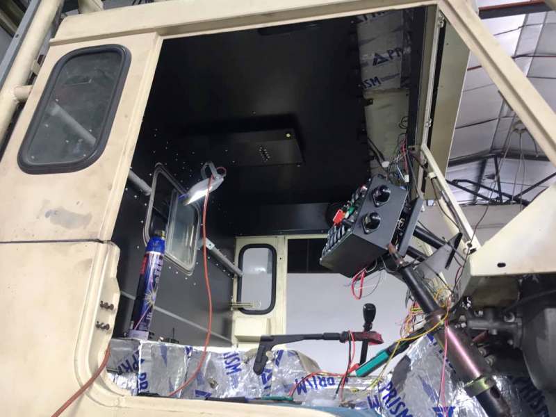

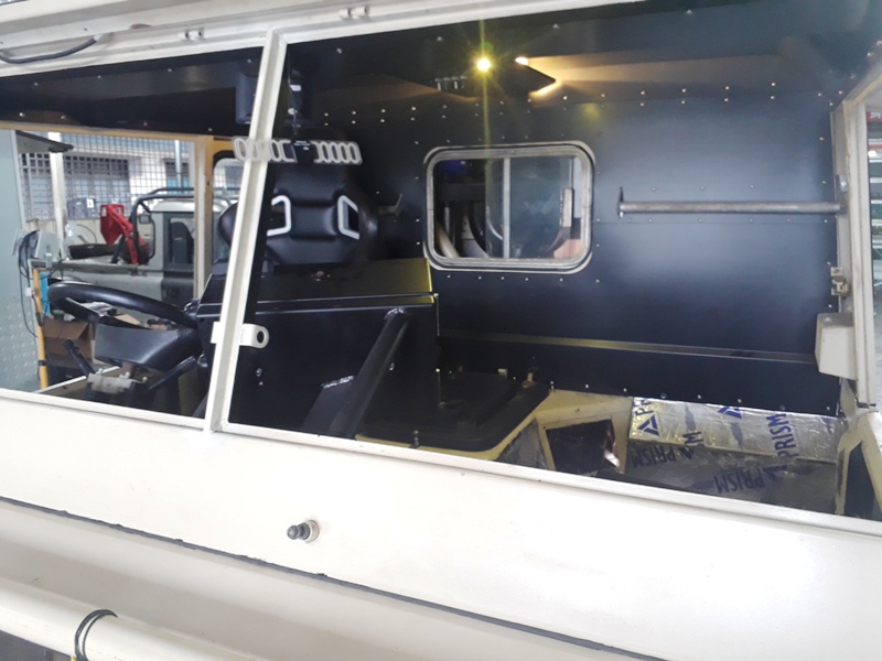

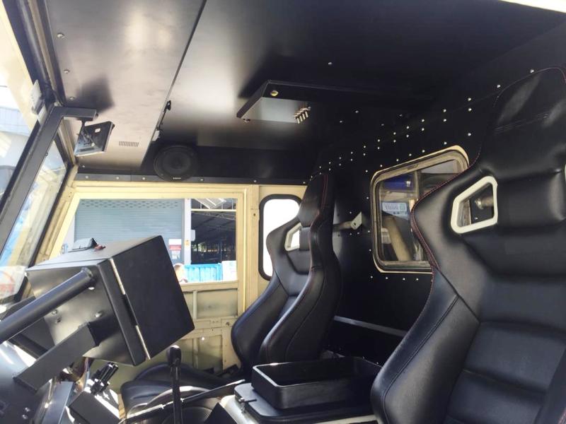

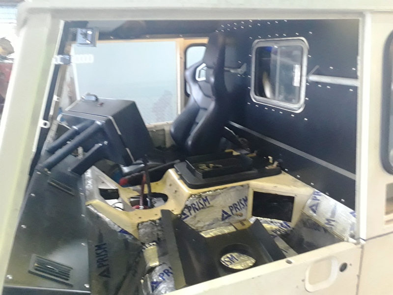

Everything almost fitted in the interior one seat and the gearbox cover to go. Leaving only the covering of the tunnel to be done and some minor painting of black around the window.
I hear I'm going to have a big issue at road transport inspection as I have changed the interior layout and also lined the cabin sigh! We will find out on the day.

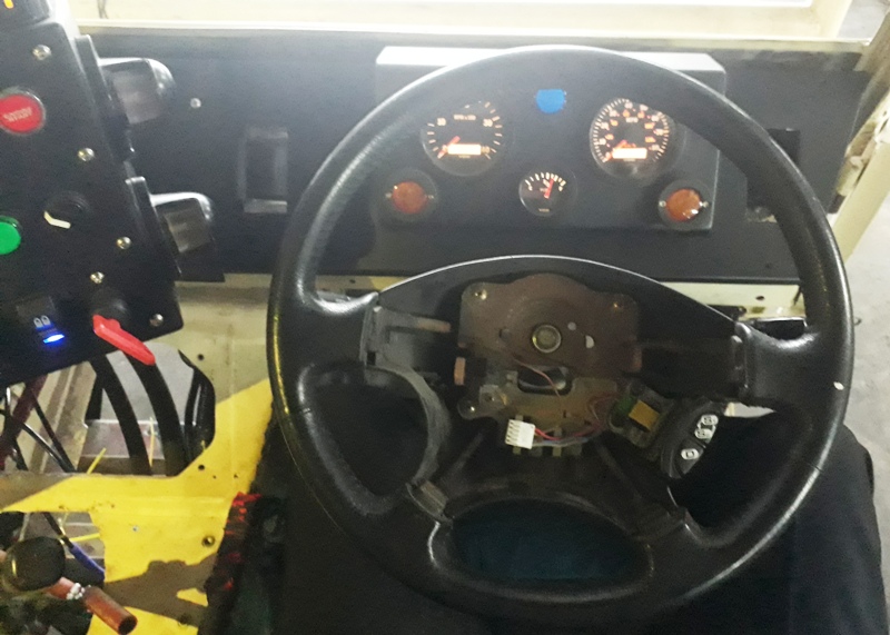

The interior looks pretty good. The steering column cover is still to be found else they will have to fabricate an alloy one.

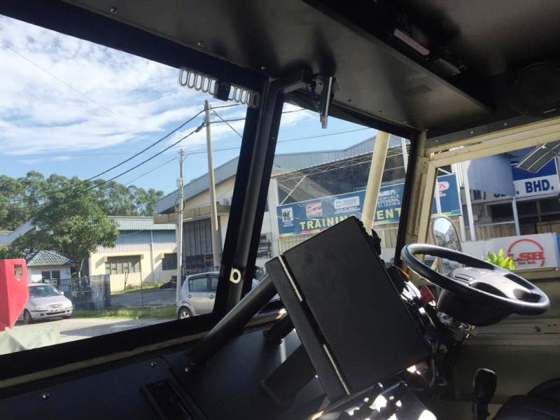

I can see all the instruments from my seating position.

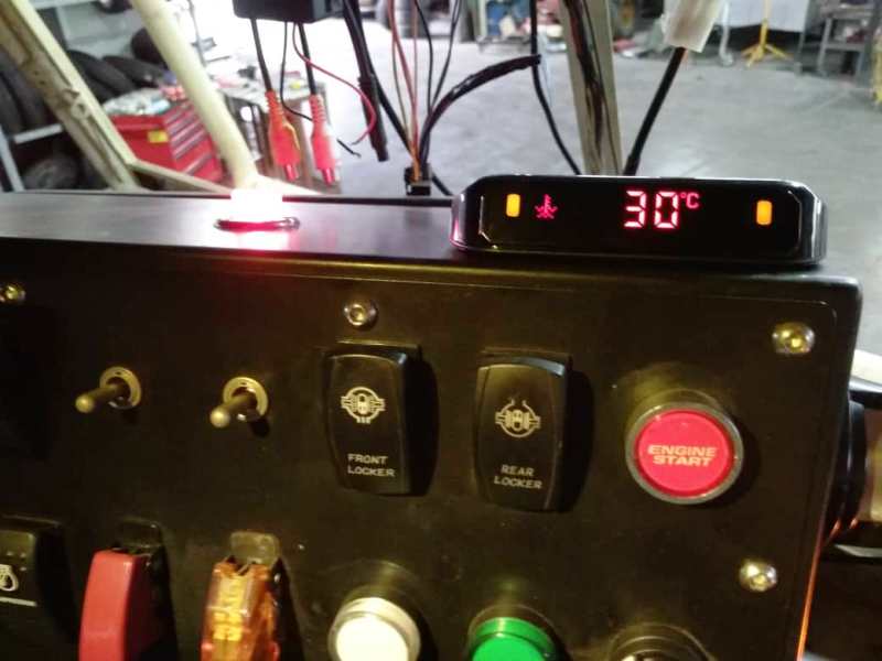

The console looks good. Everything works except the 18500lb winch and the 2 air cond switches need to be fitted.

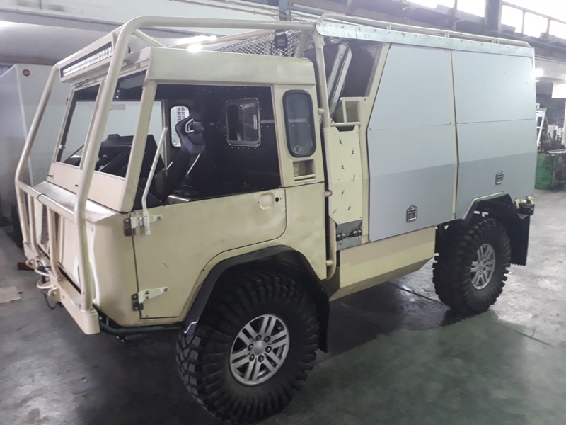

Right side view. The issue with the bottom of the poor gap at the bottom of the drivers door to be fixed in KL.

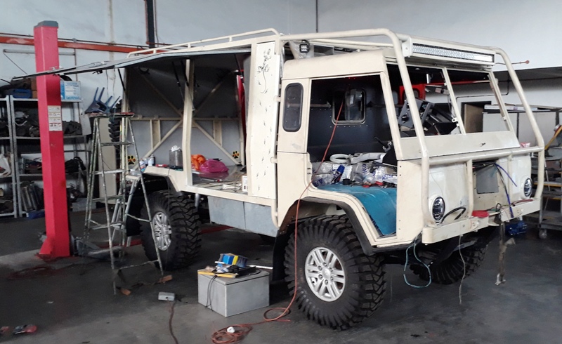

Saturday 27 October 2018
5.55AM my chauffer arrives and I give him the keys to the 80 Series Landcruiser I'm borrowing/buying while my Isuzu is in the workshop for new master cylinder for the past 2 weeks. The aircond dies lol its a hot trip up.
Biggest day in the life of the Volvo it's coming home the tow truck is due to arrive in IPOH 9am, The 190k cruises past as my chauffer wheels his way north.
I say hello and goodbye to the all restaurant staff whom I've eaten breakfast at for the past 2.5 years.

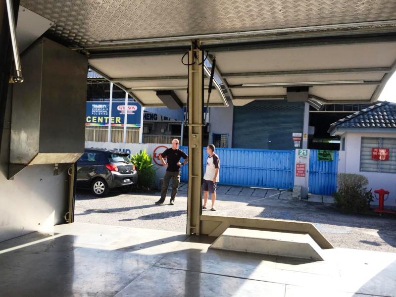

Inspection time Brett and myself inspect whats done whats good and whats left to do.
Bolted all up for the first time its starting to take shape with only the transmission tunnel and the
repaint the obvious stuff to complete.
Pensive as I look it all over will it make the 24th November deadline.

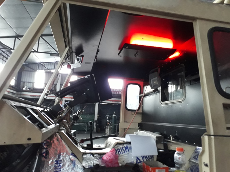

The roof console and the reverse camera.
The harness seatbelts remain to be bolted in and the engine cover is finally bolted down.
The fuel pump and fuel tank filler area is cleaner with the fuel filter and compressor tank moved tight to the cabin. The fuel feed issue fixed with the minor leak repaired.
Planning the next vehicle? Or discussing RFC next event they are both going to attend.

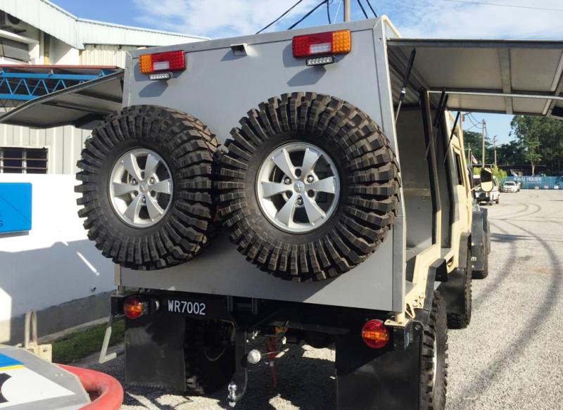

Number plates now attached and the Kayak trailer tow bar is fitted. The rear panels all bolted in we found a water leak at the end of the journey.
Spare tires all mounted we need to mount a anti vibration rack later and a wheel mounting slide/guide pin.
The newly powdercoated grill and the tool kit is now bolted down behind the drill. The new front windows were only fitted Friday afternoon.

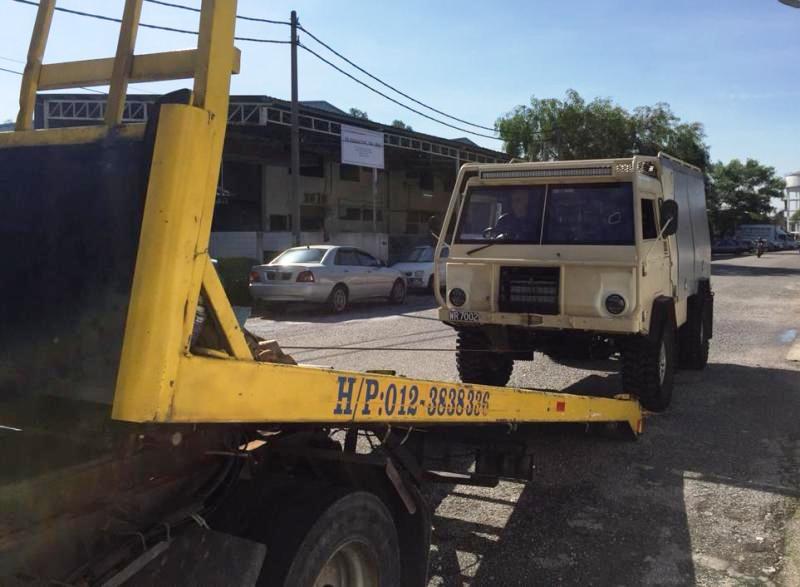

The moment for it to be squeezed onto the flatbed it fitted by inches.
The journey home uneventful apart from the tow truck struggling up every hill.
Pic of it in it's new home tonight. I took it for a drive before parking it in it's new bay while we finish it. Very night drives quite well apart from the shuddering steering which we think we know whats causing this.

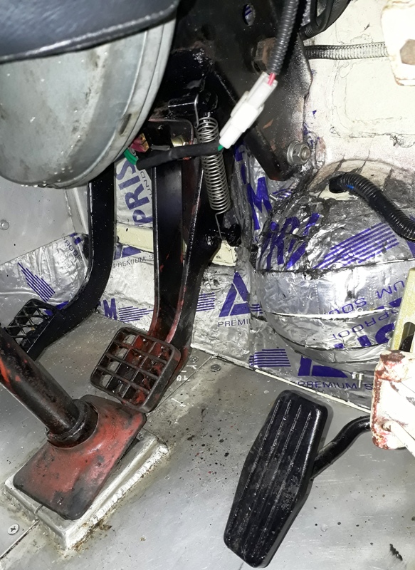

There is only 2 items to fix before we can get the inspection done:
Power steering shaking
Brake pedal return spring - done fitted
Rear cabin seats 2 to buy and get all bolted down.
Spring for the brake return fitted.

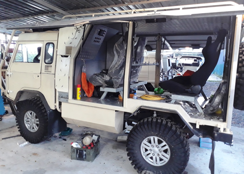

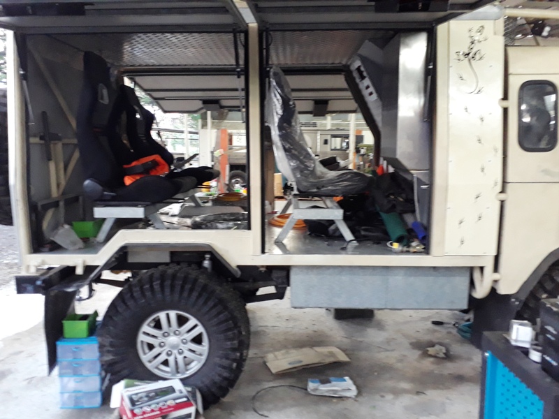

Seats and frames being bolted in and the spare parts etc being removed from the rear cabin.

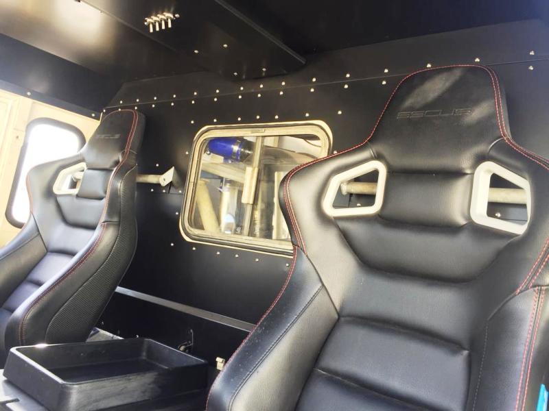

OK, explain the middle row of seats here. Looks like it would be a very boring ride w/out windows. What about the back row as well?
My guess is it's all about the inspection.
Or it will be easy enough to cut some windows into the panels...?
What is the purpose behind this/these vehicle, tours, or?
