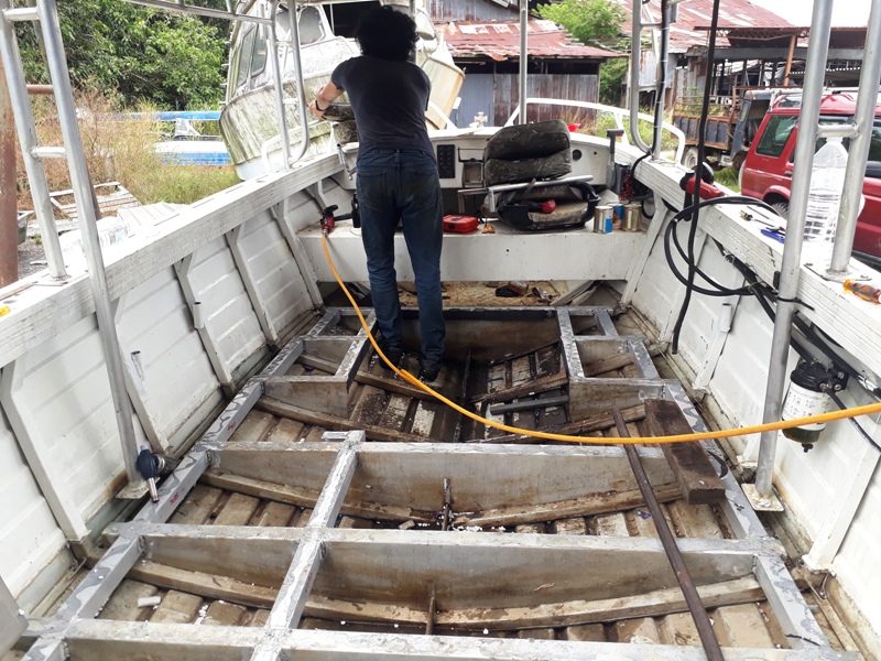

The workshop is closed for the weekend so I elect to drive 365k up to the boat factory drop off Adam's Volvo Axles for his Volvo and help them strip my boat and collect the 2JZ-FSE and bring it down for mods it needs before we install it.
Takes me 4 hours to get to Butterworth (Penang) the traffic was hell.
So we only start work at 11.30am on the boat.
By 4pm we had the boat stripped with only the seat left to cut out.

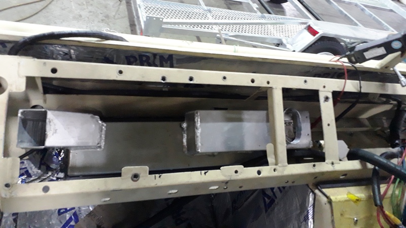

7:40am and then at the workshop at 8.30 to wait for it to be opened. I have the overhead console with me which I collected last night it looks ok maybe.
A quick fit trial shows it's not in good enough condition and needs to be remade with a different style so no welding is needed inside.
We bend up the top panel and the bottom panels. The bottom panel is trial fitted and looks ok.

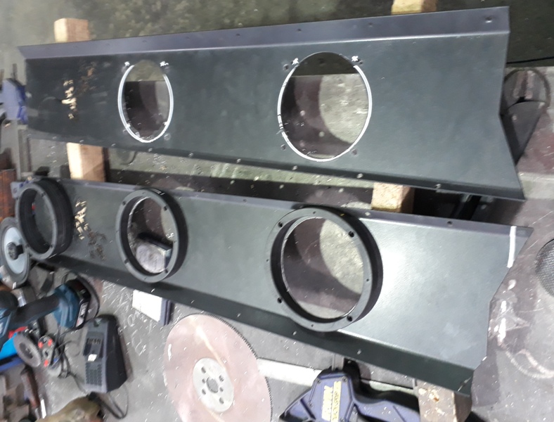

I go out in the afternoon and collect new speakers and then spend hours preparing one speaker to fit the panel.
8pm I get assistance from the boat builder and we work on the speaker panels again. All 4 base plates are cut away to fit nicely. The 4" speaker holes are expanded for the 6" speakers and we trim a tab off and a test fit reveals they fit nicely. When finish they need to be stripped and re powder coated.

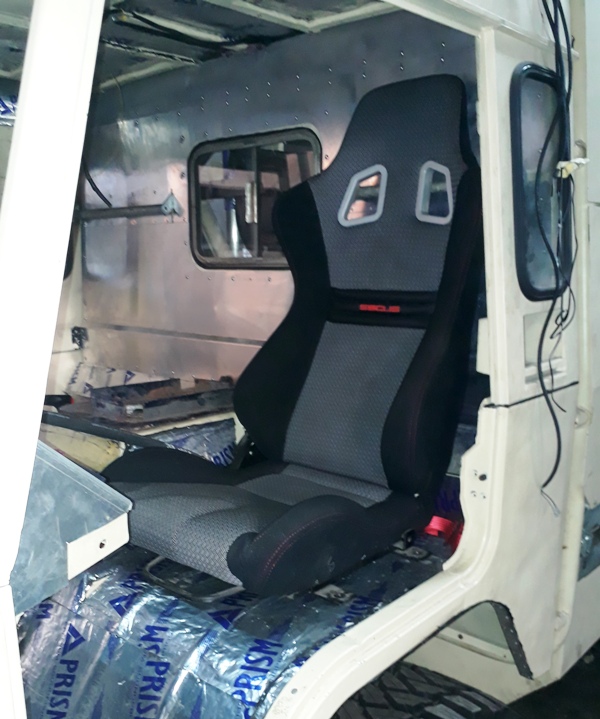

We test fit the chair. I already have bolted in the middle panel and spent the afternoon getting all the holes drilled some 80 rivnuts and been drilled and installed incpuding redrilling the speaker rivnuts from 4mm to 5mm.
Then its time for a dash review and we set the drivers seat in then start the dash panel layout design.

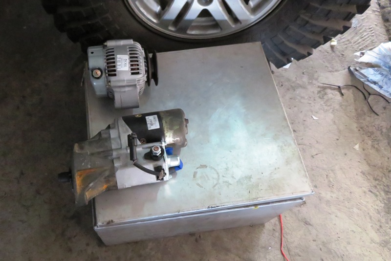

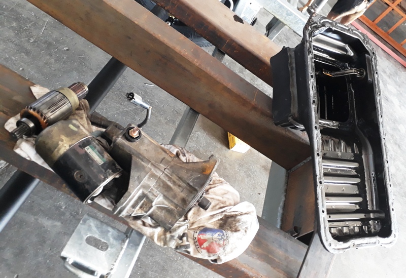

I pull the starter motor so it can be converted to 12v. OMG I realise the SUMP has to be removed to pull the starter.
So I drain the oil and pull the sump off. Then pull the starter motor.

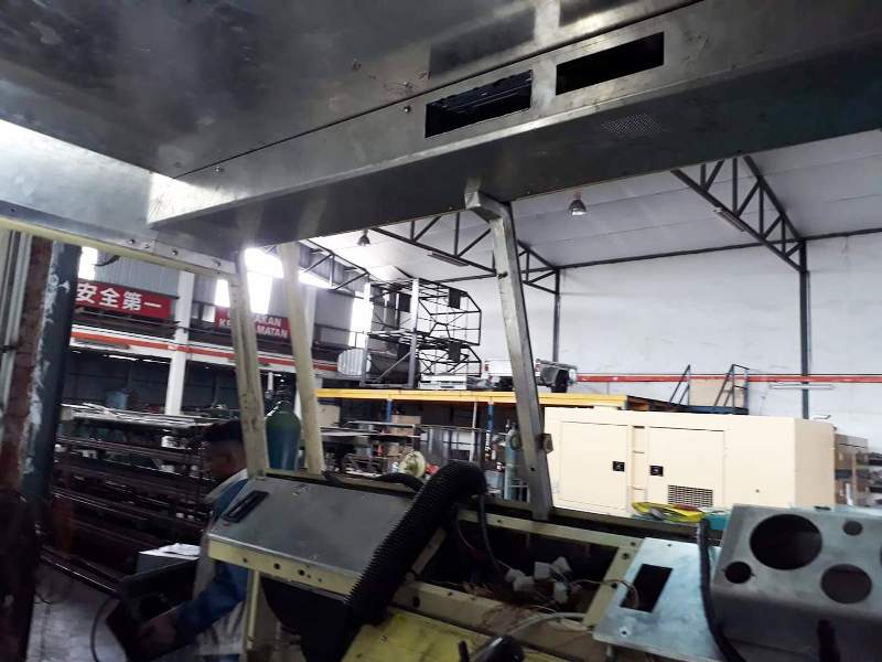

The passenger side of the ducting is ready.
and the middle piping is alomost finished.

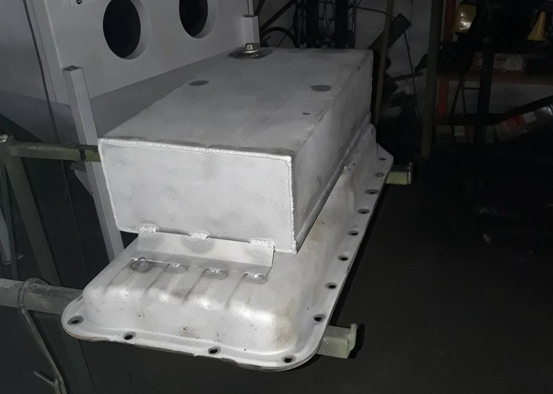

It's decided the 24v starter and alternator are to be removed and dropped down to 12v. So it's sump off damn to get the starter out else its engine out. We decide sump also needs to be trimmed and that prompts it being remade to chop the remaining sump wing and then fix it up so it can have the 2.5 litres we havechopped out.
The sump will be remade Friday.
I scoot the Starter down to the nice sparky shop. They say come back 5pm it will be ready converted to 12V.
The sump before it gets chopped (already chopped for front prop shaft) and hacked into its new shape.

They have remade the sump to retain the 2.5 litres lost when cutting the sump wings off and spend the morning welding the new bottom to the top.

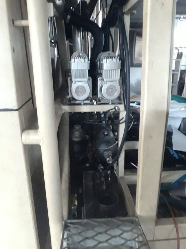

I re-fit the second air compressor after the workshop destroyed the previous one and leave it for them to re-wire.
I have to pull the 12v and 24v alternator today and then take the starter down for conversion.
I get the 12v alternator and brackets stripped off. Then pull the 24v alternator. Down to the auto sparky shop. Get a 12v replacement for the 24v alternator. They convert the old pulley to the new alternator I wait an hour for this to happen.

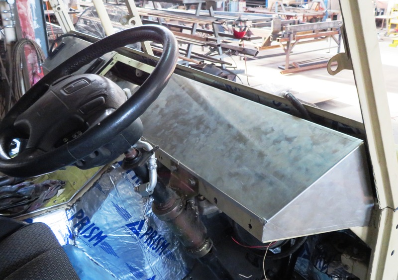

Meantime Raj has built the removeable drivers dash panel template (access to clutch and brake fluid) ready for them to now make the swingaway instrument panel.
Tomorrows work fit these.
Compressors all fitted and wired in again.
The sump is completed and sandblasted and now ready to be painted Monday.

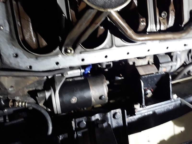

Workshop 8.45am fit the starter and by 12.00pm it's all installed and I have hopefully made it waterproof and the engine sump is cleaned ready for the sump install.
Lunch then the fone goes - office I pull the work laptop out. I get the alternator installed with 3 turns
holding it in and the office calls again the day is a bust and by 5.30pm I have done no work on the Volvo all afternoon except stare at office computer screens.

I work on stuff outside the cabin while Raj finishes the air cond ducting mounting points and drivers vents.

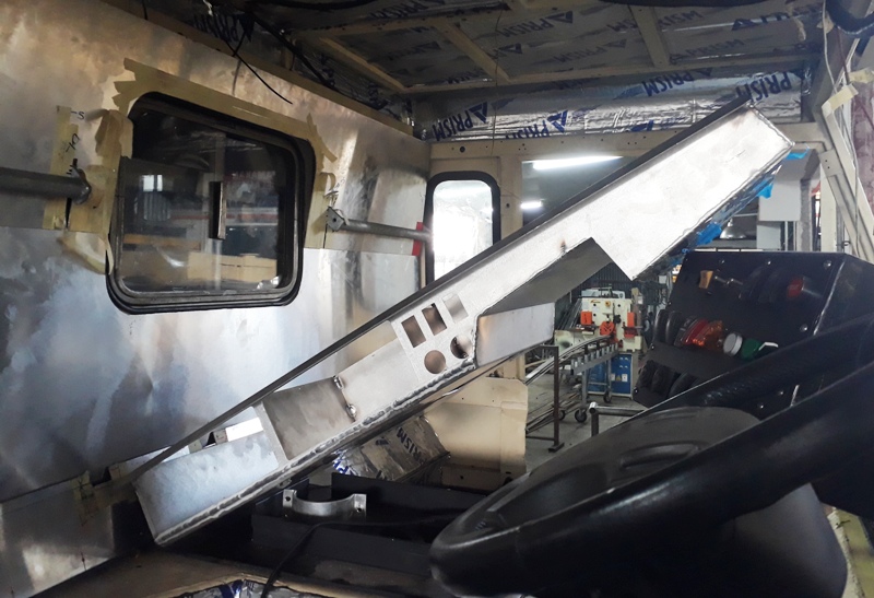

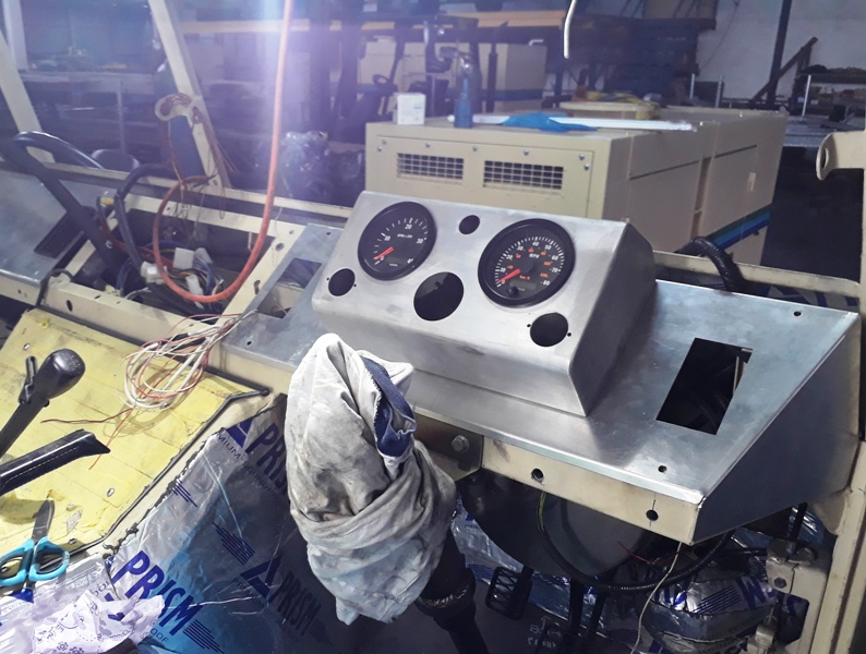

Raj starts on the flip up instrument cluster to on top of the dash cover he has just made.

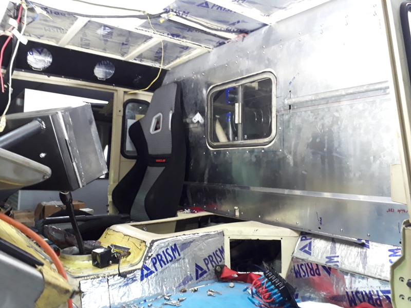

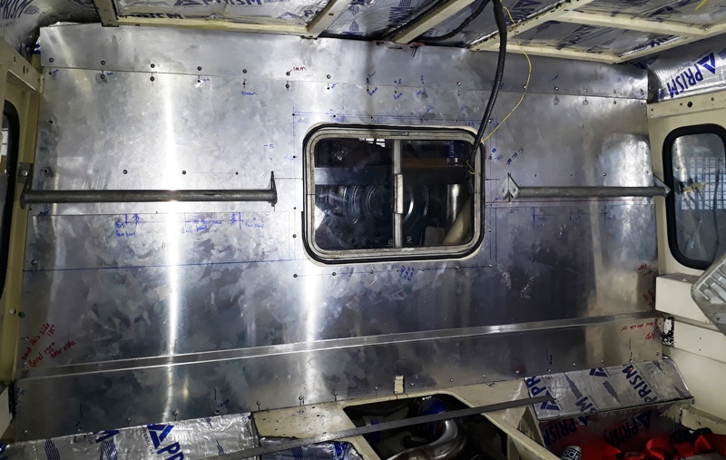

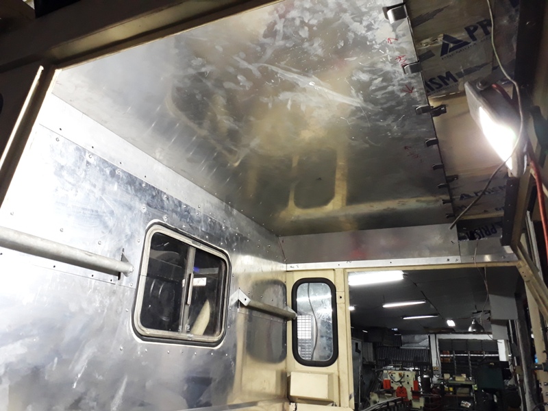

I manage to finish the top panel it all lines up and bolts fit perfectly.
Sunday 11 February 2018

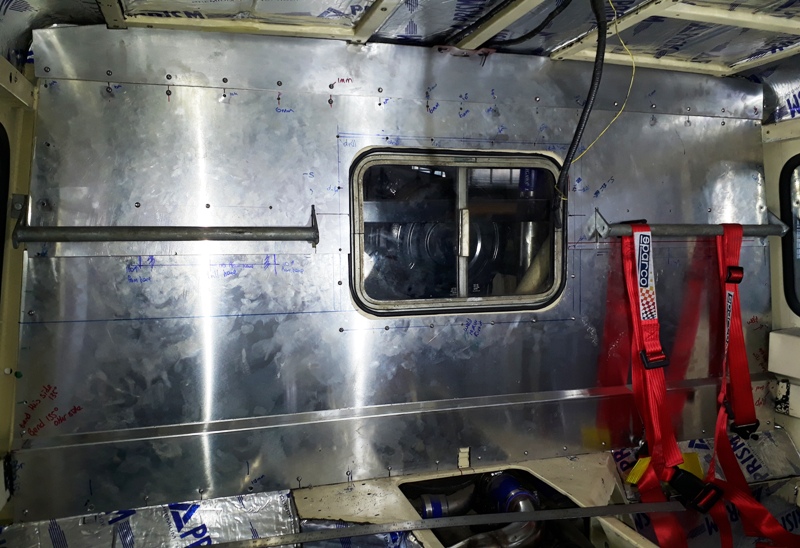

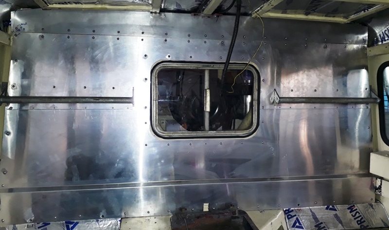

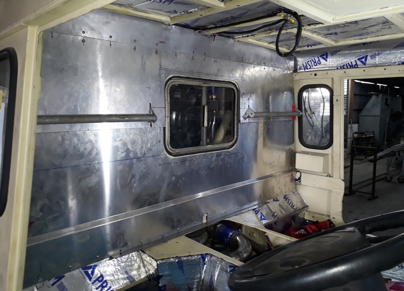

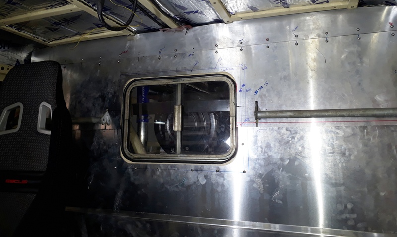

By lunchtime I have the middle panel fitted and it is almost finished just the window trimming to go.
By evening I have all the rear panels fitted nicely and have 1 hole to weld up and 2 holes to relocate to avoid the speaker panels.
Cleaned up the panels look ace well worth the effort.
I fit the wifes seat to see how it will look.

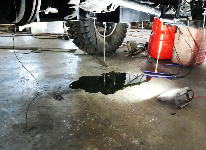

Workshop 8.30am and see the puddle of oil on the floor - cry sob nooooooooooooooooo!!!. Its done the landrover thing and marked it's territory.
So my days work is decided. Drain the oil. Kitty litter on the oil slick. Then when all cleared undo the sump - 2. hour to remove the sump. Find the leaks and leave it for welding.

Will you stuff insulation between the aluminum panels and the outer body?
Any attempt to seal the panels to prevent rattling?
What an effort, they really look ace!
Thanks for posting, it's really coming together!

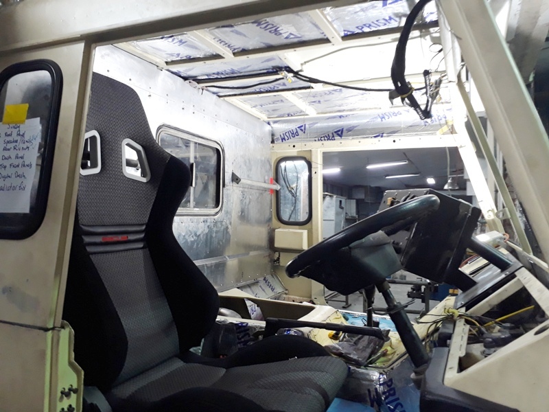

Will you stuff insulation between the aluminum panels and the outer body? Yes trying to get sound proofing material in IPOh since my local shop closed up shop and moved to new zealand sigh.
Any attempt to seal the panels to prevent rattling? yes looking at sticking sound proofing to the back or light thick foam to stop the alloy resonating. been there before it can get very voisy lol.

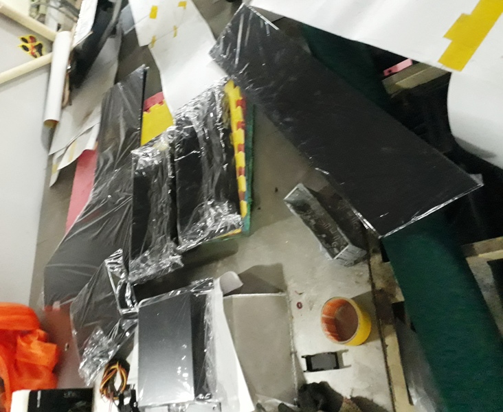

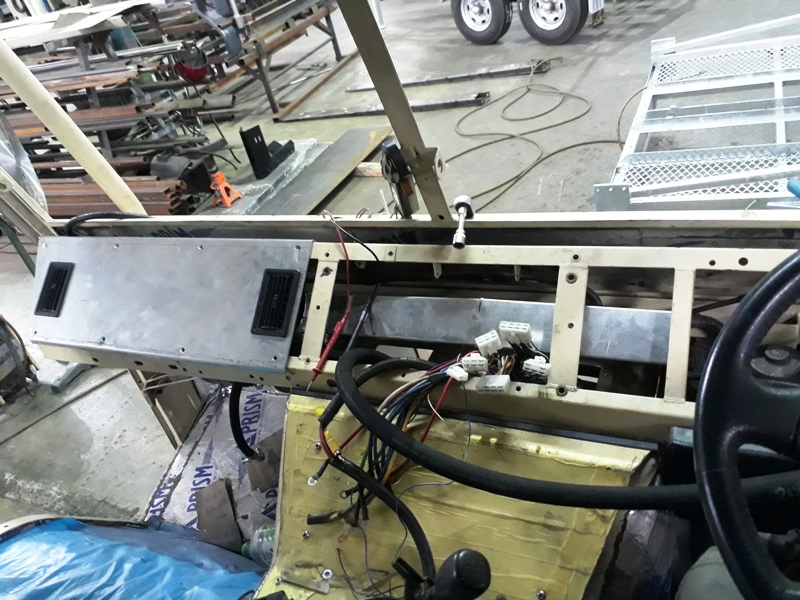

They have finished the front console and the centre window wiring channel. The goal today is to get everything cleanedup and down to the powder coating factory next door.
The sump is finished and is ready. I leak test it later in the day and it fails again. It will be fixed next week.
I strip the gearlever panel and make the plate ready for powdercoating. The engine cover is restripped then taken to the powder coating factory immediately for processsing.
The other dash panels are given final welding and making sure evedrything fits perfectly and final sanding.
