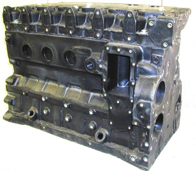

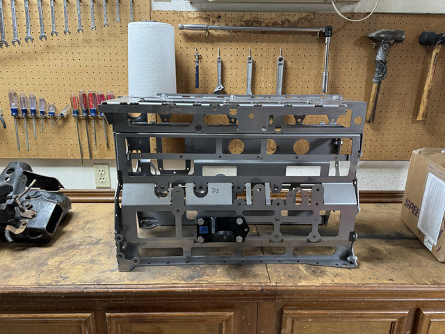

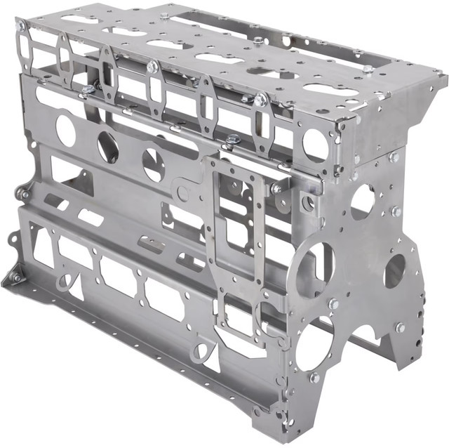

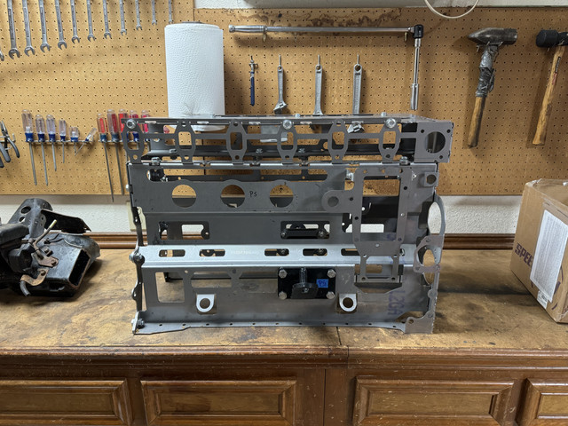

I need to clean & organize my garage to prepare for the swap, but picked up this mockup 6BT engine from Speedway Motors.
It is dimensionally correct laser-cut steel and only weighs about 45 lbs. It should make it much easier to move in and out of the engine bay to mock-up engine mounts. Since my truck is 3FE, I need to replace/relocate the frame-side engine brackets to the 1FZ location. Then modify the steering brace to clear the oil pan. Plus, just general clearancing for the bellhousing and other miscellaneous items.

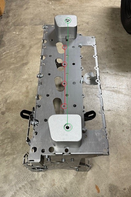

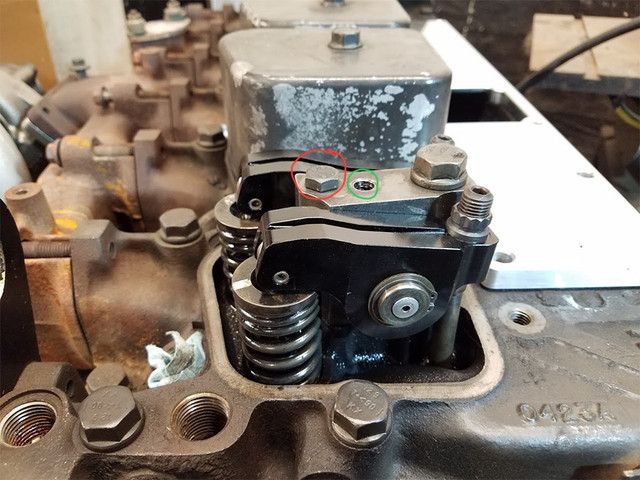

Unfortunately, the mock-up block from Speedway Motors is not going to work. The mock-up block is marketed as an exact replica of a real 12-valve engine. But it does not have the provisions to bolt on the valve cover buckets.
The real Cummins engine uses rocker arm pedestals that bolt to the head. Then the valve cover buckets bolt to the pedestals.
The Speedway mock-up block has the holes for the pedestals, but does not have the holes for the valve cover buckets. So I would need to buy Cummins pedestals to attach the valve covers. Those are a couple hundred bucks additional cost. And I would need more hardware to get them seated.
Also, it doesn’t really make any sense from a mockup perspective where you would be primarily concerned with the external dimensions of the engine. Who is mocking up rocker arm pedestals to begin with? Just include the hole for the valve cover and delete the rocker pedestal provision altogether.
There were other drawbacks as well. The steel was laser cut, which meant every edge was sharp AF. I cut myself a couple times during assembly.
Plus, it used nuts and bolts to assemble, which meant those holes weren’t available to attach accessories like intake, exhaust manifold, or bellhousing components. You would have to disassemble the stamped steel components, hold the accessory in place (exhaust manifold), then reassemble with longer bolts to clamp the two stamped steel components and the accessory. Not impossible, but a pain.

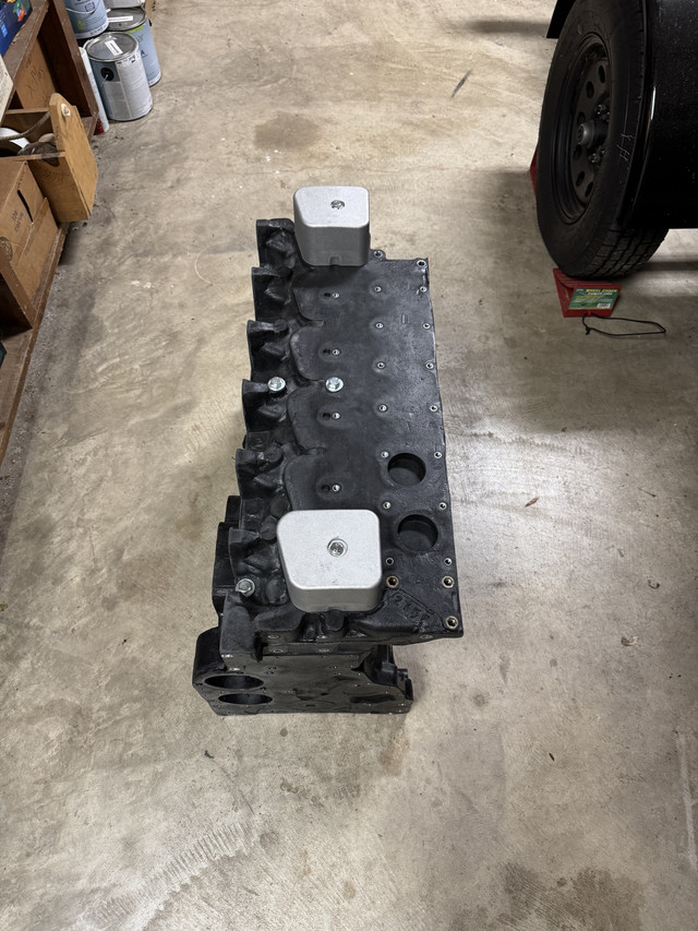

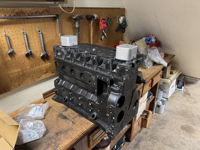

I was able to get a full refund on my Speedway Motors mockup engine (kudos to them for being hassle-free about the return).
I splurged for this much nicer (and more expensive) mock-up engine from P-ayr. It is a fantastic replica and includes nutserts for all the Cummins accessories that mount on the longblock, including oil pan and valve covers.

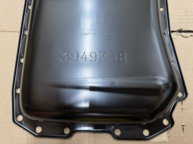

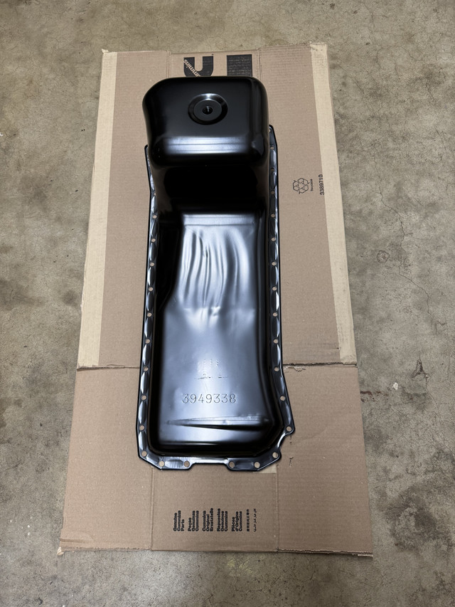

I also picked up this “swap friendly” Cummins oil pan (PN: 3949338) that offers the most clearance for the 80 series draglink. I’m not sure the specific application, but I believe it is similar to the 2nd gen Dodge setup (1994 to 1998.0). It pairs with an OEM 2nd gen Dodge oil pickup tube (PN: 3928455).
More info here and here.
