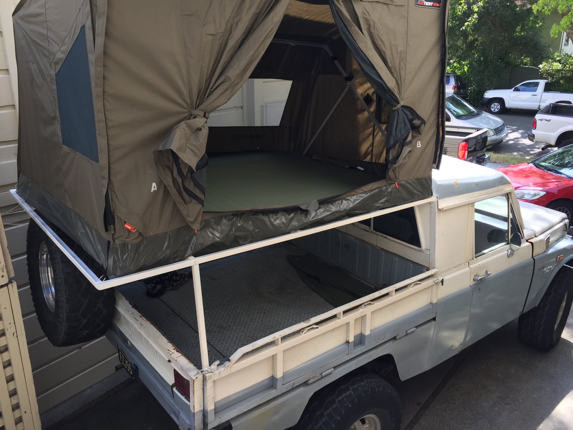

Was the rack built for a specific purpose? Why does it hang out the back like that?
Yes sir! It's the platform for the RV1 tent.
I also have a 270 awning with walls that will have quick release mounts since I will only mount the tent and awning when I go camping. The entire rack is also removable with 4 bolts.
