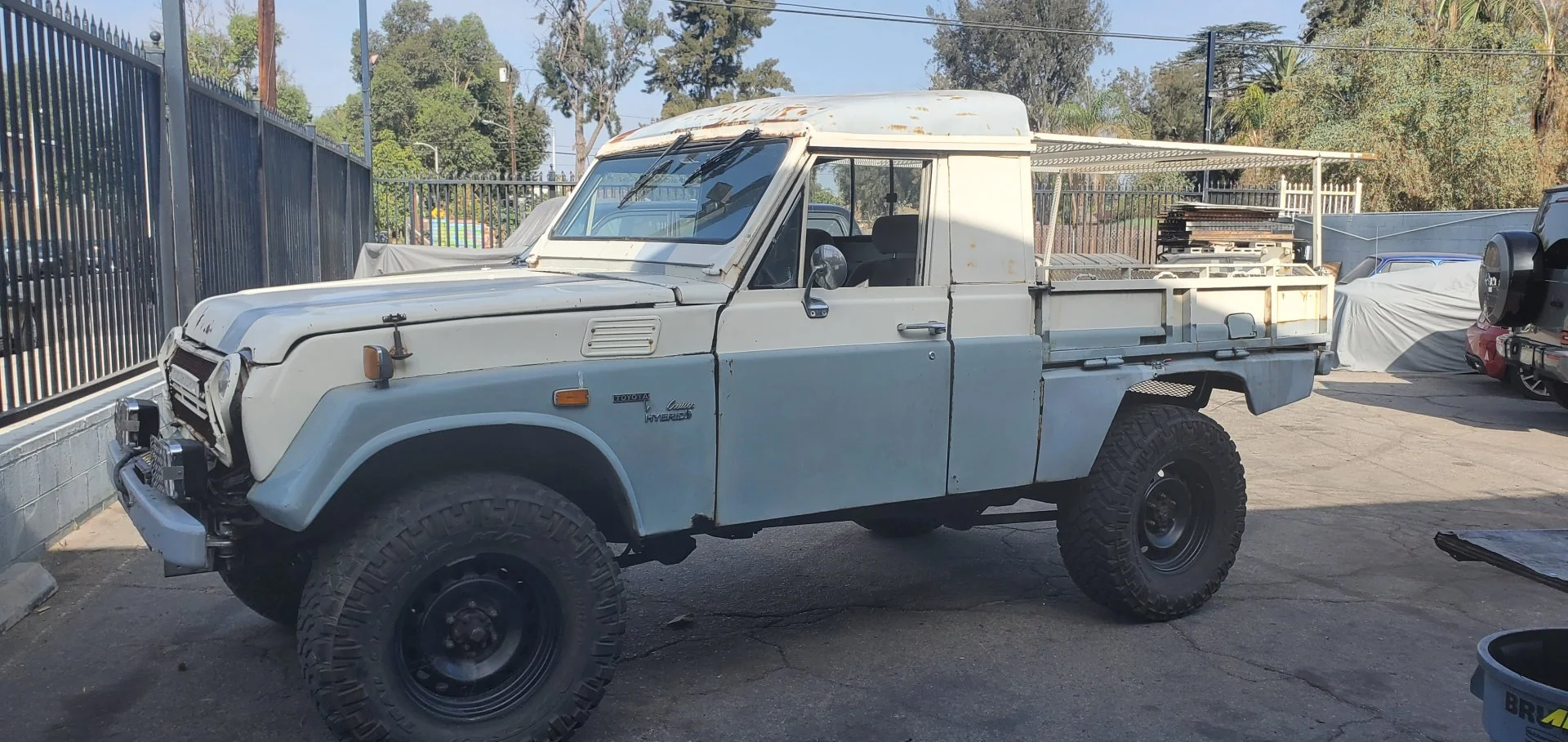

Here's a pic of the day it was dropped off last month in the middle of June. Sizzling Bacon indeed.

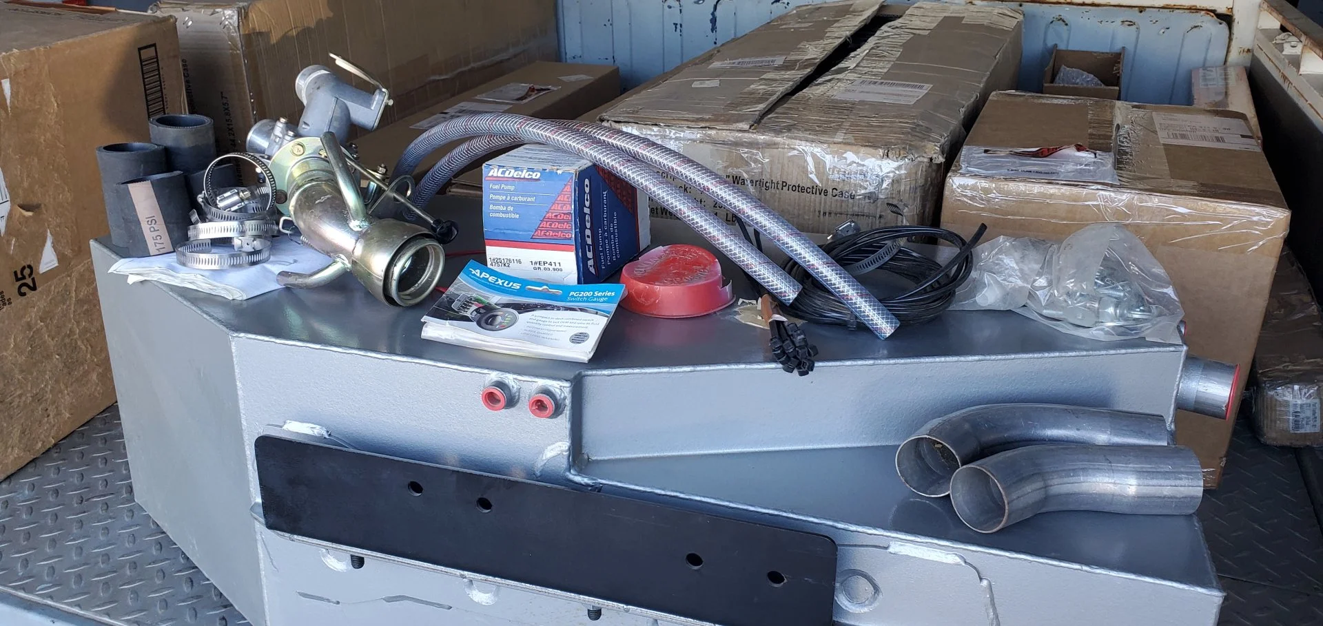

Oh yeah, exhaust will be reworked and I scored something locally for an unbelievable $650 last week that will be dropping under there.

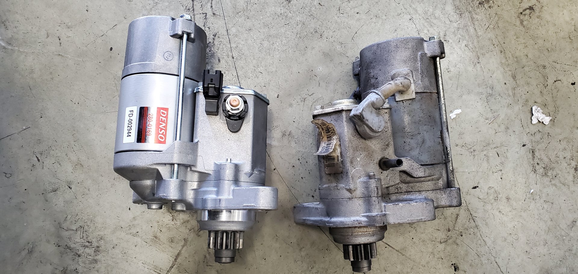

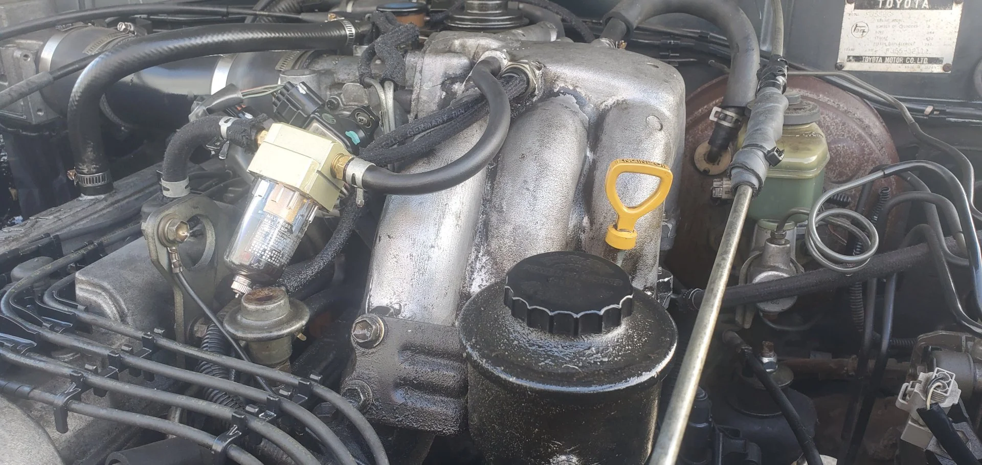

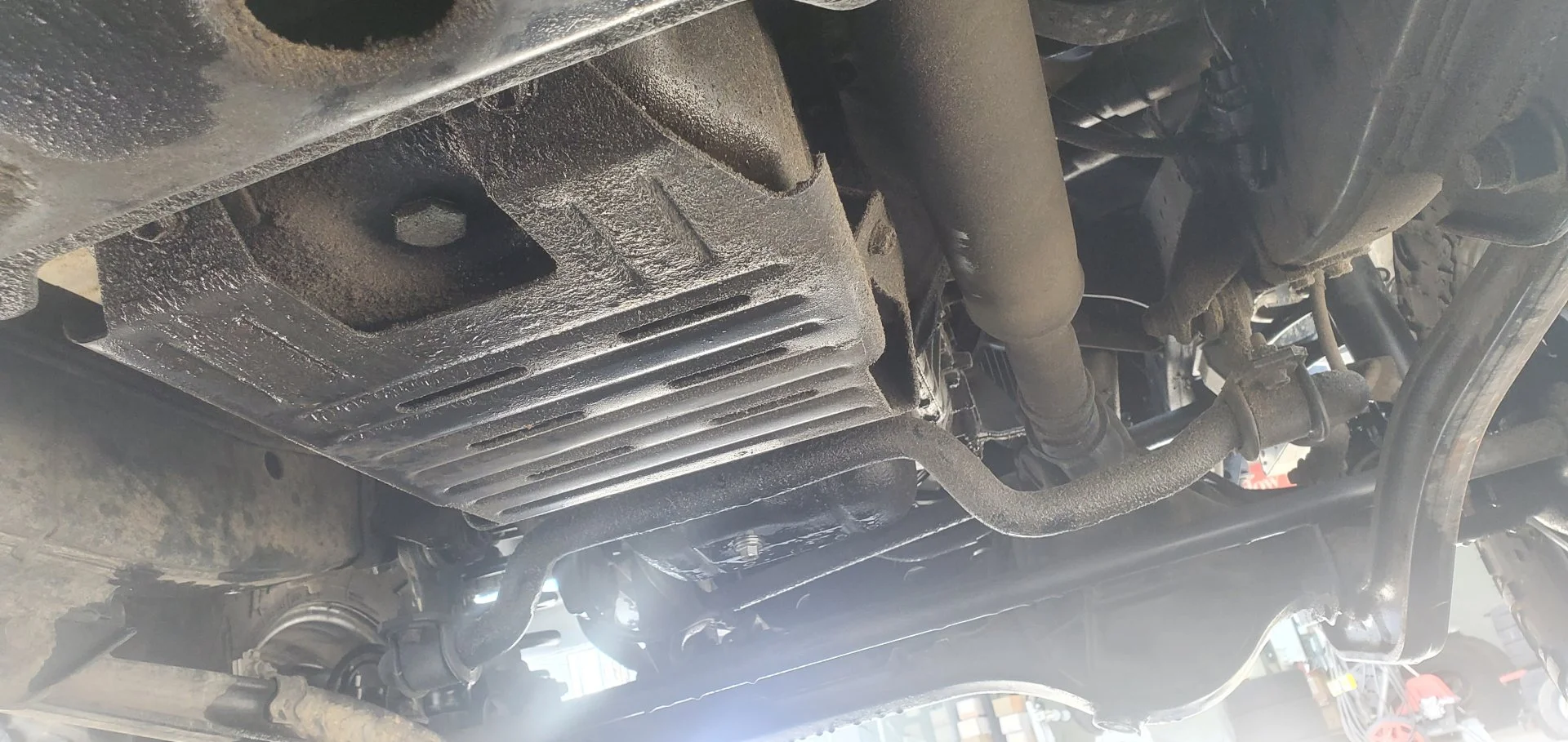

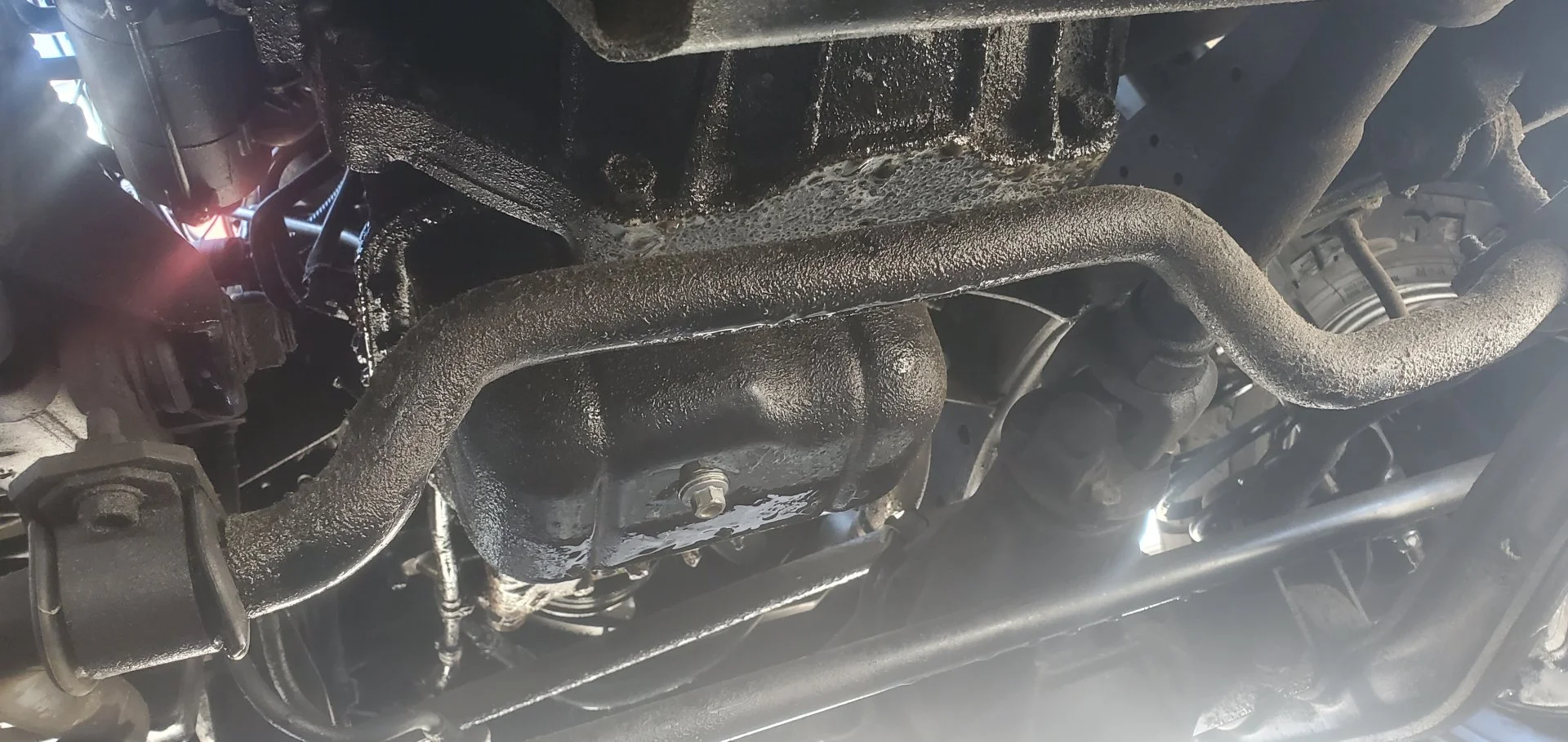

Started with a degrease and power wash to clean off years of 1fz-fe sweat.
Also replaced the starter since I was getting a few clicks to start before turning over.

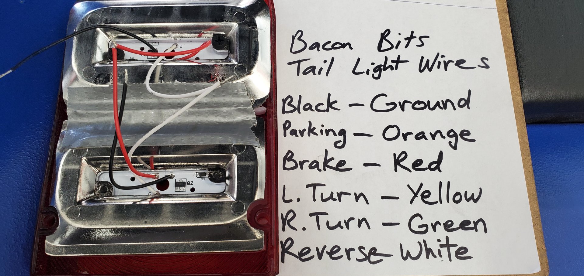

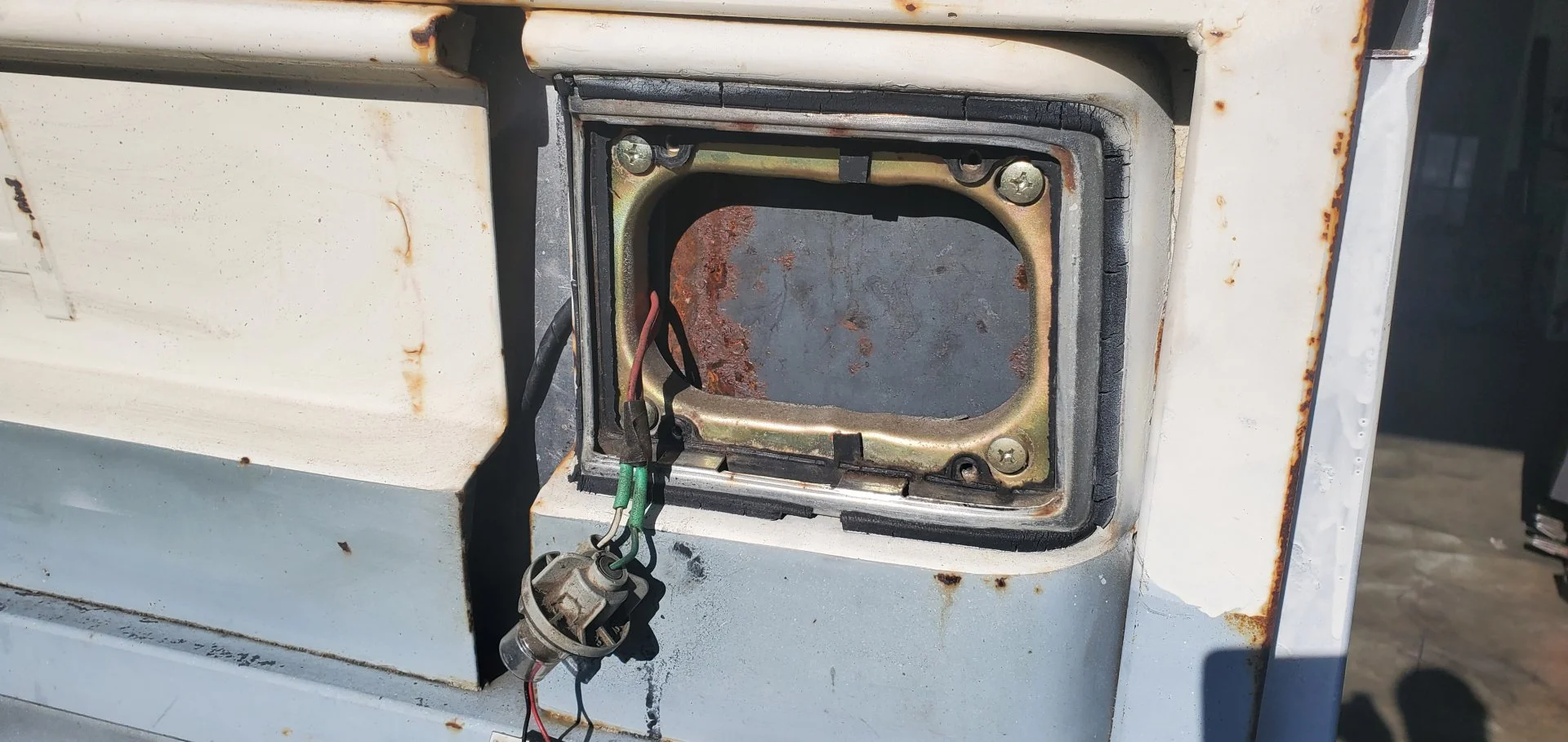

Figured out a way to make the rear tail lights functional since my plan is to keep the rig looking funky with the 70's vibes.
Used a RV / Trailer style universal LED brake light housing and tore it apart. Grinded to fit the 55 tail light covers and now I have Brake, Parking, and Signal Lights.
Planning on some under mounted LEDs for reverse. Cleaned up the wiring harness and ran it into the rear tail gate.

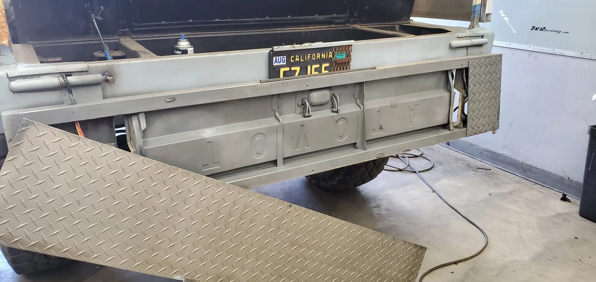

Had to add the plasma cutter and duct tape to keep with the build origin story

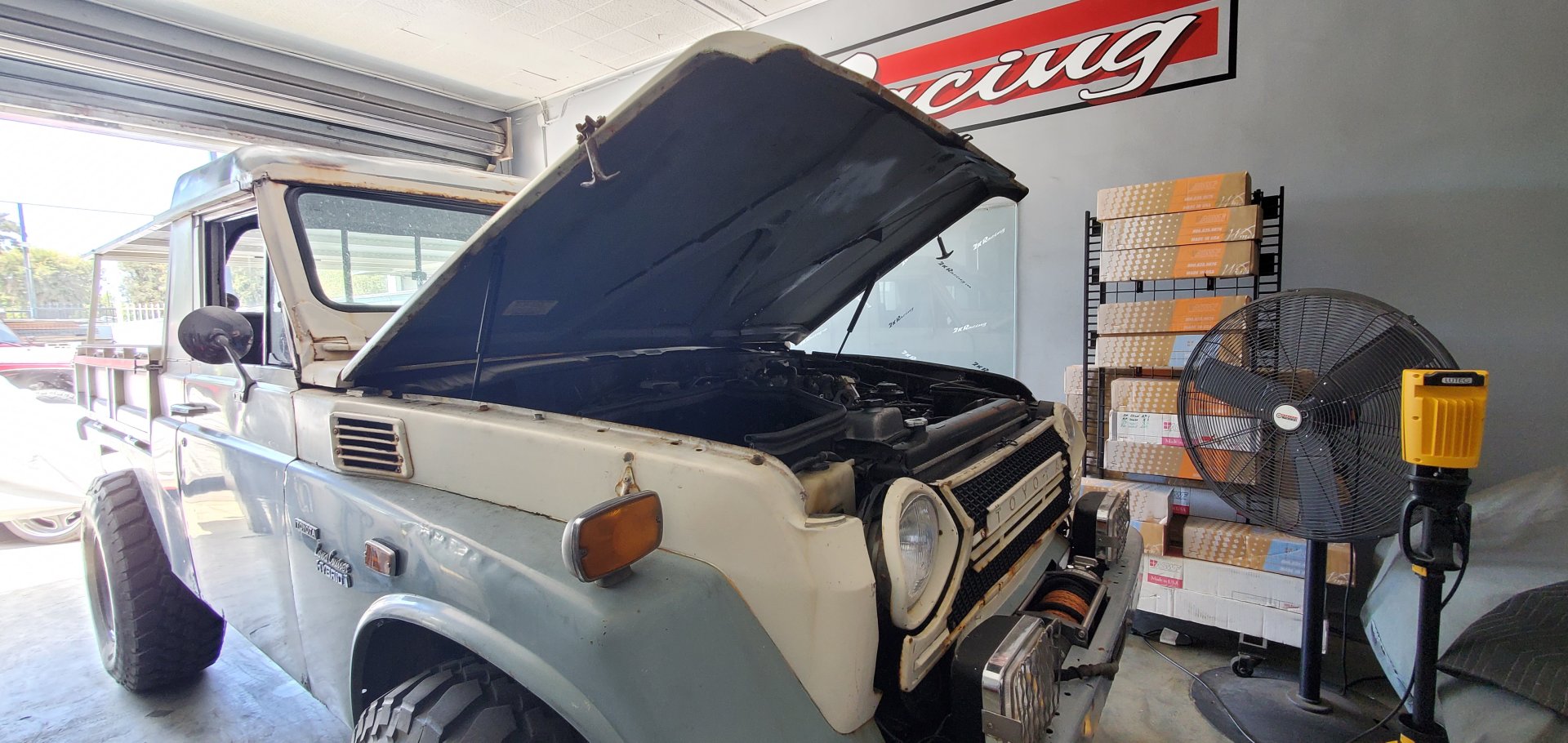

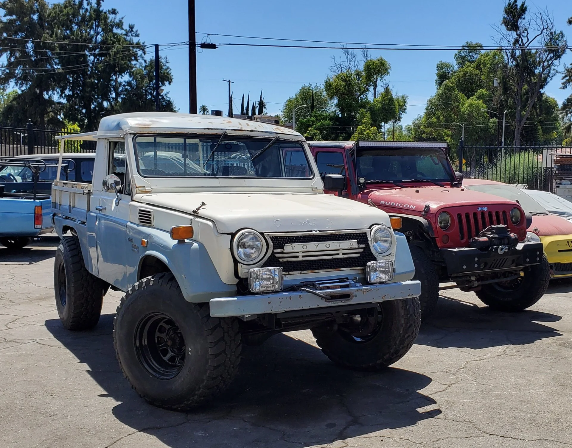

Made some mounts on the hood to retain factory 80 hood support lifts. Rattle canned over the racing strip for a solid white hood. I think it looks much cleaner without it. Also threw on some 16.5x10 steelies that had 37's mounted on them to test fit how much room I was working with. Fit great with zero rubbing on road. Offset and width was a little too aggressive but looked beefy. The JK has a 4" lift with 37s just for reference.
