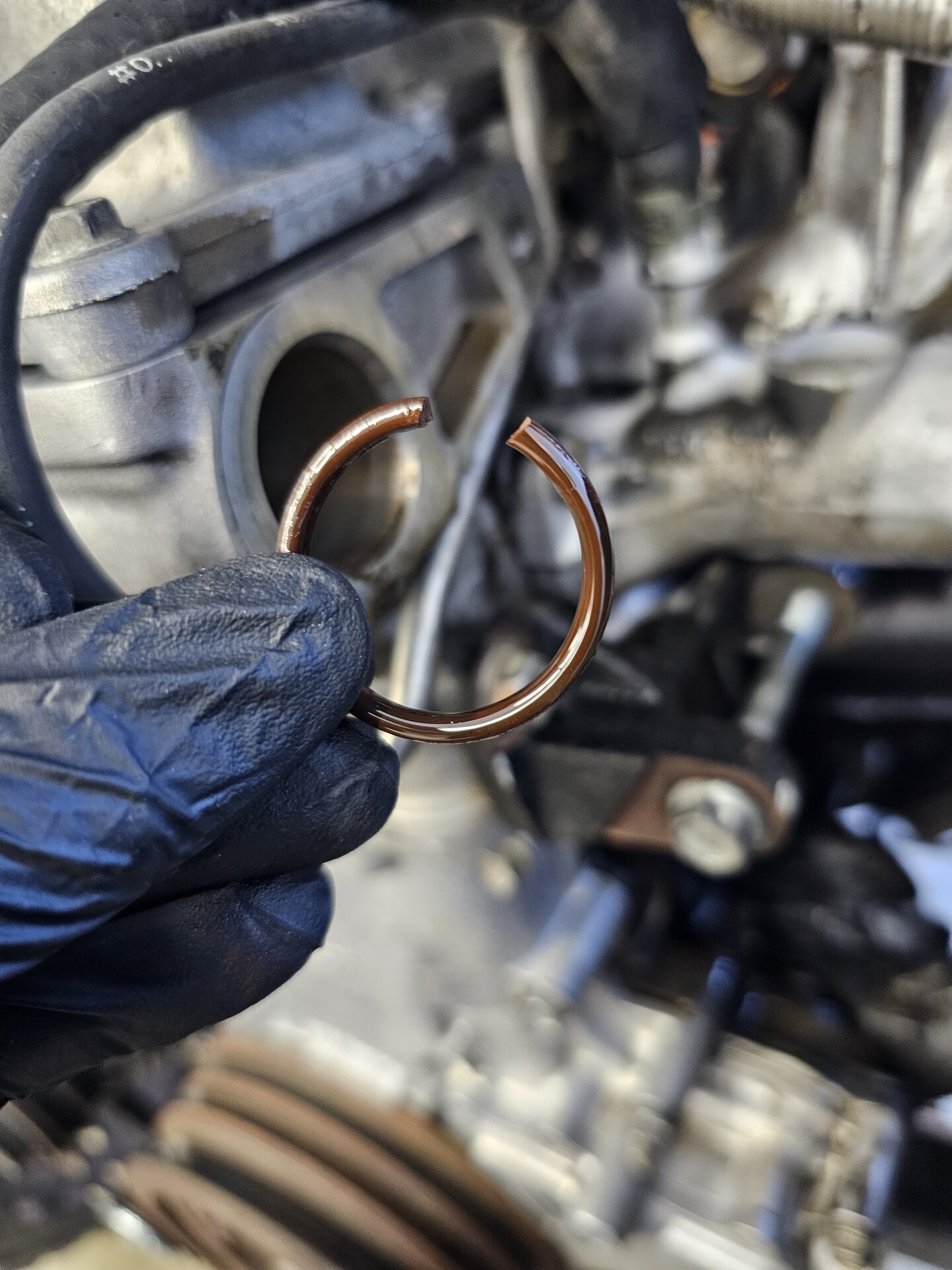

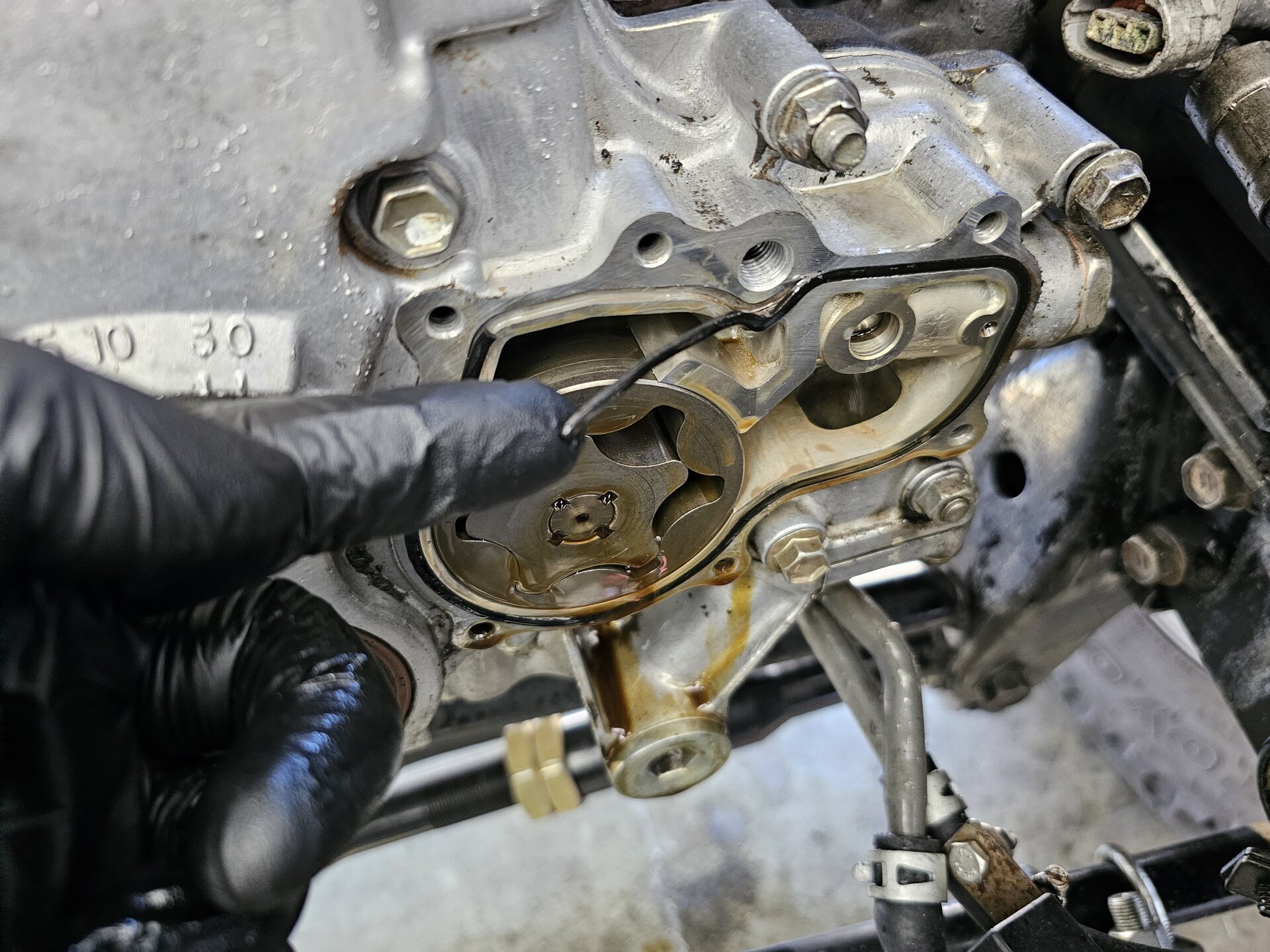

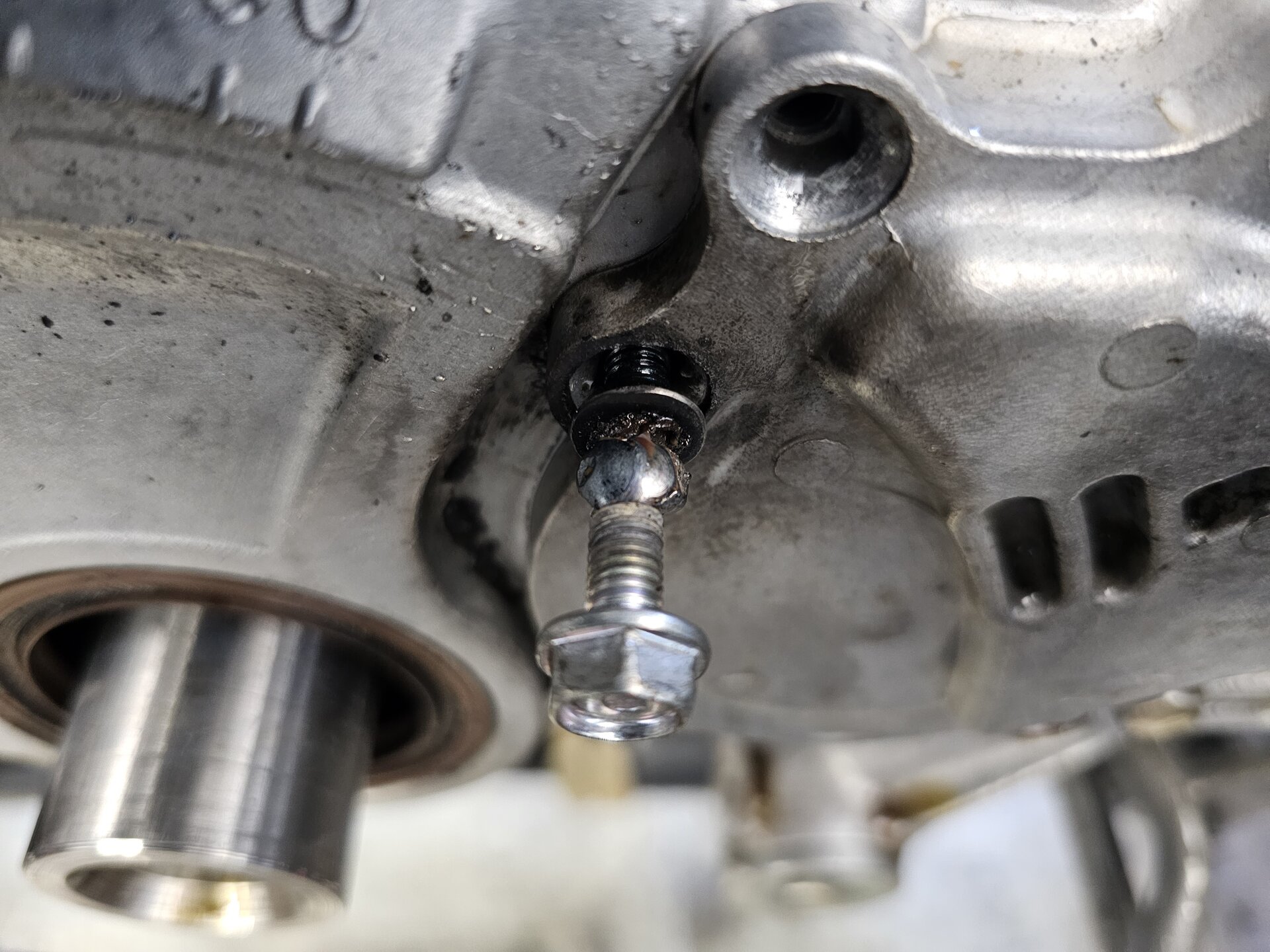

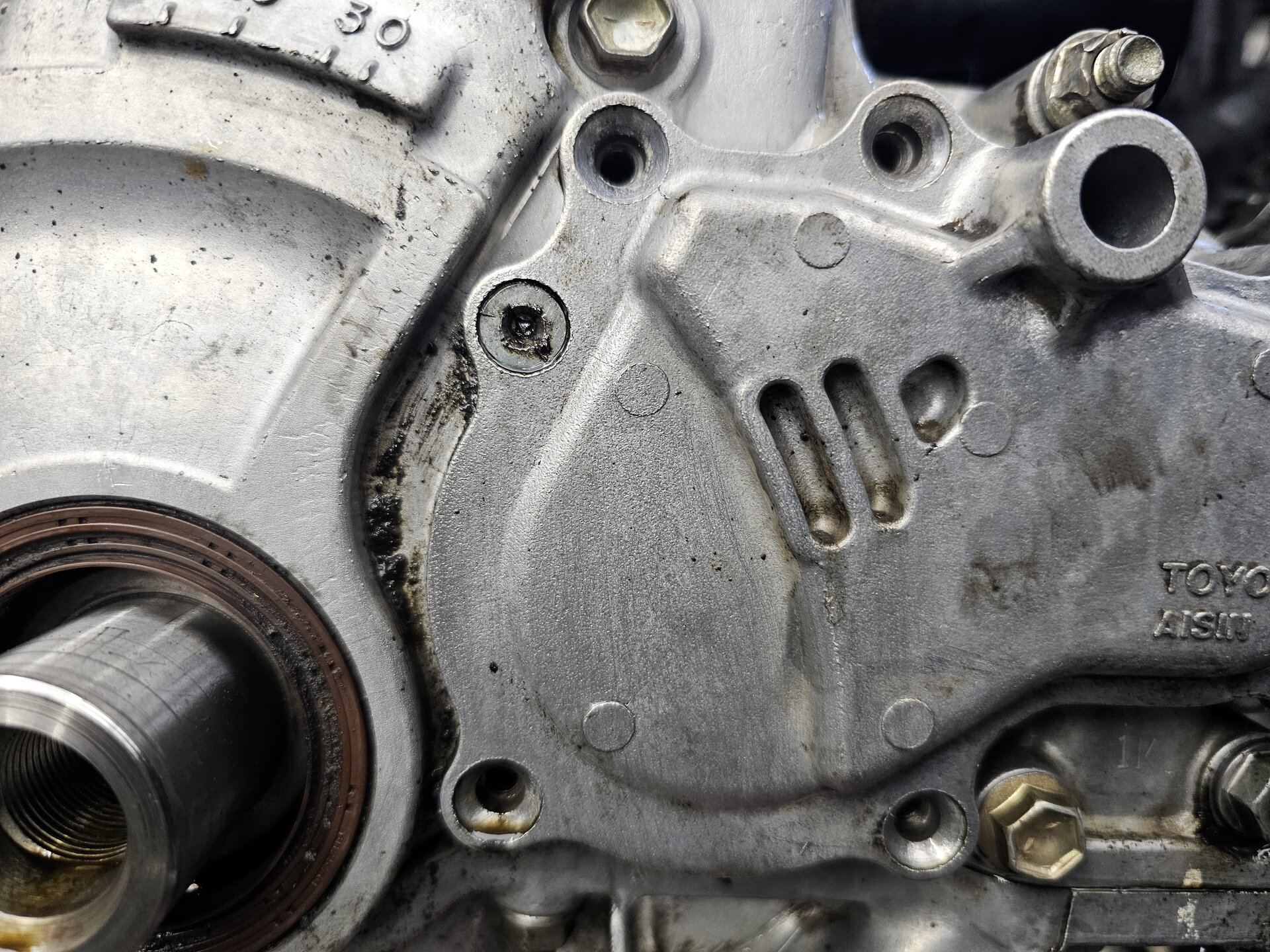

Of course one head had to strip. Welded a bolt on and came out easy enough. Installed New Water pump, Thermostat, Crank seal, Distributor O-Ring and Mean Green Alternator.

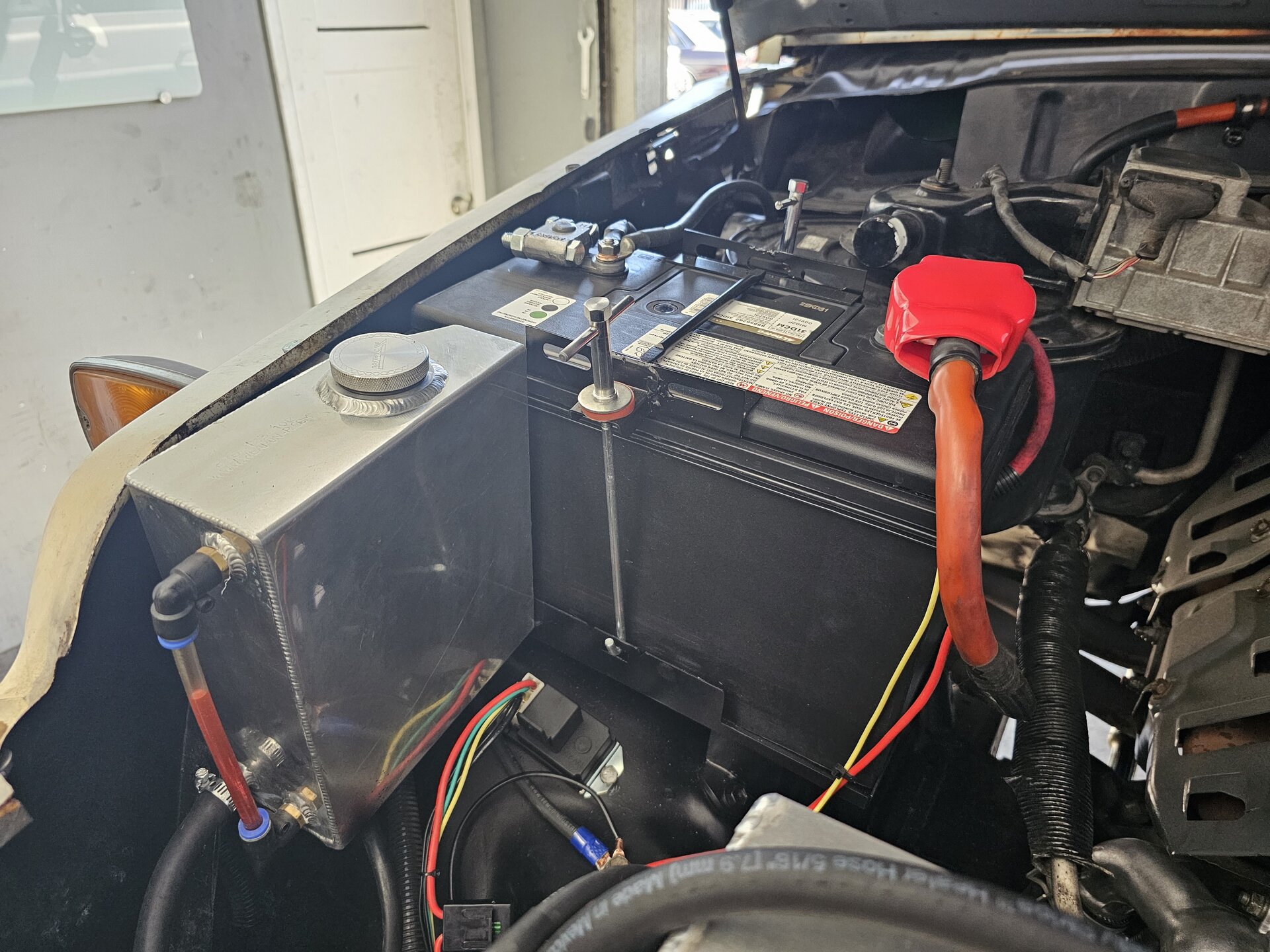

2nd battery tray is in. Group 35 is huge but fits.
Redarc Smart Isolator installed.

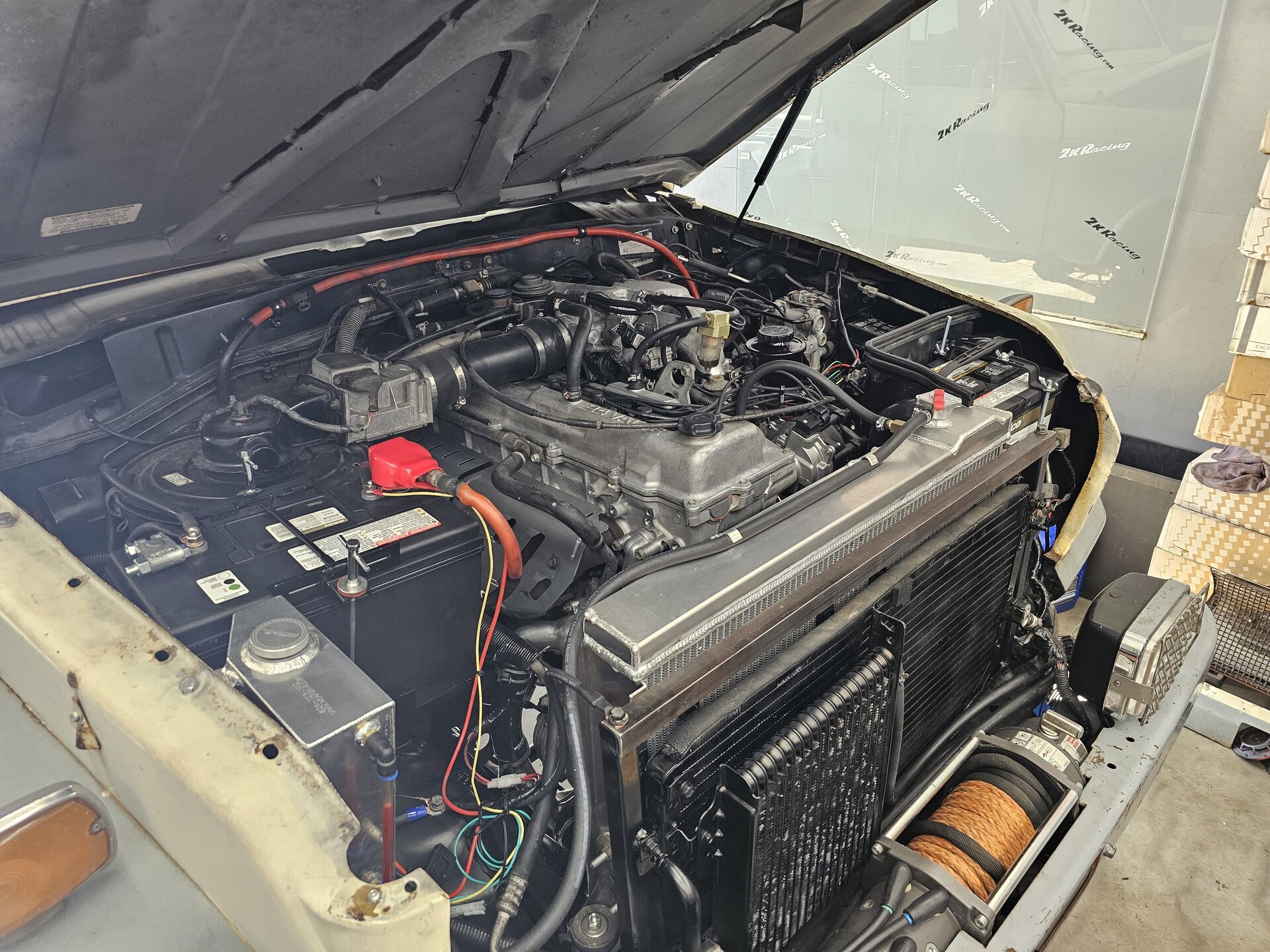

Radiator/Condensor/Oil Cooler all mounted up. Tight fit but worked well. I tried to make sure that every bolt is easy to get to. If I ever needed to do a trail repair I could do so effortlessly. I could say I have taken it apart 2 dozen times or so during test fitments. Probably takes 10 minutes or less to remove everything from the grill, headlights, complete cooling system until I see the block.
