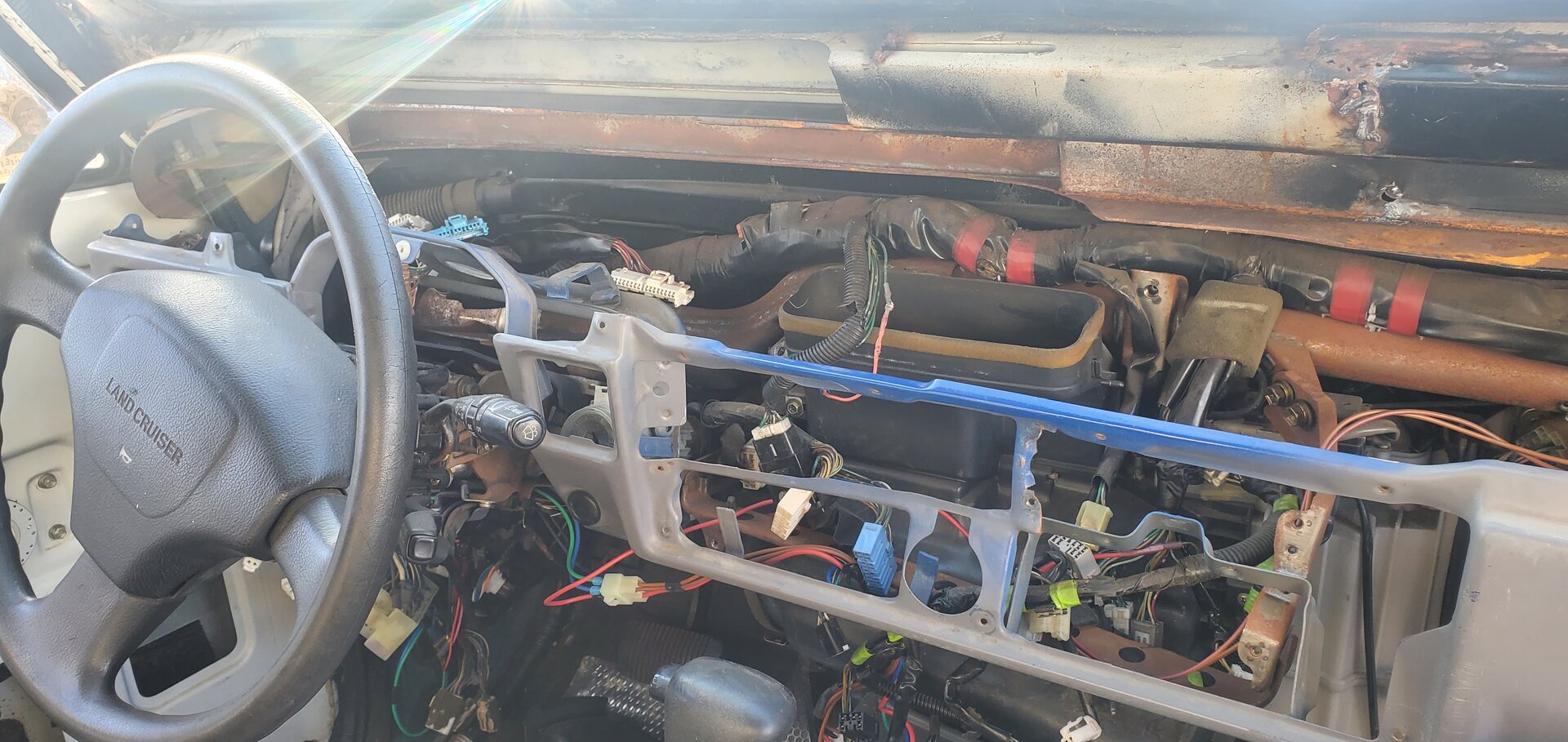

Next was to install a DC front drive shaft.

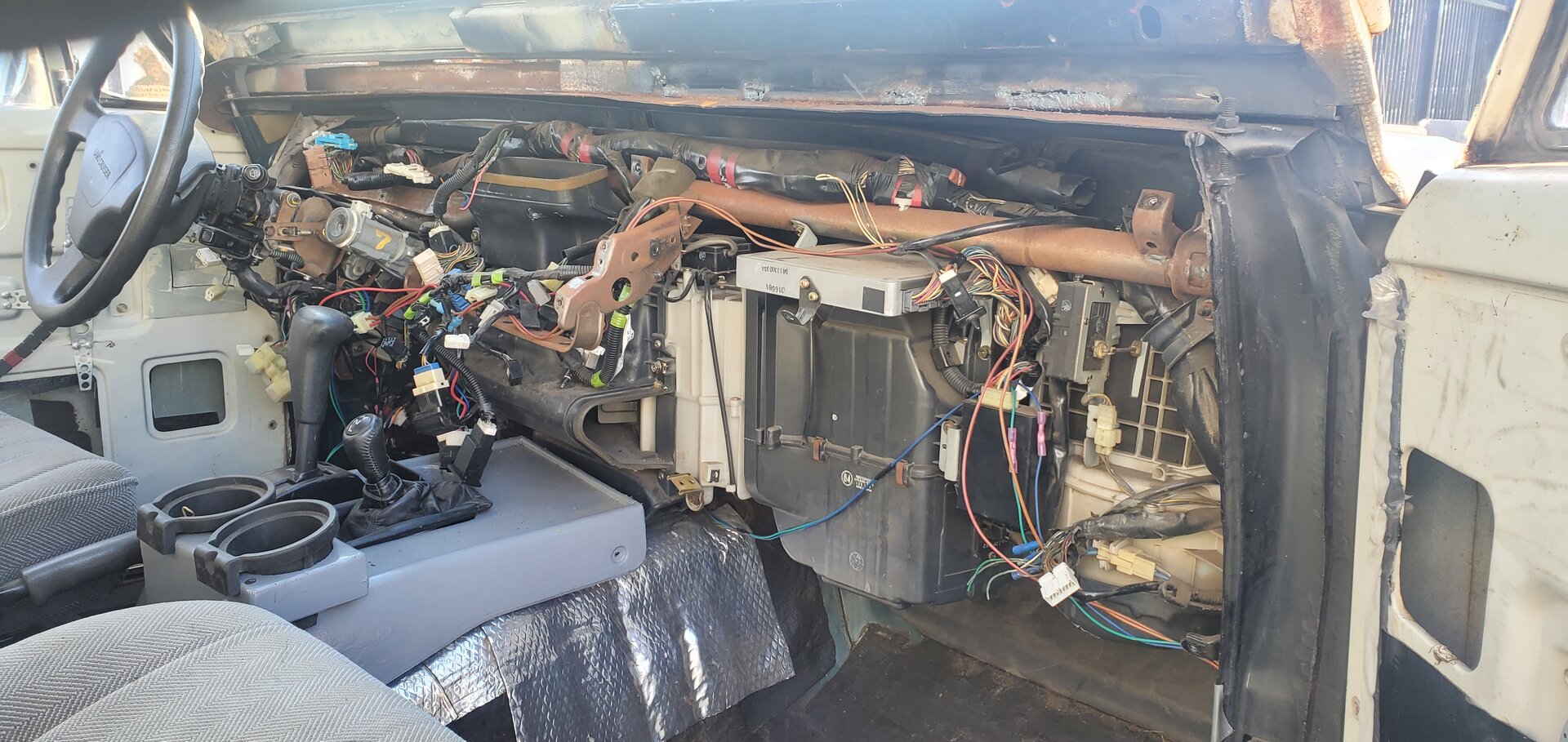

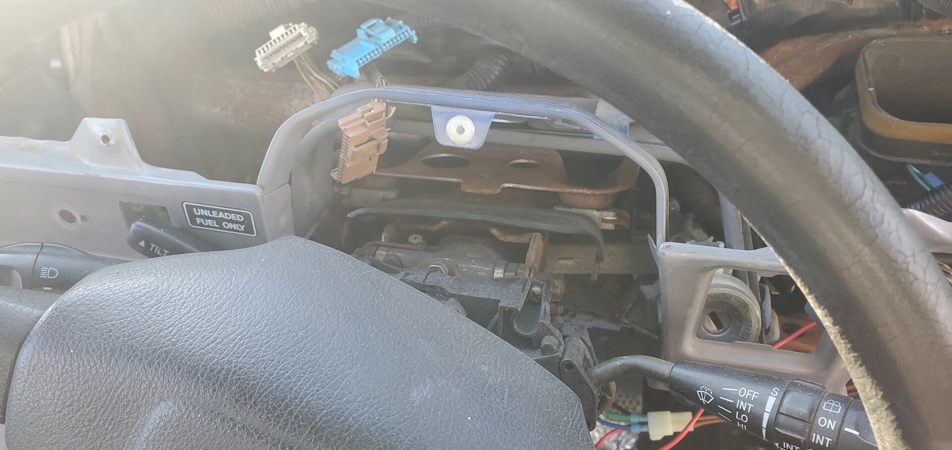

Since everything is mostly steel on this rig, the 80 dash just didn't look right. I decided to go with a dash from a 60 series and it actually is almost identical in length. Only real issue is that the 60 series ignition switch is on the column so the 80 series ignition interferes with the dash. So the plan is to just delete it. Most new cars just have a Key Fob anyway, we dont need no stinking keys! I'll install a couple toggle switches for ACC and ON, then a momentary push start switch for the starter. Last pic is what I'm hoping to achieve, but with a side of bacon.
Love it! Was hoping you'd go this route. Why not use the 60 series ignition? Are you retaining the 80 series column?
Yes, keeping the 80 column so I can set my cruise control 😎 pinkys up.
I’m sure you could very easily keep the cruise control. Break out the EWD.
I'll have to wait and see how it all comes together. Not against it, but I kinda like not having a key to start. Kill switch already installed.
