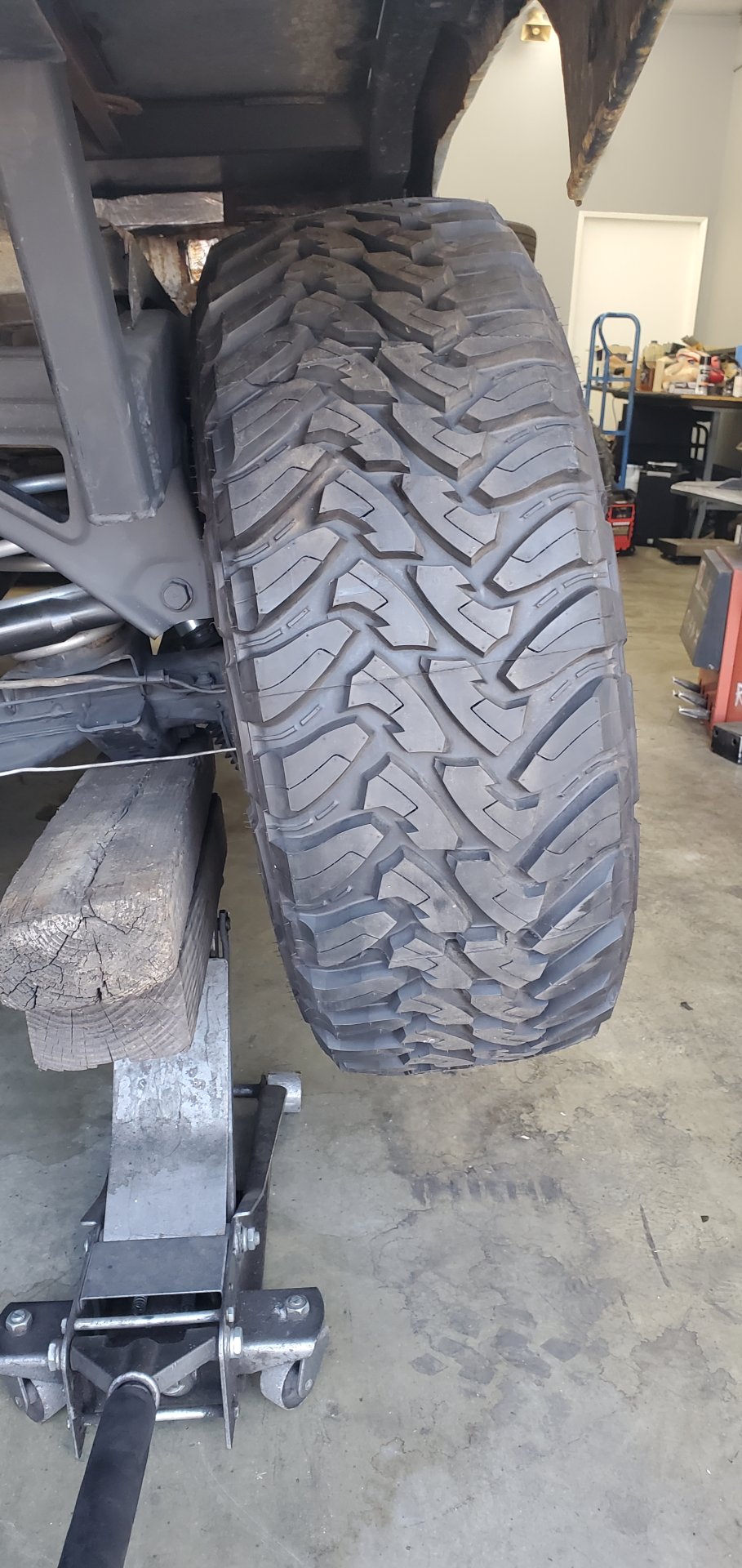

Mounted up to see fitment. Wheels are 17x8.5 with 0et wrapped in Toyo Open Country MTs 37x13.5x17. Looks like I got plenty of room even stuffed.

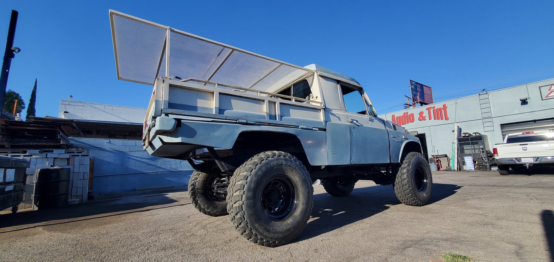

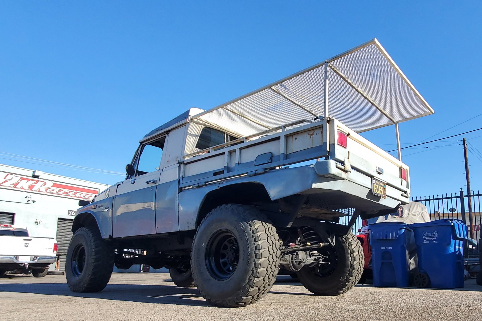

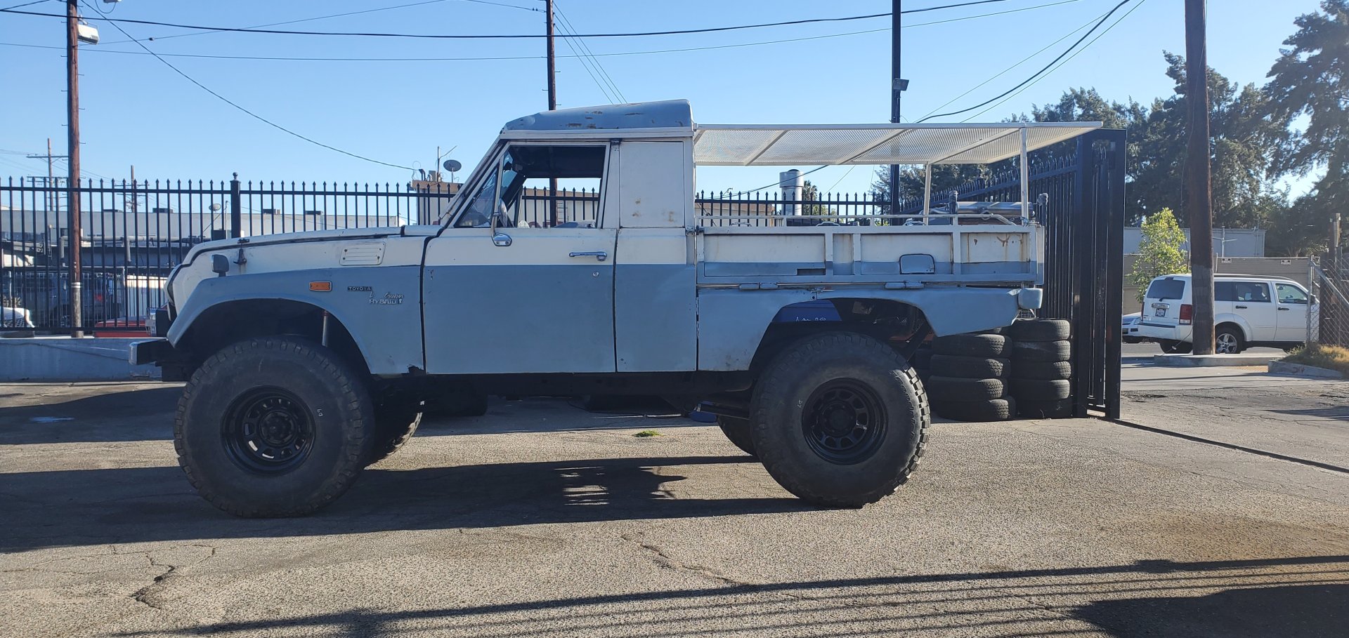

Alignment all done and finally got my plates in
