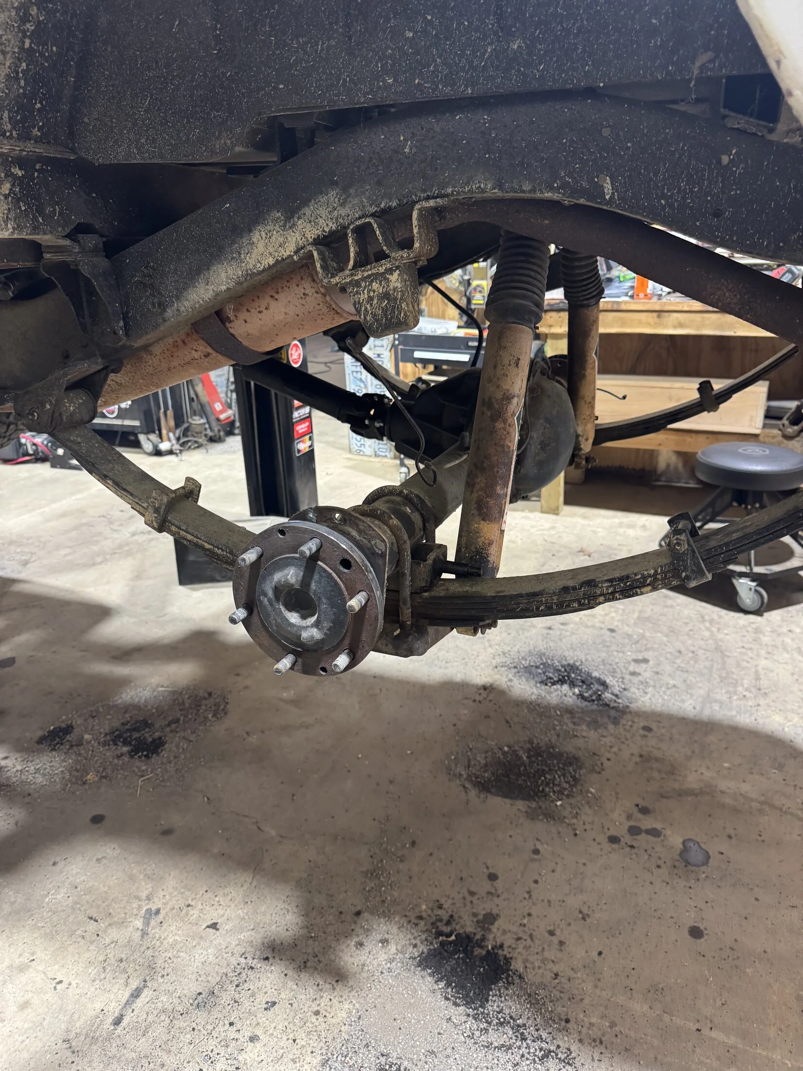

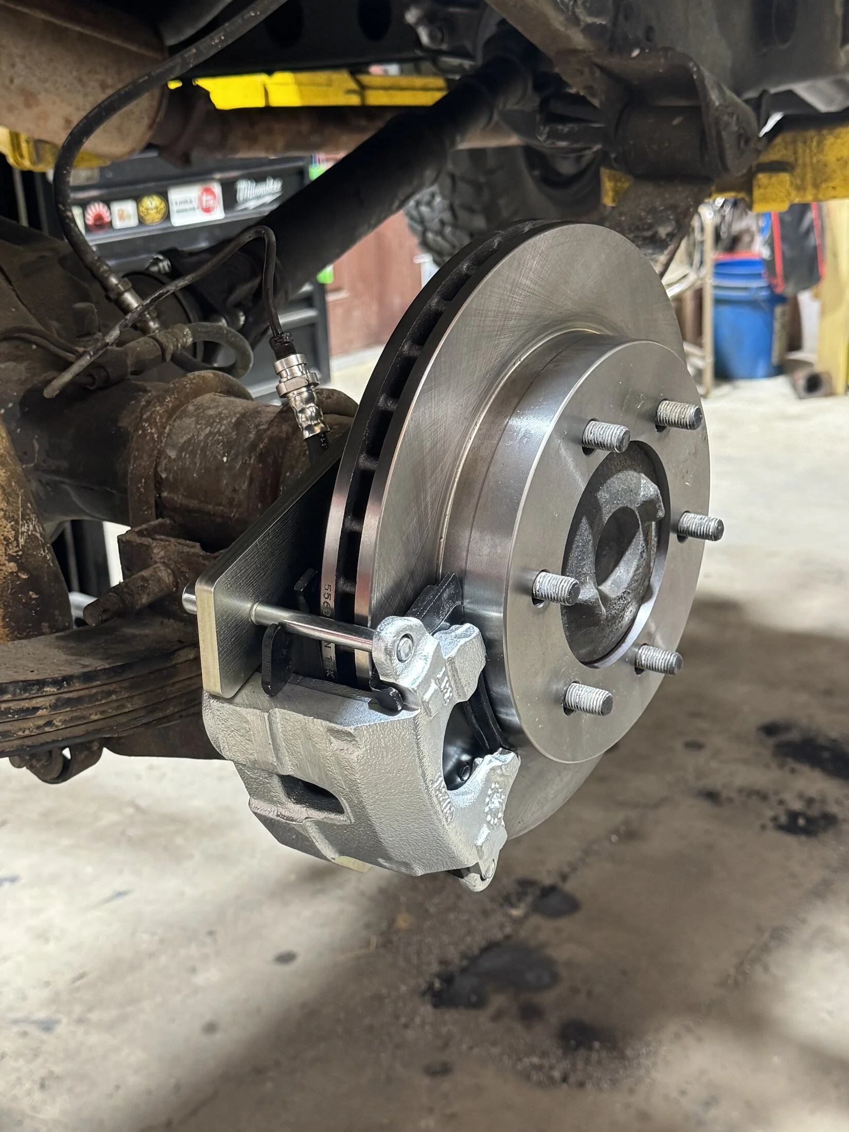

How was the JTO kit compared to the TSMs you’ve installed previously?
Fine. Basically the same thing for 1/2 the price. That kit has just gotten too expensive.
Love the comment re tire carrier. Curious, were the threaded holes for caliper bolts all janky ? we have come across a number of those sets with unusable threads and have to chase em.
Nope. All good.

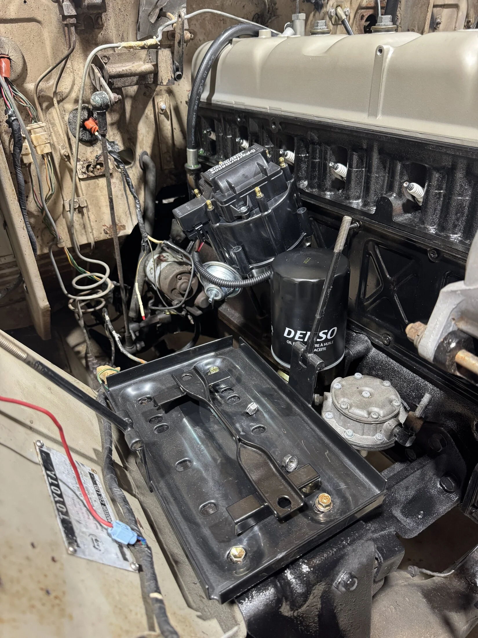

Changed the oil. 20/50 Valvoline with Zinc.
New Denso plugs.
Dissy installed.
PCV

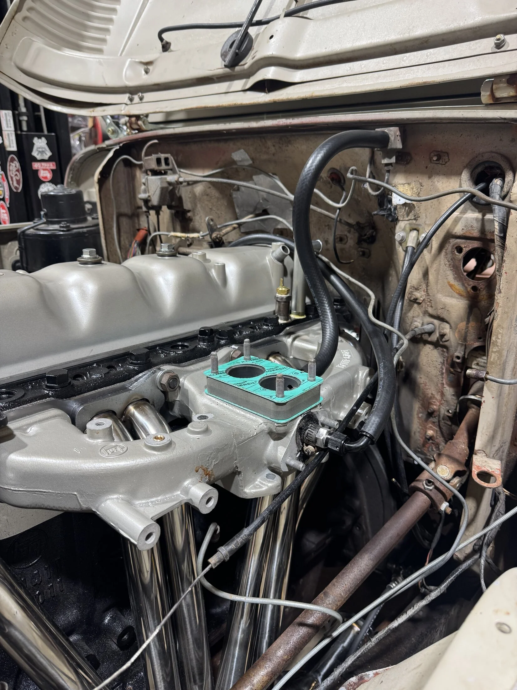

Redline carb base
New battery tray and holder.
Just sticking s*** back on as I have it

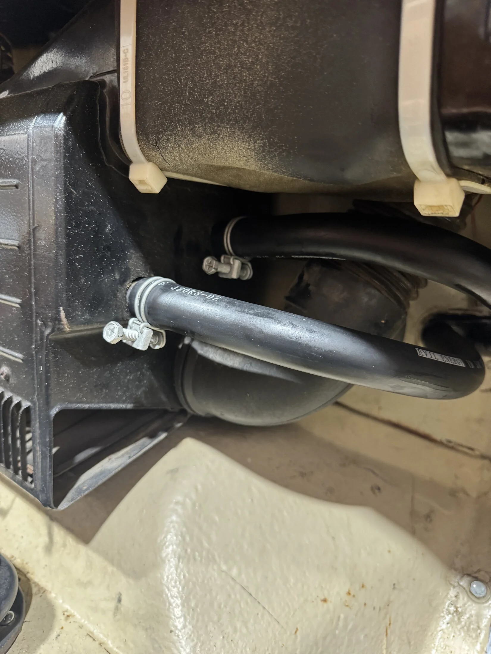

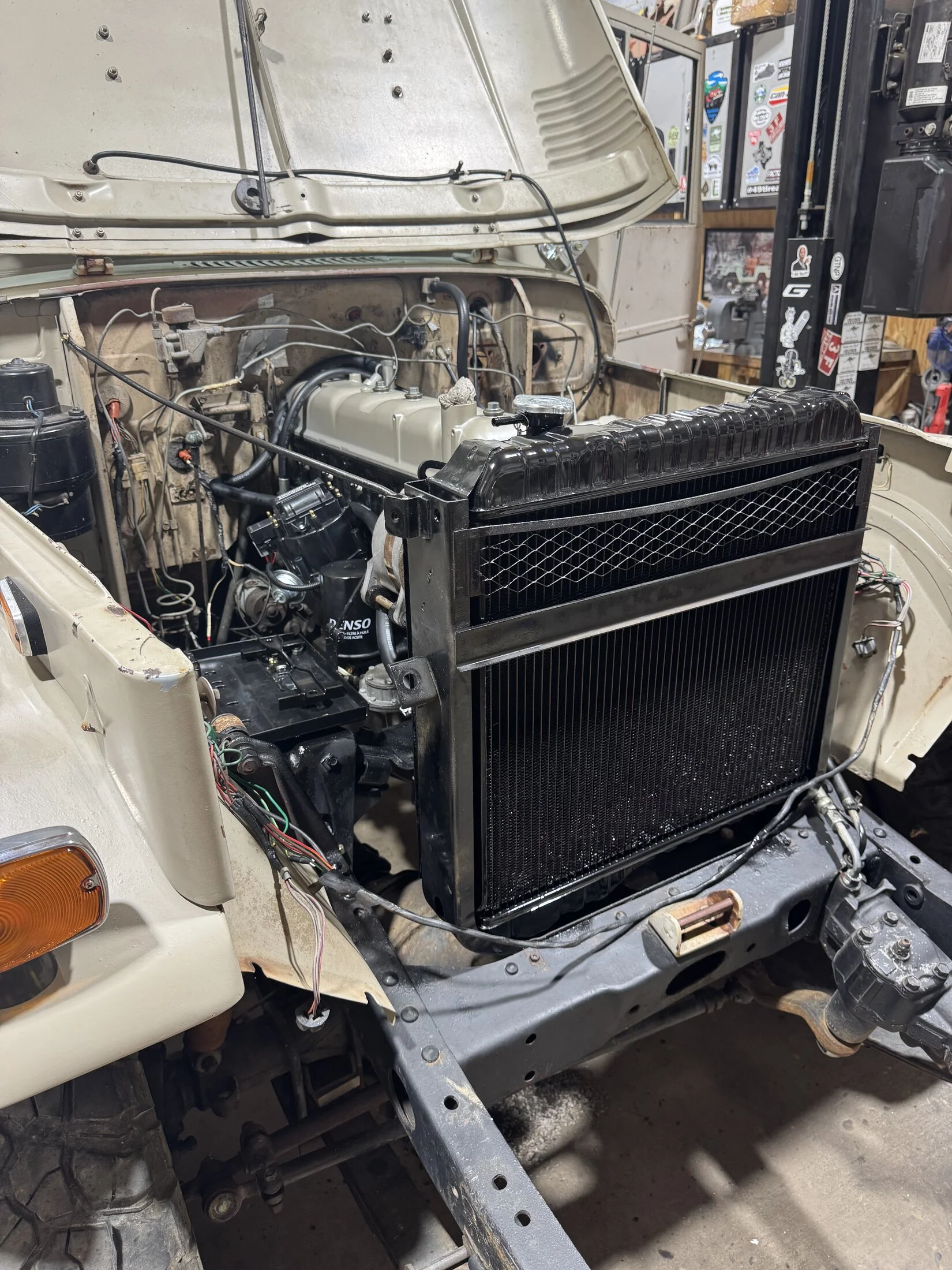

Water hoses all installed. The upper radiator hose is discontinued from Toyota and there is a work around but some a****** (@OGBeno) bought all of them.
He's mailing me one.....

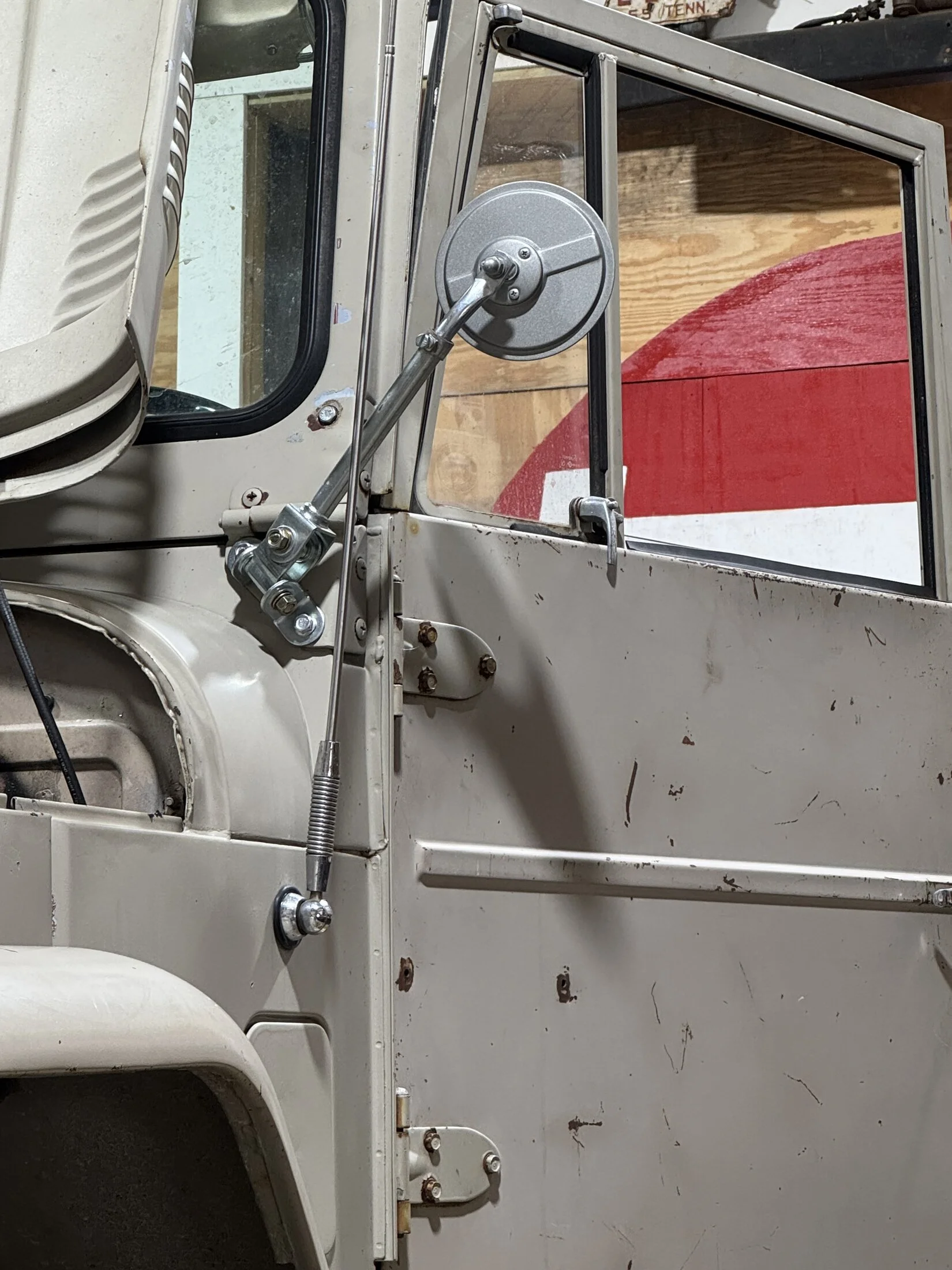

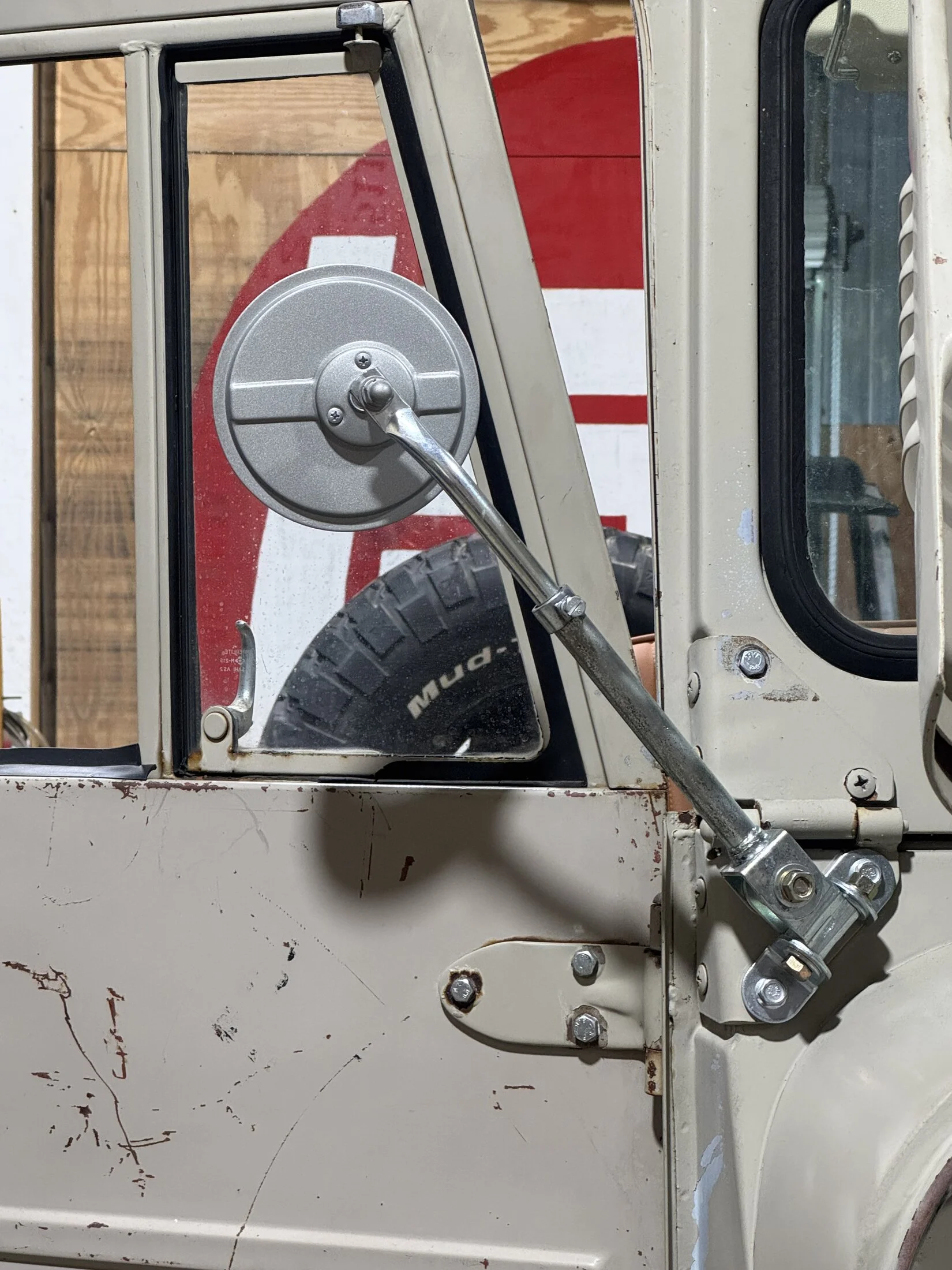

Aight. More parts came in. Jeep mirror heads are gone for OEM

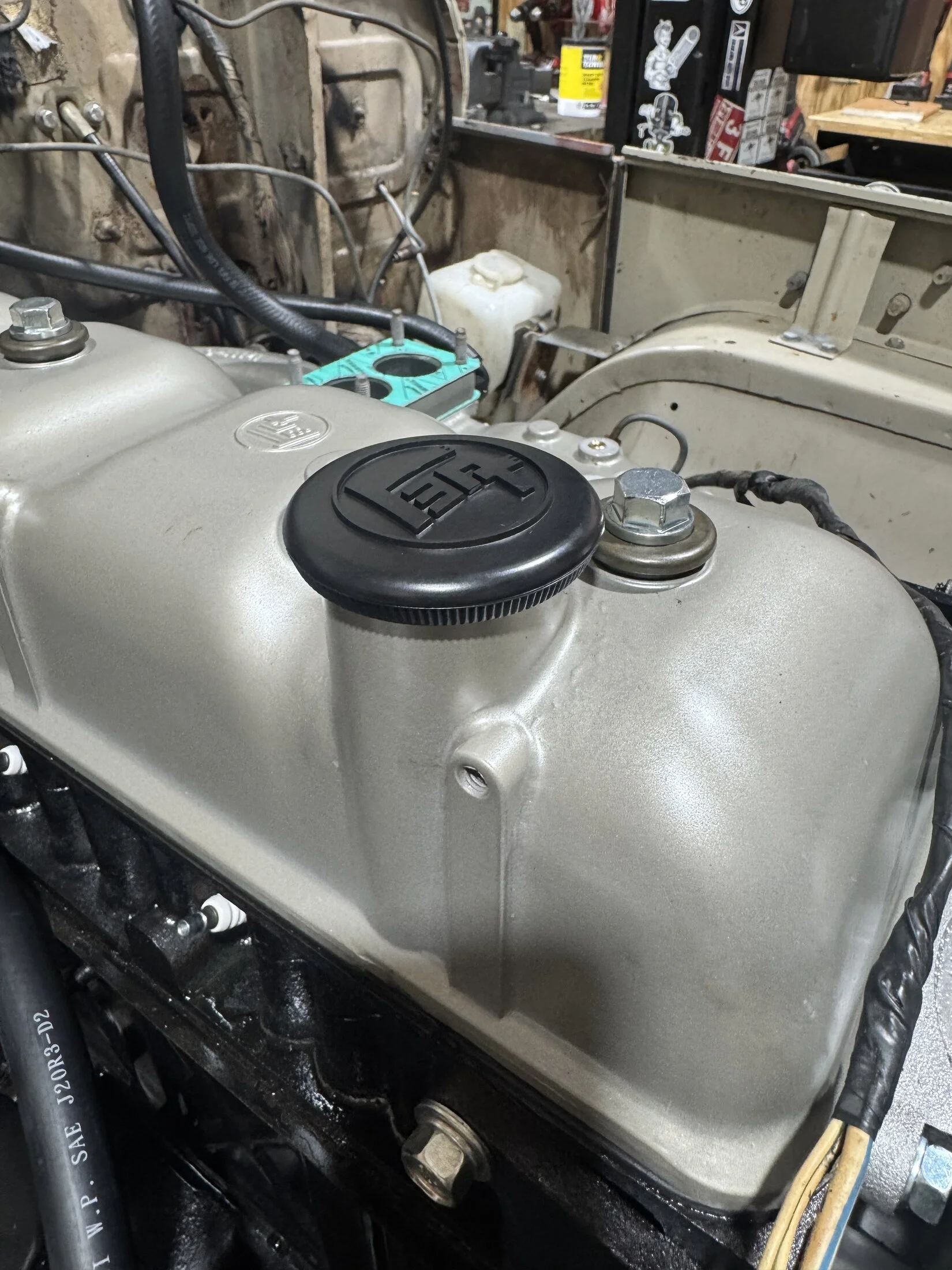

Oil cap

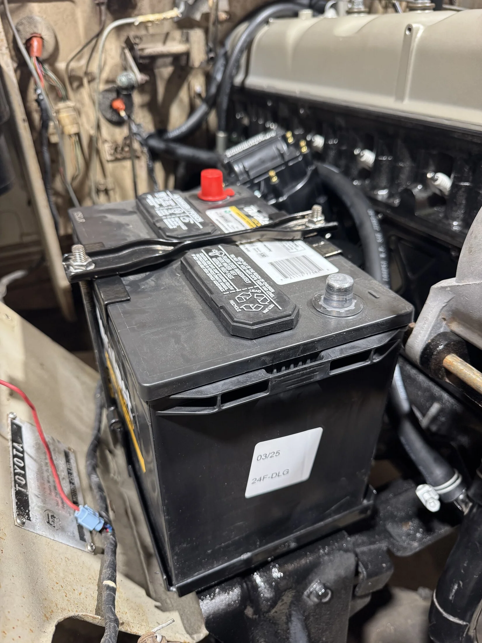

Battery. The genius from before had some oddball that won't fit in the stock tray

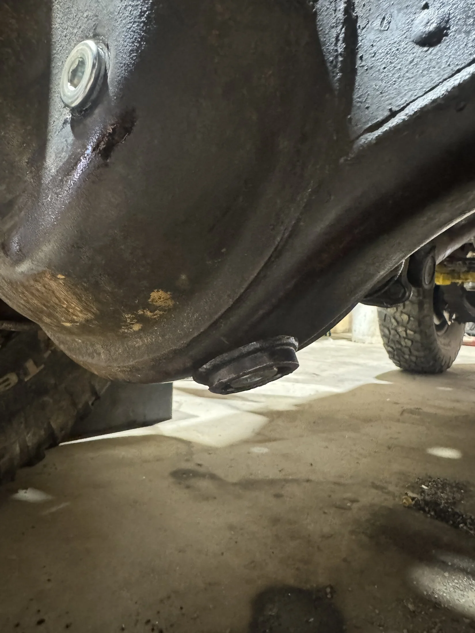

Hammered out the old rounded off 24mm dif drain and fill plugs and drained the jet black 90wt out and reinstalled hex plugs and new gaskets

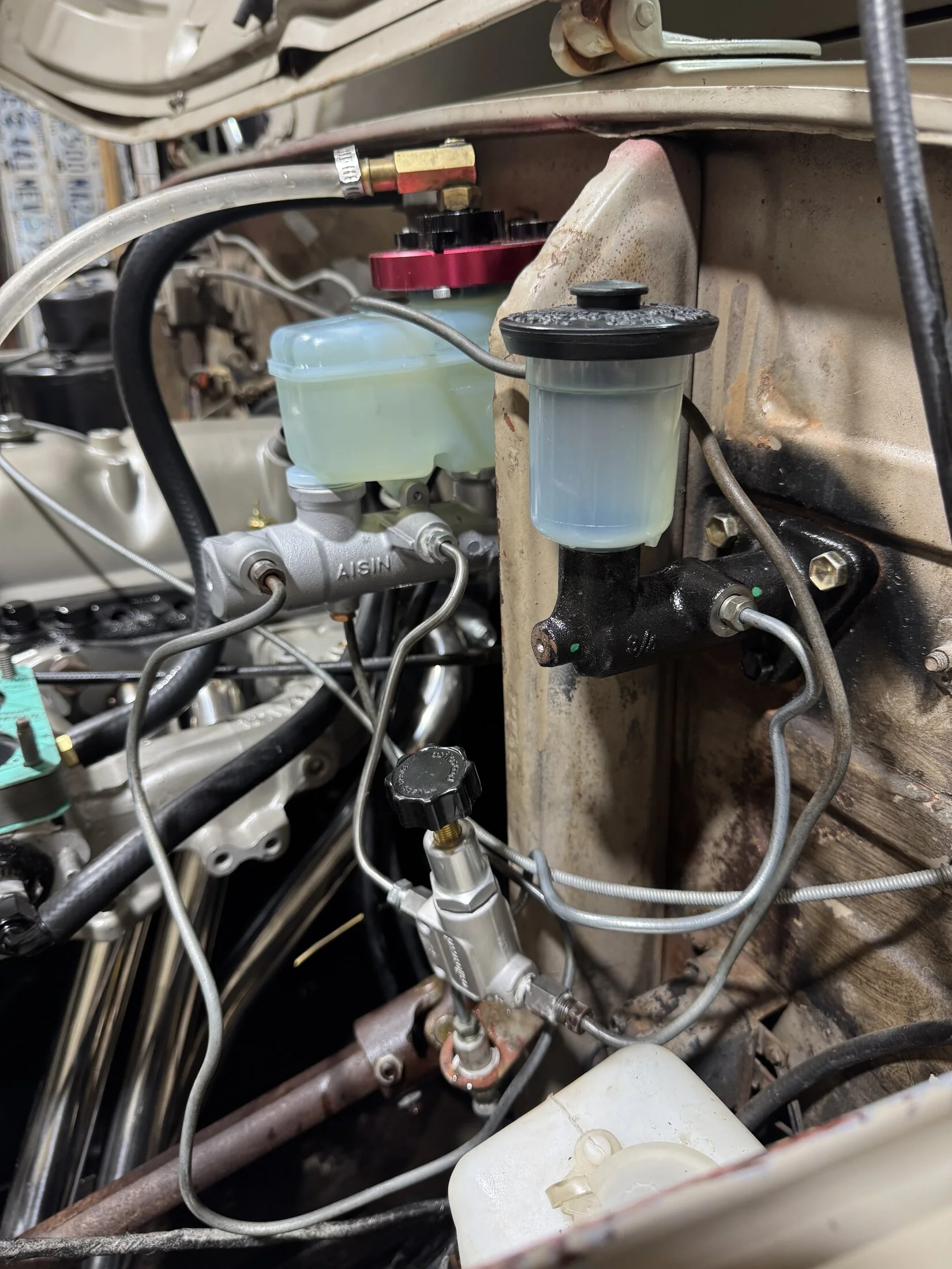

Clutch in and bled.
Brake lines have a drip or two under pressure so I undid it all and added some locktite 567 to the threads. I'm gonna let that sit up overnight and bleed them out tomorrow.

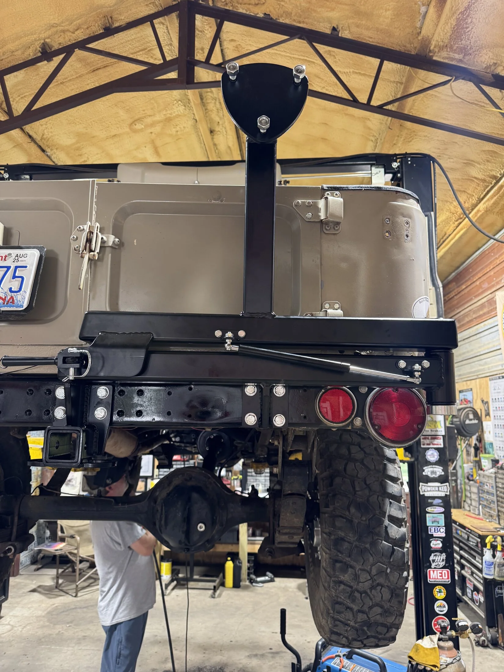

Was supposed to get a pallet from 4Plus today so I could get the swingout on but the turds did not show up.
May have to start wiring tomorrow.
Pallet DID come in so I grabbed a breakfast burger and then grabbed the pallet.
Even got the tires in ....

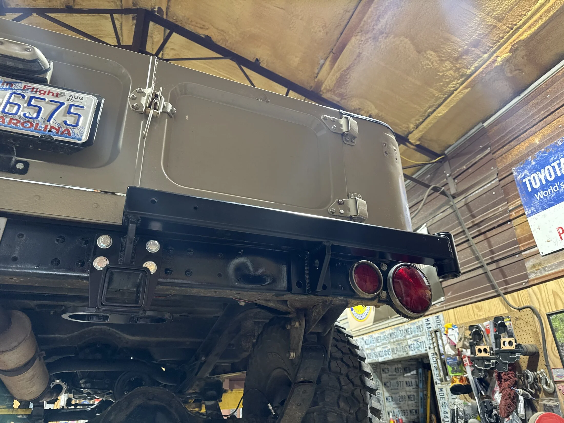

And it's on. Nice and tight.
