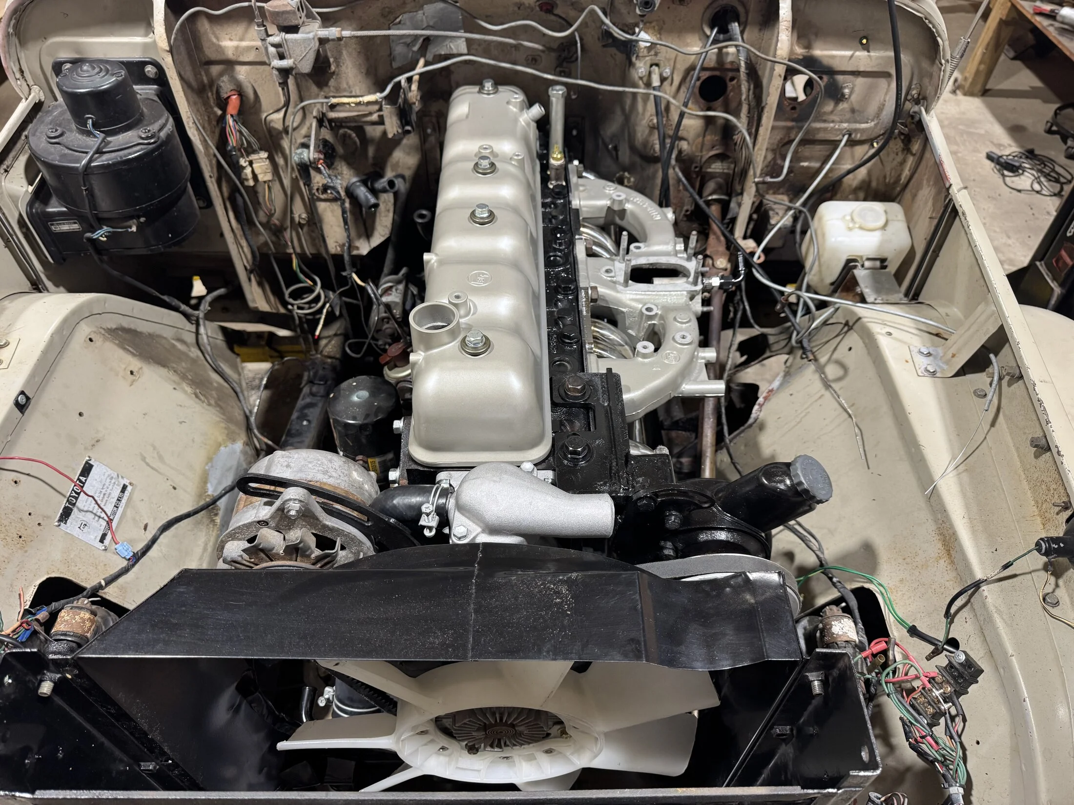

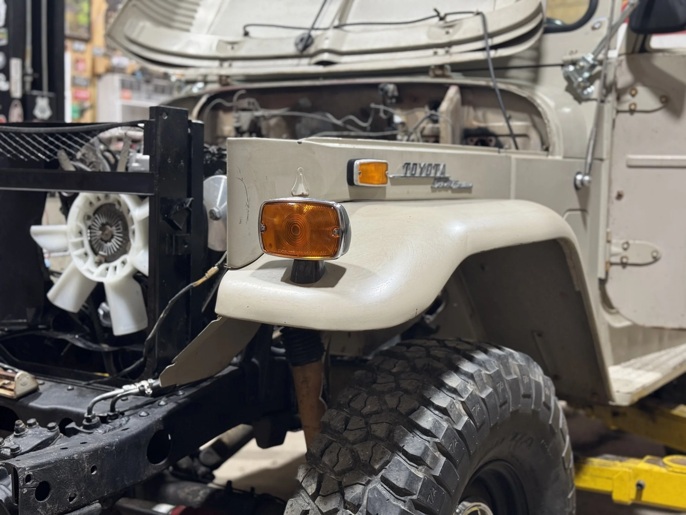

Cleaned and painted in my high tech paint booth
Got the proper turn signals installed

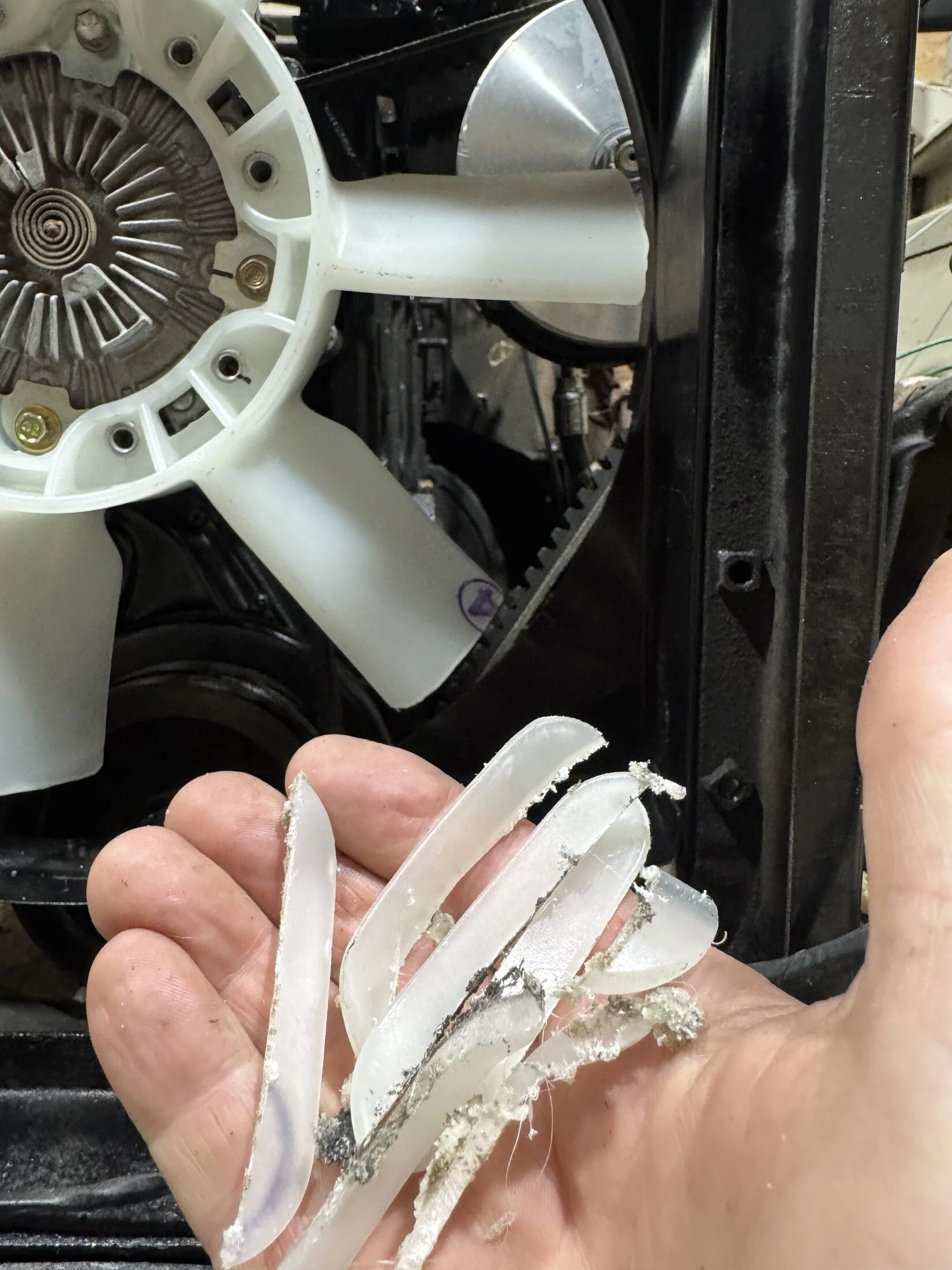

Added a fan clutch and fan. I needed to trim the fan a bit

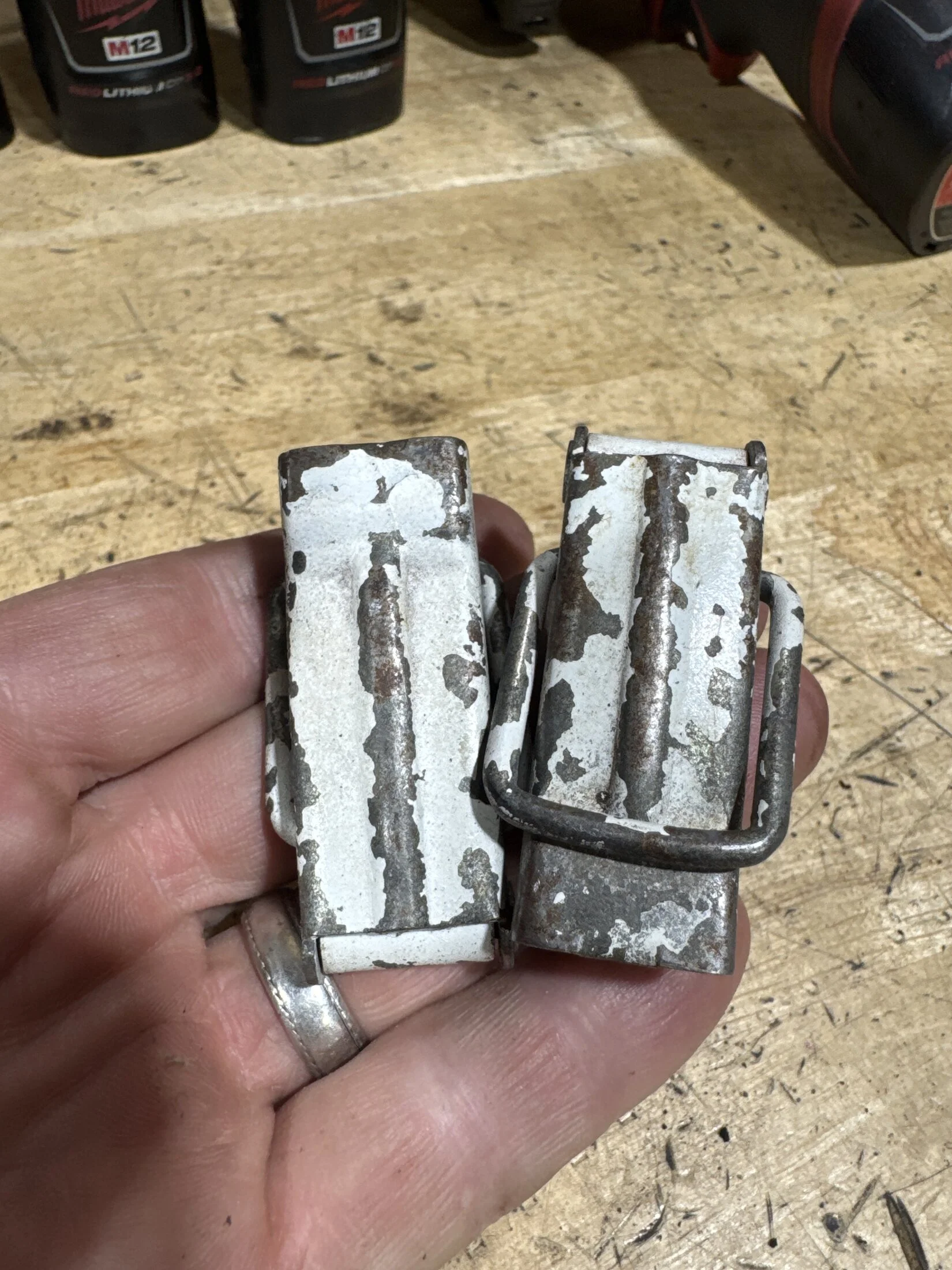

My buddy let me purchase a couple of seat clamps. These things are getting hard to find

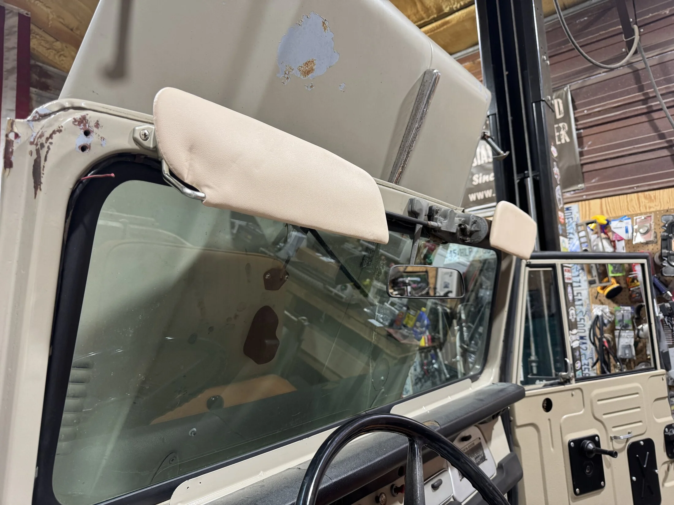

Last items of the day .... visors

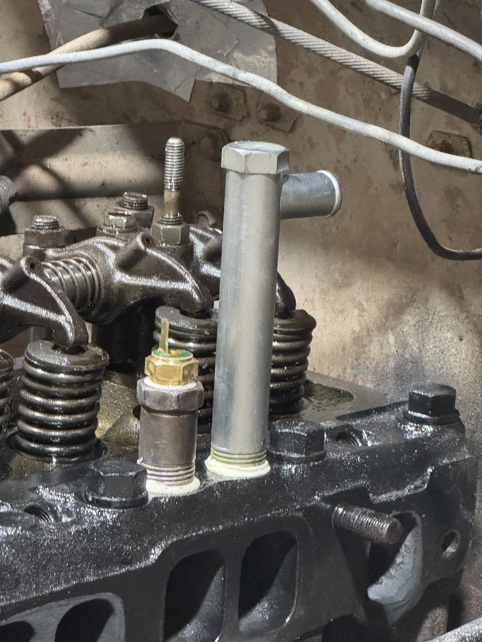

New sensor and water tube

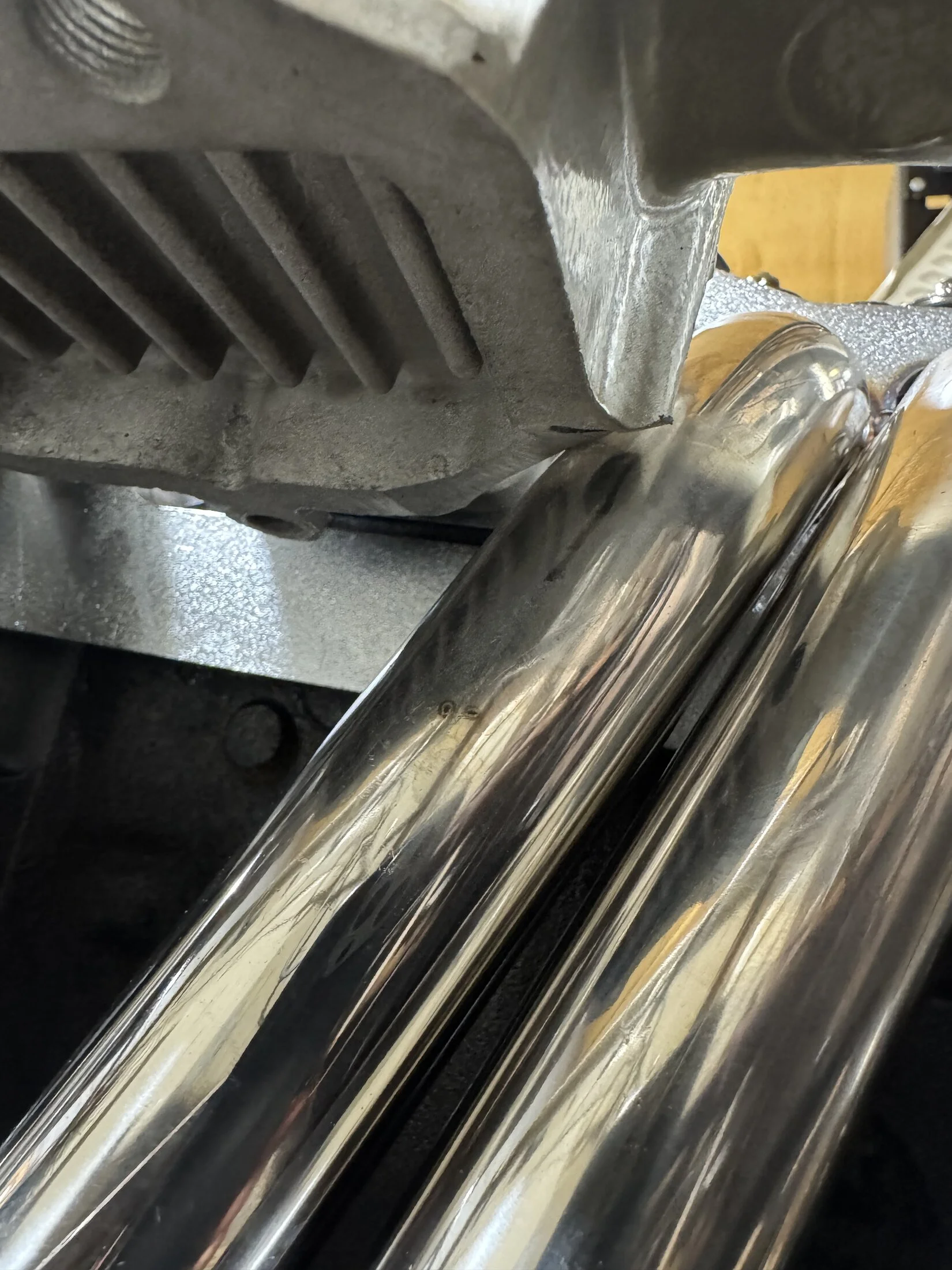

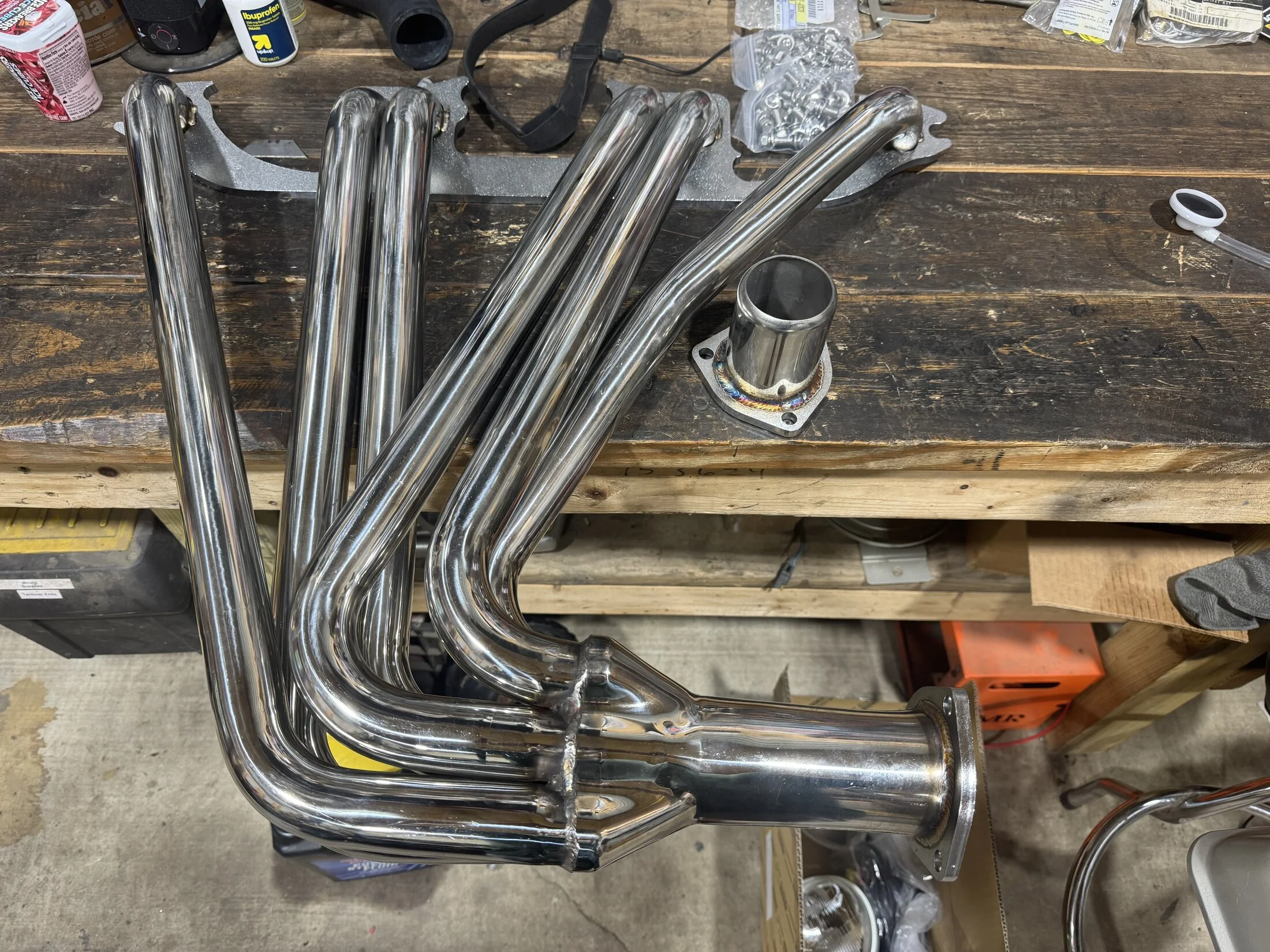

Got back after lunch and had a header here from EBay. New offering from a company in Chico. $350 shipped and stainless. Very nice.

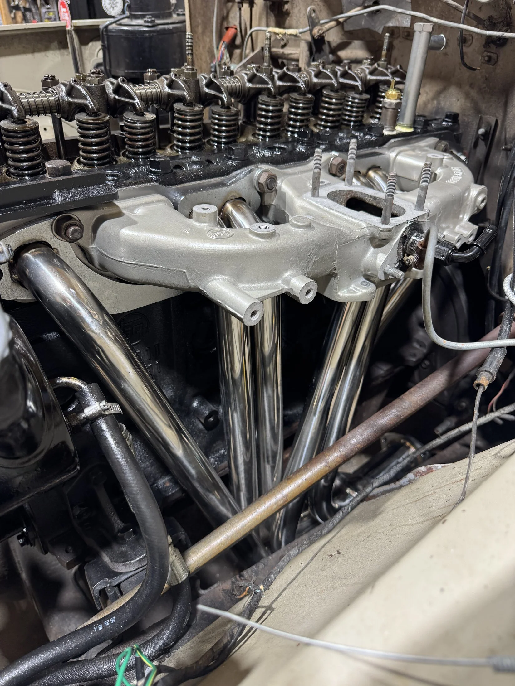

One problem though, the #4 tube hits the intake and I had to clearance the intake. I think this outfit is new. I sent them feedback. It's a damn nice header for the price.

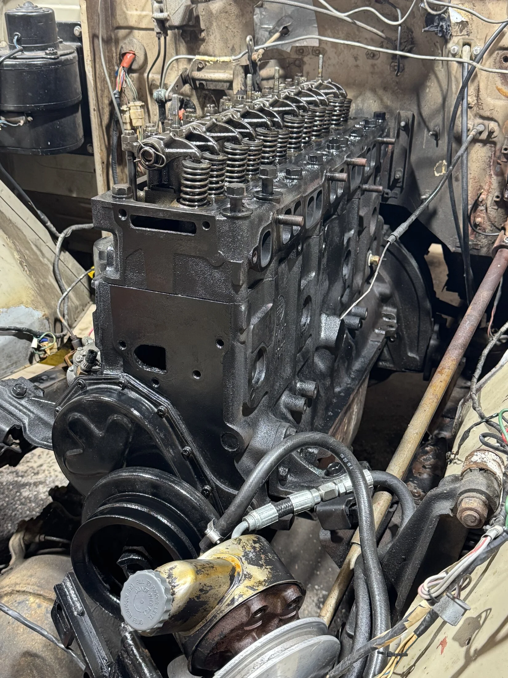

Set the valves. They were pretty close. Had to loosen two. The others were spot on.
Fresh powdered intake and valve cover installed
Was the flange thickness correct on the header vs intake manifold?
That was something that has driven me crazy on all the headers I worked on in the past, they were always thinner than the intake and required washers or welding.
Yes. Nice fit up top. Remflex gasket will solve almost any woes though.
Is a header preferred over factory manifold?
I prefer them mainly because you are getting rid of a couple of gaskets I don't care for. The intake to exhaust and the donut.
Late model ones have a bigger downpipe and flow pretty good but the early ones are pretty restrictive IMO.
The main issue with this one was the intake was cracked and the exhaust manifold was pretty sketchy. I'll reinstall a clean one but if I have to spend any money one then I usually just toss them for a header.

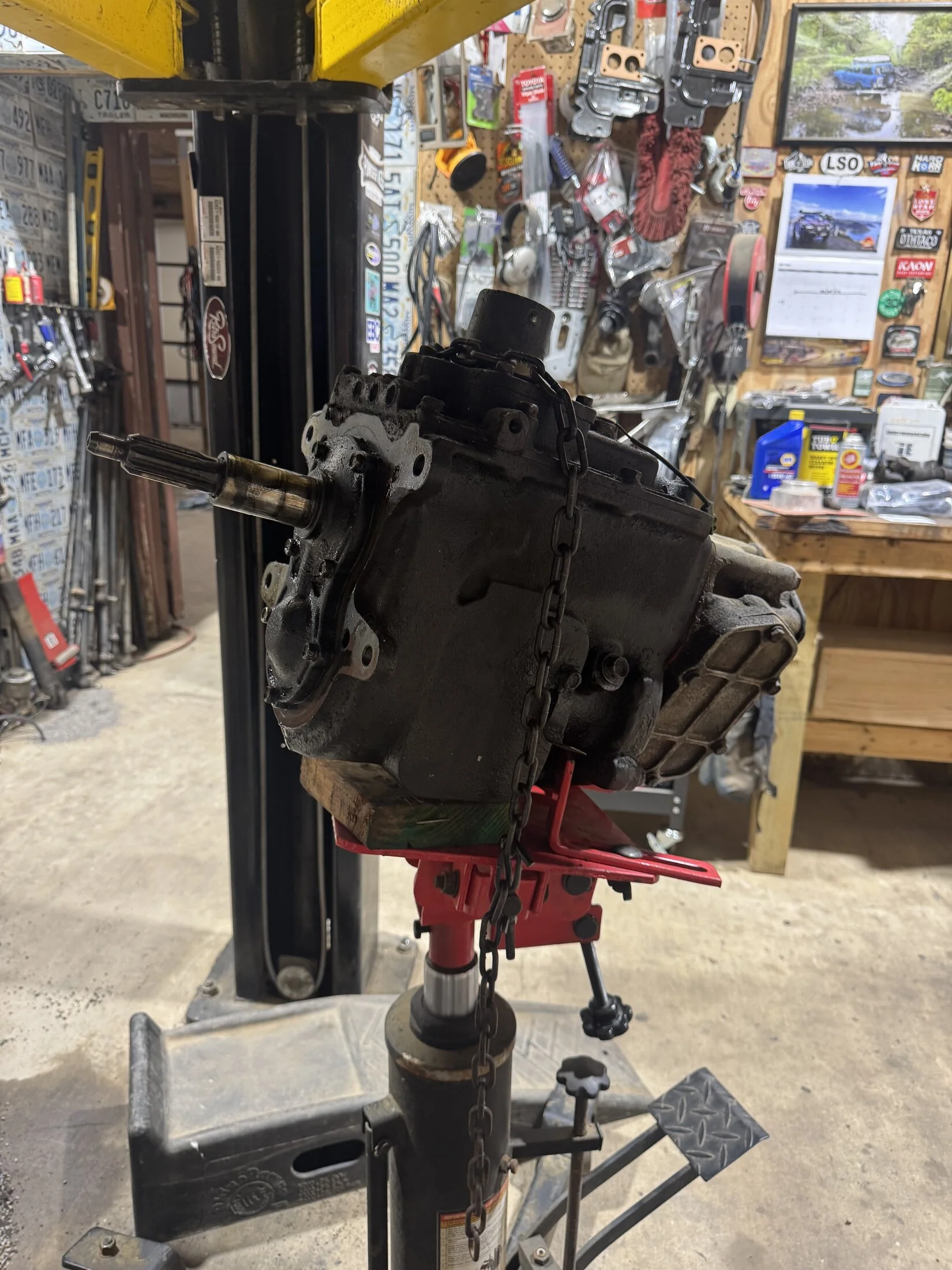

This sucks to have to do but there was a jingle jingle sound in the clutch that I needed to investigate.
It looks like cheap Chinese clutch parts from Napa. I think a nice new Aisin kit will fix any issue that was there.

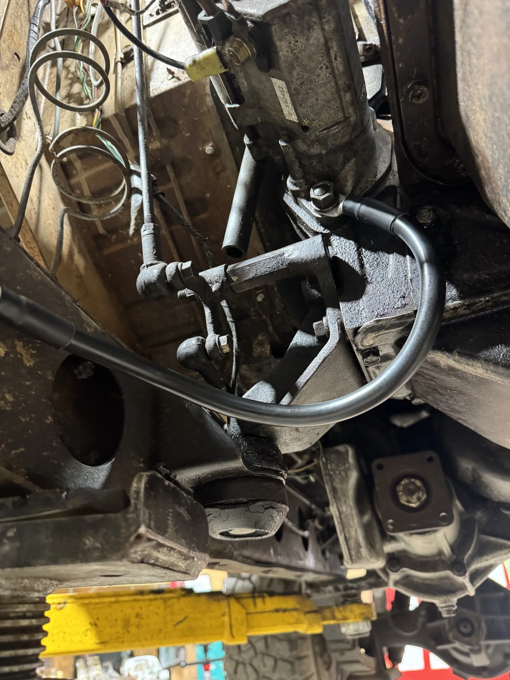

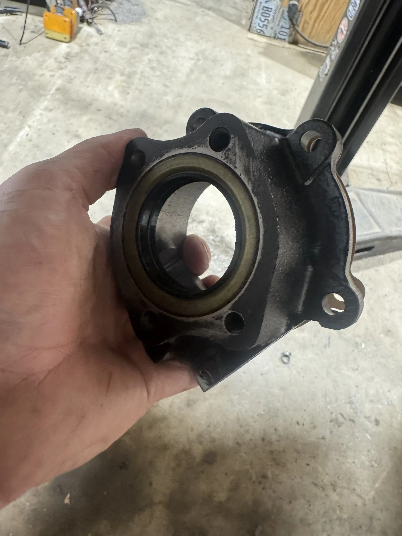

Nothing fun to report today except I got the trans/transfer back in. Lots of moving parts with the linkage and such. Added a double seal Tcase Speedo housing from @orangefj45
