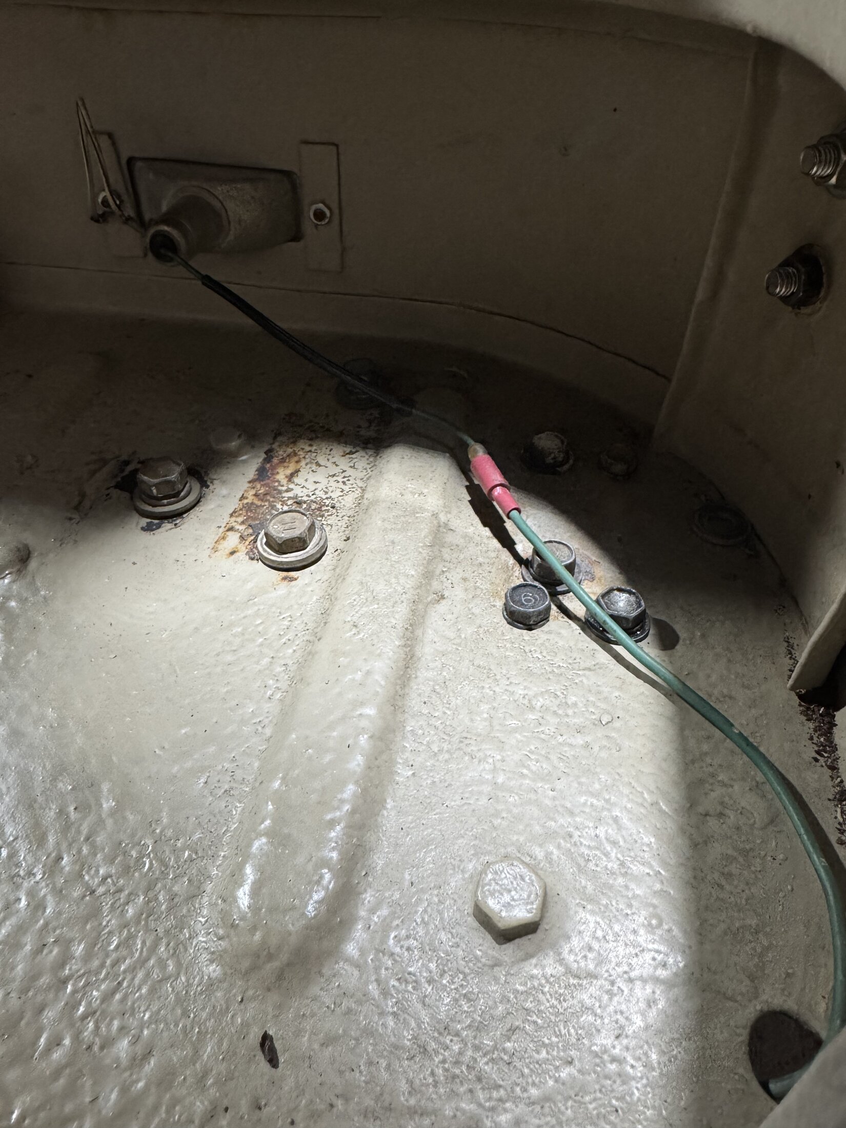

Funny. I just spent the last hour filling in all of the holes the previous jackass drilled in the tub with bolts. Used some 3m dum dum to get a few cracks filled. Should stay pretty dry.

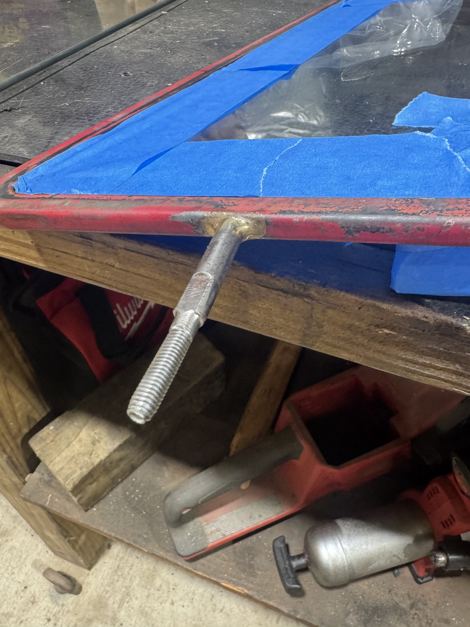

I started off removing the backwards wing window
I bought a whole door that had a good drivers wing window but I freaking snapped the rod off. Gonna have to get the Wizard to put the good one on the red frame
The rear handle was broken. I bought this one out of Indonesia. What a pain in the ass it is to replace this thing
Yesterday the Wizard came up and fixed the wing window.
