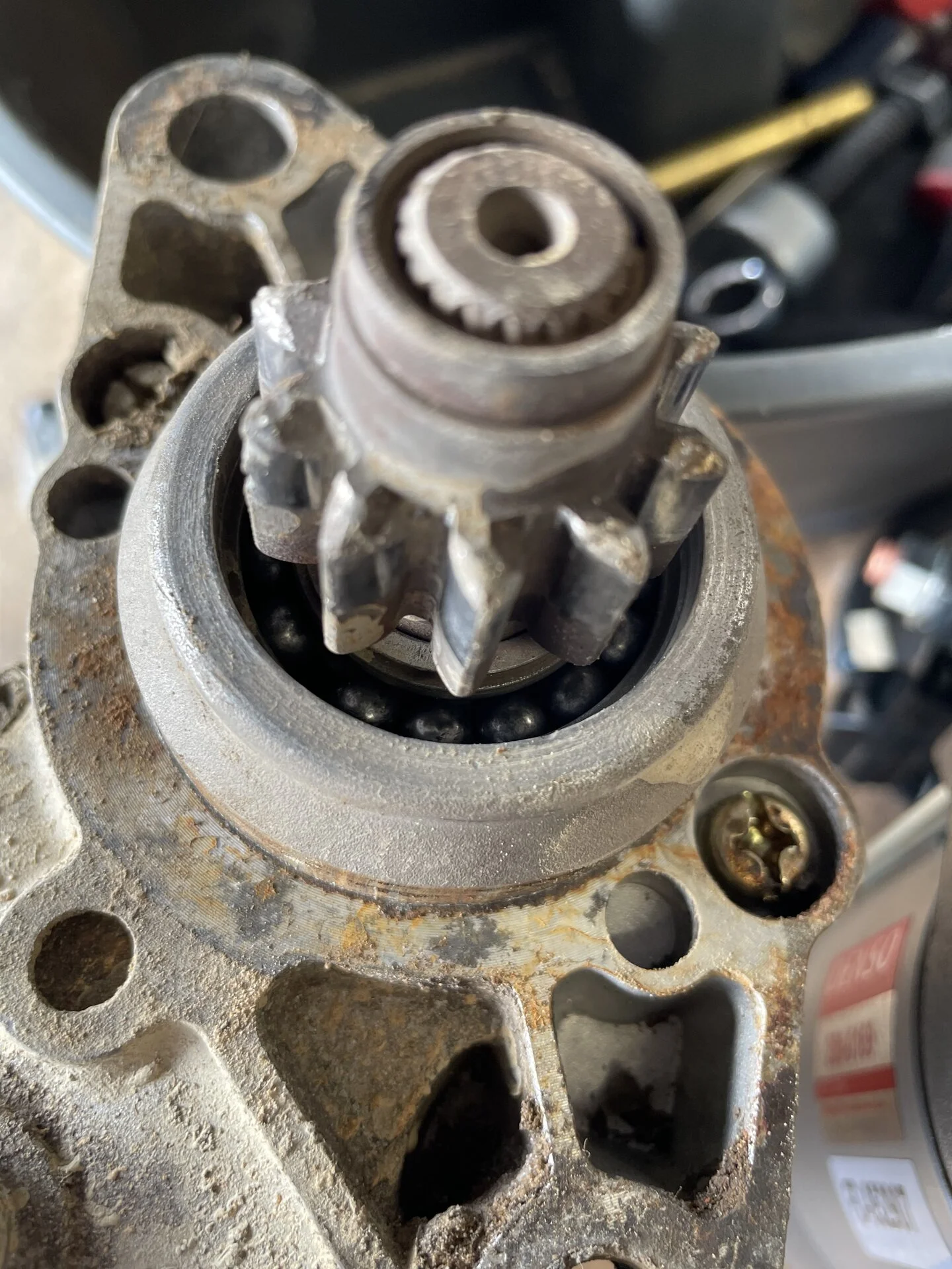

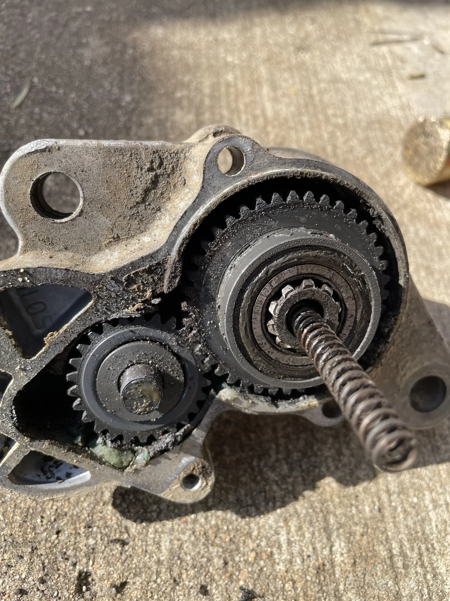

super glad I just went and got a reman unit, instead of trying to refurb this starter.
starter was full of grit, the external bearing near the gear wheel had become spontaneously air cooled
when I pulled the "top" of the starter off, I could not even spin the gears by hand they were so full of crap
