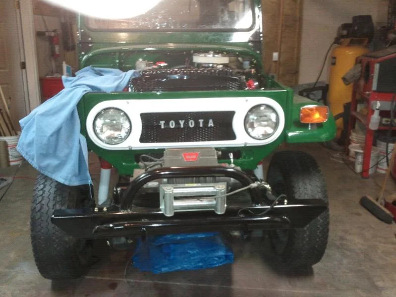

I was able to spend a few hours today and was able to get the fender aligned. I disconnected the center mount of the bib and had to cut a little more out around the steering box. (It really sticks out a lot but that's OK.) I will need to make about a 1/2" to 3/4" shim to put under that bib mount but that will work out just fine. The important thing is that the body, front clip and hood all seem to align.

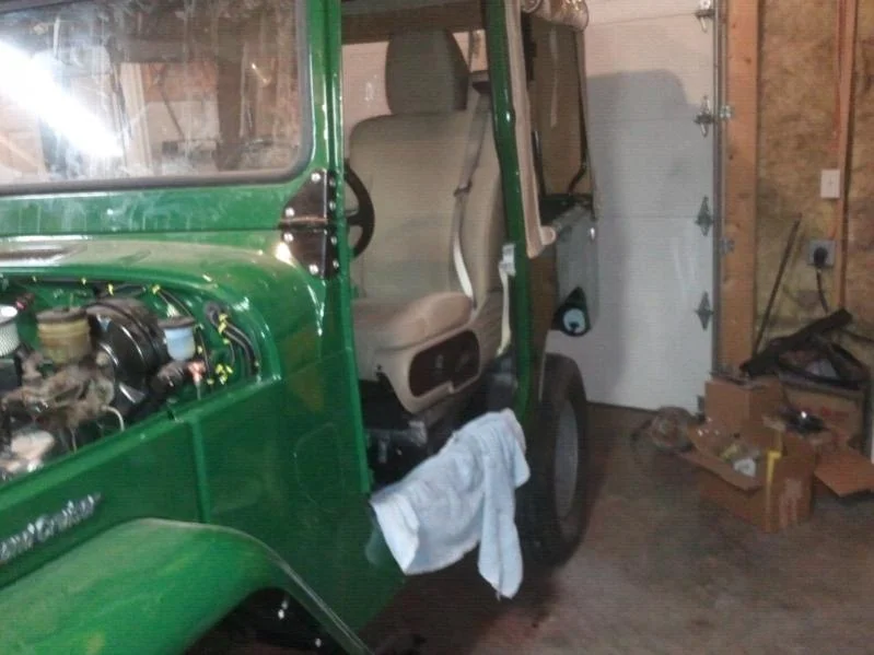

Finally, I started screwing around with the Ford truck seats I wanted to use. Unfortunately, I did not measure the height of the steering wheel and discovered it is about 2 inches lower than my other 40. That makes the seats not want to fit very well. That is going to take some sorting out.

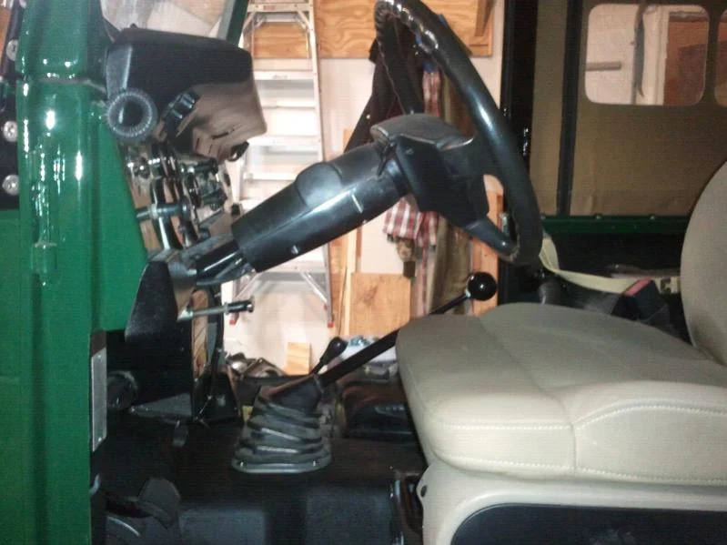

I put the driver's seat in and it is way too close to the steering wheel. I figured it was the seat so I was able to get it down to 16 inches from the floor. Then I looked at the my trail rig and realized the steering column is at a weird angle.
The stock height from the floor too the top of the bolsters on the seat is 18". The stock height from the floor to the center of the column at the steering wheel is about 29". I am at 26".

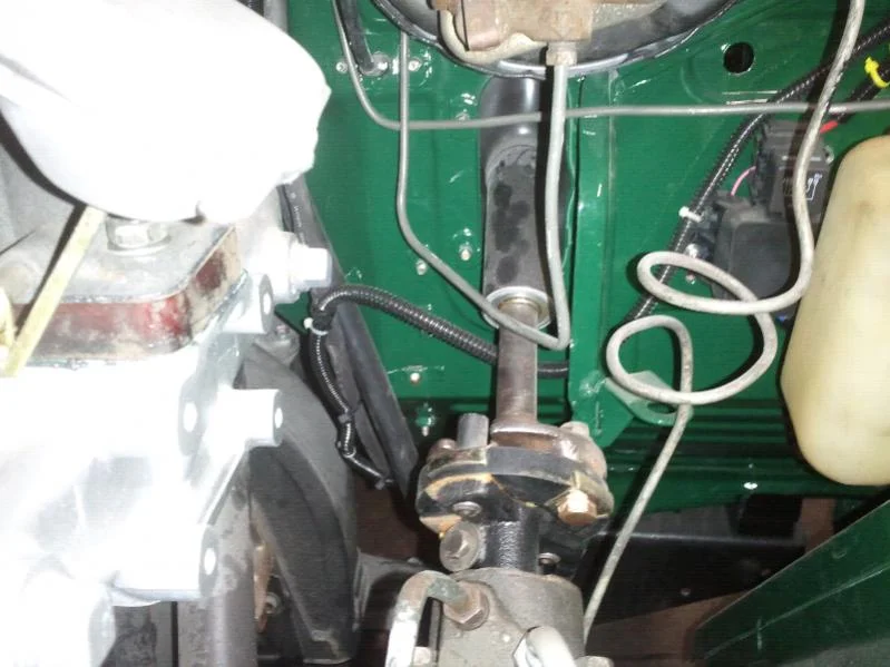

I have mini truck steering in the truck and aligned the steering shaft with the steering box. The box sits on the mount at a 30 degree angle. I can not tilt the shaft up any more without binding the rag joint on the box.

Angle is bad. To close to the seat.
You can see here that the shaft is totally straight in line with the steering box and where it enters the firewall.
Here you see the inside of the firewall. I used a 4+ mount and welded the shaft cover to the mount to ensure we have a good safe mount. So these two parts need to be replaced in order to alter the angle.
The solution is a Borgeson double D to Double D universal incorporated in the steering shaft just above the rag joint and before the firewall. Anyone have a problem with that?
