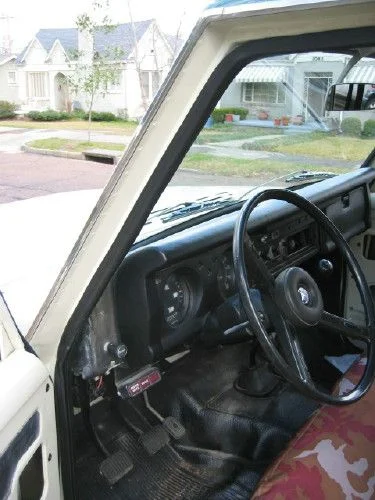

And this is where it goes.
attachment.php
I'm assuming A is the part that is to thick?

Got the door weatherstripping in from JC Whitney today.
Profile compared to the OEM. When I saw this I thought there was no way it would work.
I installed it on the easiest to access door on the 55 in my cramped garage. Used a deadblow hammer to install.
old weatherstripping
new I actually like it over the grey as it matches the rest of the window molding.
old
new
SO the big question is does it work? Yes I'm about 90%happy with it.
With the old weatherstripping the door would close completely without any push. Now it will not. It will catch the first notch on the latch. It takes very little force to close it.
Other notes are the weatherstripping on the top doesn't seal like the oem it actaually seals on the bottom edge instead of the side. I actually like it. The bottom fits really well. Sides are fine. I think with a little more fitting and a little more set it time it will work really well.
What I don't like. The clips that hold the headliner in will have to go. I will need to find a clip that doesn't have a lip on them as it make the weatherstripping uneven. No big deal. Also The threshold plate will not fit well due to the outer lip not being able to go between the two pieces. You could either grind the plate or just bend it.
