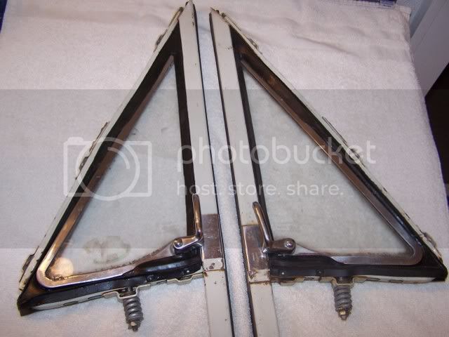

I'll have some pics of this on my piggy when I'm POTM at the end of the week!
That looks great. Now we just need him to make the rear passenger window and we are set.
I've been talking to him about that. Apparently he has a good piece for one side to use as a mold but needs a good piece for the other side.
