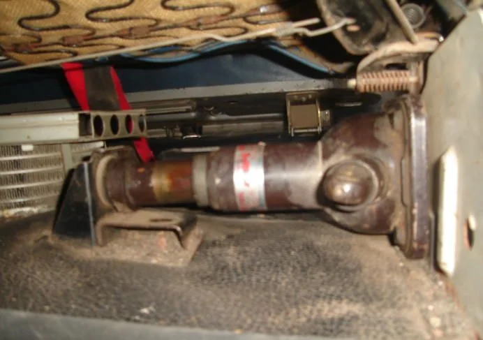

my jack holder is/was a large dry rotted "O" ring that snugged my jack down, it broke and now the jack just rattles around beneath my seat driving me crazy, any idea of sources or solutions for it?
Lou
here's the jack setup on my 73 and my 76
Thanks C-G and Nuclear Lemon; I have the piece that attaches to the floor BUT still a bit unsure of how it is held on it?;
Lou
Lou, do you have the part that attaches to the floor? That is what I was going to send! What EXACTLY are you missing? Does your floor bracket have the rubber pad that the top of the jack comes up against?
Like Luke111 says, just crank the jack open until it is wedged between the seat support and that bracket.
C-G, have the floor support, not the rubber; mine had a dry rotted large about 6 inch diameter O ring that I think held it in place.....it was broken when I got my pig............was there not a wing nut that held a clamp/retainer holding the jack firmly in place around its neck and attached to the floor part of the support?; you can see in nuclear lemon's pix on the horizontal component an aprox 1/2 inch hole where I think it went.........I was able to drive a new pig in 69 or 70 but did not buy it; just seem to remember that the jack was held very firmly not only in the vertical plane but also in the horizontal axis:confused: again that was a loooong time ago and I might be very mistaken!
Lou
here's the wing nut style. early pig and 40 series. the only thing i've ever seen held by a rubber oring is the tool bags. the two pigs i have here both have the canvas straps holding the tool bags. tool bag is under right hand side, jack is under left hand side. then, the jack tools are clipped to the bottom of the rear seat.
Lou, there's your choices!! Does your floor support have the rubber disk? My spare does if you want it. The rubber disk is not removeable, you'd need to replace your's with my spare to get that rubber disk.

G_G and Inge; thanks for the input and pix; could not have figured it out....mine is a 78 pig and the jack is wedged in the way Inge shows in her pix; the Large rubber O-ring was probably to hold the tool kit; C-G I do not have the rubber piece so if you could; please send the jack support along with the gears; are there any more left? :)
